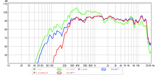

Raw response with CLD applied and with EQ
Legis,
Here is the raw response of the horn with the CLD in place. There is a sloped HF fall-off, and the low frequency knee is now around 300 Hz. I am able to integrate with the sub at a XO of 250Hz (-24dB/oct):

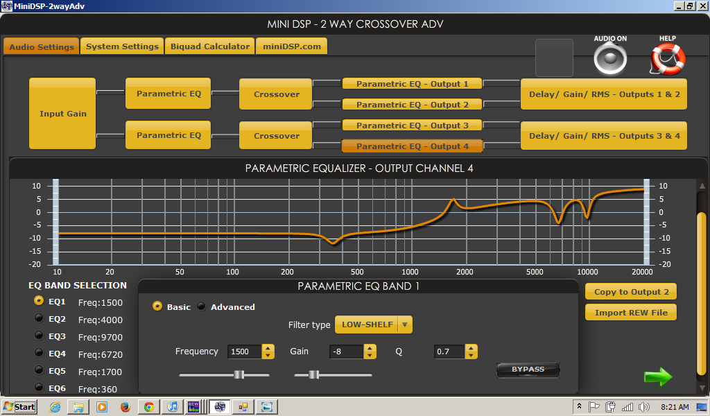

Here is the EQ that is now used:
The main settings were a high shelf at 4kHz of 9dB and Q=0.4; low shelf at 2.5kHz -8dB, Q-0.7; peak cuts at 360Hz, 6720Hz, 9700Hz; and the peak boost at 1.7kHz of 6dB and Q=7 to help smooth the throat cancellation (i.e., a DSP "phase plug" 😀) Yeah, I know it's bad to do a postive peak boost in 500Hz to 5kHz range but I will listen to it this way for a while and then remove it and see if I can tell a difference.

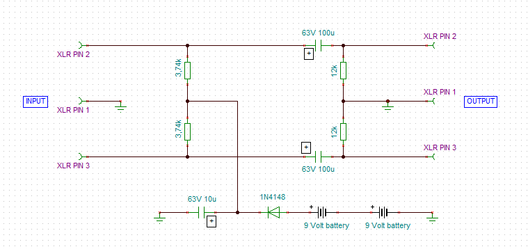

If your preamp has a switch to turn off the phantom power, you could try relative simple schematic attached 2 x 9V battery phantom power. The schematic is clone of AKG B18 battery phantom power. For less phase wrap in low increase value the two 100uF caps, and use preferred cap brand for this signal AC coupling. This circuit could be placed in microphone end of cable if environment is especially noisy.No air conditioning, it's just the DC phantom supply/mic pre amp having noise issues (Focusrite Scarlett 2i2) 🙁. That's also why the THD/all harmonics always (especially at low spl) rise in the LF in REW's "sweep view" (since harmonics cannot go lower than the noise floor). In spectrum view one can take the noise floor into account better.

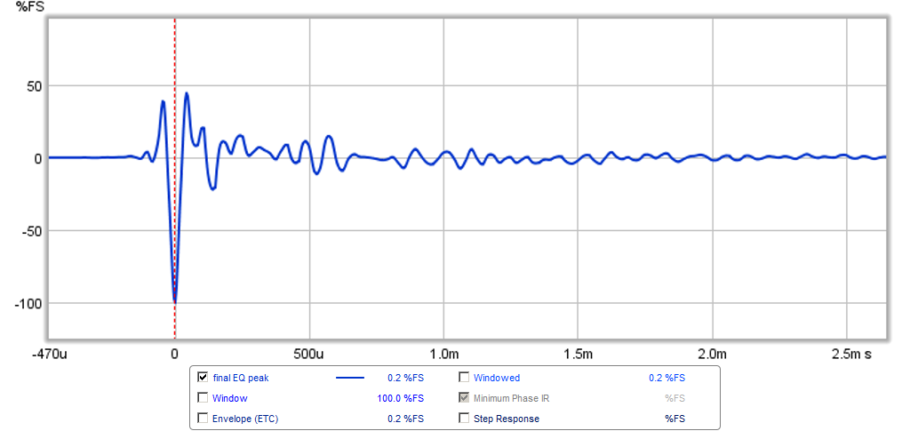

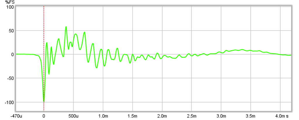

IR before and after EQ

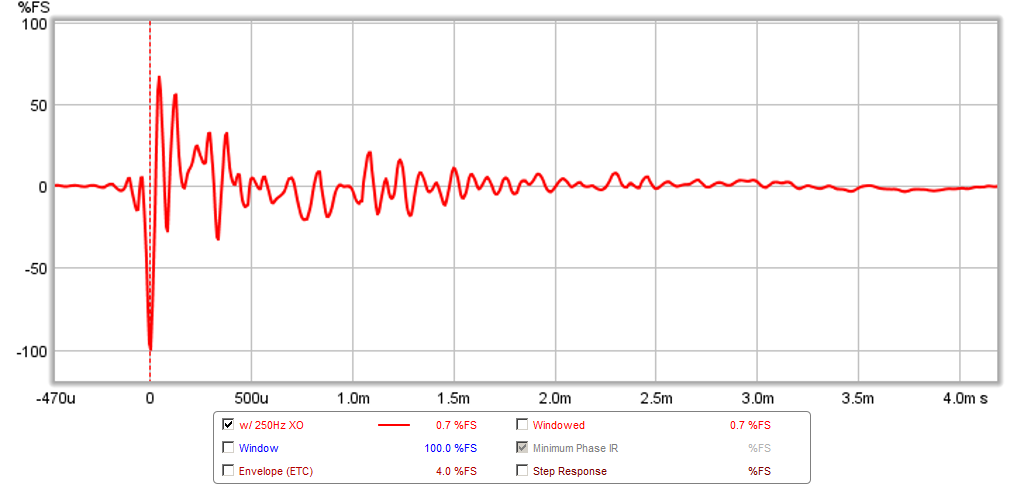

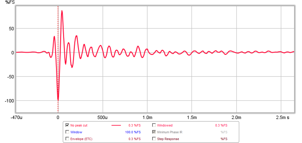

Someone asked what the effect of the EQ was on the impulse response (IR). Here it is (after CLD) raw - no EQ:
Here is the impulse response after the EQ:
I believe the 8-9kHz oscillation after the main pulse may be from the cone breakup as it was present in the OB and IB (Nautaloss), but not as large and with shorter duration.

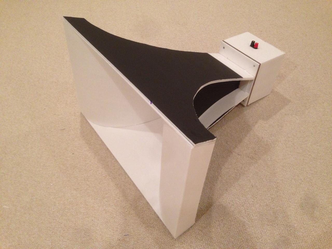

Here is a final photo of the completed horn with the CLD on all walls. It has a very dull thud sound when you tap on the panels, whereas before it was almost drum-head like.

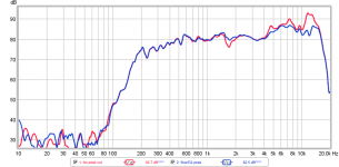

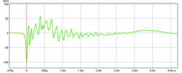

Effect of Notch Filters for Breakup Modes on IR

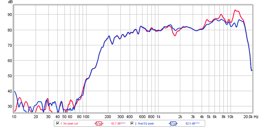

Here is the 5MR450NDY mounted in the Nautaloss and measured at close distance (12 in) away. You can see the 1.7kHz dip and the cone break up peaks in the 6kz to 12kHz range. The red trace is the response before the peak notches and blue is after.
Here is the corresponding IR for the case without the notches, note the ringing - predominantly seen with 12 cycles in 1ms or 12 kHz. So I applied the 12kHz notch first and that yielded a big improvement.
Here is the IR with the notches applied and also a boost at 1.7kHz to fix the dip caused by the driver that shows up in the tractrix. Much cleaner now.
Cymbals and high hats sound better now. 🙂
