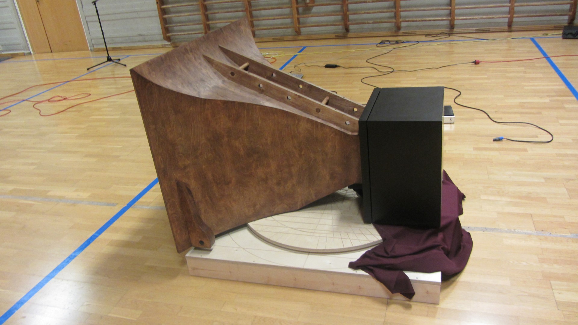

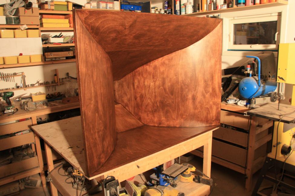

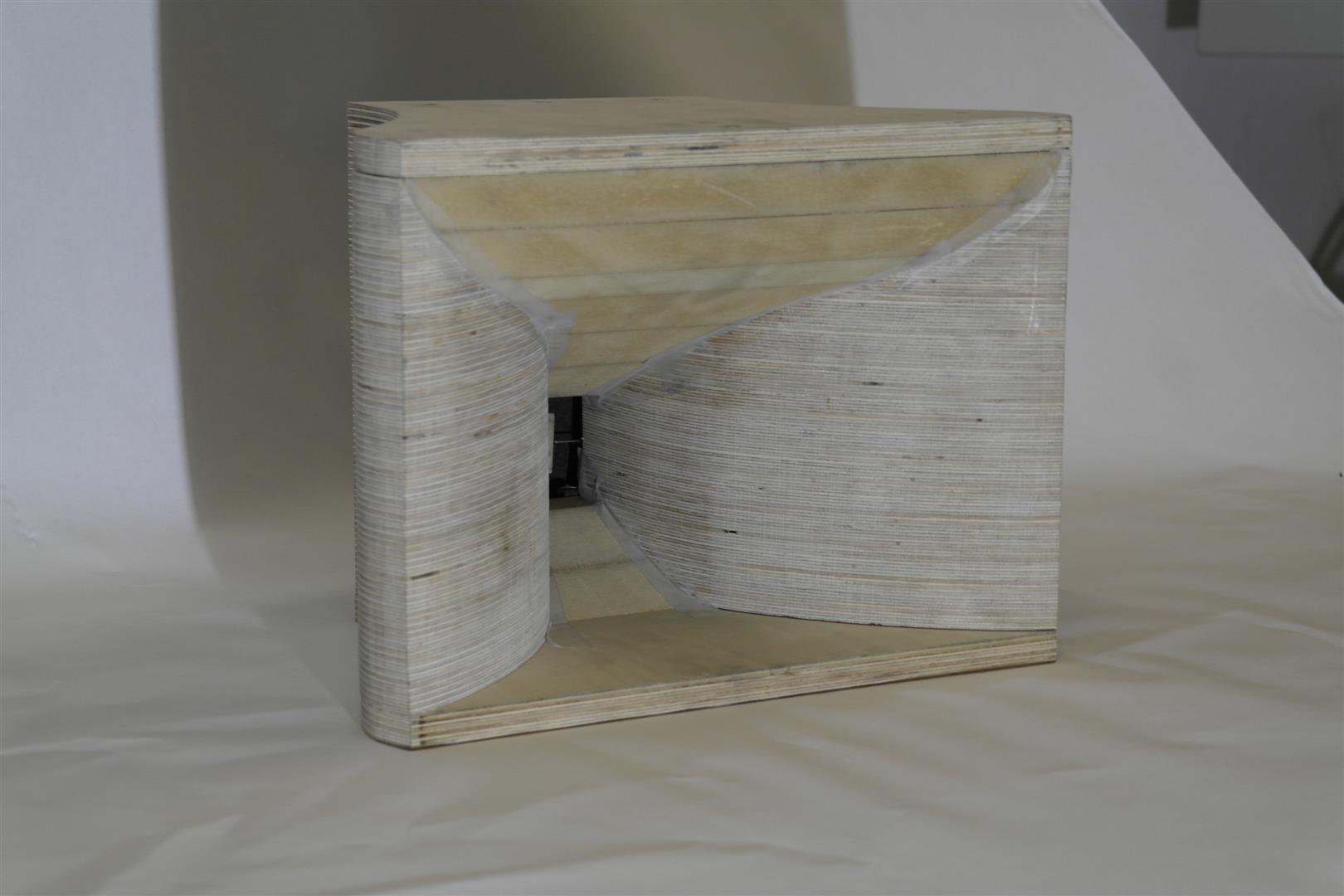

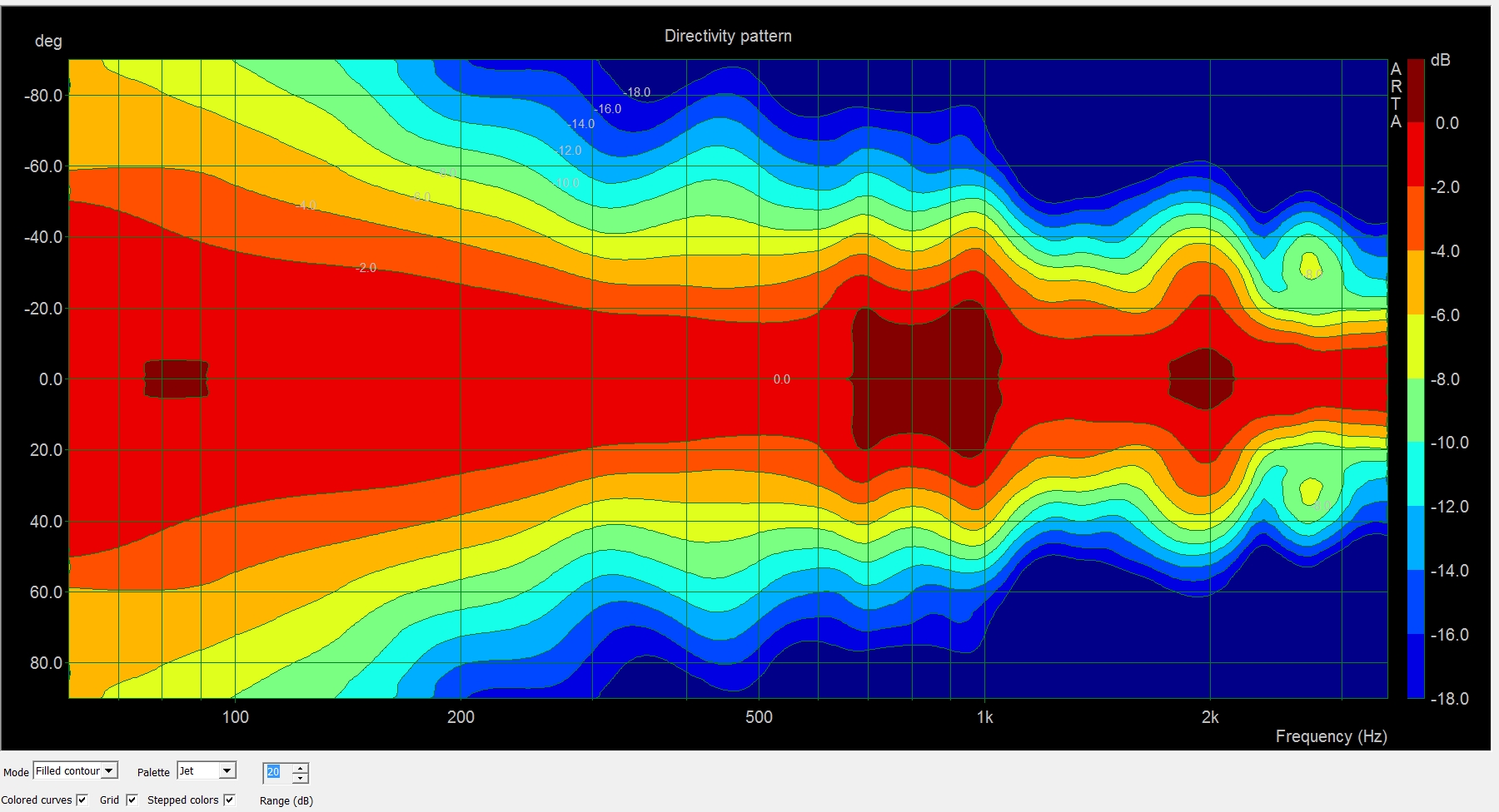

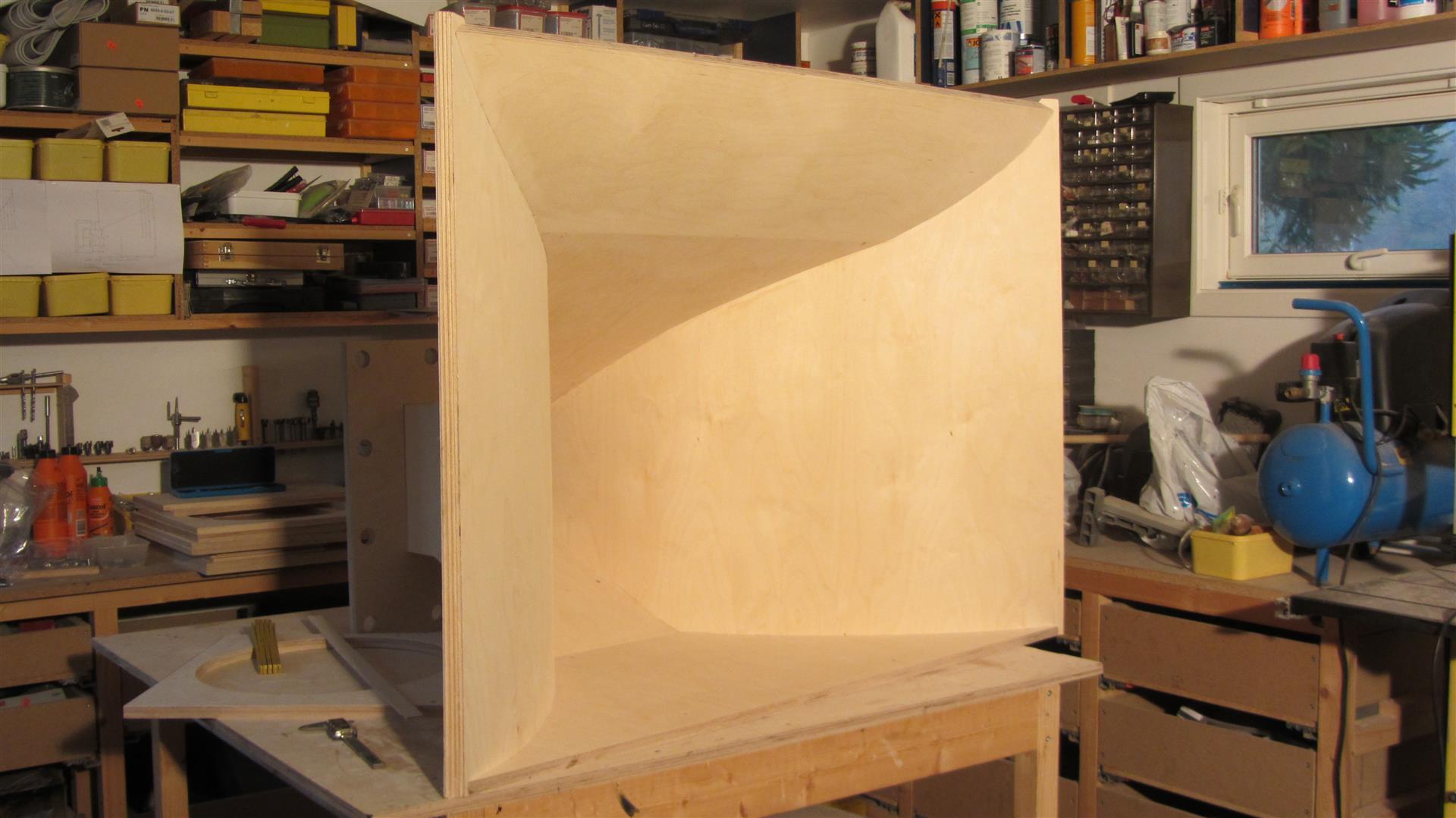

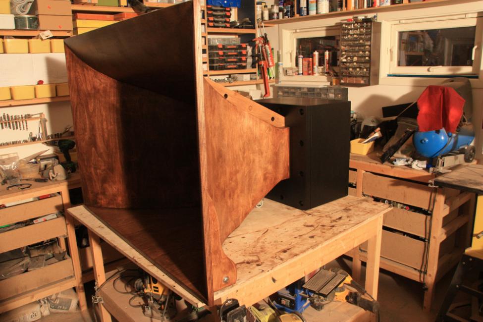

Bjorn Kolbrek designed a mid-bass horn for me and we've also decided to try to commercialize it. First a prototype scale model with 1/4 size was built and measured.
It measured very well both horizontally and vertically and we went on to build a full size one.

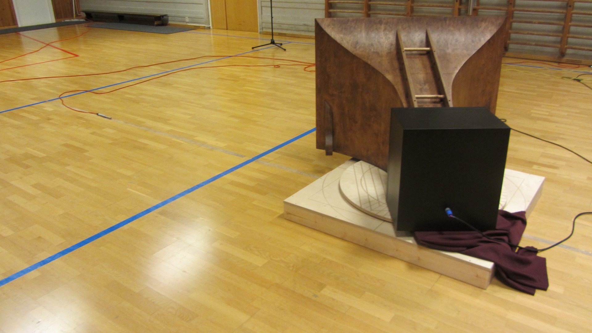

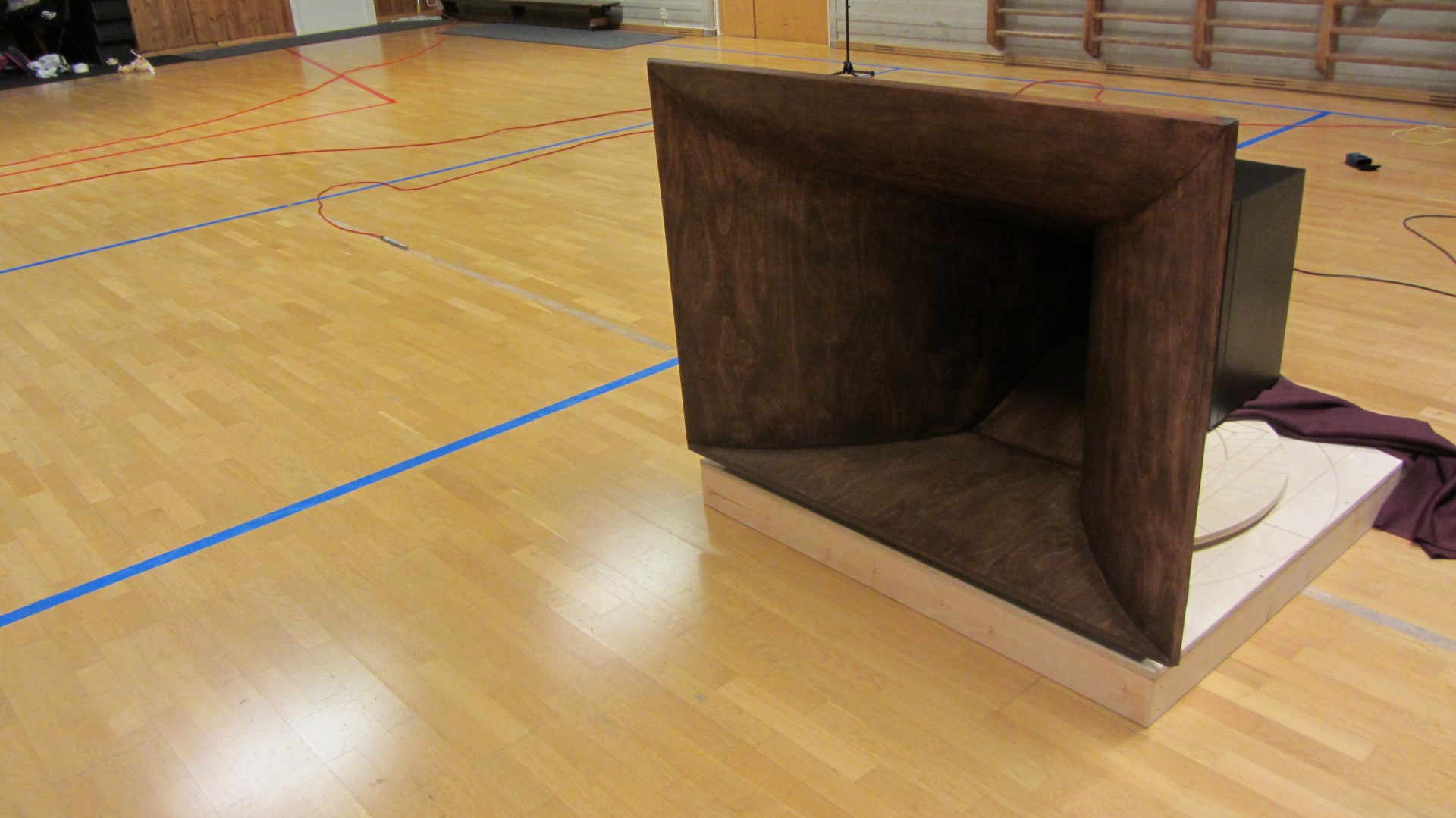

The full size horn was than measured in a gym.
The horizontal polar is very uniform and looks great and a little better than how the smaller scale model measured. Vertically we did some measurements including the floor to see if the asymmetrical shape minimized the floor bounce, and it seems to work really well.
We used JBL 2220H besides a B&C driver to measure the horn with and the JBL 2220H driver has a cancellation around 600-700 Hz, which we know is driver related. We're uncertain if this inherit with the driver or if our used drivers are damaged or haven't been reconed properly.
Next step now is to find the best production method. We may also get our own driver developed.

Roughly 4' (width) x 2.9' (height). Depth depends on rear chamber but without it it's about 2.95'.
I'm a little hesitant to share measurements because the JBL 2220H driver that was used had a cancellation and some resonances. Can be seen here:
However, I don't think this effected the horizontal directivity much, if any at all. So here's the horizontal polar.

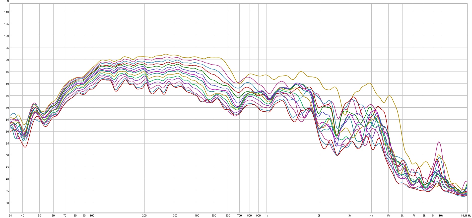

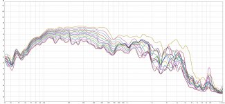

Here's some vertical measurements which included the floor and shown with 1/12 oct. smoothing. Just be aware that the driver issue effected these.

Not so useful to cross a 15" driver between 120-250Hz. The driver 2220H is perfect for this task, for example the 2225H will sound worse in a horn. But the horn is just too small for me. I have a pair of similar horns and now use ported 2225H instead. I could use both if ever I get a castle.

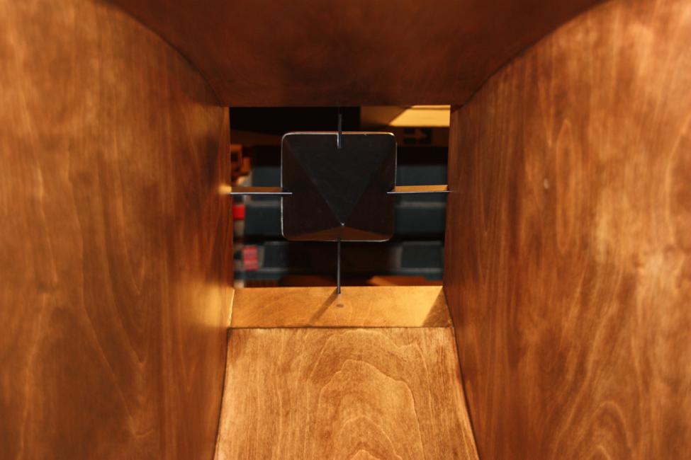

My horns have almost the same mouth at 47 by 26" and are only 48" deep mouth to throat entrance. 3.8" throat diameter.

Wow this a liitle throat in relation to the cone size !
How do you made for extend in the low end the 350-400 Hz natural HF roll of of the B&C driver ? Thanks to the space between the throat and the cone surround ? How deep is it ? 3 cm ? Or is it simply the volume of load ?
