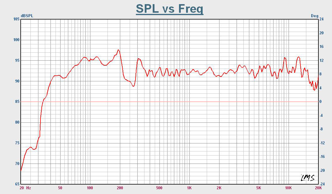

Above 150 Hz and especially between 200 Hz and 300 Hz the V folded horn is very uneven as can be seen by the measurement below.And now, back to reality: by "uneven above a certain frequency" do you mean below 80-90Hz? I'm not sure if there is significant unevenness below 100Hz but I don't have the frequency response at hand right now.
Our midbass horn measures flat.
Above 150 Hz and especially between 200 Hz and 300 Hz the V folded horn is very uneven as can be seen by the measurement below. ...
Ah, yes. - I did remember correctly. Are these your measurements? I only remember a response curve that's been floating around the internet for ages that is much less detailed (i.e. has been smoothed).
I think this "dip" might be due to the type of the horn and possibly its construction too.
Some modelling might reveal whether this is due to the horn - others have probably done this. As far as its construction is concerned, certainly one would not expect to have proper midbass coming out of it. I can't help wondering whether, if somehow one managed to smooth all these sharp corners in the folds, it would benefit the response. This is not a cheap exercise of course. Much easier to address this by directing the midbass to a separate section of the loudspeaker - which gives you the added benefit of letting the woofer do its job more comfortably. If, on the other hand, the anomaly is due to horn shortening, it's easier to fix by using some external panels, however, this solution has other shortcomings.
The point I'm trying to make is this: the original folded horn seems to be something a lot of diyers are keen to reproduce or improve by making it more sturdy etc. but no-one has attempted to actually improve the design as far as I know. I did read about someone making an enlarged corner horn that could go deeper while at university many decades ago but there's nothing else since. I don't expect there will be either - not any time soon - due to the magnitude of the cost and effort involved. I suspect this is mostly due to the material used for its construction (plywood) which is both expensive and cumbersome to work with due to the sizes involved.
