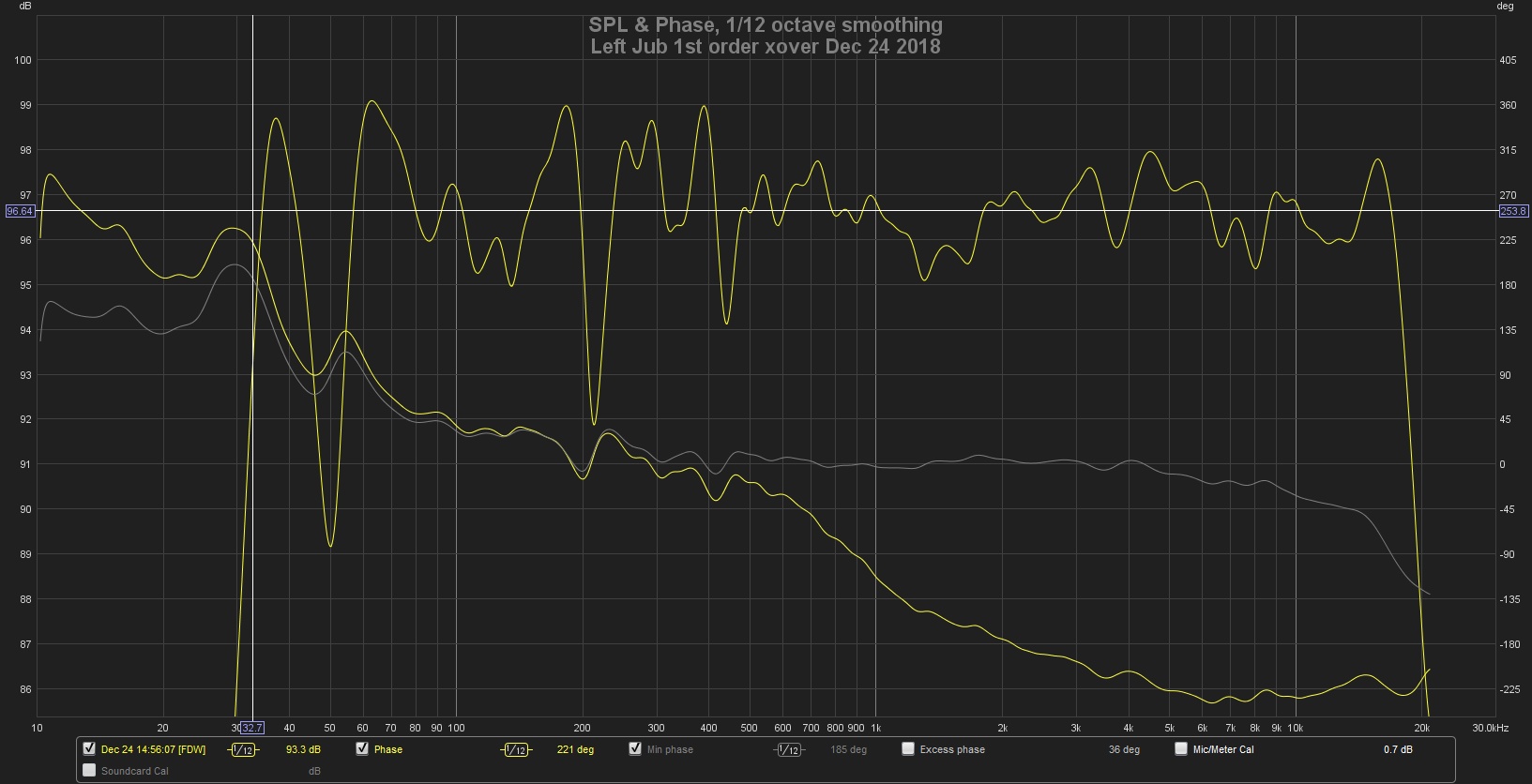

Here's a more recent in-room measurement of that same two-way Klipsch Jubilee w/TAD TD-4002 driver (complete with room modes and microphone/boundary 1/4 wave cancellations at 50, 212, and 424 Hz) using IIR filters only:
Your comments about the Jub bass bin seem a bit odd to me. I don't believe that a midbass horn mouth sticking far out in front of the K-402 either looks very good--or sounds very good either, due to the resulting requirement to have to stand back several metres in order to get a coalescing of the two horn's outputs. But it's obviously personal taste. Adding wings and a nose piece to the Jub bass bin is very doable and much more space efficient IMHO--like the following:

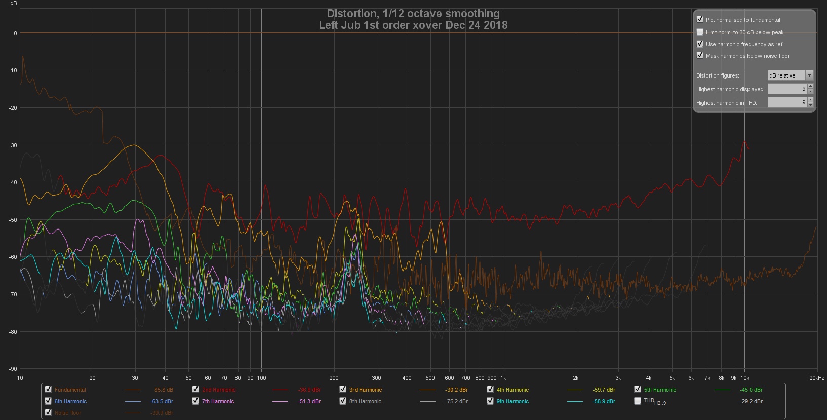

Here is a harmonic distortion plot of that same measurement (~96.5 dB on-axis at one metre). The distortion levels at frequencies below 100 Hz are lower than any subwoofer alternatives (that I can actually get into my listening room), that I've seen measurements for (at 96.5 dB), particularly modulation distortion:

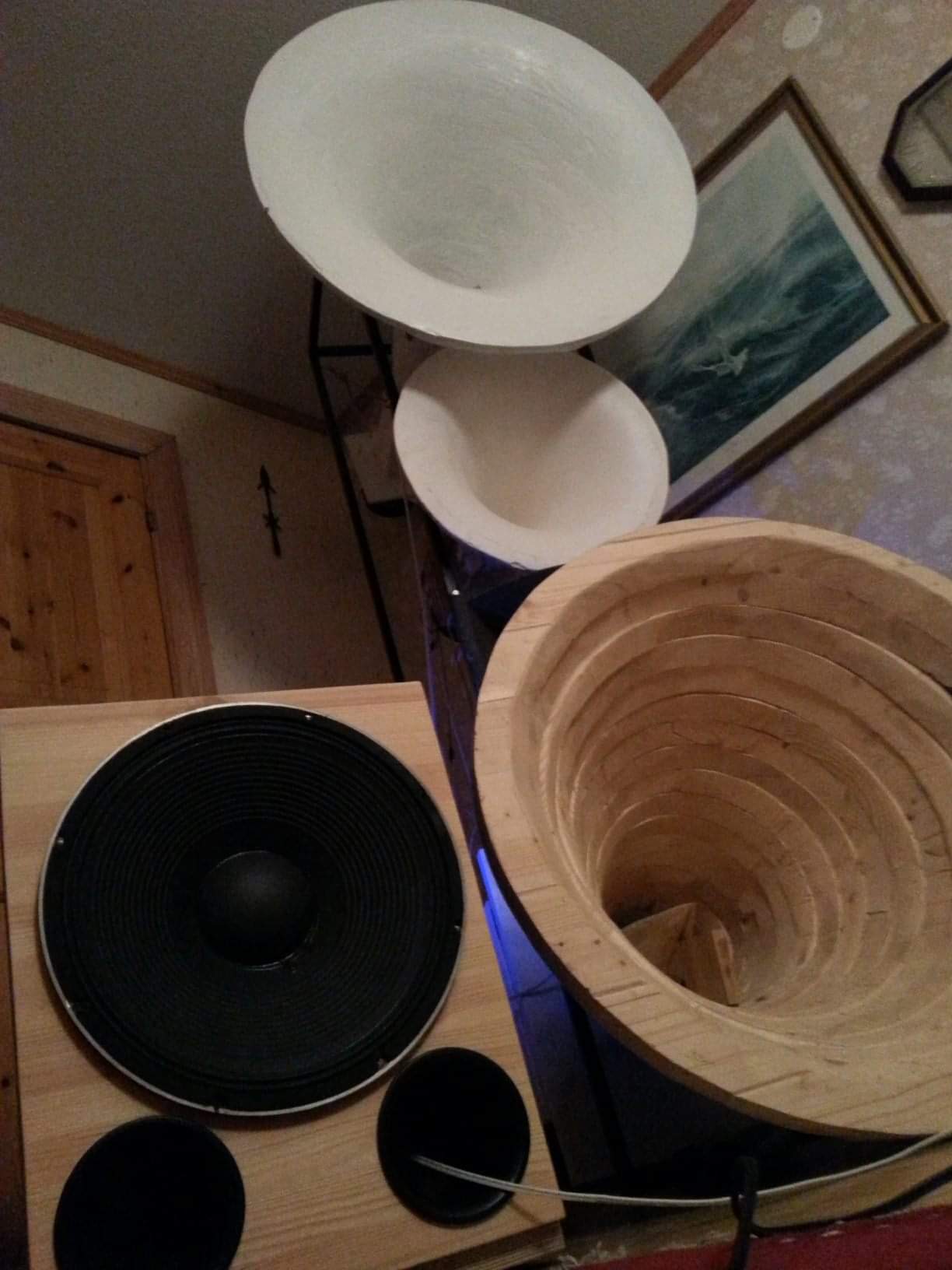

I could not decide on midbass solution either so naturally I built both a ported JBL 2225H cabinet and a hornloaded JBL 2220H. I did consider a corner horn but I was lacking a good corner with good solid pine tree to reflect the midbass. I can not rely on a thin plaster wall for midbass horn duty.
The ported sounded more correct, but a bit boring compared to feeling of being at a live concert I got from the horn loaded 2220H. Single instrument jazz was fantastic on horns, and with all that sensitivity I could here a pin drop in the recording. With more complex material, the 2225H was better, as if the mastering engineer did not use a horn speaker to tune in the bass. Strange.
I would love to have space for both at the same time. During my experiment I had to bck away to the next room for a coherent soundstage between the horns.

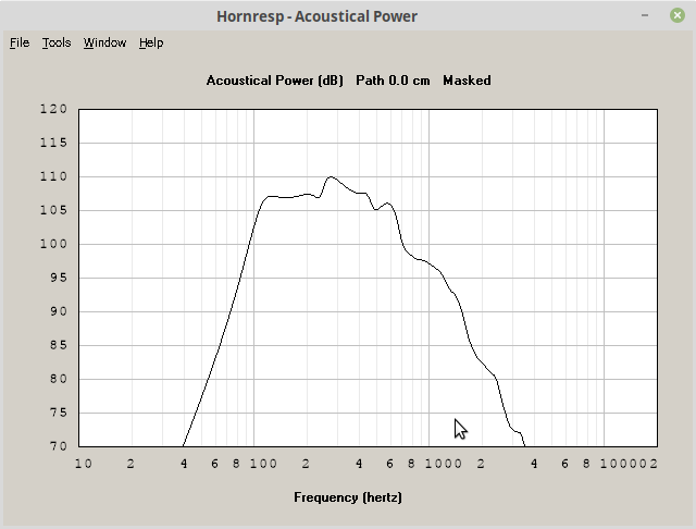

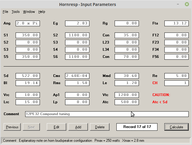

I played around with the different options in Hornresp and came up with this:
I was trying to have something like A7 horn with bass reflex to use from 100 Hz up to 500 Hz - something not too deep. TH below 100 Hz and JBL2445 above 500 Hz. And then I thought how about a TL instead of the BR.
I am pretty sure this has been done before, is this idea worth trying? The front horn would be as usual and the back horn would be folded so that it exits below the front horn.
the sim looks pretty good vs an approximation of Inlow's 135Hz horn
wonder what the mouth spacing would turn out to be? (IIRC I used 35cm in he sim below)
group delay is interesting as seems to shift from the front horn to the rear horn at a point
a 0.83 scale La Scala (20 inch cube) looks ok - in sim - crossover will add delay
(I have the back chamber volume reduced in this sim to reduce excursion below cutoff)

you may have a scalable alignment and the horn's volume ratios are 2:1 - a 1.2 scale, 2 pi with a JBL M151, F#~90Hz
and summed response pretty good
