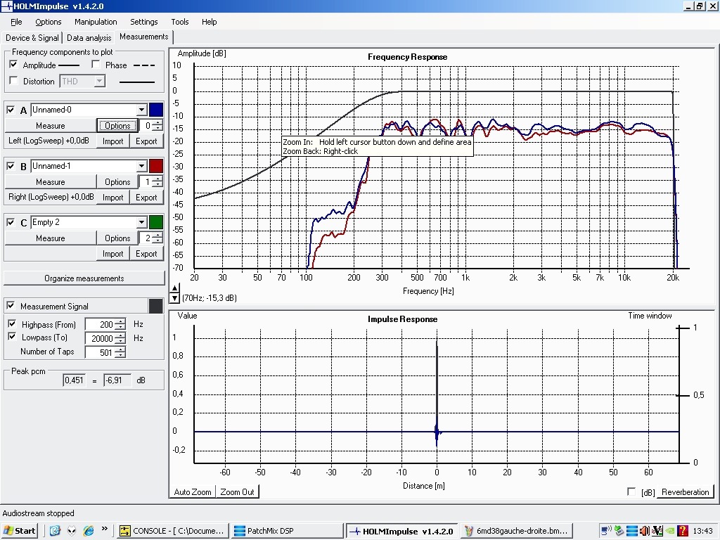

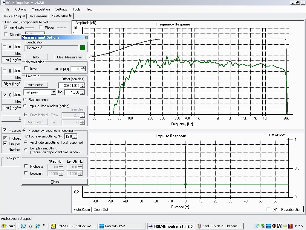

As I am using a 3 way and cutting the mids between 300 and 2500 I am more thinking of a waveguide than a horn...
So just maybe to control a little bit dispersion and diffraction...
I think something like that would be ok, too bad it has guide for a 1" horn as I use 34mm or 30mm tweeter (audax tw34 or wavecor tw30a12)
https://www.limmerhorns.de/630-bc1/
Yeah maybe just a kind of guide with concentric circles sanded or plastered would be doable...
I see, so you want a device which works more at the higher frequencies and disappears at lower frequencies. If you do this you might be able to make the woofer act like it is larger than it is.
I'm not sure what you'd expect with diffraction. Is there some that is a problem or are you just suggesting?

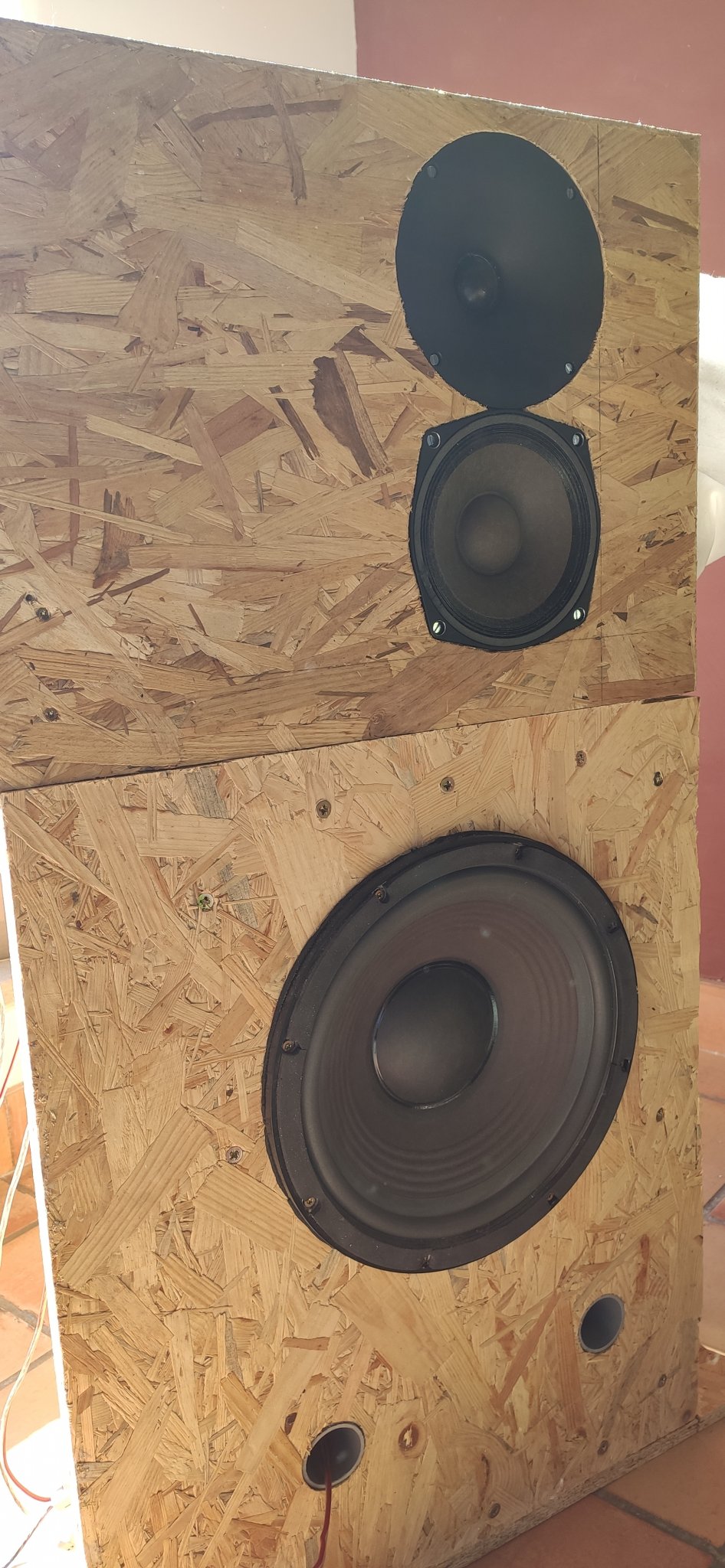

I am playing with BC 6md38 wide open baffle and waveguided tweeter. Woofer for the time being beyma 12b100r bass reflex.
I like it, I think 165mm drivers are great on a lot of aspects. Maybe a small waveguide with no compression would smooth the response and make it less dependent from position...
What do you think of limmerhorns anyway?
Regards Greg
(Sweeps from 300 Hz @ 80cms and 100hz @ listening position, cutoffs 300, 2500)
