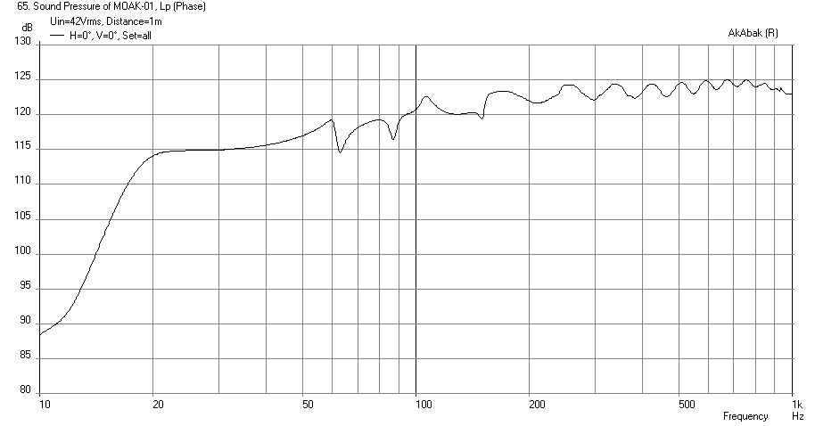

You read correctly about the 96" measurement . I am looking for a tall tapped horn that goes down to 16-18hz and plays clean to about 80hz with a small foot print. I have 10' ceilings so the height if free. I have room for the existing subs but the space is tight and just looking for a possible options.
You might want to look at this "tall" sub that Freddi had Thejessman build from a plan and design by Tb46 - it uses a low cost Infinity 1260W - which is a great performer for the price:
Or you may want to consider the MOAK (never yet built):
More info here: http://www.diyaudio.com/forums/subwoofers/254948-moak-mother-all-karlsonators-aka-magnificent-monster.html
