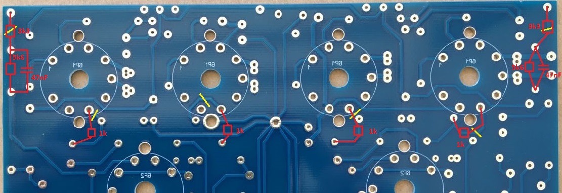

Thanks batteryman, that makes so much more sense to me now.
I disconnected the Rnf / Lnf from the board to diagnose, and now I've got a much cleaner, but also weaker signal. I will check if I mixed up resistors somewhere.

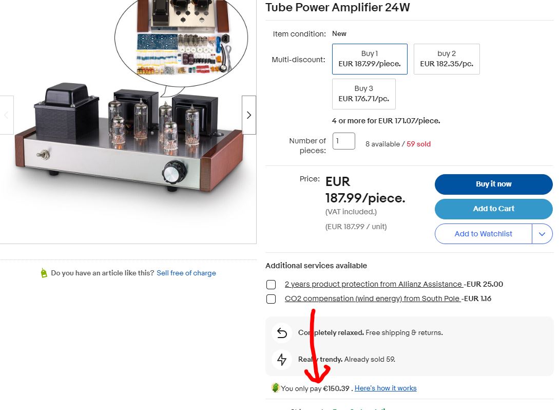

Thank you for the replies! The amp in this thread seems to be the cheapest to buy and available in Europe, but maybe there is a lot to be spent to get it performing well? Seems a lot is wrong with the original design.

In Germany this amplifier is available again with a big discount, which makes the offer almost irresistible (it is also available for shipping to Sweden but with slightly different conditions) 😉Thank you for the replies! The amp in this thread seems to be the cheapest to buy and available in Europe, but maybe there is a lot to be spent to get it performing well? Seems a lot is wrong with the original design.

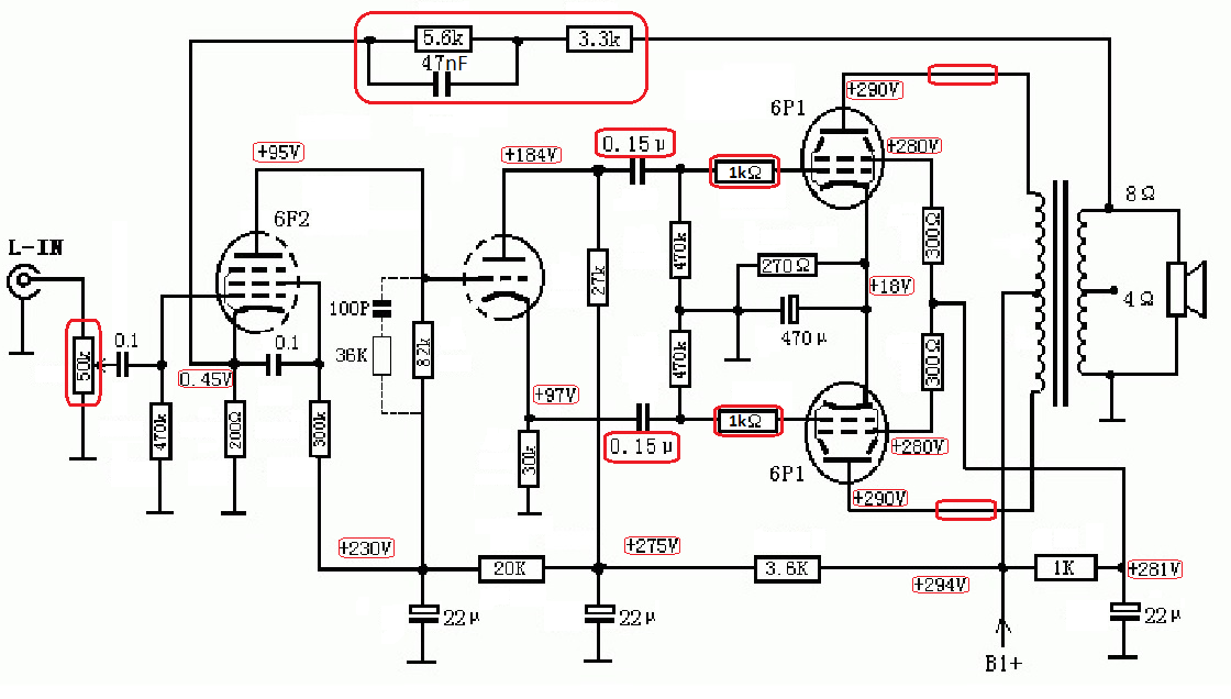

Has anybody made a LTspice sim of this amp? I think that would be useful for simulating mods etc.
DC voltages look close in simulation, the input pentode voltages are a bit off, I use a 6U8 (ECF82), not sure how close is to the Chinese 6F2, and for the 6P1 I use a 6P1P-EV model found here in the Spice models' thread. I also used an 8K:8 OPT, not sure which one is required.

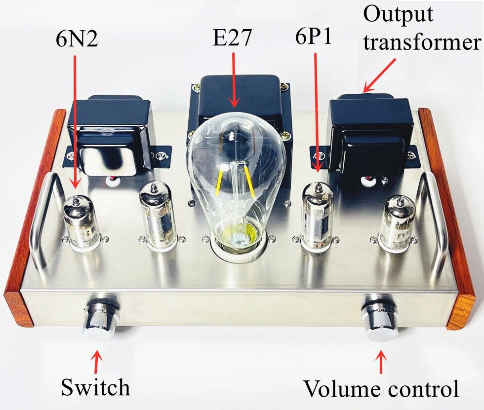

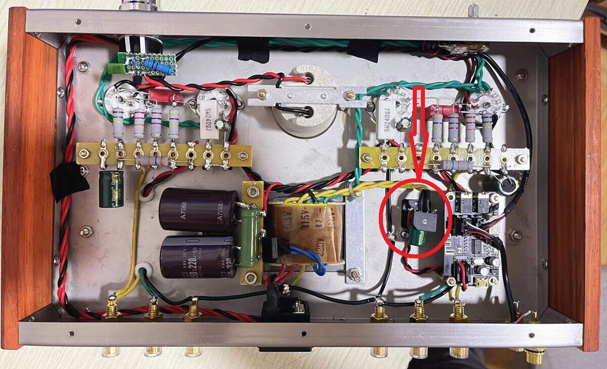

E27 lamp - is not a rectifier! Probably a silicon bridge rectifier inside.....What is this joke ? 😳
