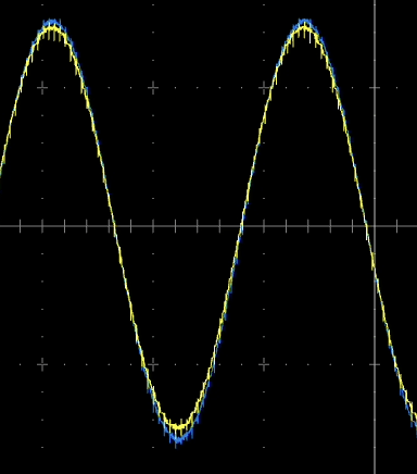

Yes, it's a digital, line-level signal (input, in blue). The output is yellow. Same in all three pictures.
The 20kHz signal is stronger without a load (no speakers), and it goes away when switching off the amp. It does not change with moving the cables for my probes. It isn't present in the input. The oscilloscope also doesn't have a power supply, just a laptop with USB power. So, logically, I can confidently say it's originating inside the amp, can't I?
Below is an earlier measurement with L and R channels that shows these spikes in both channels.
Switching noise could be, of course.. I recently added another bridge rectifier to the 6.3V AC filament heating circuit, and it's not yet loaded, output wires just dangling. I didn't think it could output 20kHz... but then I come across this thread ... Could that be the source?

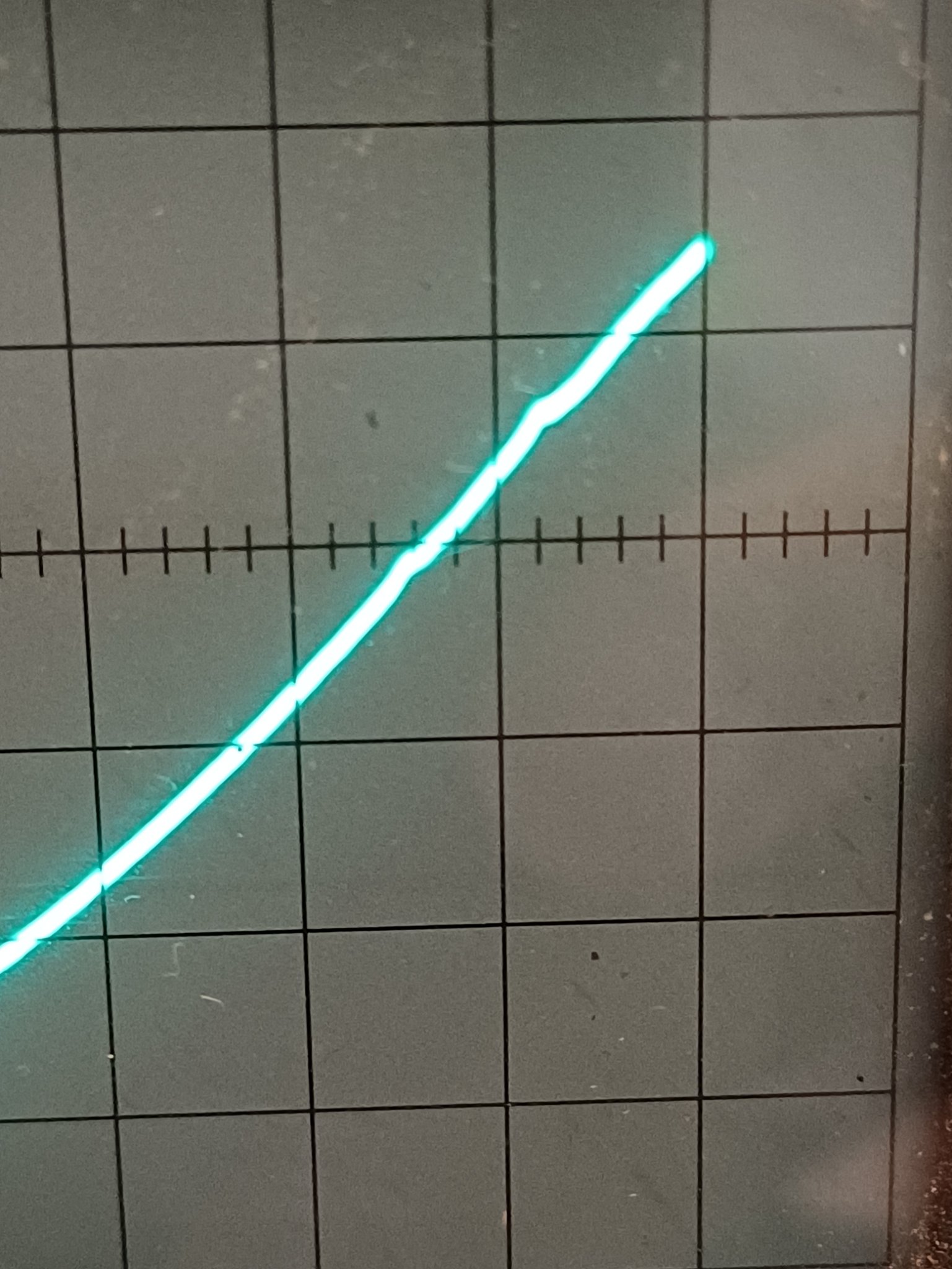

I did some experiments on this amp today. Wanted to play around with the resistor values for the 'splitter' so I put in some resistors and a trimmer instead of the 30k resistor so I could vary it while measuring distortion.
With equal values (27k), the 2nd and 4th harmonics was significantly higher, while the others seemed to stay more or less the same. With higher resistance the 2nd decreased, and came to a minimum around 31k. I kept increasing it a little bit more, but nothing seemed to happen. 30k was very close to minimum H2.
I also wanted to try different bias to see what happened. The result was not so much. It seemed that H2 increased and H3 decreased a bit and with higher bias (lower resistor values), but not significantly. Since the distortion is H3 dominant, I was hoping to be able to reduce H3. My guess was that the H3 comes from the P/P tubes, but I'm not sure, and I was not able to do much about it.
I also found a problem with one channel on the amp. There were some small 'blips' moving around on the rising flank depending on output level. They are not visible below 4Vpp though (4ohm tap and load). They showed up as pretty nasty high order distortion on the FFT. I found that swapping the output tubes between channels moved this problem. There also seems to be less gain with the problematic tube pair. I ordered 4pcs for 20Eur from Audiophonics (and I had a voucher so I got them almost for free), so I hope I can sort this out by swapping them around and measuring some more.

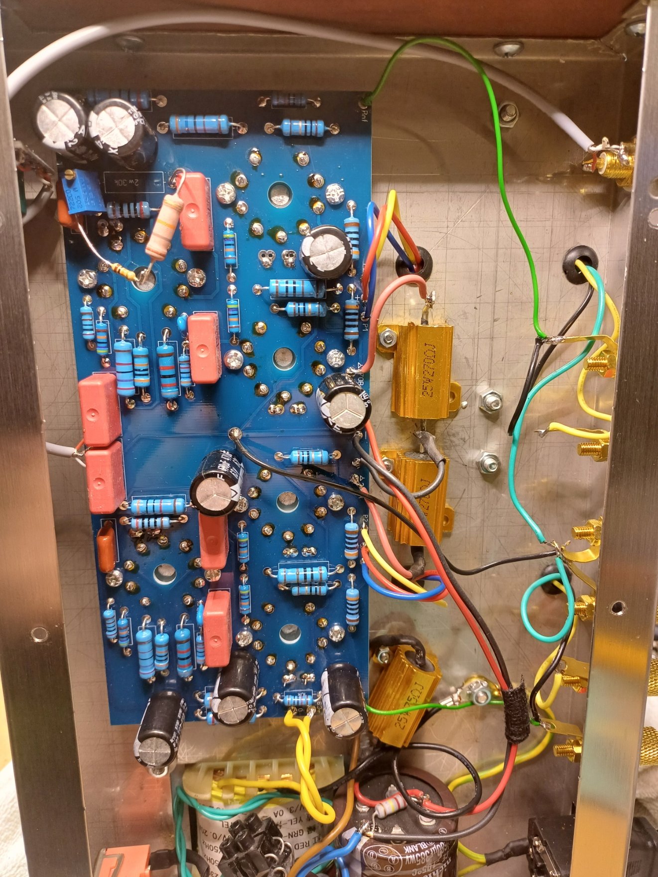

I had some minor issues with my build that turned out to be the tubes. Got some replacement tubes from ebay and the amp sounds very nice. Also, I replaced some of the hardware, jacks, volume pot etc. right out the bat, as I had better ones.
