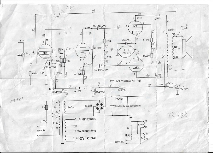

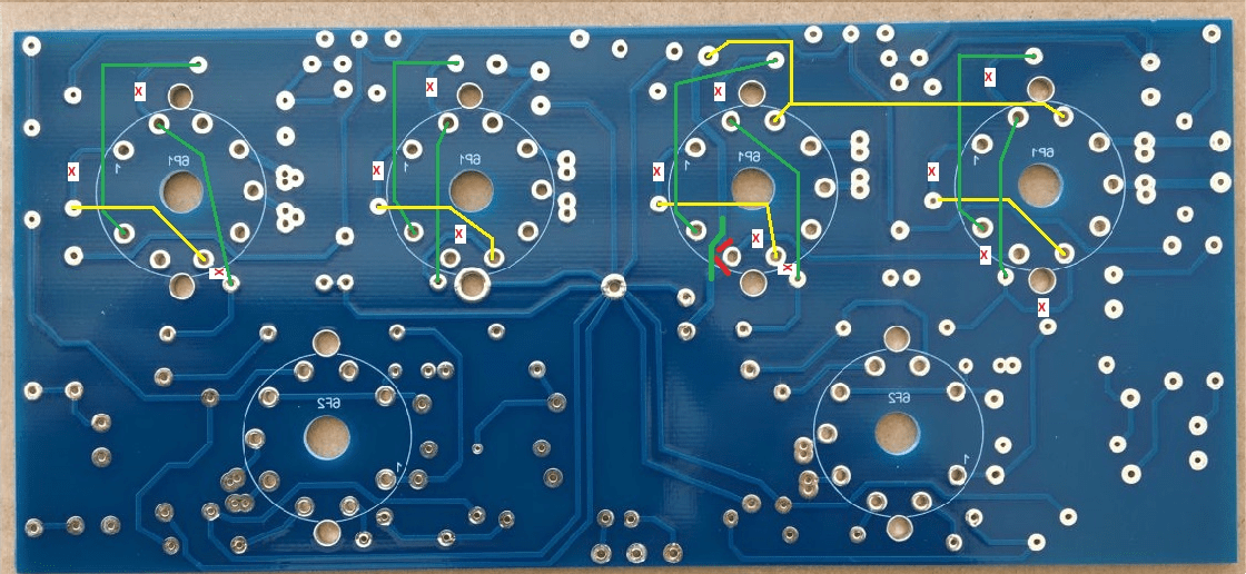

Attached is schema from April '20-
Per the comparison to Post #56, PT in my diagram shows (2) 6.3V windings. That matches your PT label. Post #57 is correct w/ wiring advice- imo.

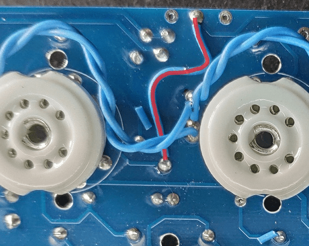

As you can tell by the markings- I double checked my PCB per supplied diagram. Found pin #2 of the 6P1's was actually PCB traced to pin #9.
Initially thought this was mistake either diagram or PCB. Research showed 6P1 had internal connection from #2 to #9. Would have been nice if that were noted.

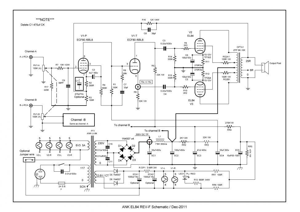

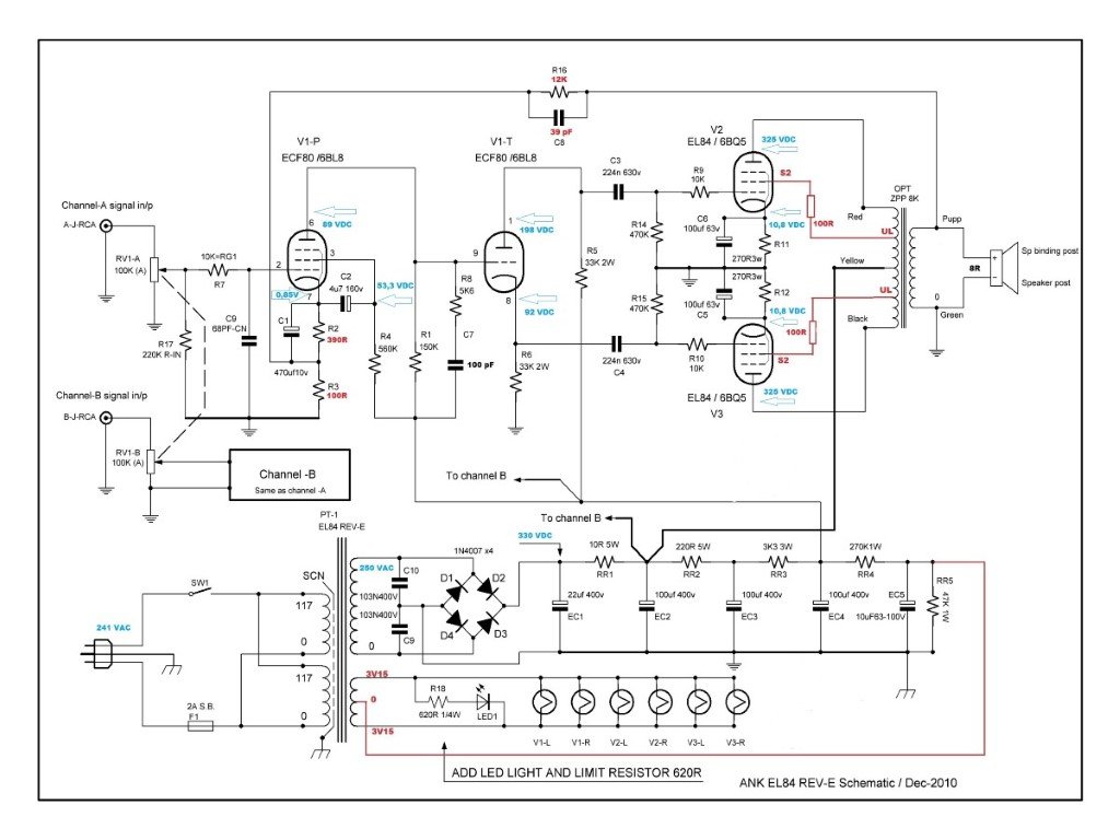

1. Audionote ANK EL84 (Rev D or E)

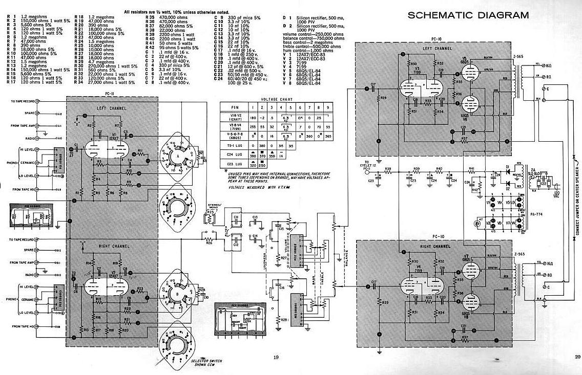

1. Dynaco ST-35

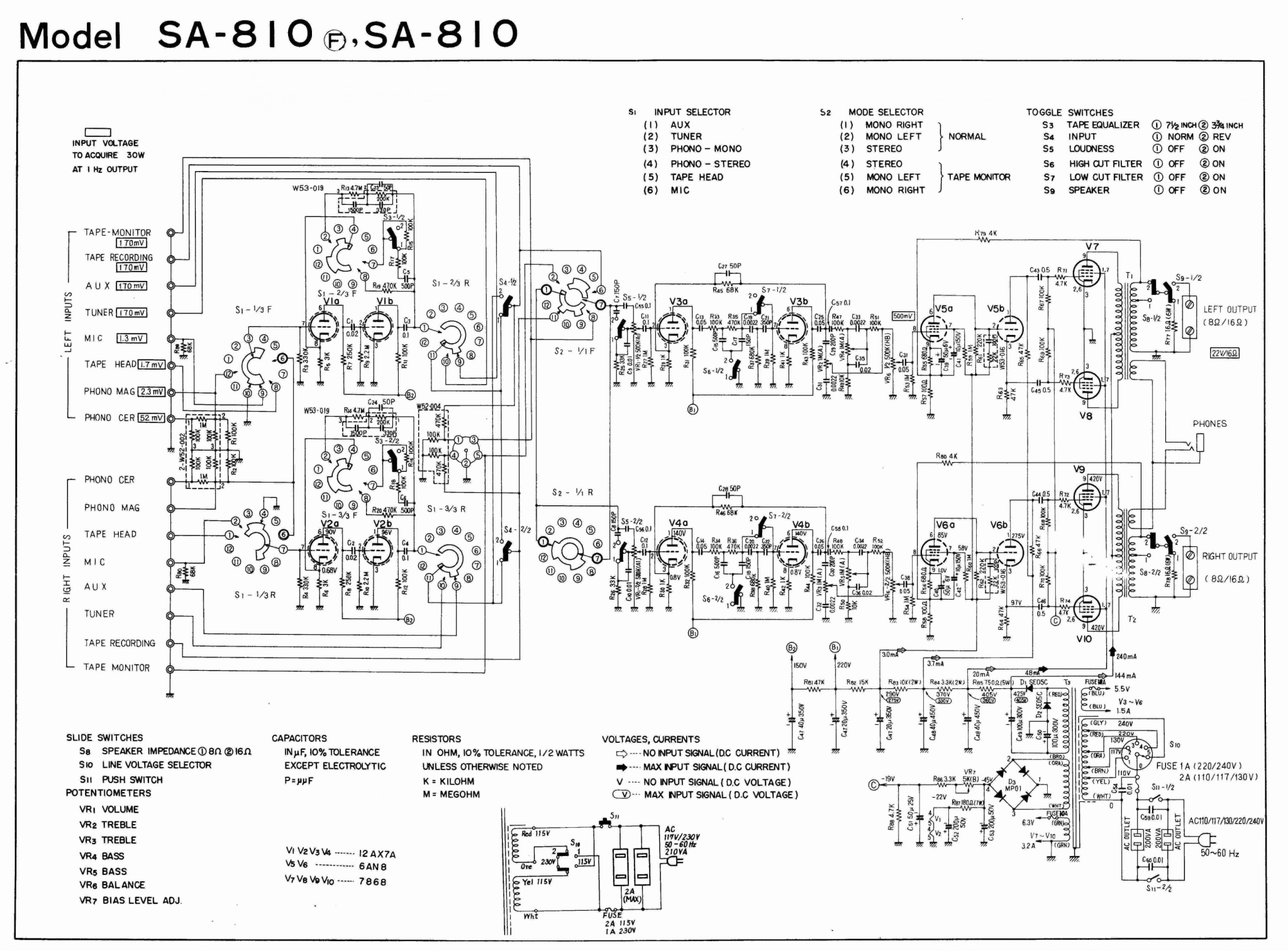

2. Pioneer SA-810 / ST35 Hybrid- the current
Latter combines the lo noise floor of triode front end w/ the bigger output plates of the 6GM5/ 7591
Rocks the house... This output stage is cleaner when leaned into v/ the 6BQ5 set. Thats my journey thus far...

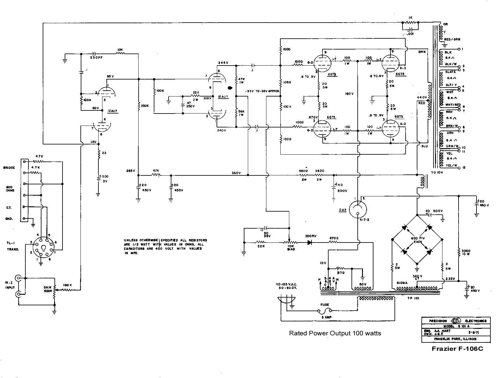

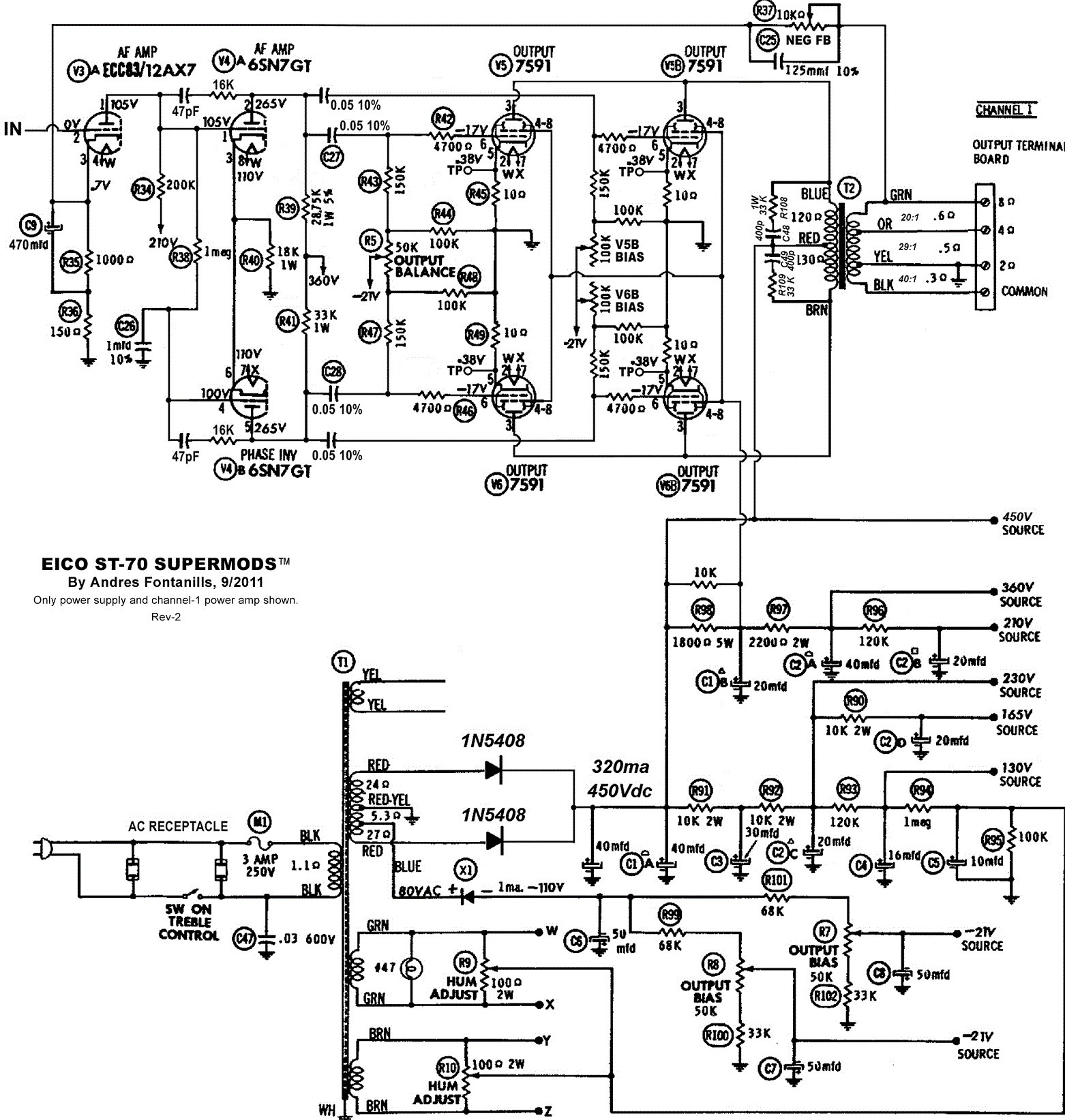

1. Eico 70 supermods PP quad
2. Frasier F106C 12GT5 quads 100WPC Barn burner
Depends on what your goals are...

Interesting journey you are on. I ran mine without negative feedback. Also CC's as mentioned earlier post. Equal concertina resistors. Added bleeder resistor on power supply caps. Zeners to reduce voltage to G2 on 6P1P. My best sounding small amp. For $200 USD from Icairn Audio store Aliexpress, hard to beat that value, as a DIY'er.
"I ran mine without negative feedback" - Tried changing the 10k FDBK resistor value, then deleting it- sounded raspy when deleted, all values in between were an inverse function. 10k was best balance per design
"Equal concertina resistors"- That seemed logical to me also- but there are varying schools of thought on that
"bleeder resistor on power supply caps"- Smart, very smart- so did I
"Zeners to reduce voltage to G2 on 6P1P"- Something I didn't consider trying 3 yrs ago- but seen that mod discussed here w/ other PP designs-
Not yet to the tuning procedures of my journey... first bring the boom- then refine the room-

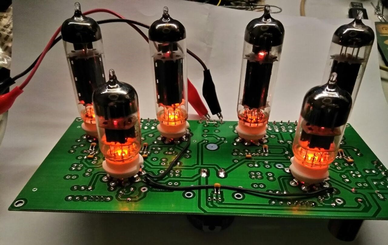

Have mine assembled, added bleed resistors across the two filter caps.
Brought up on the variac with dummy loads, voltages measured ok.
Powered down and connected some sacrificial speakers and an input source as the next step. At power up it sounds good for a few seconds, then degrades into an increasing mess of distortion/oscillation? (not sure of the proper terminology to apply to what is coming out of the speakers).
This isn't affected by the volume control. It fades out once the power is cut, and the bleeders do their job.
Tried swapping the blue/yellow P1/P2 wires, but that was worse. Distortion mess immediately at power up.
Any ideas to troubleshoot this? Thanks again to all for the previous guidance.
P1/P2 is the primary of the output transformer ? Remove the negative feedback resistor 10K or the wire to it , from secondary to cathode of 6F2
And measure the voltages that are marked on schematic , this is for knowing if the board has no obvious mistakes / faults .
@Depanatoru Thank you, that was it! Voltages were all over the place when wired with the neg feedback. I removed those connections and powered up. All voltages matched the schematic when running at 110V. No hum, no hiss, sounds good.

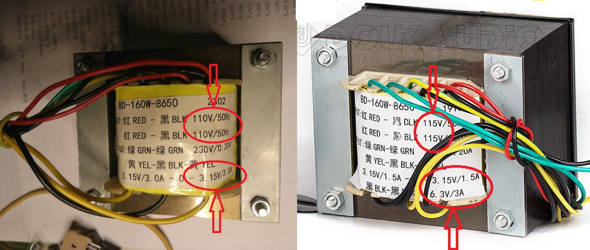

As an FYI for anyone who has one of these, or is considering one, my power transformer was marked as "120V" input, but that appears to be false. Running on my 122v house supply, the B+ measures 302v. Running from the variac at 110v, B+ is right at 278v as specified on the schematic.
Higher B+ is not an issue if the caps have enough voltage rating , the filament is important to be all the time below 6,3V so you don't "cook" the tubes and expect long life .

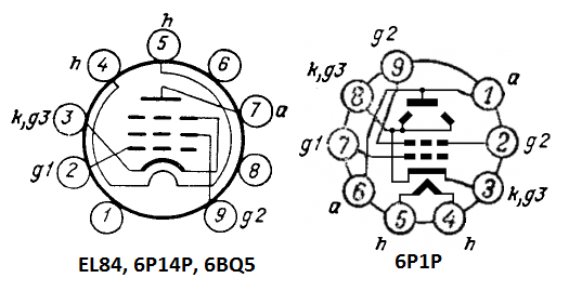

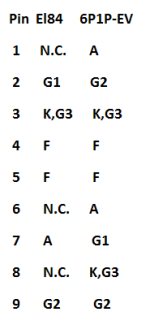

who would like try to EL84 / 6BQ5 / 6P14P, here is a pin comparison:
the 6p1p-ev is not a direct replacement of the el84, another pinout !
they are russian tubes, inscribed in cyrillic. imprint 6П1Р-ЕВ

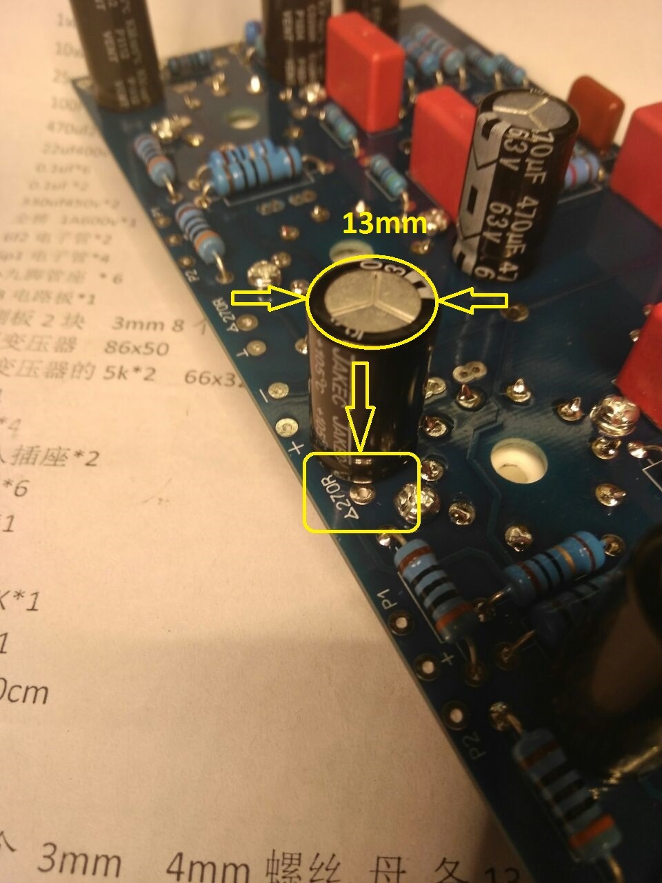

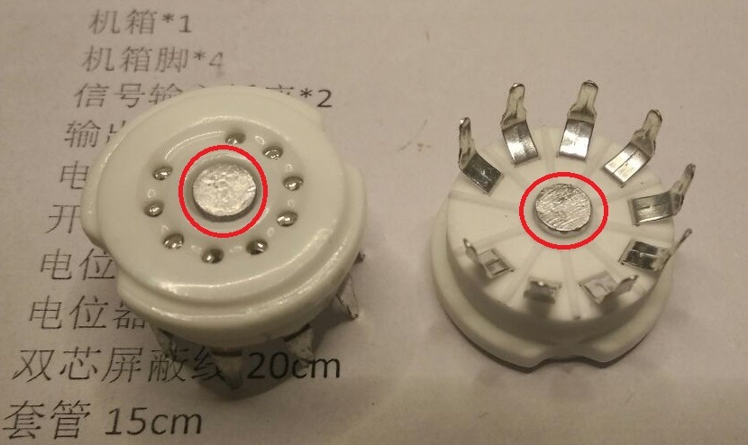

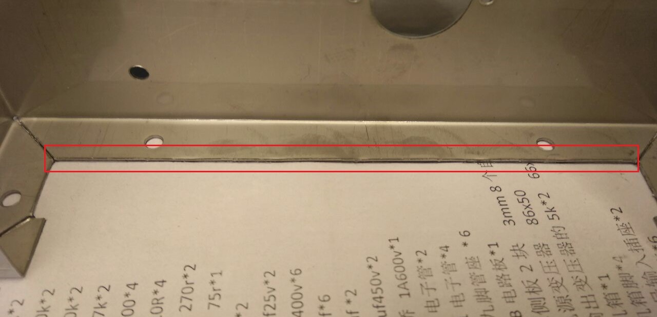

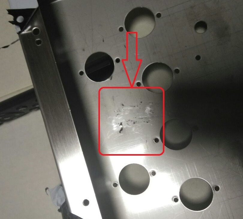

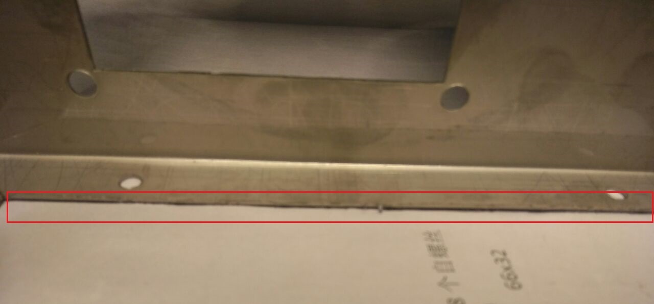

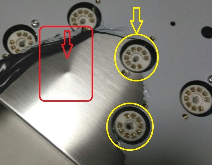

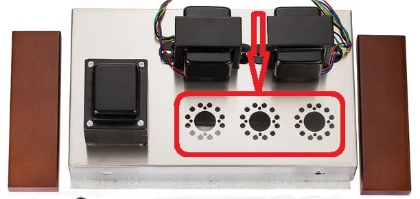

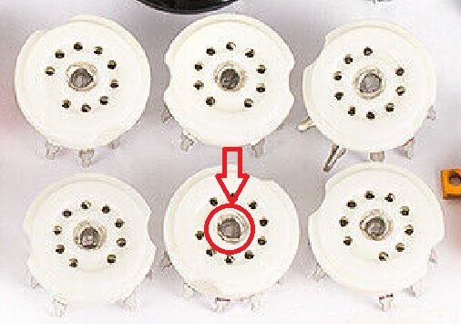

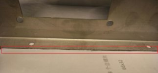

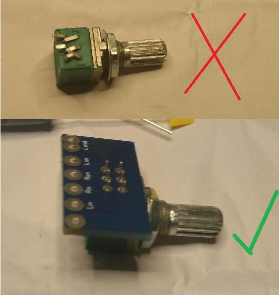

I received the kit from eBay yesterday, partly a disaster:
Since the box was externally undamaged, I accepted it as is. Then I made the mistake of starting to assemble the components because the PCB and components were on top. When that was completed, the disaster began: power transformer (only 2x110V instead of 2x115V, 6.3V~ winding not available) and tube base not as shown in the eBay offer (with a center hole), electrolytic capacitors too large in diameter (risk of the insulation of the electrolytic capacitors burning through when soldering and this results in short circuits), pot connections totally bent, housing damaged (dent especially in the visible area due to insufficient protection of the heavy power transformer inside the box) and not deburred, sharp edges everywhere ---> risk of injury! No holes for air circulation like with his other kits, but by using other sockets (I really wanted to install LEDs) this is now possible.
Now I can mess with eBay because the seller only offered a discount of 8% and that's decidedly not enough for me!
