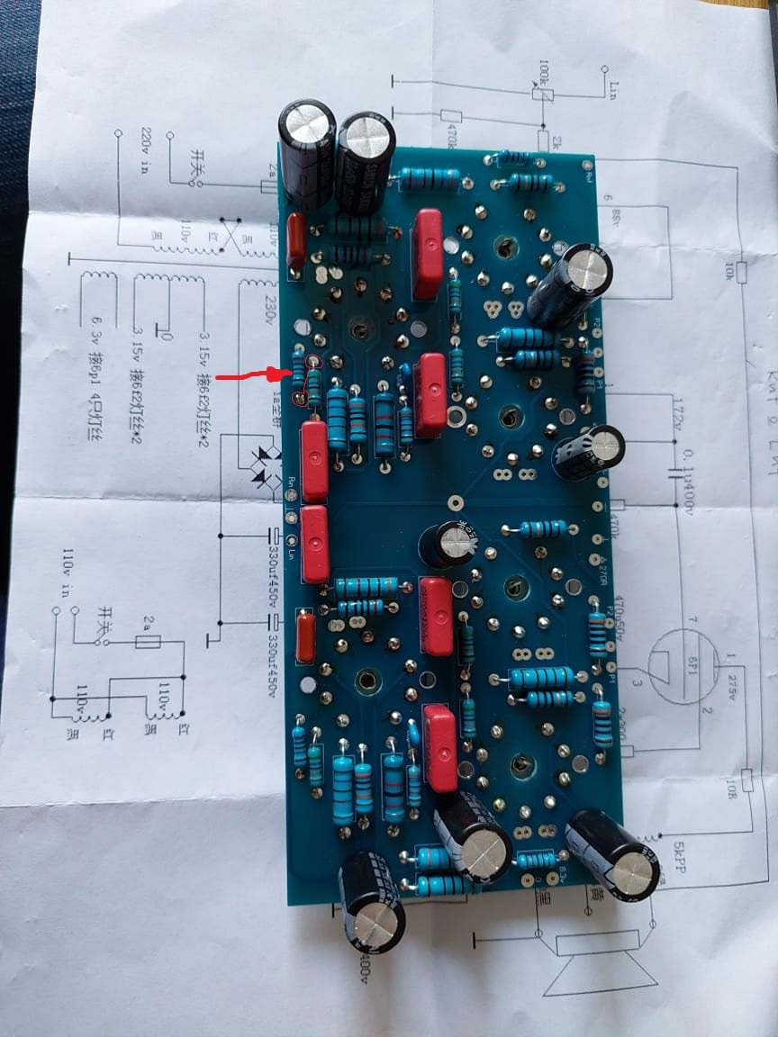

Hi!
I bought this kit in late 2021 and got a pcb that has some modifications, compared with the pcb exemplified higher up in the thread. The Rin/Lin via hole is connected to a 0.1uF capacitor. The node that matches the input node on the schematics is marked with a red arrow on the attached jpg.
I've reached out to the vendor, on ebay asking for more info. Has anyone seen this board (attached)?

I started to trace the pcb and it seems the 0.1uF is placed properly. However, there is a 0.1uF coupling capacitor that is not shown in the schematics they send me.Hi!

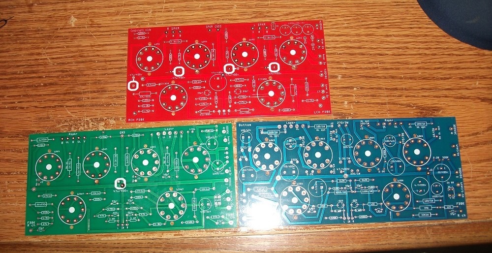

Rolled tubes on original design- tried 6P1EV outputs- no difference my ears could hear. Rolled the preamp tubes... 6EA8, 6U8A, 6GH8
Struggled to find preamp tube better than Chinese tube that didn't have 'hiss' at no volume. Jan 6U8A's started out quiet, then 1 got 'hissy' after 2 months daily use. Bottom line- my rolling showed ChiFi tubes hard to beat in original design.
Then began researching and changed up design w/ diff PCB's (pics)
Blue board- Audio Note EL84 (6U8A/6BQ5) design
Green board- Dynaco ST-35 (12DW7/6BQ5) design
Dynaco design used hi-gain triode as preamp instead of pentode- noticed significant reduction in background 'hiss' instantly.... the floor was almost dead silent... decided Dynaco front end design was a keeper.
Red board is current design- a hybrid really... Dynaco's dual triode front end feeding Pioneer's SA-810 higher power 7868 (6GM5) outputs.
Currently at the point of 'tweaking' values to optimize this design... first upgrading original power transformer to feed higher power output tubes.
