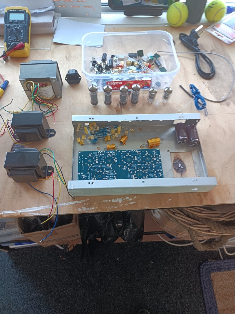

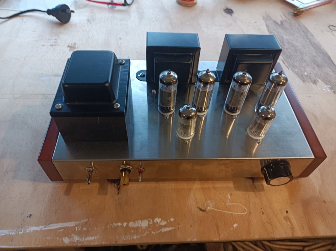

9 Days from shipping notification, and the kit was delivered. That is pretty unbelievable from China to New Zealand. So unpacked it and checked that all the components were there - just loose in a bag. The valves were well packed, in corrugated cardboard tubes, inside another tube. Put all the components on the circuit board, Drilled out the front panel for a headphone socket and switch. Installed the power transformer, power supply components and high power resistors. Then the input and output sockets, wired up the volume control (why is it linear?, they always used to be log pots). mounted that. Installed output transformers, then the circuit board. Connected up all the links, installed the dummy load for the headphones. Checked everything, then turned it on. Lots of heat, and HT sitting at about 200V instead of 300V. One channel working the other has hum and low power. Eventually removed the circuit board and found one resistor had a free end, no solder. Fixed that, put it all back together, and tested with a square wave. Both channels have the same output levels, square wave has a bit of overshoot, but I seem to remember that was normal with these amps. Plugged in the turntable, put on 50 year old version of The Who - "Who's Next". Sounded pretty good through some speakers, but way better through my Sony headphones. I am pretty happy with it (no mains hum, clear sound, slightly bassy through the headphones).

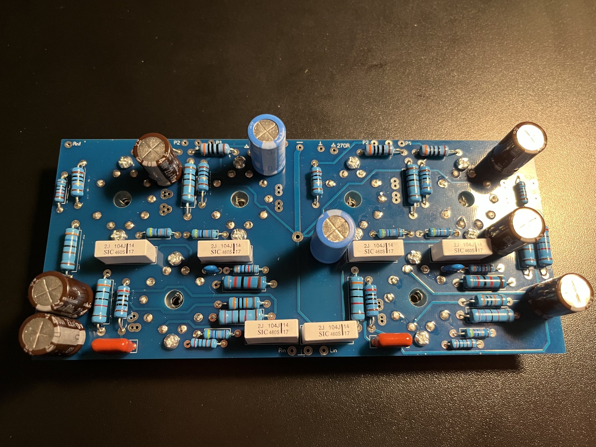

I picked up one of these kits as an intro to tube audio. I've done some solid state audio refurbs, and non-audio electronics builds, but am new to tubes.
I have the board assembled, following the labels on the board. I used Nichicon electrolytics to replace the off brand caps that came with the kit. Forgot to order Wimas to replace the supplied film caps, but can swap those later.
The layout seems slightly different from what's been posted previously.

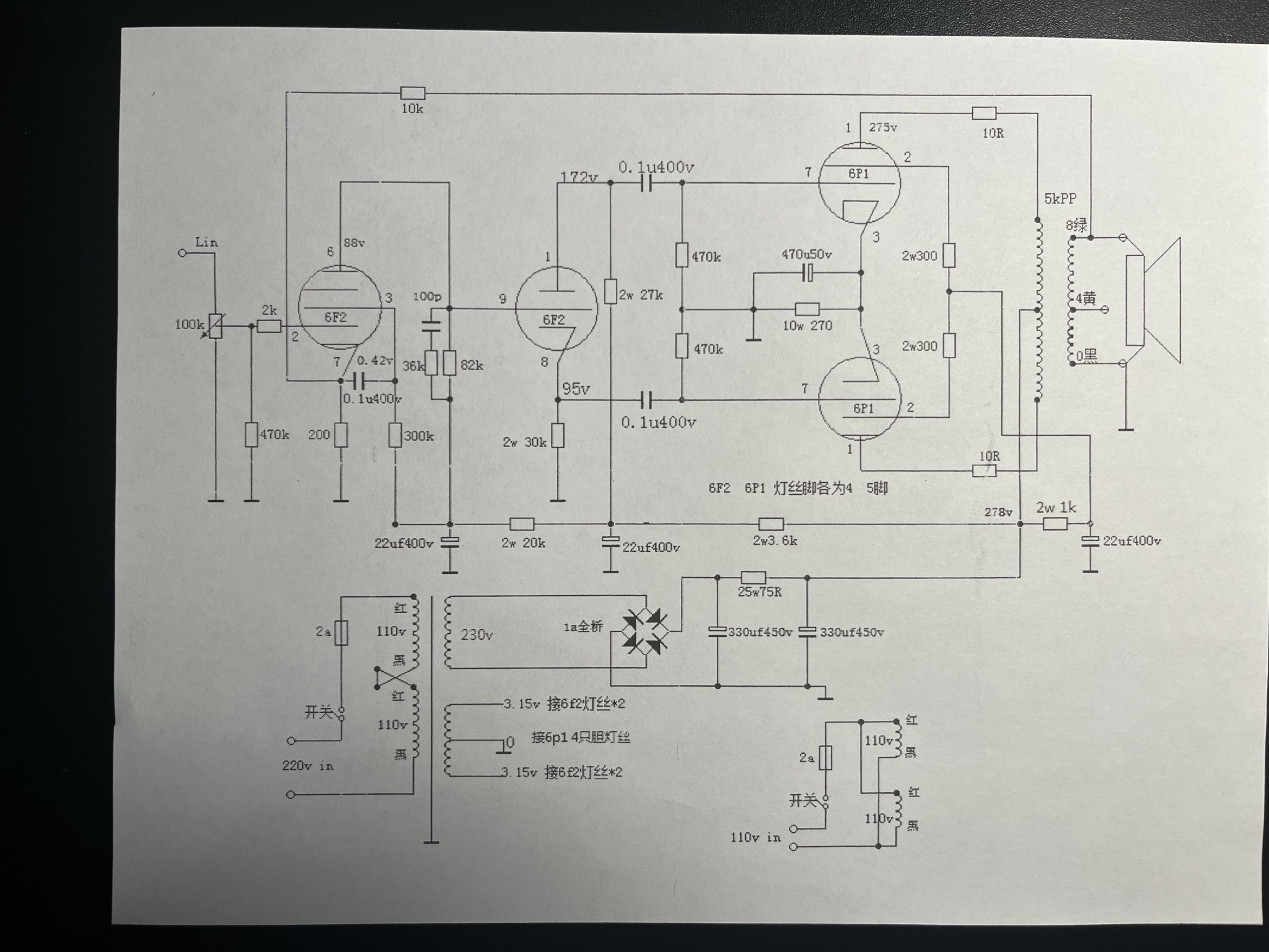

Here's the supplied schematic:

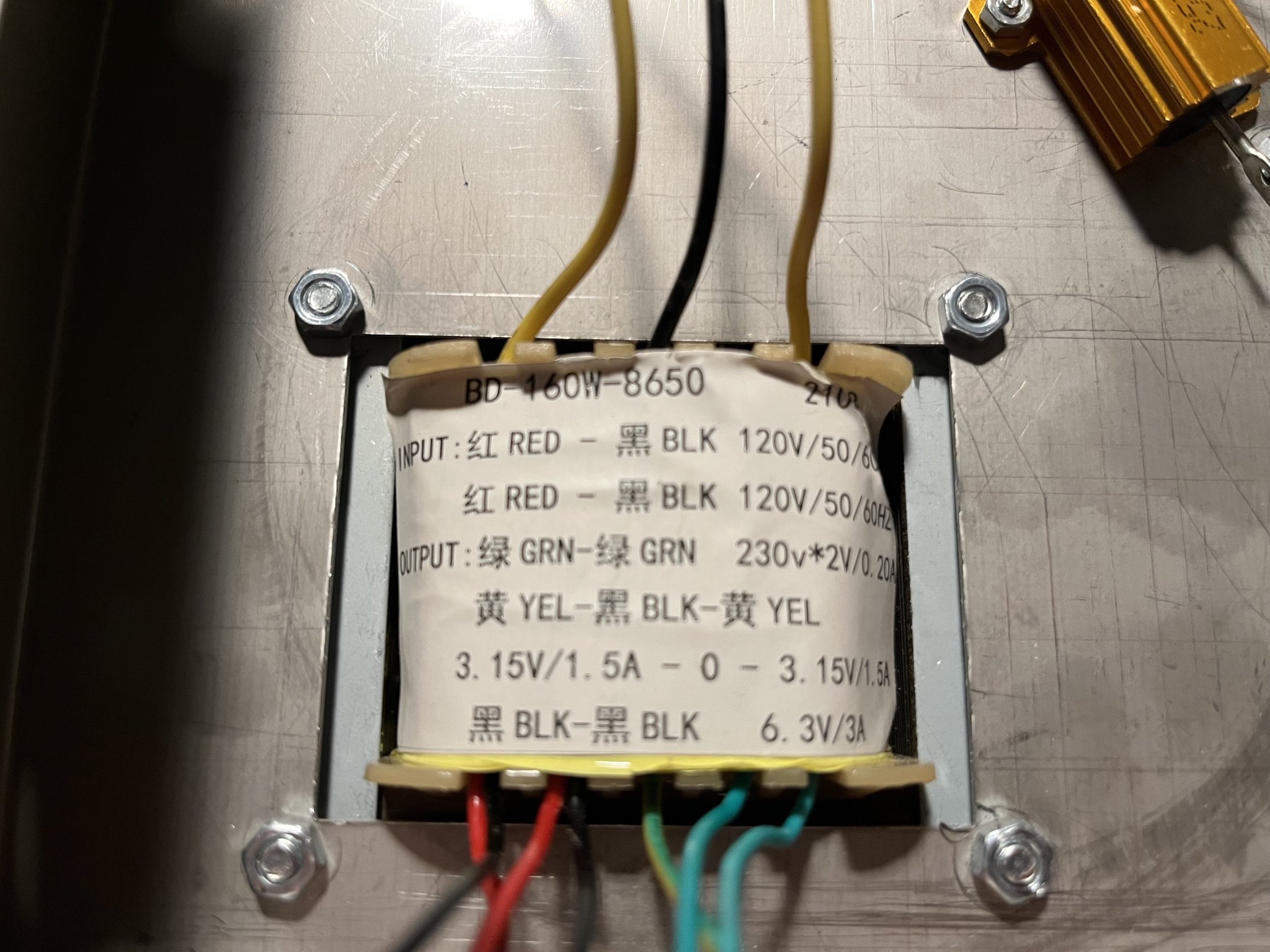

The transformer is labeled for 120v, which is good (if true) considering previous posters appear to have units wound for 110v. Beyond that, things get a little weird.
For input they list red - black & red - black. Do I just bond the two blacks and two reds for input?
For output, they list green - green, which is fine. According to the schematic, these go to the rectifier. But there's an unlisted yellow/green wire also.
Next on the label is yellow - black - yellow at 3.15v - 0 - 3.15v. Not sure what happens with these. Would seem to be for heaters, but not enough voltage? Schematic shows the black wire as being grounded?
Last on the label is Black/Black at 6.3v, which would be used for the tube heaters, but these wires don't exist.

Yes , for 120V the two windings are in parallel , for 240V in seriesFor input they list red - black & red - black. Do I just bond the two blacks and two reds for input?
Between ends you have 2 x 3,15V for filaments , the middle tap 0 should be connected to ground.Next on the label is yellow - black - yellow at 3.15v - 0 - 3.15v. Not sure what happens with these. Would seem to be for heaters, but not enough voltage? Schematic shows the black wire as being grounded?
Mine is the same. The only diff from the schematic is there are 2 dc-blocking caps added on the input that are not shown on the schematic.The layout seems slightly different from what's been posted previously.
The green/yellow wire from the power tranny goes to a solid chassis earth.
My power tranny only has the yellow-black-yellow heater wires (3.15V x 2 = 6.3V) so I used those for all heaters and no prob. Just check your heater voltage when you first power it up to make sure its in spec.
