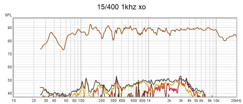

Fane FC-153F01 has copper shorting ring, has to be full lenght copper sleeve because the impedance is 25ohm at 20khz. H3 performance as good as it gets, stays under -60dB/0,1% even at 1khz region where H3/H5 usually rise.
8pcs of these bang quite snappy and coherently in a sealed line array subs😛
Measured with a SE-UL tube amp with only cathode feedback.
Got 8pcs of the little brothers of the Fane FC-153F01, the Fane FC-123F02. Appaers to be the same motor driving a different cone.
Here's the H3 comparison of out-of-box FC-123F02 vs. couple of month used FC-153F01. The 12" is without a box "naked", the 15" is in a closed box. Mic distance is 5cm to dust cap. Drive level is the same, something less than a watt. H3 does not get much higher (relatively to signal) with increased drive level so this "motor's inductive distortion" which the H3 (and H5) represents, can be measured with low amplitude quite good in the mid band.
These are made with a SE tube amp with no feedback. With a fully voltage source amp, ie. normal sand amp, the H3 might rise couple dB's.
Without the harmonic freq as ref:

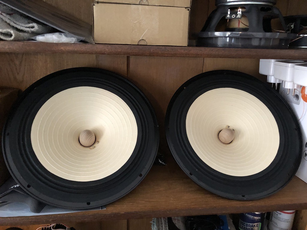

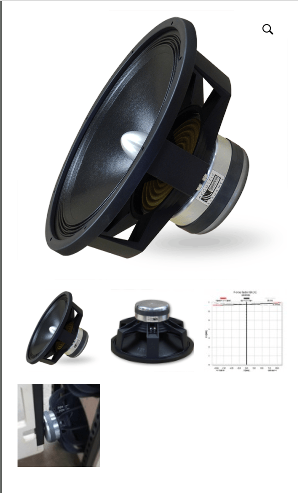

Hi all, i did not read all of the posts of this thread so carefully, but i am wondering about the following:
in very old days there was woofer chassis with large dimensions for studio and HiFi use. Nowadays almost all of them are not in production anymore. The only large woofer chassis still in production are ultra low resonance frequency subwoofer chassis with low efficiency. I have built a long long time ago a 400 - 500 liter Sub with 2 15 inch Fostex FW 400 driver, very low resonance frequency about 27 Hz and a very low mechanical resistance foam surround driven with a Nacamichi EC-100 active crossover and some kind of diy MOS FET power amp modules for a diy power amp. I have never heard such an accurate bass response in a room of mine at home since then.
I have bought a pair of Sonido SW 400 15 inch chassis some years ago, but they are not the caliber of the old Fostex FW 400. I am using them in an open baffle sub construction. Sonido in Hungary do not sell them anymore either. There is an offer is the U.S.:
Acoustic Elegance Speakers
I like the build quality and the parameters, i am wondering is someone here could get his fingers on them, here a picture:
