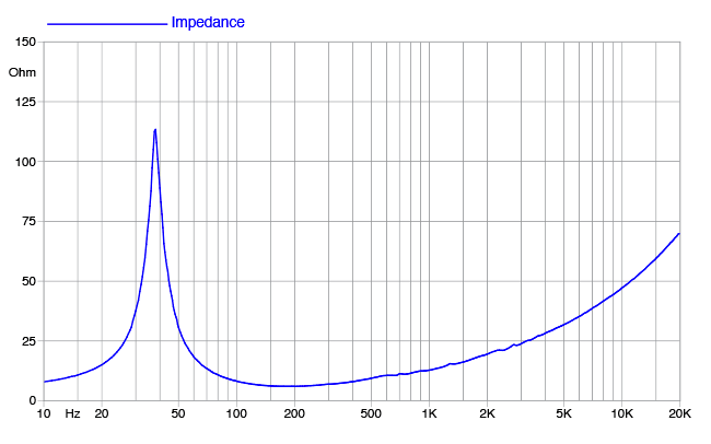

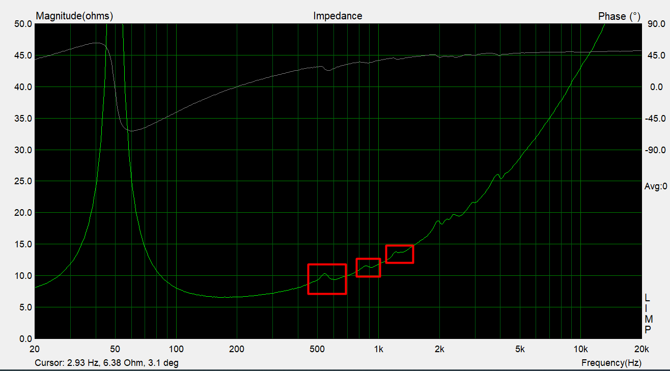

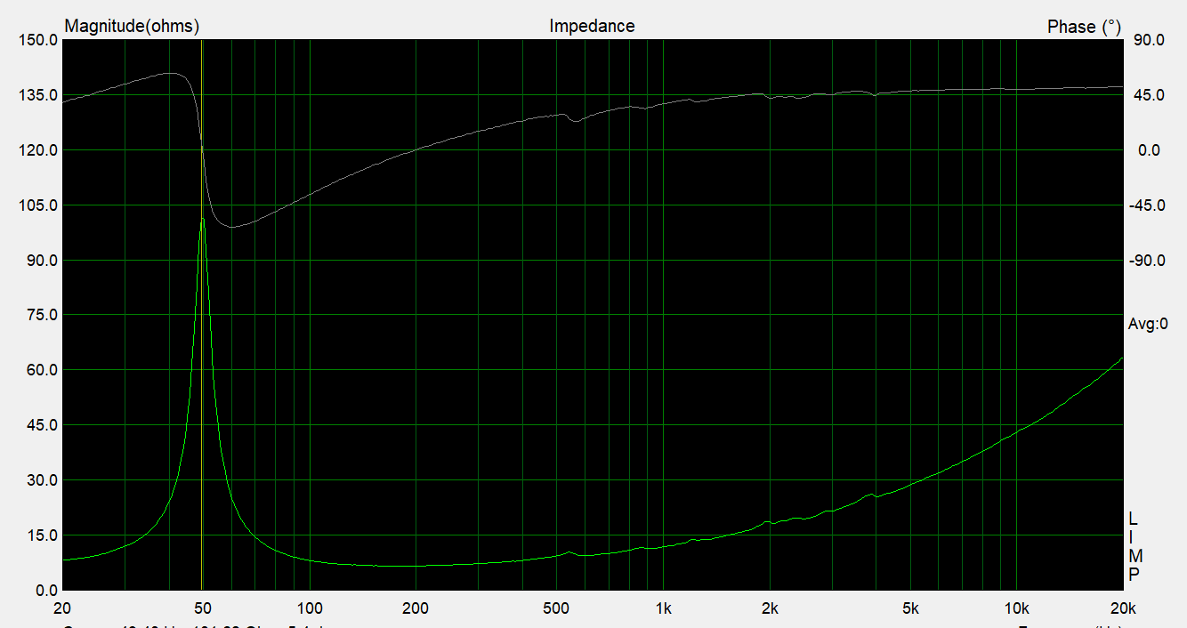

Manufacturer datasheets yeah, or preferably measured impedance by yourself or some other independent party. Here is example of 15fh520 impedance measurement I took when I bought them. Can't remember if this is free air or in box, probably some sort of free air. The blips are some form of resonance and I think the surround resonance is the lowest one, here around 550Hz. They are hardly visible in the manufacturer datasheet though. To my knowledge every driver has them, the edge resonance for example and eventual cone breakup, but is better or worse and higher or lower in frequency depending on cone diameter, shape, material, and all sorts of other things I'am not able to imagine with current knowledge. Perhaps ear can tell the difference, even if EQ was used to make two driver response the same. It would only make sense to choose better behaving one but getting the data to compare with might mean buying them all.
Anyway, these are my first measurements and might contain error but anyway you now know what the blips look like. Note also how the free air resonance is around 48Hz instead of 36Hz in datasheet.
