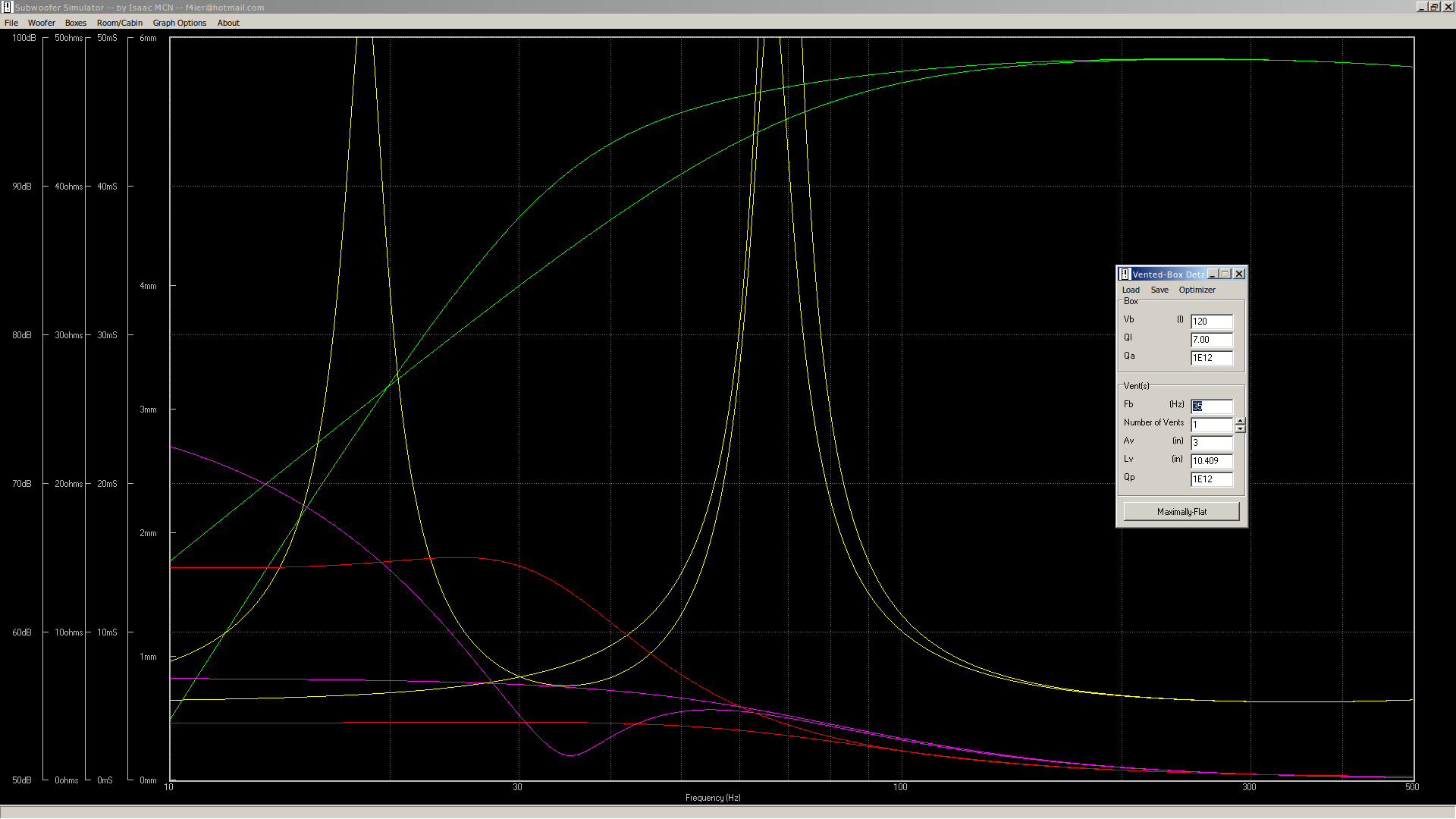

Quick-and-dirty vented and sealed sim for 15PR400, done on Subwoofer Simulator.
80L box for sealed, 120L for vented. I'm not sure what the units are for the vent dimensions, so you'll just have to double check.
I gave up with the 15FH510, but it looks like it might be aimed at pro tuning somewhere under <80L rather than bass extension.
It depends on what your goals are, but if I had to choose for myself, I would go for the 15PR400, based on:
-shorter voice coil, lower Le, impedance exceeds 20 ohms @ 5kHz vs 2kHz, lower cone mass all suggesting cleaner mid-range extension,
-the sealed option. It loses 4dB across a wide range, but it saves hassle with vent performance not meeting expectations, and infra-bass comes back.

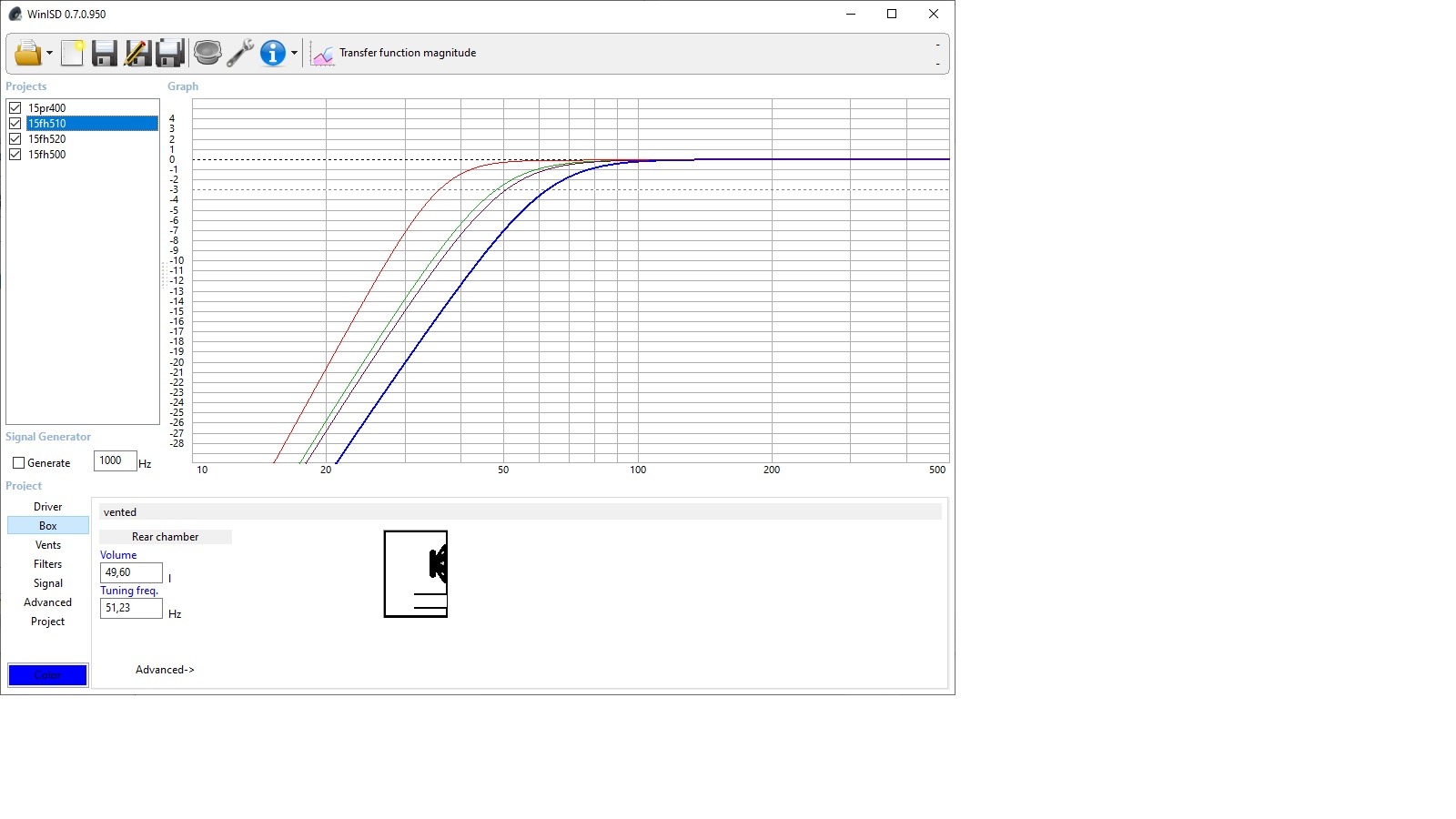

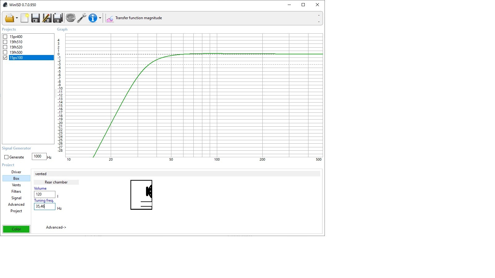

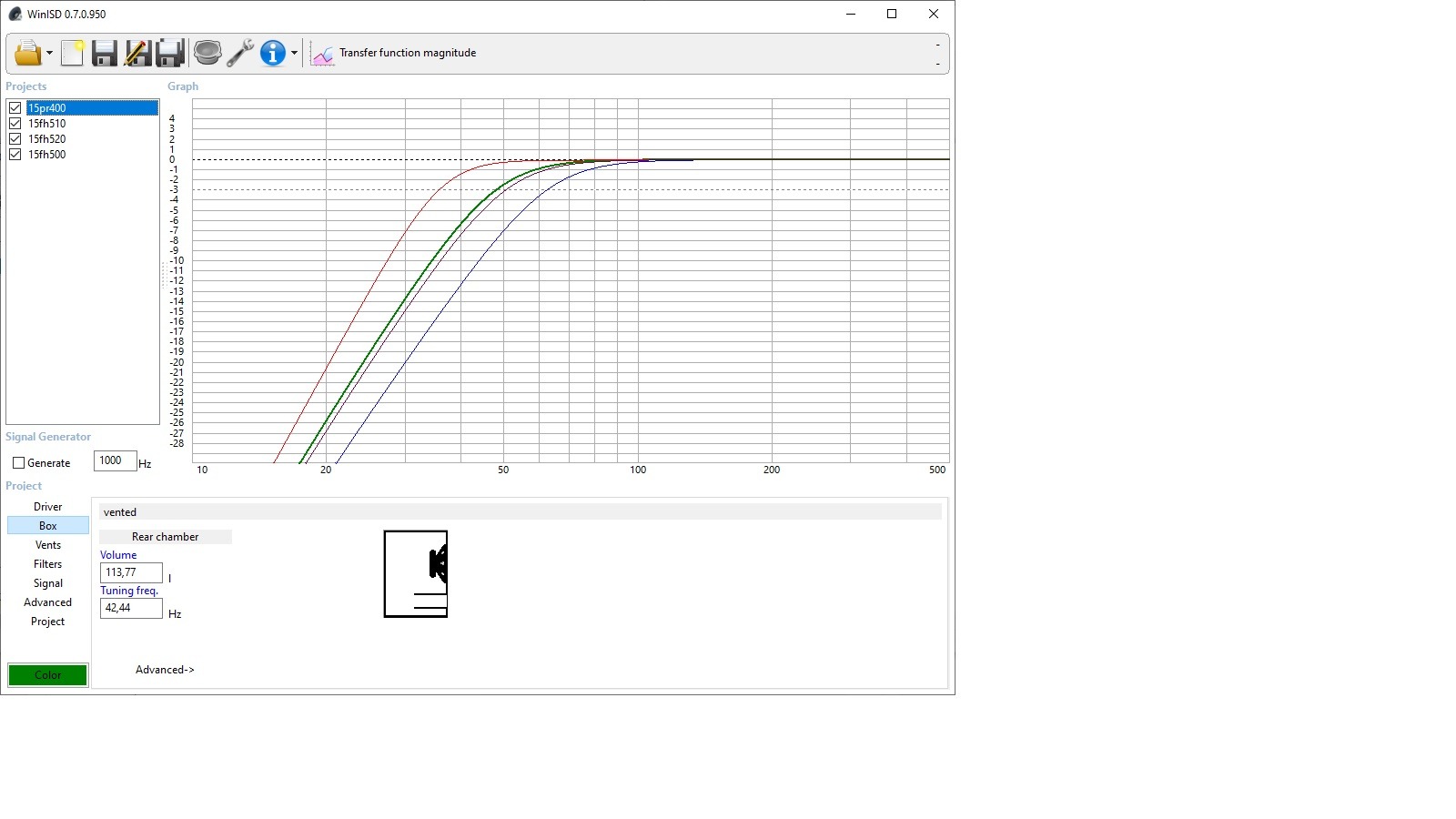

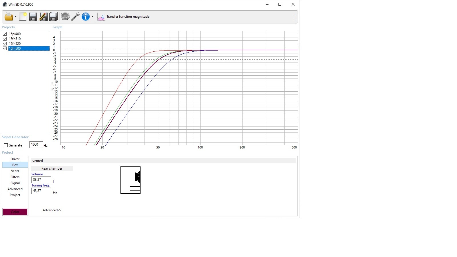

I have run some winisd simulations, I enter the TS parameters and then I choose Butterworth vented box, interesting stuff...
15PR400 113l QTS 0.32
15fh510 50l QTS 0.26
15fh520 180l QTS 0.39
15fh500 83l QTS 0.310 and actually close to 15pr400...
This confirms that high QTS will naturally go lower in a bigger box
low QTS don't go very low naturally
QTS 0.30-0.33 are the best choise if you intend to use a ported 120l cab which is my case. They can go low enough I think.

Try them all in similar size enclosure, for example the 120l. There won't be mucho difference, db here or there in the transfer function graph I suspect. Then check the other graphs like cone excursion and SPL with amplifier power you intend to use to see which one satisfies the SPL / extension requirement you possibly have or would like. If all of them qualify with SPL and extension you could test how small of a box works. If not any of them qualifies you'll need bigger box or bigger amplifier. Basically, when the size is limited the compromise is between SPL and extension. Simplified, lower efficiency heavy moving mass cones will play lower in smaller box but not as loud.
Figure out your SPL target you need to reach with the woofer, and then compare the box size and extension against that with amplifier power you have available. I suspect all of them drivers can satisfy your SPL target if the box size and amplifier power is not limited. In this case the extension could be the limit, and to cure that use more and/or bigger drivers.
It all revolves around the size / SPL / extension trinity 😀

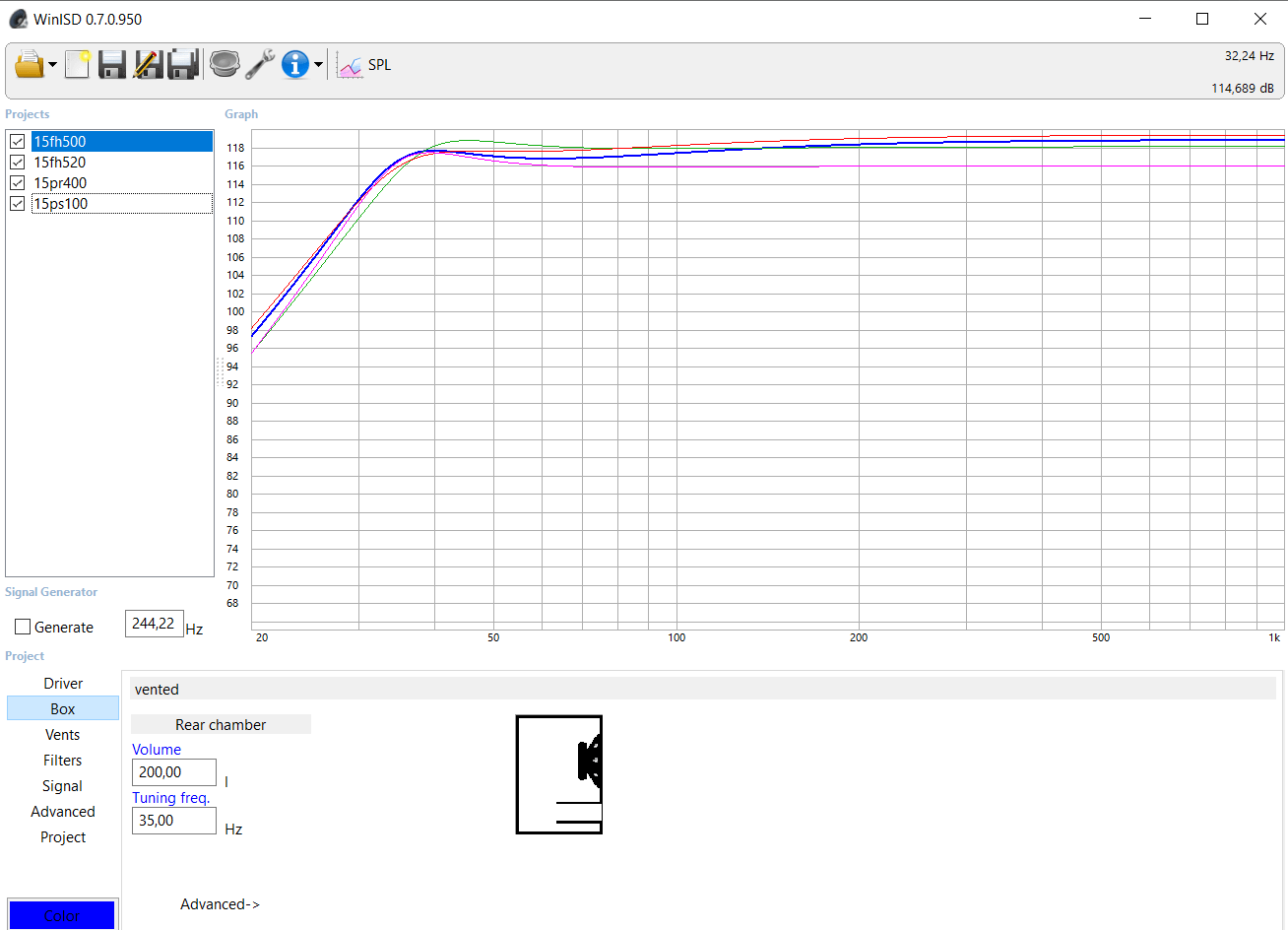

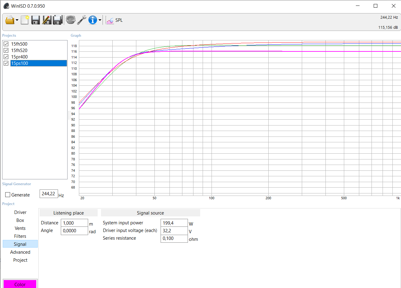

edit, here is 4 of the drivers, all in 120l enclosure with ~fs tuning (what winISD automatically suggested). 200W of power would have all of them play 115db at 40Hz. There are some difference higher up, db or two. Room would introduce +-10db stuff over these nice graphs 😉

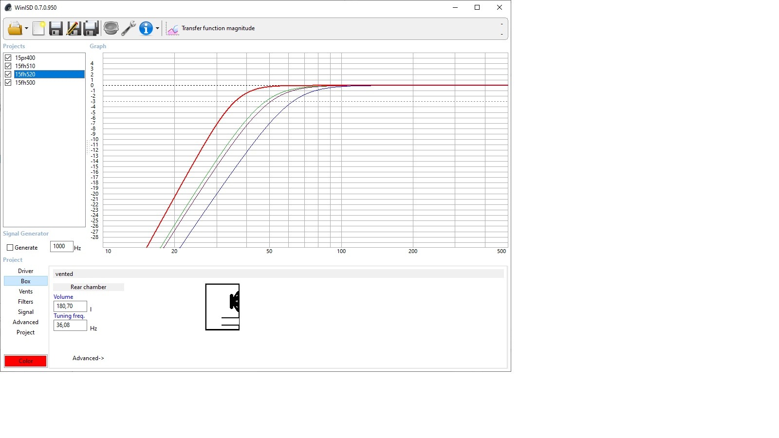

Here them all in 200l box, more extension, again db or two differences between all of them.

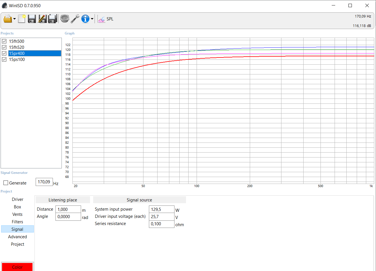

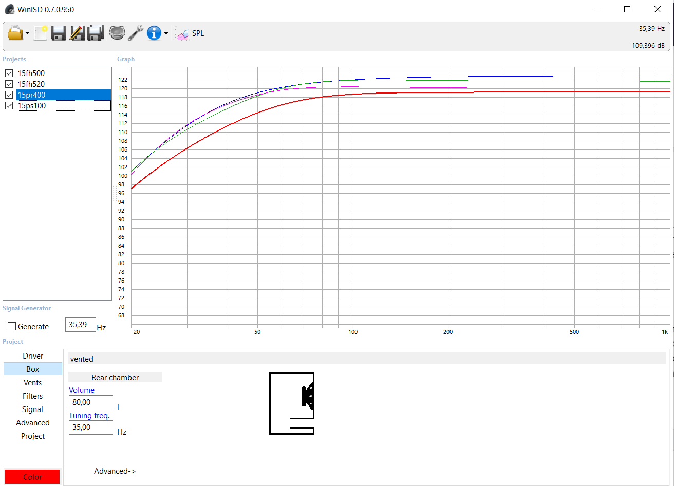

There is more difference with maximum performance, if box size is again 120l the 15pr400 xmax limits the performance. The others work fine, only need more power to get the higher SPL. Only 120W makes the 15pr400 to reach excursion limit so the previous examples wouldn't work out for it.
Reactions: jawen
^ edit time over. on the last image all fs was set to 35Hz. Here comparison if box was 80l and max power before xmax. All of the drivers get to ~35Hz 115db except the 15pr400.
Basically, for home use, there are not that much difference between the various 15" drivers considering the low frequency extension/SPL assuming reaching maximum SPL is not needed. If maximum SPL was required for given sized box then there might be need for more careful consideration. For example the 15pr400 might not suit all cases. Or, if you had particularly small amplifier then you could pick a driver that is suitable compromise between efficiency (max SPL from the amplifier) and extension.
Above drivers perform about the same, but the 15pr400 lags behind on max performance due to less xmax.
