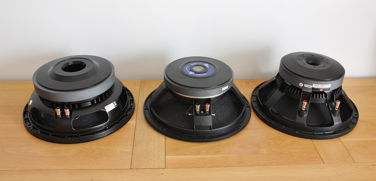

Interesting comparison of three professional 12" woofers.
The 'traditional' Beyma holds up fairly well against the more expensive BMS and 18Sound which have shorting rings.
