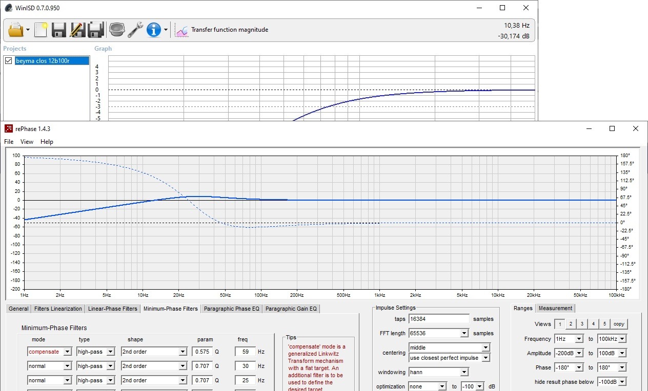

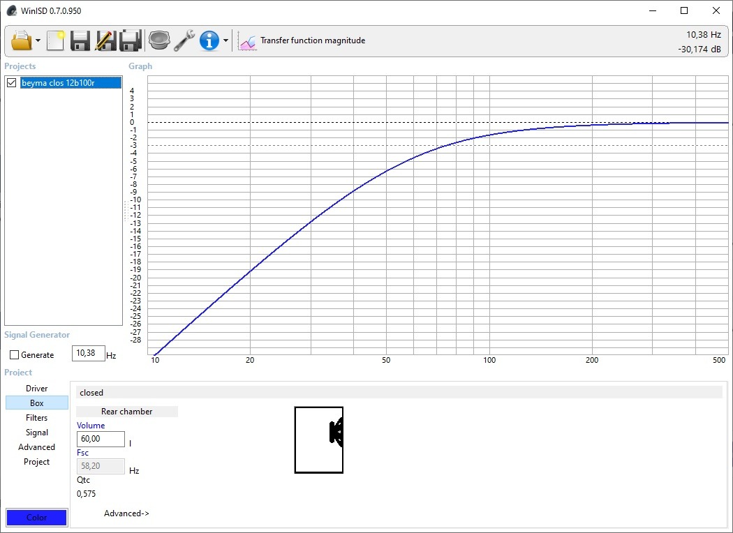

Well,
Put sox in the vents.
Used winisd to see what was fc and qtc
put that in rephase correction mode, quickly read a french tutorial, generated convolution impulse
load it in vst convolver
First time it crashed, it is sensitive to sample rates ! I was worried I broke something damnit !
Reloaded, with a traditional 44.1 khz mode...
It seems to work !
Of course all the gains and delays between the lows mids and highs are to be done again...
I will check if it is stable first and if it works at 96khz first
