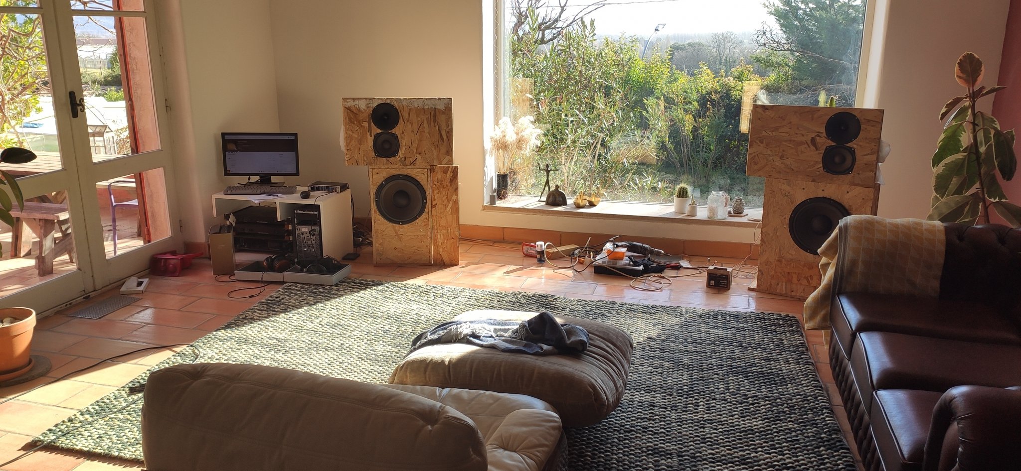

Pro woofers with high-end hifi specs
BC 6md38 on wide open baffle with big waveguided tweeter, digital filtering and Tri amp, xo 300, 2500.
For the lows, I got ported beyma 12 b100r...
I'd like to try something bigger and better and perhaps sealed...
I have rme soundcard, mic, rew...
I'd like something that could perform 40-300
I read that you recommend inwall which I can't do but I think wide baffle are a good intermediate.
I think some faital 15fh5xx could work, what do you think?
Shall I look for low QTS, high bl/MMS ratio or something more like a 0.4 QTS ?
Theoretically what would be the eq for that?
Room is big, 5*10 with ceiling going from 2.5 to 6m, but listening position is set in a 2.8m triangle, ceiling starting at 2.5m and going upwards..."

Attached, wife at work, kids at school, dad playing lol

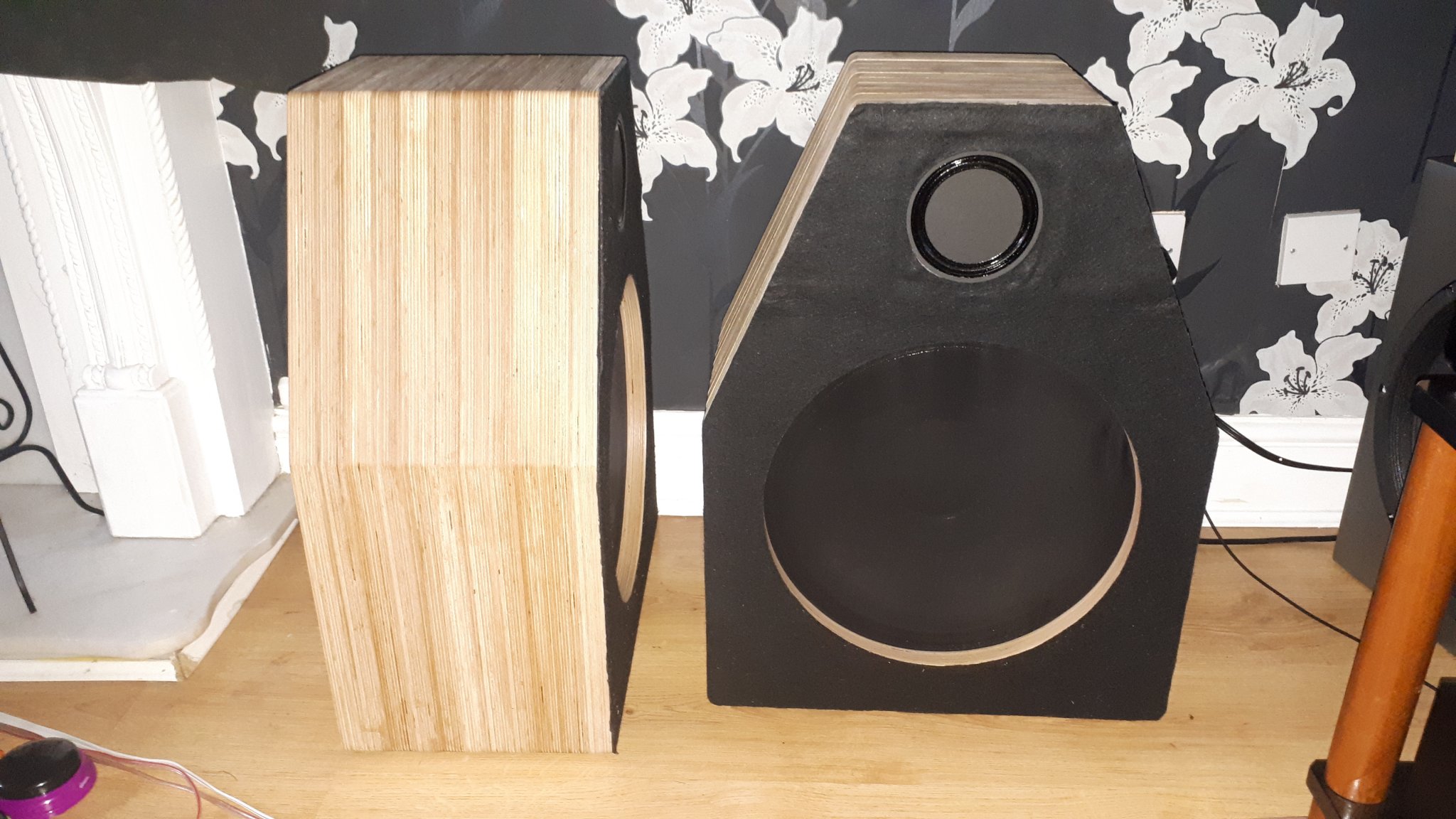

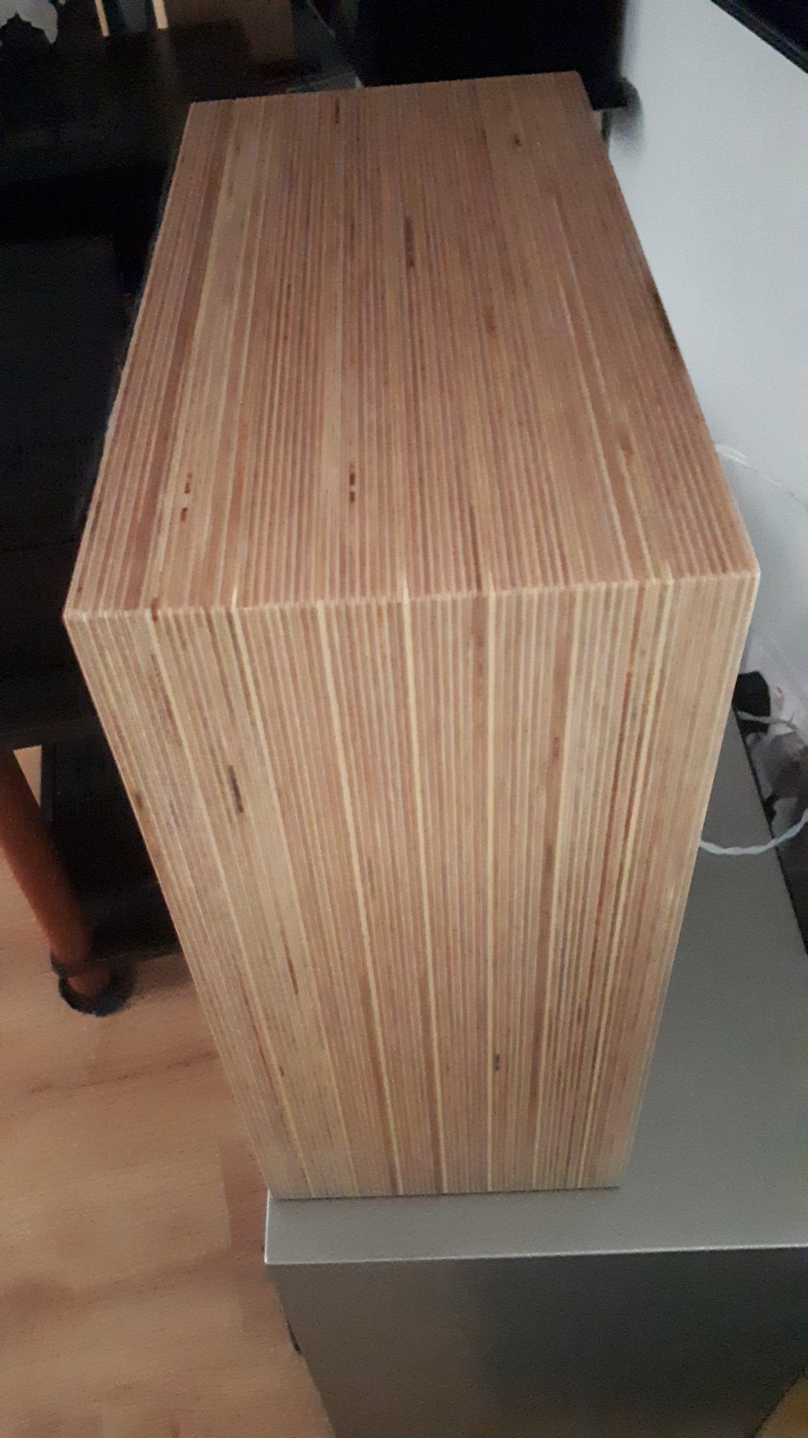

Hey Greg,
Re your question about cabinet shape/resonance, I think its very important to minimise cabinet resonance, here are a few thoughts:
(1) Asymmetry is great, symmetry is bad. ie the worst cabinet shape is a cube and a trapezoid or curved shape is best.
(2) Use birch ply, not MDF!
(3) Dont build a "box"! Build up a laminated / layered cabinet for a true inert non resonant structure. (See attached pics)
(4) Calculate internal volume required, plus the air volume the driver takes up then add 10% to 20%. This allows you to apply internal cabinet damping material and/or internal stuffing. ("Twaron" or Angel Hair is very good).
(5) Also use up the extra air volume by gluing in place some acoustic foam wedges inside your cabinet ie turn the internal air space into a mini anechoic chamber.
(6) Numbers (4) and (5) are very important in the mid and high frequencies, less so in the bass. The bass cabinet requires mass and rigidity.
(7) Ratio of cone weight to cabinet weight is important ie If your 15 inch cone weighs 100g and its being powered by 500 watts its "pumping" in and out at 20 to approx 150 times a second.... If you calculate the stop/start energy and remember "for every action there is an equal and opposite reaction..." All that energy will rock a light cabinet back and forward and the panels will radiate more sound than the cone! My ref is the bass cabinet needs to weigh at least 400 times the Mms of the cone ie a 15 inch /100g cone needs a solid cabinet of at least 40Kg avoid the worst of the resonance issues.
(8) Really strong spikes are needed to anchor the bass cabinet to the floor. Then use "Sorbothane" pads (not more spikes!) to mount the mids and treble cabinets on top.
Cheers
A.

Hello,
Thanks, waiting for your answer I was getting some information...
As space is not an issue here and regarding the fact that sealed enclosure require less volume, what i will do :
Bigger rectangular box.
Inside double walls, not parallel of course, filled with sand. Or ceramic tiles, of debrees from all the stuff used for the house...
Brace behind the speaker with Dacron, polyester thin cloth stitched to it.
Fill behind with rockwool or melamine foam (expensive). Or acoustic foam wedges as you describe to create an anechoic chamber...
OSB could be a cheaper alternative to plywood which is insanely expensive here...?
3/ didn't understand, or what I understand is a lot of loss, expensive lol
4/ I read opposite as filling the box will artificially increase the volume. Also that smaller boxes have resonances which tend to go beyond bandwidth usage...
