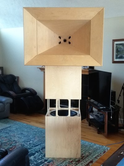

I was recently contemplating doing my 4 new surrounds with 2226 and 2446 with Radian Al phragms (have all the drivers already) on Yuichi A290s. Might still, but I have another design I like better so far.
The first, then tweak. The new surrounds I mentioned in the last post will be sealed 2226s LT'd in a 3 way.By the way for your compensation, do you tune a LT and a baffle step compensation or just the Lt and you finish with an eq?

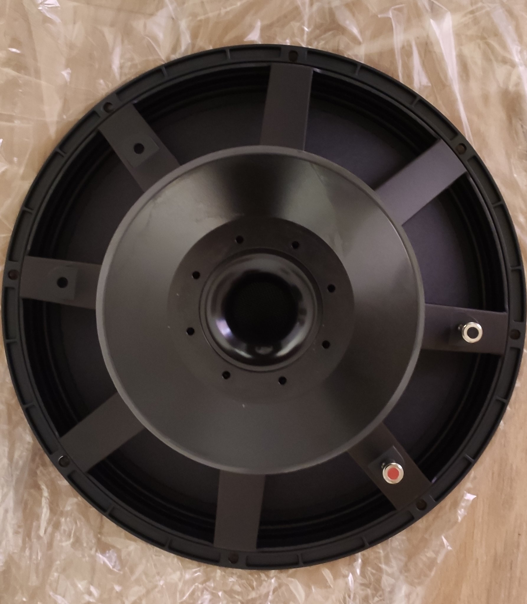

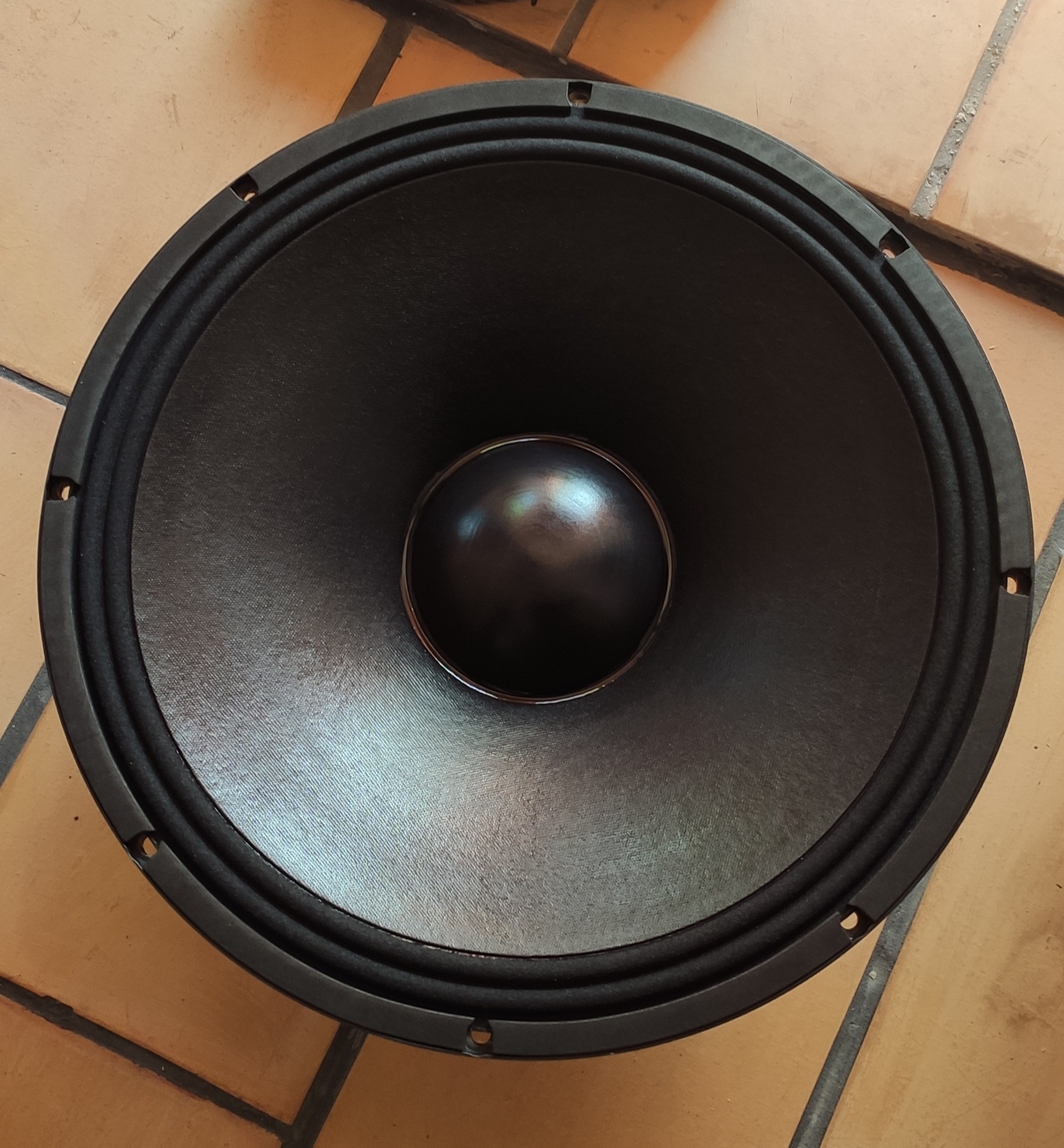

Hello, just to keep you updated about the BMS 15s330 and perhaps if someone Google's it someday will have a beginning of a review which I didn't.
I was hesitating with several drivers from faital but I thought that first picking similar speakers would give similar results, BMS was I think under estimated because less used by famous diyers (troels lol)...the price was a bargain so this definitely made my point. After I received them website increased price by 20%, I guess it was still pre COVID price lol...

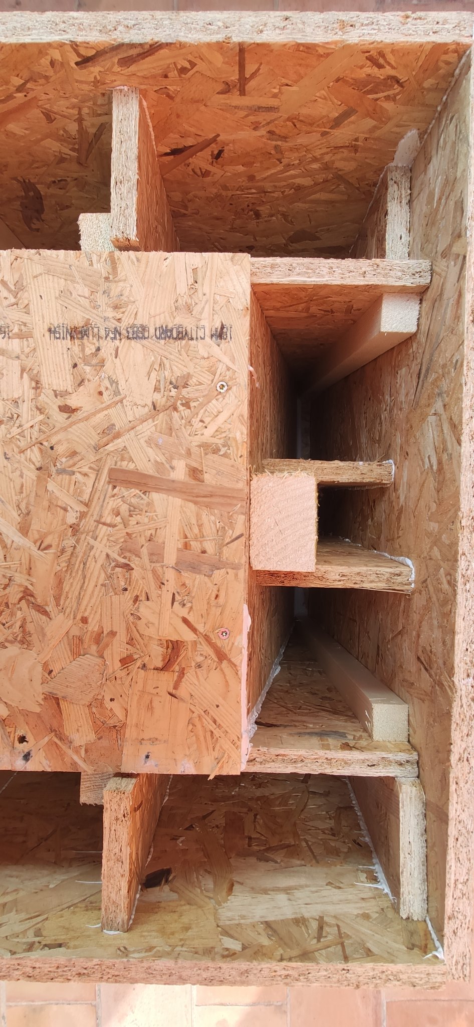

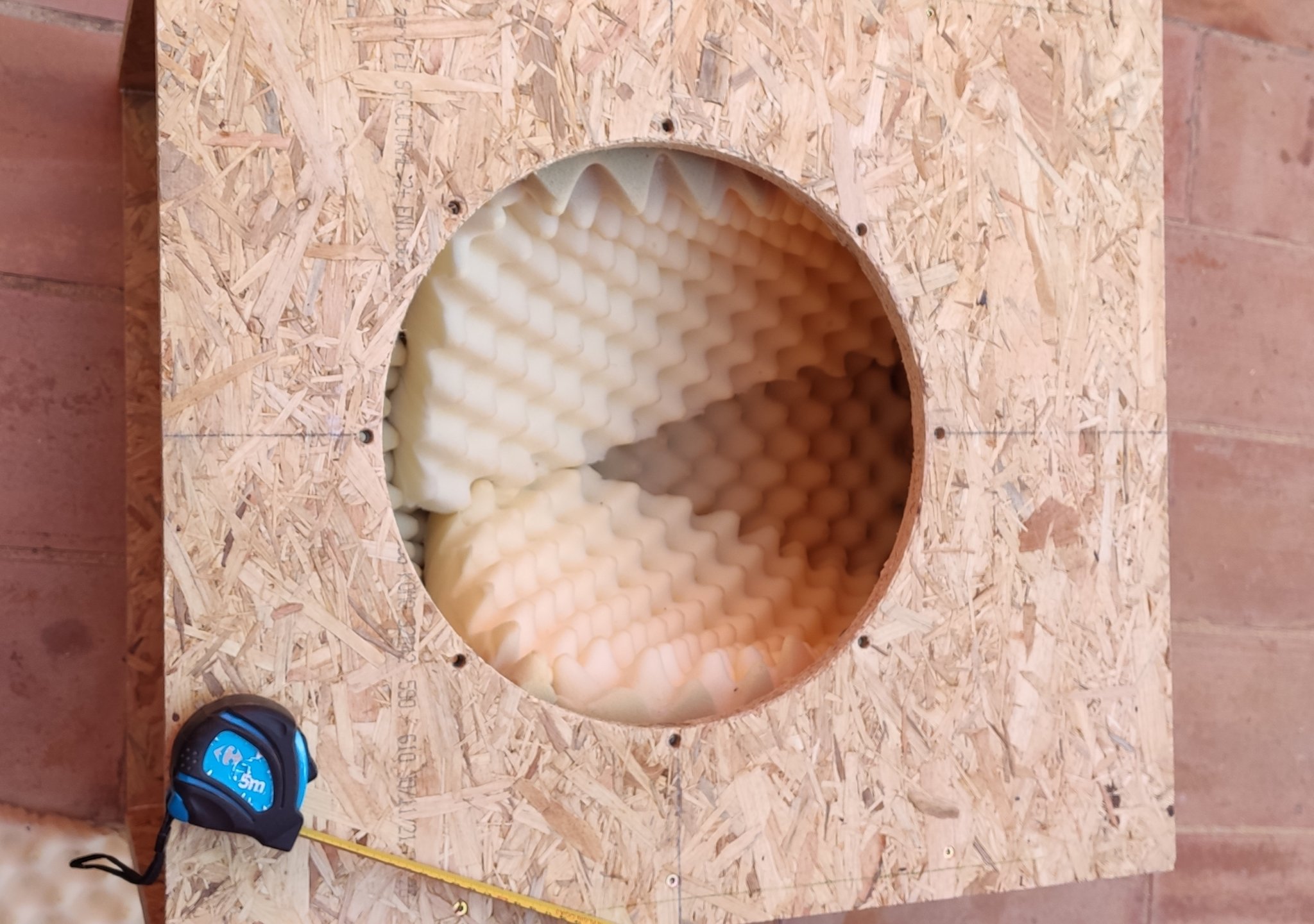

I made everything I could to create a good box, it is a kind of pyramid inside a box, 60l of air, 60l of sand. Foam from an old mattress was used inside.

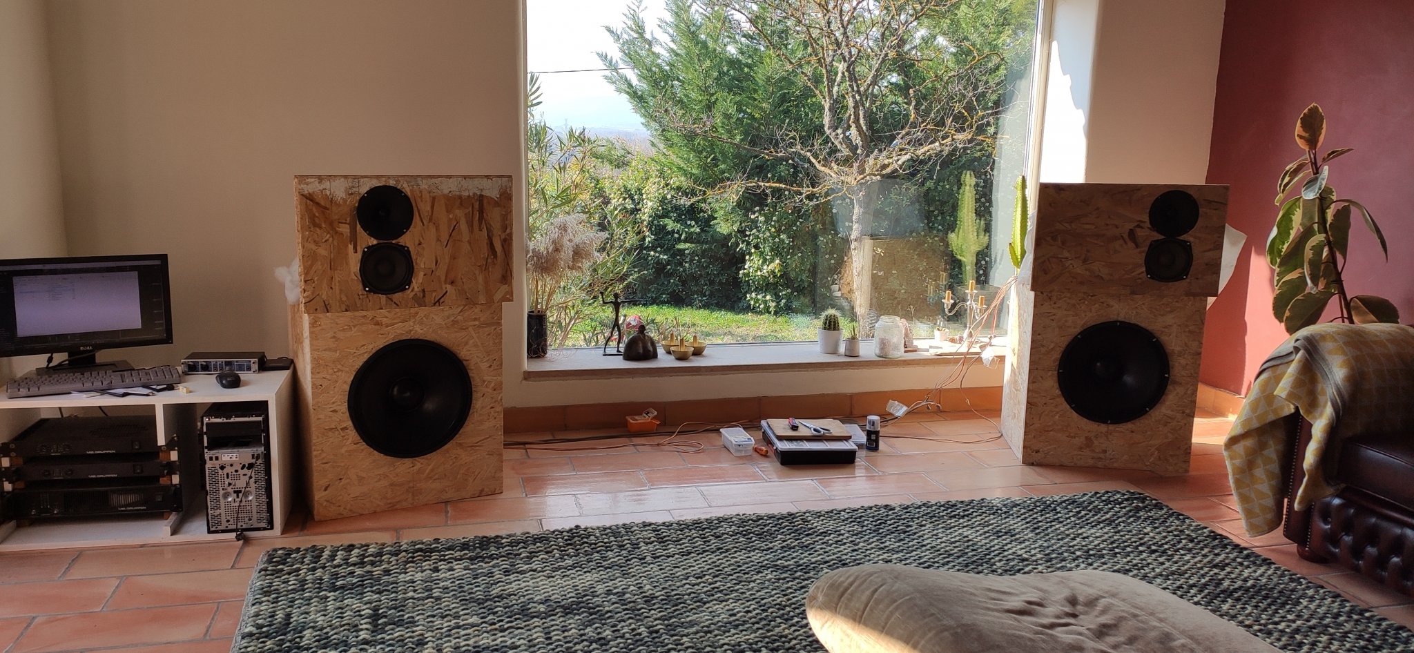

I plugged everything and was happy because it was not that different and the nasty problems I had were gone. I don't know what it was, resonances, distortion, box noises maybe all of them...
Then I listened more and noticed that everything was better, transient, impact, lower notes. Bass and drums stop when they have to stop and give impact when they have to...
I am sure that a 400hz is no problem for that guy.
I am happy I kept the idea of a 15" for that and not overspent in a 12 plus sub...
I am quite inspired by big genelec monitors, 1238a, I'd like something with the same waveguide...
So far so goods.
Thanks to all the people who helped.

Of course I need to put descent plywood on all surfaces but that's the idea...
It have not filled with sand yet but it is already quite good in terms of box noise...
