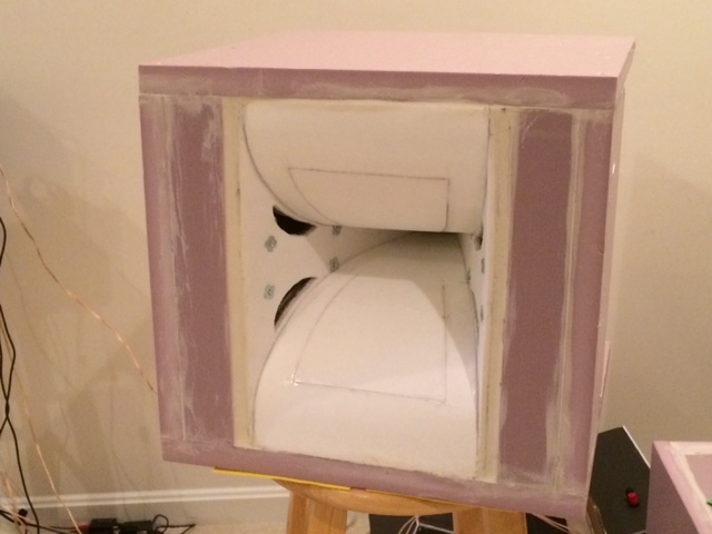

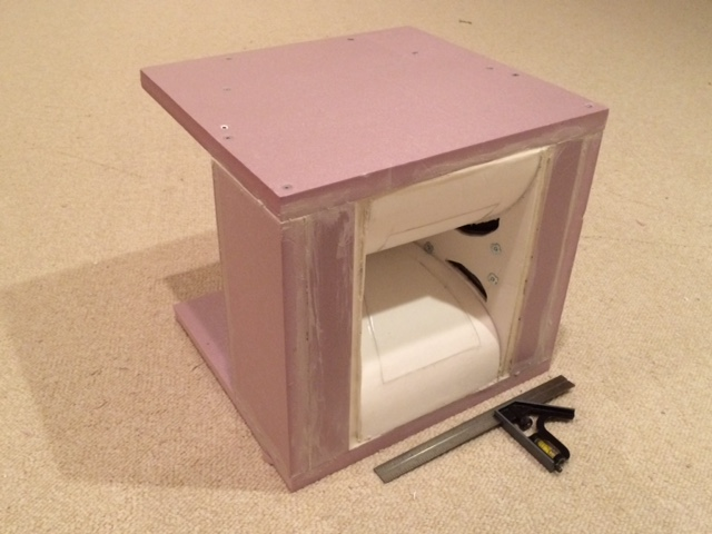

uTrynergy open back box

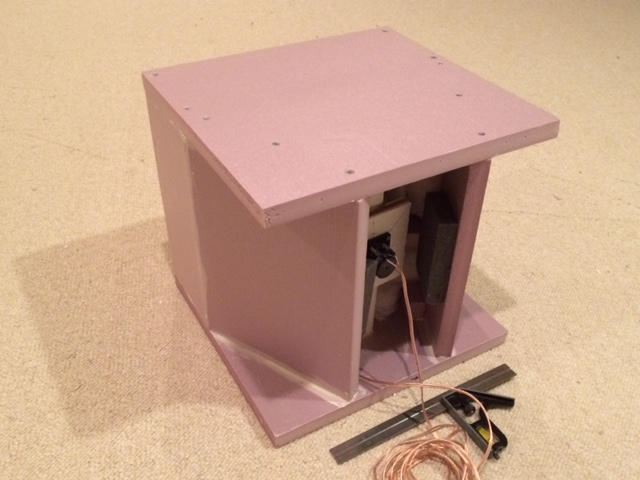

I was intending to make a sealed box, with the option to go bass reflex vented. In building it, I left the rear panel off for final install of a removable panel. So I turned it on and listened to it and the dipole bass really surprised me. In a way, it resembles a band pass slot loaded sub woofer with open U frame back. The full range mid/tweet is also free to radiate to the back too. Anyhow, the bass digs pretty deep and I can get about 90dB at 50Hz with only 2% HD. The cool thing is that as it is an "OB" woofer system, the group delay is very low - under 5ms at 50Hz.
Material is all 1in thick XPS "Foamular" from in 2ft x 2ft sheets at HD. Low VOC Liquid Nails adhesive and hot melt tack with some screws to clamp for curing. As it is still drying, I have it rotated 90deg to not put any shear stress on the (still wet) glue joints.
Here are photos:

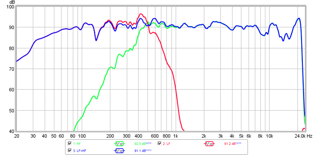

Here is measured acoustic XO (Harsch at 500Hz implemented with BW4 on LPF and LR2 on HPF with 0.92 ms delay):

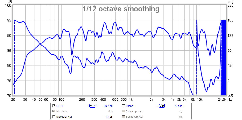

Here is phase:

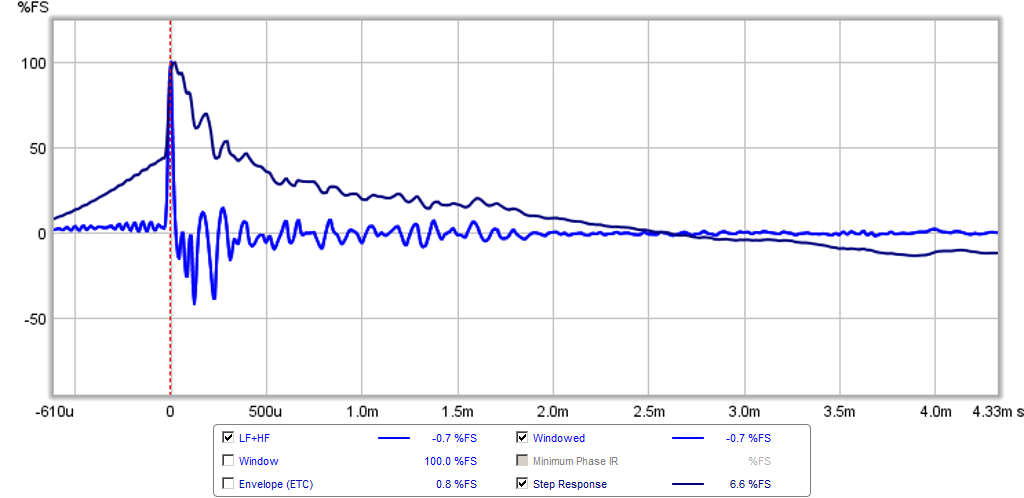

Here is impulse and step response, there is ringing but it is so fast (22kHz), it can't be heard and does not add sibillance:

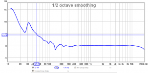

Here is group delay (with 1/2 oct smoothing for clarity) - 4.5ms at 50Hz:

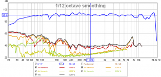

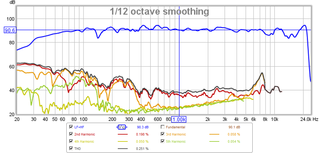

Here is distortion - not as low as the bigger Trynergy as the little Tang Band 2in driver has to move a bit more. At 1kHz getting 0.25% at 90dB and 2% at 50Hz. There is a nasty peak at 9kHz that I am not sure what it is caused by - still investigating. I think the foam core construction is causing the higher than general distortion in the lower octaves:

Ringing at 22kHz is likely a measurement artifact -- any time you convert from frequency domain to time domain (such freq response to impulse response, as done in log-sweep measurements), you will see apparent "ringing" at the frequency where the data in the frequency response stops. The FFT processes as if the data above the highest frequency just goes to -infinitydB, which would be a bad brickwall response that rings. In reality, the system just doesn't know what the response is above about 22kHz, it likely droops then rolls off in a minimum phase nature, without the artificial ringing.
This happens with speakers that still have output beyond half the sample rate. The ringing COULD be real, if the driver drops like a rock there (was it EQ'd using a big resonant peak?), but I would be suspicious.
Bwaslo,
Thanks - good to know. I do see a peak on the frequency response at the 22kHz though and sort of matches the rising peak from manufacturer's data (which stops at 20kHz but peak shoulder, with apparent peak at 20k is still visible).
https://www.parts-express.com/pedocs/specs/264-808-tang-band-w2-852sh-specifications-45644.pdf

Looks very nice, I have a open baffle and now why it sounds so well, so open, and the idea of a dipole like back is worth experimenting.
My wil be bigger, but think about make a smaller one like you did, it is more easy to put somewhere.
It is also interesting to close the back and listen again, the dipole peak can give trouble higher up.

Ringing looks like pc runs out, higher then 22 Khz it get trouble.

although the tri-square gives a relative idea of size what is the overall size of the trynergy?
This statement is nonsense.
HF peaking is due to driver, and how it reacts with horn.
Time domain and frequency domain contain exact same information.
