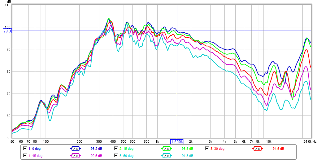

Horizontal polar of uTrynergy w/ W2-852SH
Taken at 1.0m. Note that response seems peakier than previous measurement in vertical orientation at 0 deg. I am hypothesizing that it may be because the liquid nails adhesive between the two layers of foam core hardened and the walls are stiffer. Or it may be that the curved wall does not flow into the flat baffle of the speaker that it sat on so there is an abrupt edge for diffraction (probably more likely - can be tested by flipping back to vertical to see if same). Seems more uniform of a behavior up to 12kHz.

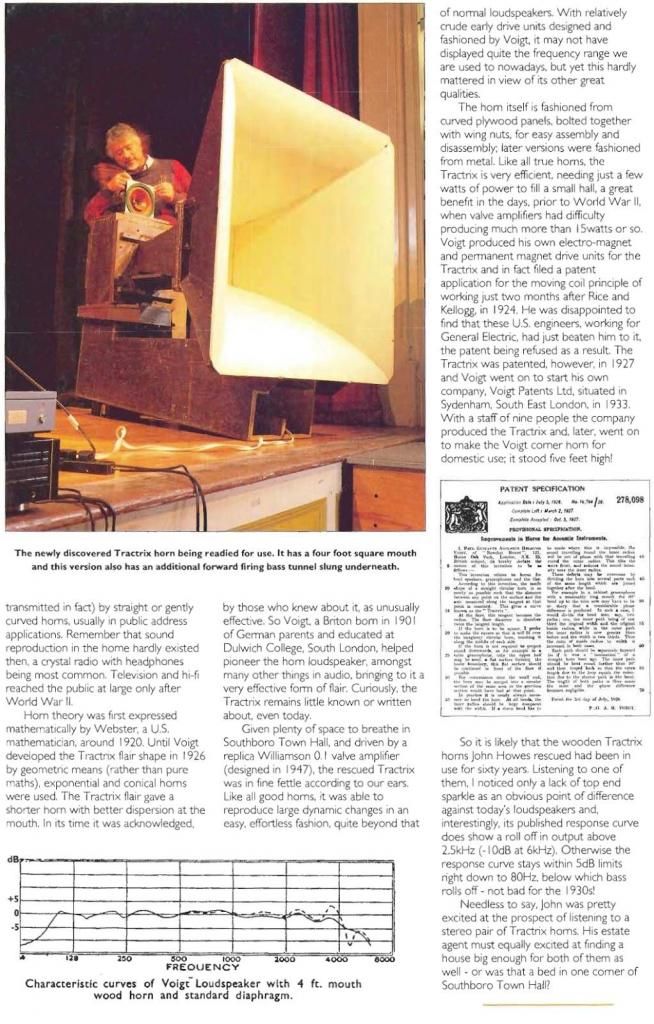

I just ran into these old pix of Tractrix horns driven by fullrange cones (though no Synergy woofers). So, some history, here!
(link: pink fish media - View Single Post - Western Electric's first hifi speaker
these are Voight horns, not Western Electric as the link's name suggests
Thanks for the history Bwaslo. I know how efficient they are first hand. Just a few watts is all you need and the dynamics are amazing.
