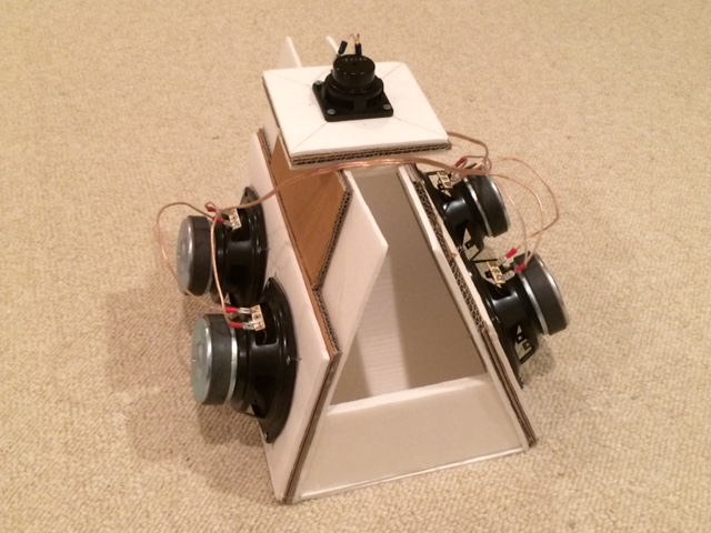

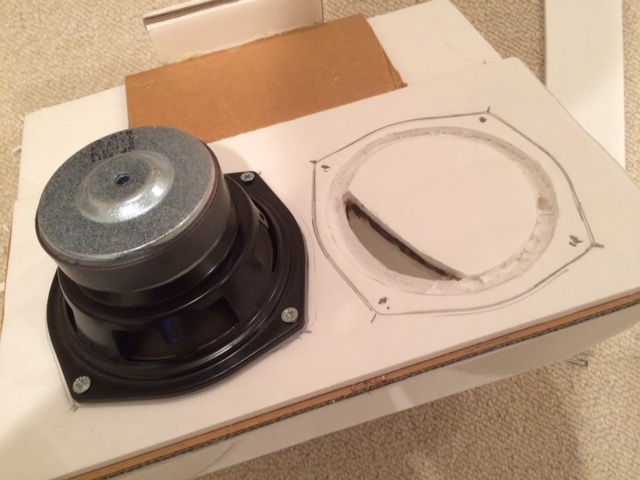

Woofer installation

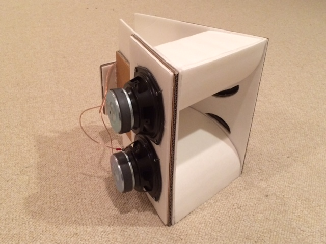

I found some time to install the four 5.25in buyout woofers today. Detail shows how ring of foam core removed to provide clearance for rubber surround:
micro Trynergy with woofers installed:
Rear view showing full range W2-852SH and woofers:

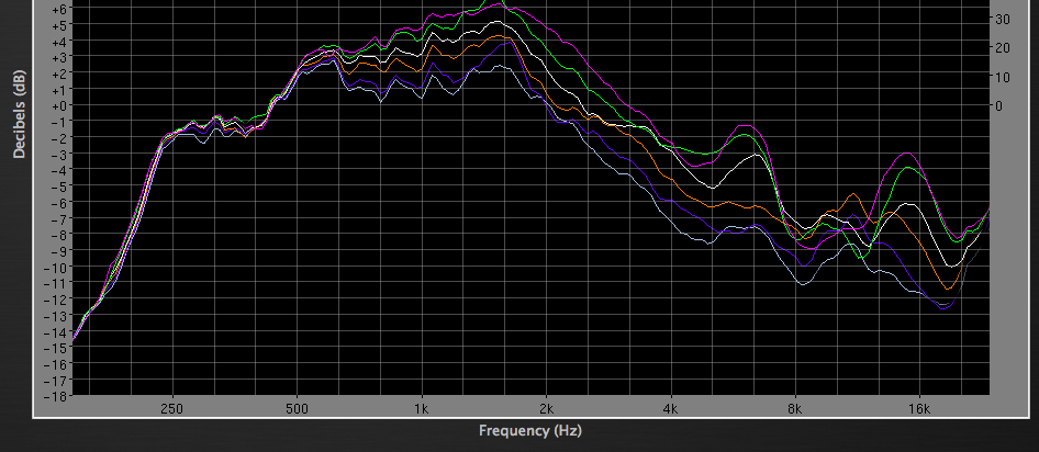

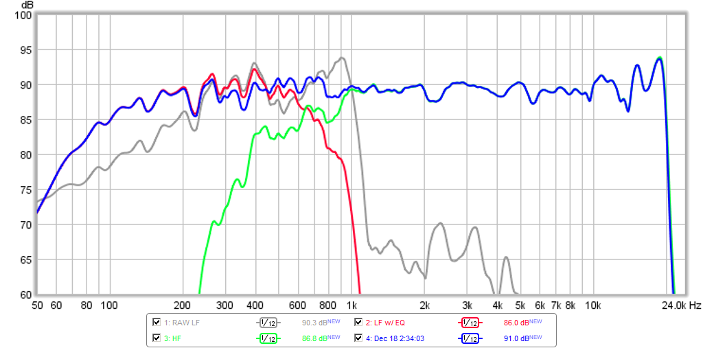

Very rough attempt at EQ'ing open baffle woofers (raw is grey) to hear what it may sound like. EQ'd woofer response is red, shows great upper frequency extension so I should be able to XO to fullrange driver no problems. Even without BR or sealed rear chamber, drivers can hit 100Hz with EQ, but the distortion is higher.
The bandpass injection ports in this case are good for almost 1kHz. I need to build a pink XPS foam box to house the whole thing and turn the woofers into a sealed back chamber. Although still contemplating a BR port version.

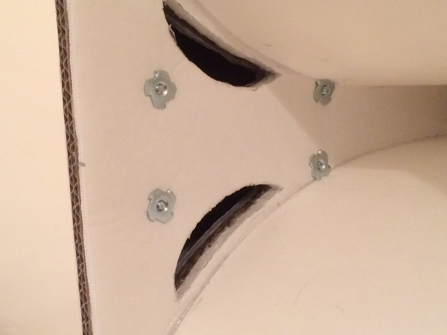

I fixed a small buzzing problem as the screws holding the woofers were just not getting enough grip on the triple layer cardboard. I used T-nuts on the inside surface of the horn and these hold really tight.

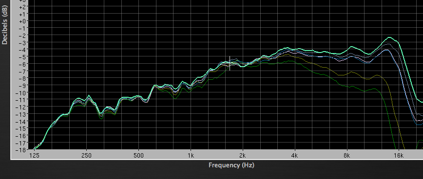

Tests a few days ago determined that the native HF dispersion of the 3.5" Tymphony TC9FD-18-08 is around -11dB at 16kHz at 25 degrees off axis.
The narrow HF dispersion results in the on axis rise Using a 45 x (approximately) 30 degree conical horn with a 2 3/8" x 2 3/8" square throat, the frequency response remained smooth, other than on axis +3 dB peaks at 6 kHz and 15 kHz, and dispersion remained uniform out to 25 degree off axis, only 8 dB down from on axis at 16kHz, an improvement compared to the native response. The 6 dB per octave mass break drop starts at 1600 Hz, about an octave lower than a typical compression driver.
Response at 16 kHz on the horn has perhaps 1 dB gain over the direct radiator (no baffle, 1 liter sealed chamber), maximum gain of about 12 dB at 1.6 kHz compared to the sealed direct radiator.
The screen shots below show on axis response, followed by 5,10,15,20 and 25 degrees off axis.
