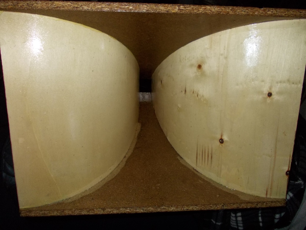

Did just a part of what you did, only ask myself the horn is maybe unnecessary big.
Maybe better a smaller one and a sm,aller throat for more compression and a fill up of the cone bringing him close to mouth without ar only a small faseplug.
regards
regards

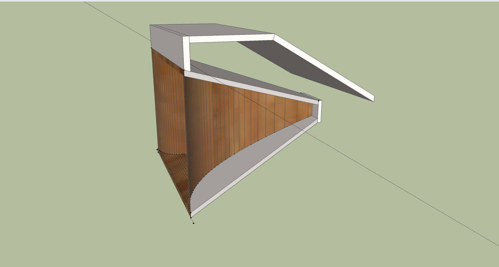

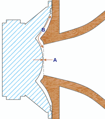

One reason why I am exploring the smaller uTrynergy - smaller and more manageable size. The phase plug design you draw there has a sharp lip where flows from edge of cone has to make a turn. That distance vs center of cone will make a sharp cancellation. I had a pretty deep one when I put 10F on the little 1.4in throat of the smaller uTrynergy.

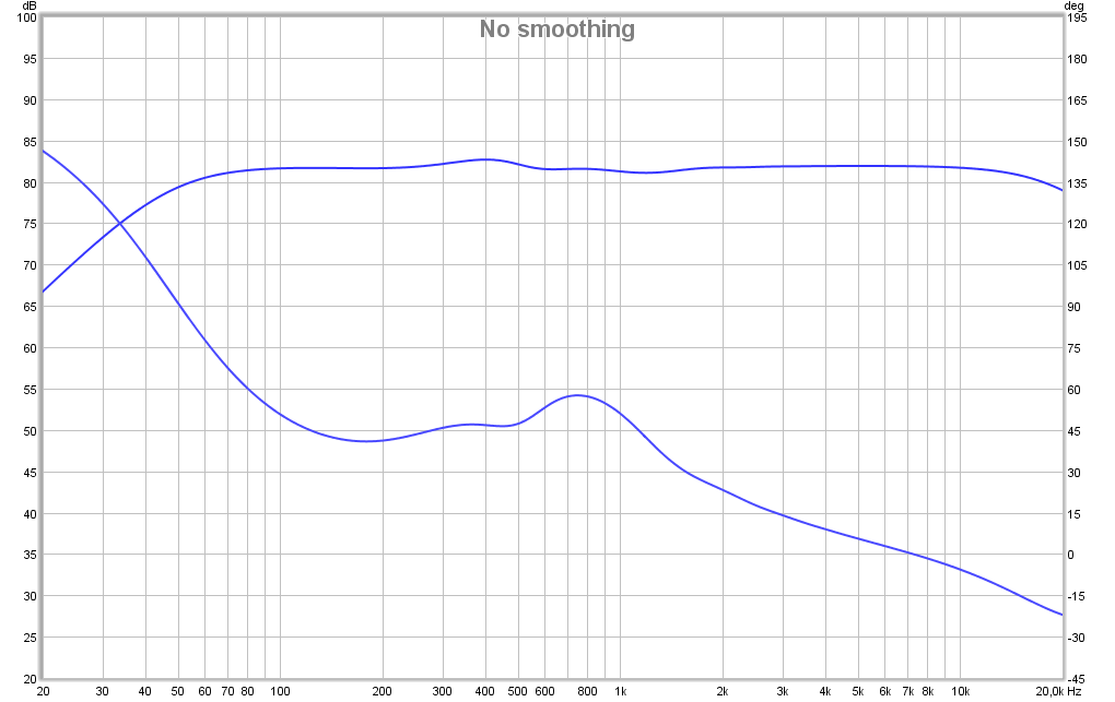

Where was that cancelation? frq?.
Maybe the filter way of correction is the only way, but curiousity of mine do let me try. Oke the small mouth = more compression is not very good idea, except maybe with a powerfull speaker motor and stiff cone.
What cuttoff frq has your smaller horn? mine was set on 275 Hz and 12,25 cm2 throat.
regards
I was able to get it to go down to about 350Hz in actual measurement. I am crossing at 500Hz. The full scale design was 175Hz and this is half scale so 175Hzx2=350Hz is theoretical lowest horn loading frequency so that matches.

Rule is 1/2 to one octave below calculated horn loading I did read somewhere.
Dit you also sim the bass alone to see how high it will go through the ports>?.
The dipole opening behing the horn I think is not critical, it do not work like a ported
box, I think a closed box do also wel when used to 80 hz like me.

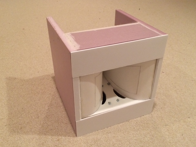

uTrynergy with SB65WBAC25-4 driver and improved XO

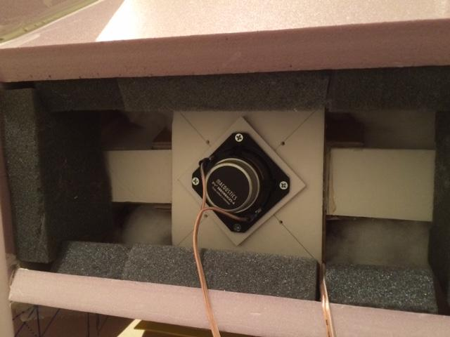

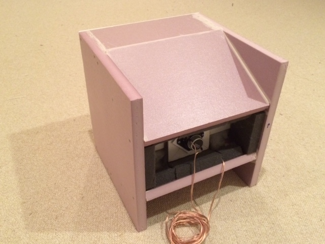

The nice thing with an open back speaker is that it's easy to swap out the driver. I decided to try one of my favorite full range drivers: the SB Acoustics 2.5in SB65WBAC25-4. It's an aluminum cone driver with a Nd motor and nice top end and very little ringing. It is a bit lower in sensitivity than the Tang Band but that is not an issue as we are trying to integrate with woofers that are inherently lower in sensitivity.
Here are photos of the new driver and the speaker now with a foam core face lift to give a clean appearance from the front. I also added some foam around the rear exit reduce reflections back onto the full range cone and to smooth out the bass from the back.

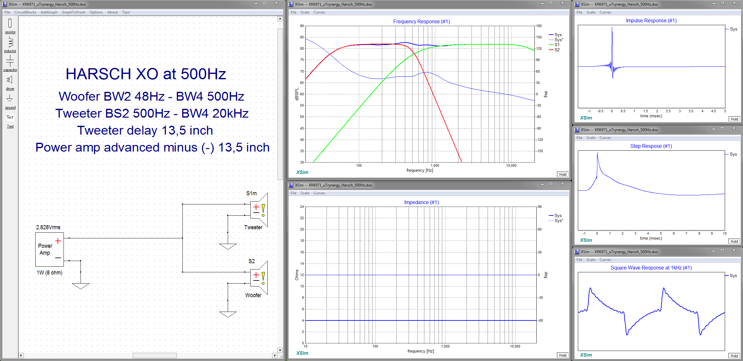

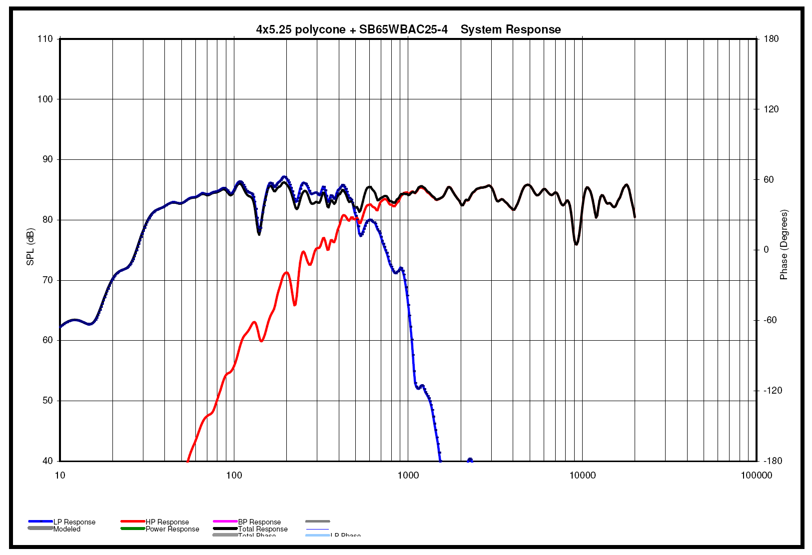

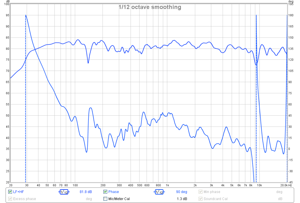

I also decided to use this opportunity to do the Harsch XO properly by measuring the raw response of the drivers separately and in parallel, driven full range to acquire the .FRD files (minimum phase converted) so that I can simulate the response in Jeff Bagby's PCD spreadsheet to determine the acoustic offset and to apply PEQ's to match a target function. I am glad I did this - it's a methodical process with clear steps that has no guesswork. Once I put the FRD files in PCD, I was able to quickly determine that the acoustic offset is 170mm to get an exact match of the combined response with the measured combined response acoustic interferogram.

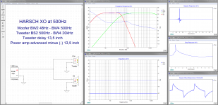

I set the target functions as BW4 LPF at 500Hz for the woofer and BES2 HPF at 500Hz for the SB65WBAC25. It was quite surprising to find that the proper electronic filter ended up as a BW2 LPF at 500Hz for the woofer and a BW1 HPF at 300Hz for the SB65WBAC25. After applying 5 to 6 bands of PEQ, the target responses matched almost spot-on. The delay was also found to be only 100ms vs the 920ms I was using before.

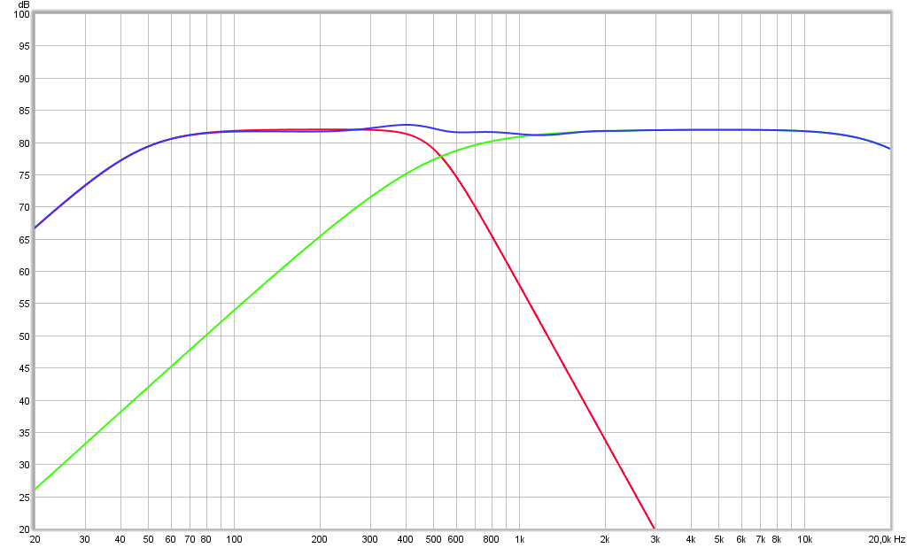

Here are the predicted responses for the drivers and summed response from PCD:

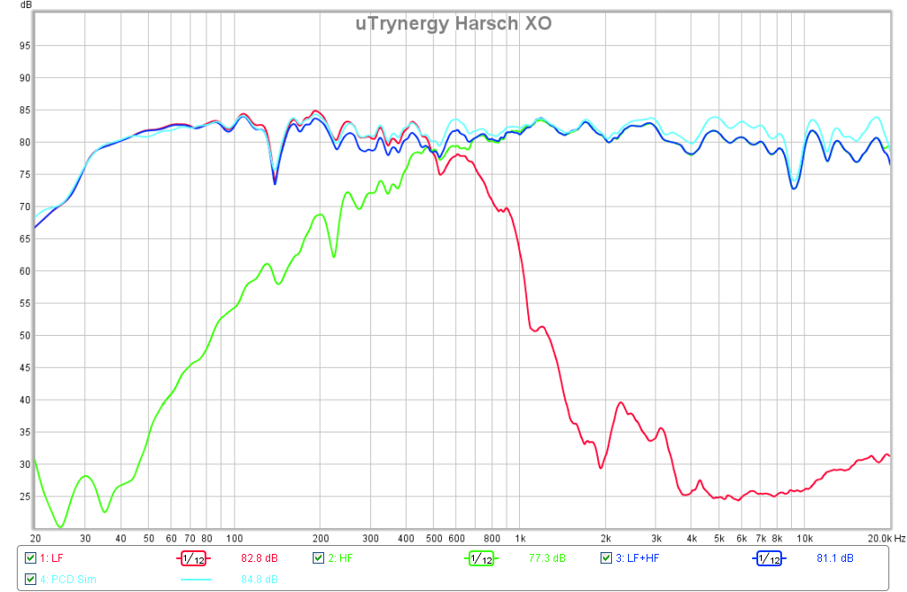

I then transferred to settings from PCD into miniDSP verbatim and here are the measured responses and the predicted response from PCD (light blue) - fantastic agreement:
Here is the measured phase response of the new XO - extremely good near flat-phase response with +/- 25 deg over 200Hz to 8kHz. There is a phase wrap at 9kHz due to the horn-induced throat cancellation, otherwise it would have been flat phase to 20kHz. The delay as adjusted from the PCD simulation seems to have the peak phase shift occurring near 1khz rather than the 500Hz xo frequency - some more manual tweaking may be needed to move it to 500Hz:

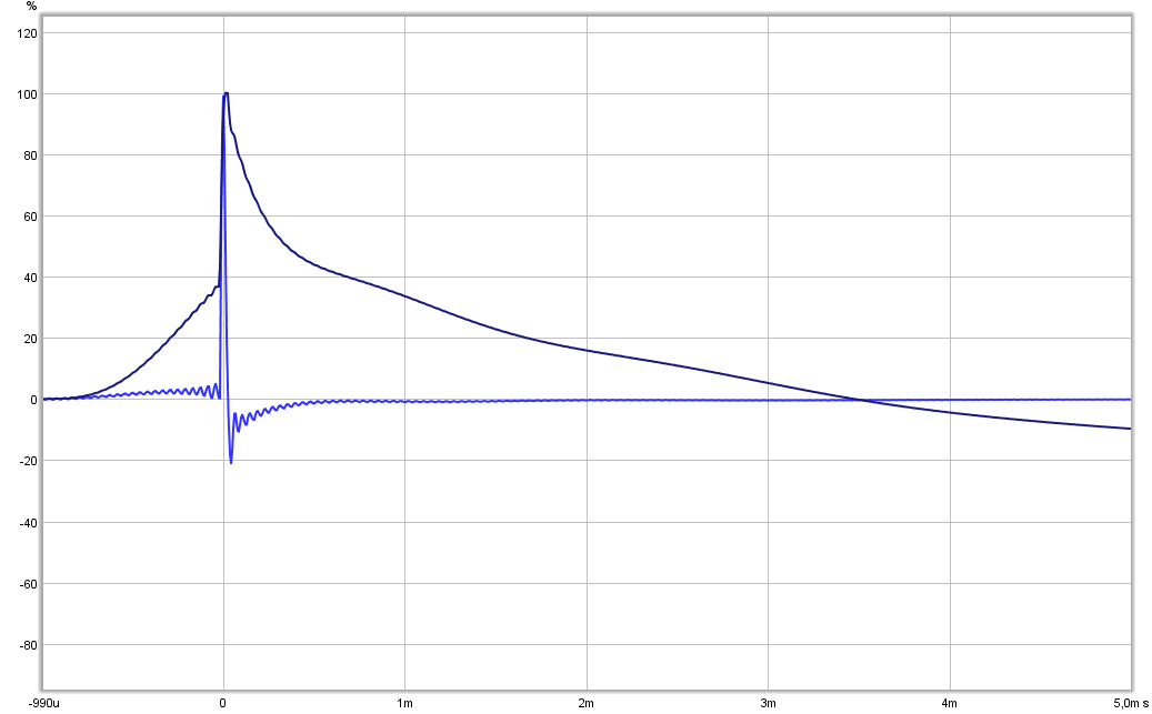

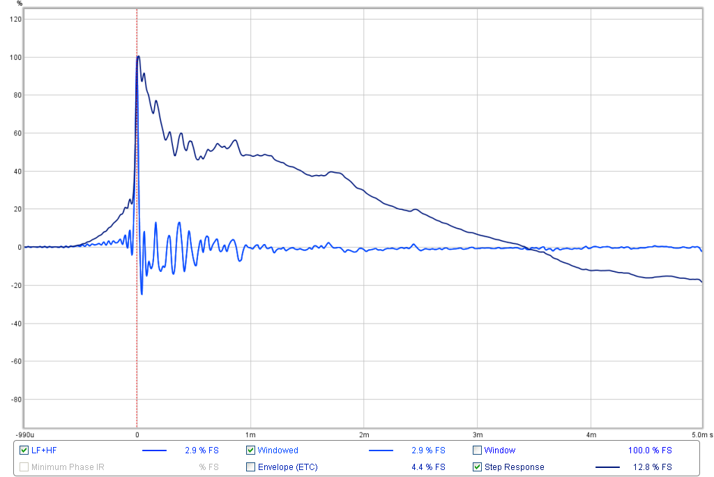

Here is the Impulse and Step Response, much better than I had previously:

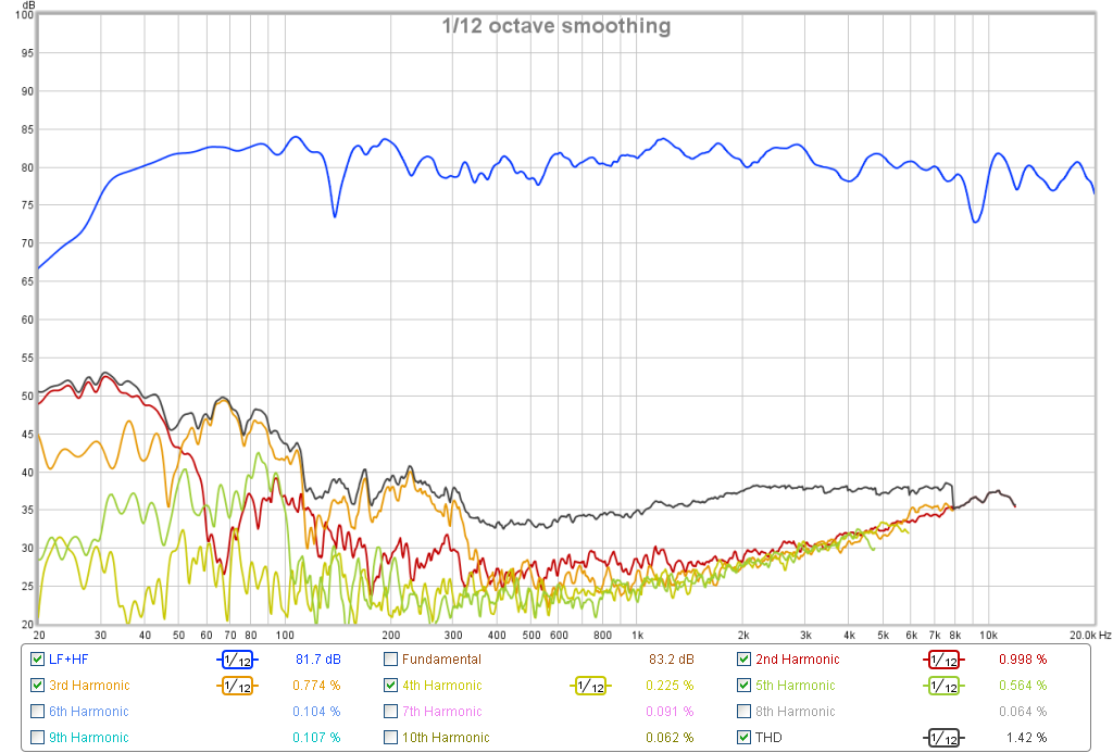

Here is the Distortion, and you can see that at lower domestic listening SPL's the distortion below 100Hz is under 2%. Also, this driver doesn't suffer from the big HD peak at 9kHz like the Tang Band did.
The sound is much more coherent than before - you really can hear the difference.

Did a quality check comparison your acoustic measurements to approx. same electric slopes made in Rephase and imported to REW and XSim. REW ones below is set same scales as your live ones for easy comparison, filters are electric woofer slopes BW2 48Hz - BW4 500Hz and tweeter slopes BS2 500Hz - 20kHz. In REW tweeter IR is delayed 1,0mS before summed A+B with woofer and in XSim tweeter is delayed 13,5 inch.
