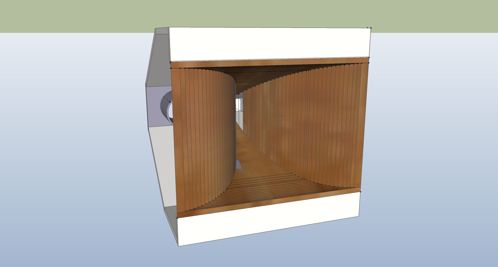

I am not sure where you got this but it may have been a way to "kluge" or fake the effect of an open back enclosure by making the ports huge to reduce any effect they would have had as a bass reflex port. Yes it is 17inches and 7inches. Akabak by default uses meters as length. In some functions like radiator specifications where we say what the baffle width is or where the acoustic center is located units of inches or other units are allowed if specified. If left as a plain number then meters is assumed.
X I have do change the meters in akabak so I can more easy find the ports.
like this if I did it right. gave the same outcome.
| *** tractrix profile from E. Forker's Tractrix spreadsheet for 300 Hz horn ***
|S_throat(m^2), S_mouth (m^2), Length (cm)
S1T=0.005041000; S1M=0.007076077; L1=5.19*0.01;
S2T=0.007076077; S2M=0.009688764; L2=4.79*0.01;
S3T=0.009688764; S3M=0.013530724; L3=5.06*0.01;
S4T=0.013530724; S4M=0.01865877; L4=4.83*0.01;
S5T=0.01865877; S5M=0.026128549; L5=5.01*0.01;
S6T=0.026128549; S6M=0.037115109; L6=5.14*0.01; | Bass front horn injection point at 24.88cm, node=56
S7T=0.037115109; S7M=0.052727978; L7=5.01*0.01;
S8T=0.052727978; S8M=0.075596059; L8=4.95*0.01;
S9T=0.075596059; S9M=0.111944519; L9=5.05*0.01;
S10T=0.111944519; S10M=0.138052394; L10=2.48*0.01;
S11T=0.138052394; S11M=0.154466426; L11=1.24*0.01;
S12T=0.154466426; S12M=0.173785319; L12=1.23*0.01;
S13T=0.173785319; S13M=0.197408872; L13=1.22*0.01; | Bass Reflex injection point at 49.98cm, node=63
S14T=0.197408872; S14M=0.230483934; L14=1.29*0.01;
S15T=0.230483934; S15M=0.266119447; L15=0.92*0.01;
S16T=0.266119447; S16M=0.300380595; L16=0.43*0.01; |0.526m long
For the synergy I did tought about do reflexports on the back?, and then corner loaded, maybe it give
more control about the cone.
regards

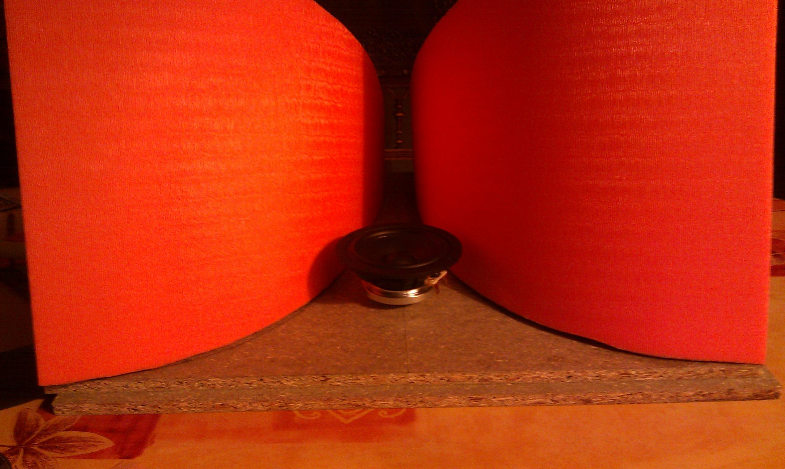

Kees,
That's almost exactly how I made the box for the uTrynergy. One note is that I needed to reduce the volume so I sealed off the volume enclosed by the curved wall and the flat panels that hold the woofers. It made for a tapered almost like the tail of an airfoil leading to the back where flows from both sides of the horn backsides combine before exiting out the open back. For your application, depending on driver Vas and what volume you need, you may leave open or closed. It's a good place to add filler volume blocks to precisely set the volume and Qts of the sealed or vented box. Your two rear vents is what I was also thinking of. We have same idea.
And you even can swap the rear ports by variovents if you like !
Groovy! That damps the cone very well because of the resistance action. you need to seal of the wideband driver on mouth
otherwise it will lanced through the hornmouth in your room.

Is there here no error? because of the ports maybe swapped? your injection port is quite close to the mouth, and says bass refelx injection port
mustmaybe be front injection port.

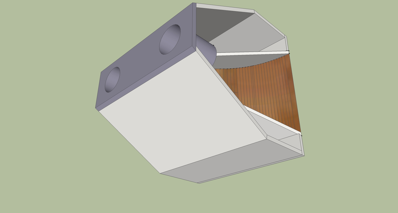

Kees, if you look at the position of the bass injection port from the front band pass chamber of the woofer, it is located about 11 inches from the throat. That is about the correct location. The steps are about 5 cm from the throat because it is straight and I take smaller steps near the mouth as it expands rapidly.
Also, you would not want your bass reflect re-injection to come in upstream of the the main band pass port - you would end up with a strange 6th order bandpass woofer that will have a very steep cutoff.
little by little, I believe the second pair will be more precise as I have only 1.5 inch at throat with this one :
Looking nice! Beware that I saw a deep (-15dB) cancellation null when I ran the 10F with a 1.4in throat. It corresponded to the distance from the edge of the cone to the throat or 6.4kHz. It will need some sort of phase plug or maybe very rounded throat edges to get rid of.
