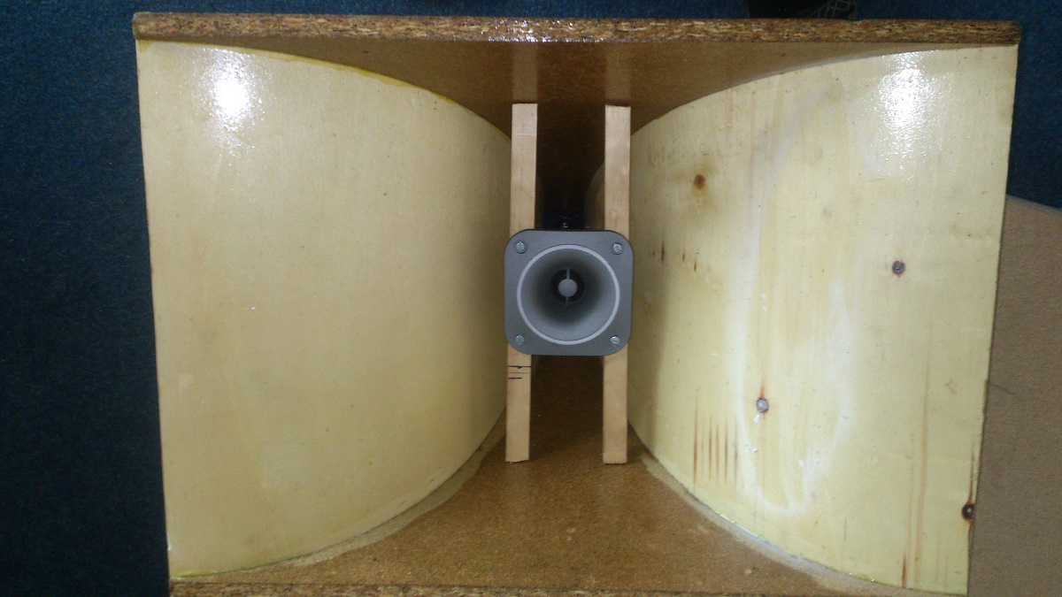

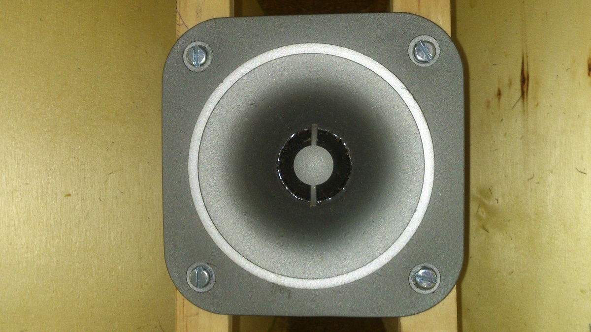

Not that is does matter much for me but think if to call your build ala Synergy then tweeter should have sat at apex and Visaton as injection port.
Thanks sharing build it sound as one need to do same as you so as to hear improvements when not spraying sound to wide on design axis combined better distortion data 🙂.
Not true, when fase corrected and a use of a HF horn it act as a coaxial horn ( Not Normal tweeter when use of a normal tweeter like here the efficienty is not higher then when the tweer can give,, it is not horn loaded.
I did have a idea of a little horn in it, made with a lathe and pointy on the back for the waves coming out without reflecting..

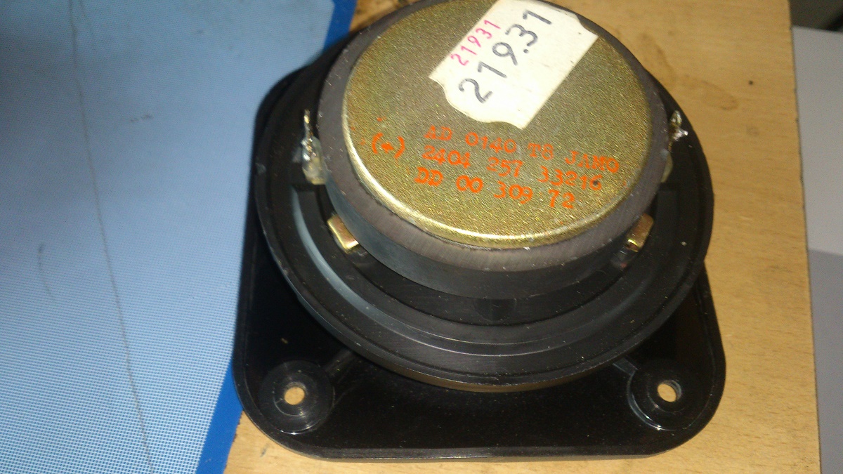

I have make some pictures, the hf horn is a jamo part and it is a phillips dome stuc on it with glue.
This way and some delay it get nicely close to a good single point sound.

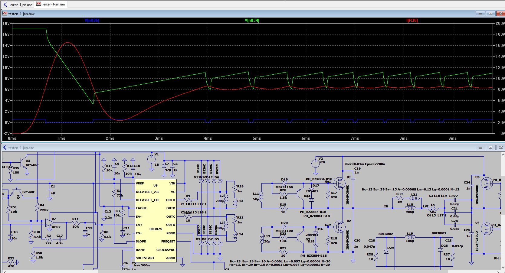

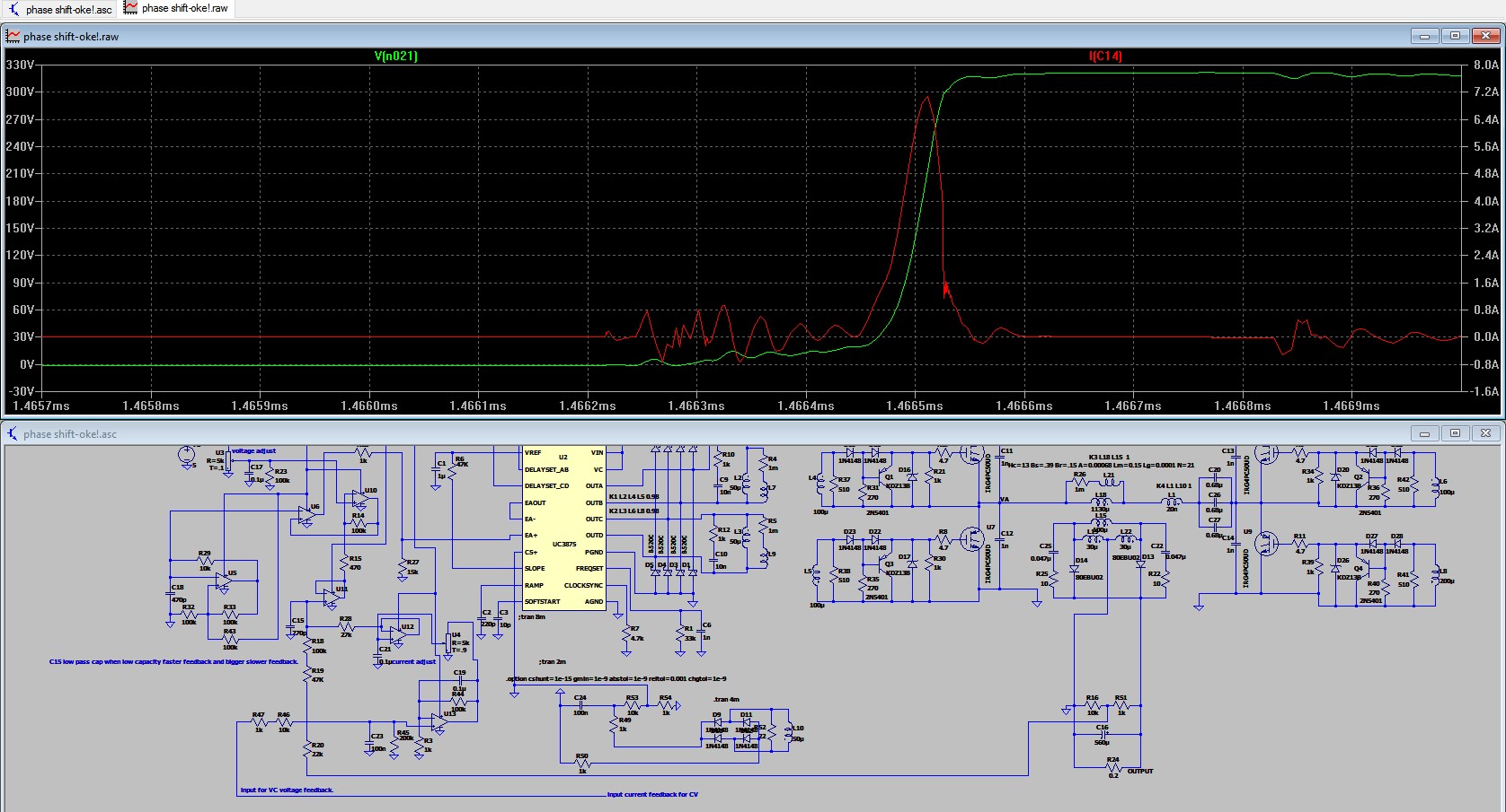

Also best wishes fro me, this moment i am busy with a 160 amps smps fase shift soft switching because my transformer did burn. it is for welding the car in spare time.

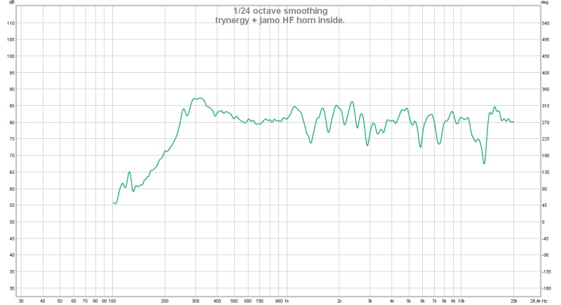

coming week I go measure the new aproach with the trynergy and I am ready now with the saw to make a tangerine faseplug.

Hars sound accours when compression get pretty high with a faseplug a la tangerine. That is why some compression drivers are very hars sounding, for PA this is not a issue.
