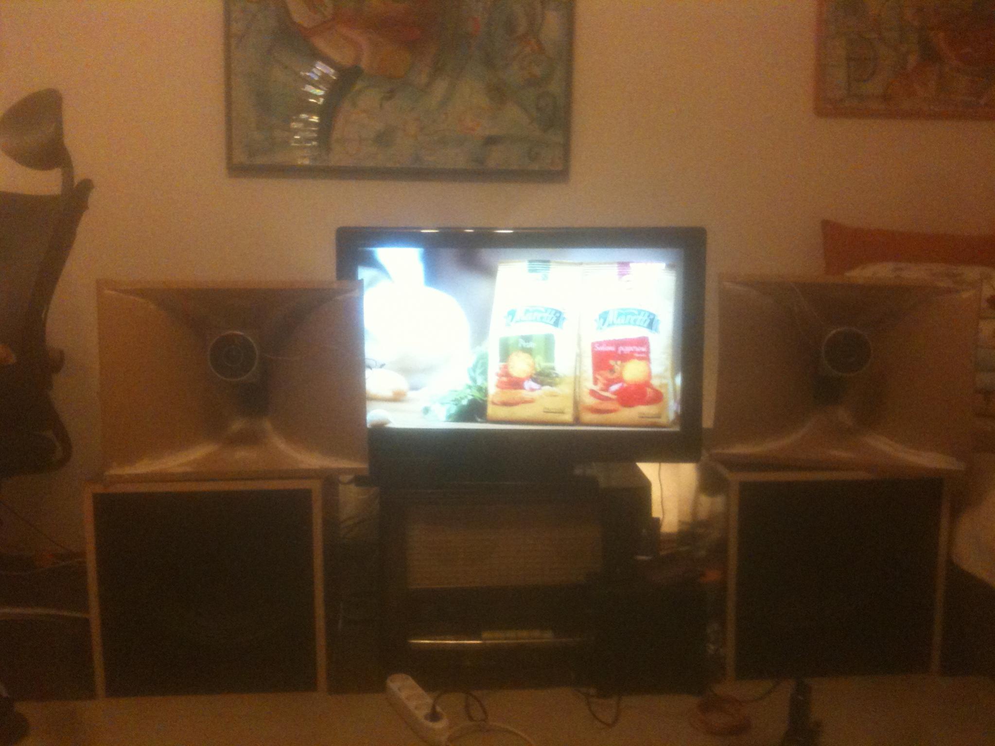

I finished my 220hz tractrix horns with Visaton FRS8M, 0.3 liter back chamber. I had no previous mid horn experience. No measurements at this moment but will do after they break in these days.
I cross them Low Pass LR4 at only 2250Hz because the highs are not as good as my Philips tweeters. The tweeters are hanged in the mouth and delayed.
The sound is very fast and smooth, way less distortion than my previous open baffle 8in driver (eminence alpha 8).
I drive them with a 20W Yamaha amp, class AB. The volume these mid horns can output is incredible. Also at low volume, they sound very clear, where the Alphas sounded distorted. I think the moving mass makes that difference, 8" versus 3" is a lot.
The only problem i see now is that i must make a midbass horn to cover 100-500hz 🙂

Very nice ! Photos? Did you follow plans here or your own? Totally agree with clarity of sound and low distortion.
I calculated the horn size with Hornresp. It is 50x36cm mouth size, 55cm deep.
I did it with minimum tools, a hand pendular saw and drill machine.
One thing i don't like about them is that the curbed wall is vibrating. It is made of 2 thin layers of wood cardboard, 4mm thick (or thin..) each, with wood glue between them. I looked for some rubber layer but i haven't found in my town.
The straight wall is 18mm MDF and it is not vibrating at all.
The back chamber is made of some 500ml plastic cup of cosmetic hair balsam 🙂 i had the lid cut to fit the driver shape, screwed in 4 points and then applied some heat resistant gasket goo from my motorcycle rtw trip kit 🙂
Sorry for the photo quality but it is what the iphone 3gs manages after all the years of usage..

Nice work, looks like mine, replace the phillips tweeter for a small horn or calcualte one for the phillips wil do much more efficienty and lower distortion for the tweeter.
I am busy with this way, only I do centrate the tweeter in the middle and build a small tractix first for it in round chape.
