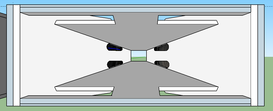

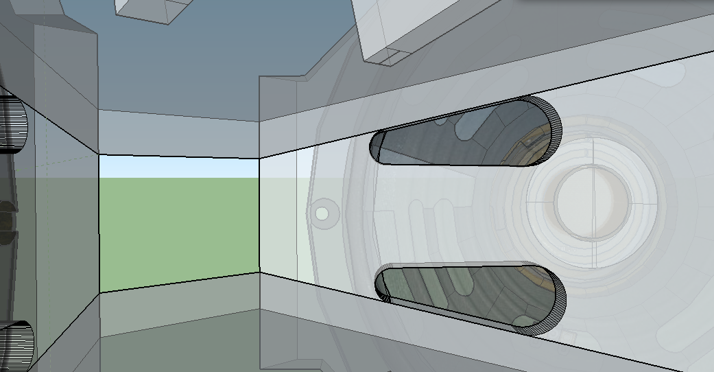

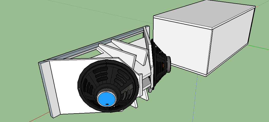

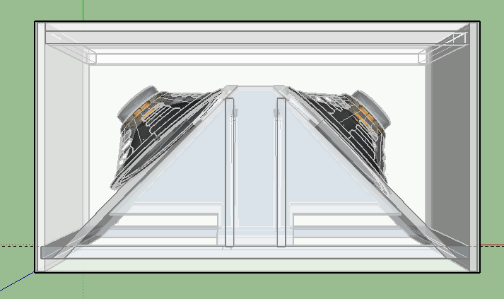

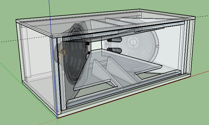

Finbot recently shared a Sketchup model with Art's approval of the Syntrip.
I thought the pics would be useful for reference here as the woofer injection ports are simple and elegant and something similar should be achievable in fomecore.
Cheers Art and Finbot, hope you don't mind.
Dean,
Finbot's model has not been "approved" by me, there are a number of discrepancies that need to be corrected, the first being "SynTripP" was not spelled correctly :^).
As well as not being approved, don't see any reason to show a sketch of a completely different design in this thread.
Art

Hey Art. Sorry If I was out of line.
My inference was that the 'sharing' was 'approved' but if it's not cool I will request the mods remove the post? Let me know, no hard feelings at all.
The reference to your SynTripP 🙂 was only for an inspirational, easy and elegant way to do woofer back wave injection ports in foamcore. Full credit to you.
As far as competely different designs.... Hmm... They are both kinda multiple drivers loading a sigle horn type projects but anywho. ;P. (yes I am stirring you up a little bit)
Dean

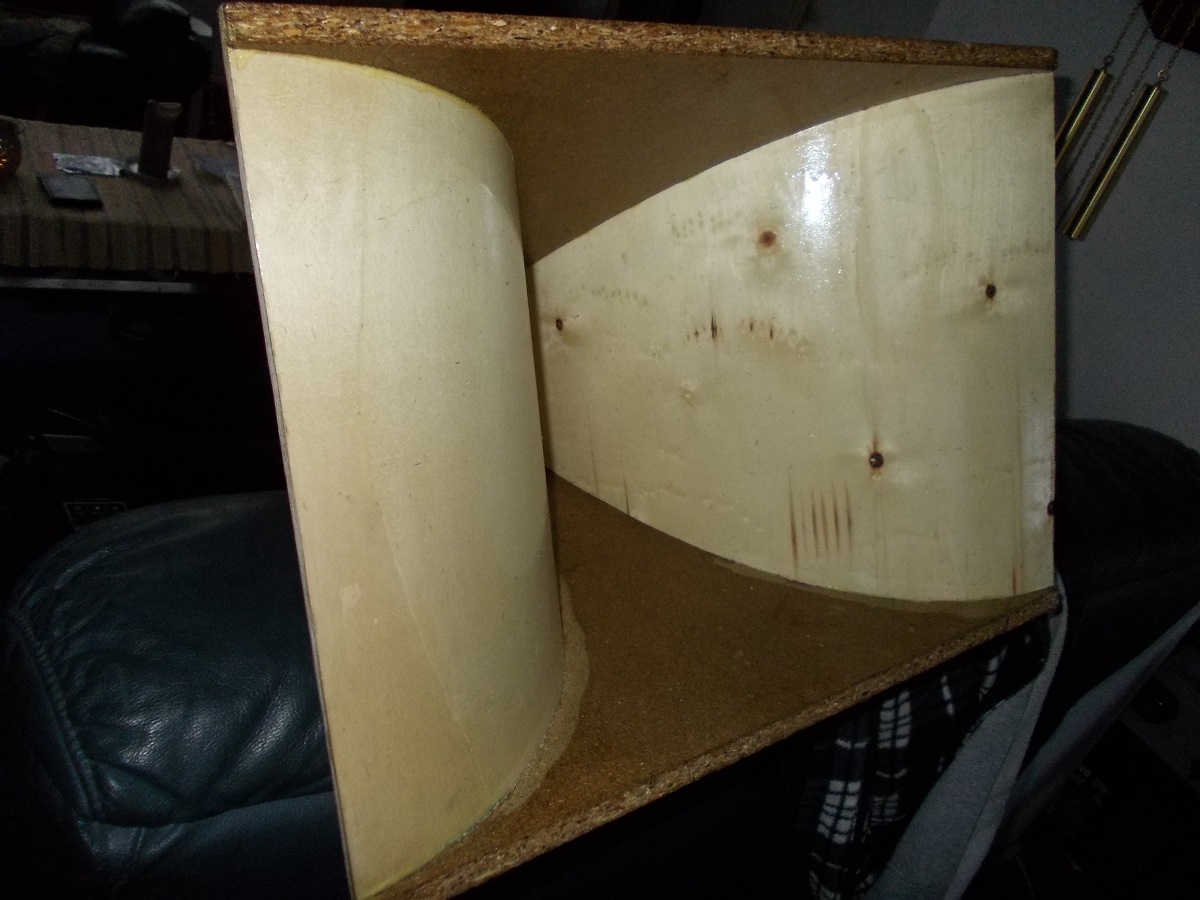

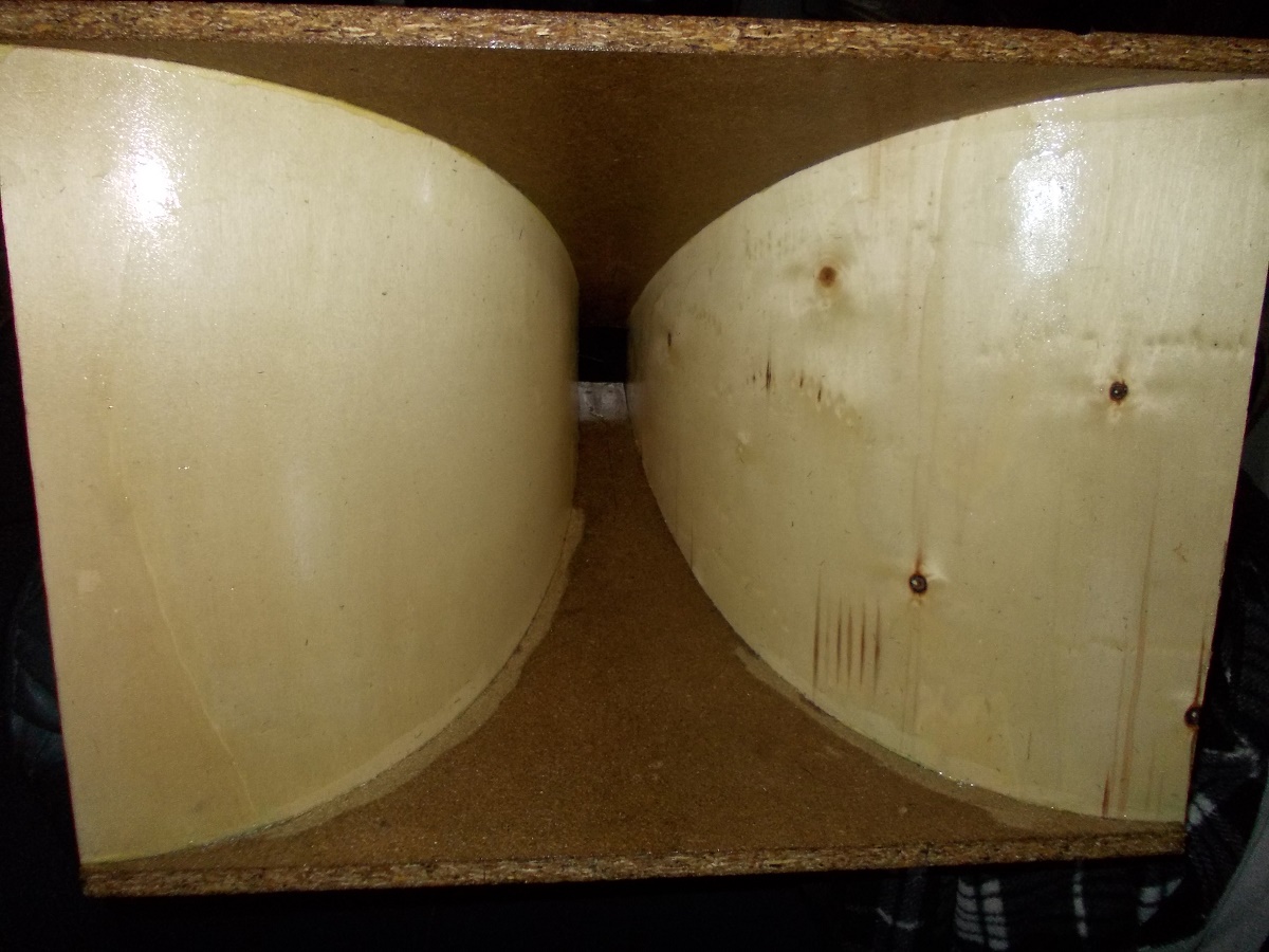

I have did a transparant paint on it who is very nice giving the wood looking very nice and damp also because it is very stiff now but was already strong.
But later on I go paint it white because it is not clean in edges.
regards
