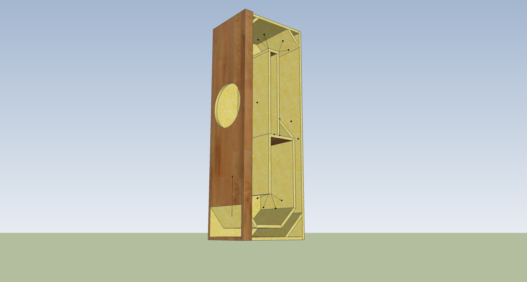

The sub is build as on photo in early post, I did have this one for two years now, but also had a tapped horn ready.

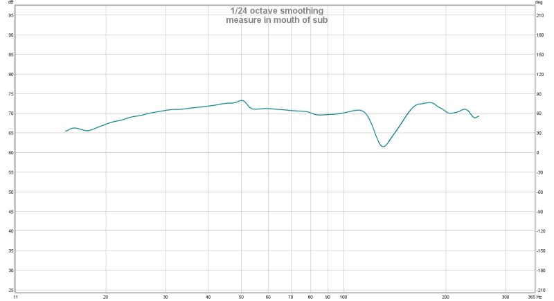

The sub in question is a T-TQWT sub not a tapped horn and when measure in mouth it has no dip see picture, then it looks quite good
you see just a little rest of the dip, o yes I have the mouth up in room, not close to the ground, maybe that is needed? bass is very
unforgiven for place the sub.
Tomorrow when it stops raining I go measure outside, with the mouth up and down, and in room on different places to see what happens.

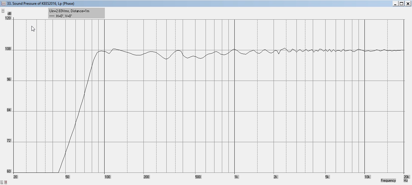

Hi xrk971

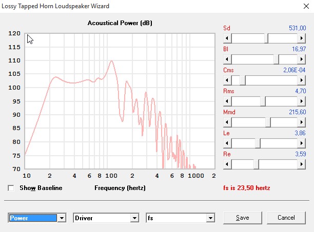

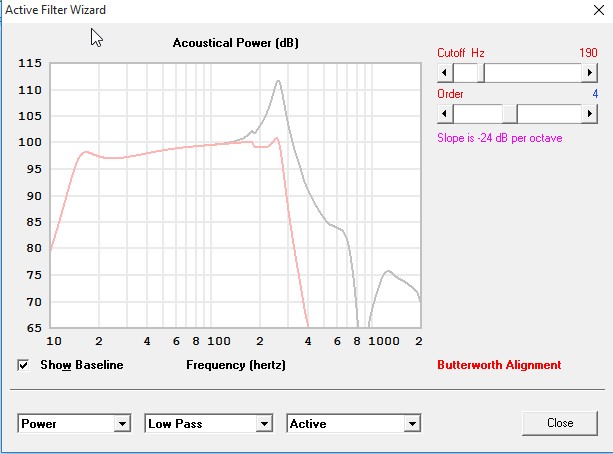

I have done in akabak some sims with the phillips and see when port deeper in horn the speaker has quite more efficienty.
I have here the sim, I go make that this way, when without the bassreflex port the phillips do not go as low for a tapped horn, so I use it also.
Oh yes, I did see the same reaction in the horn when do mismatch delay, and get the same as with my problem with the T-TQWT.
But have no answer of satisfaction, and wether do also not what I want,, so measure sub is for later care.
the best I get is this with the phillips, not bad for such old speaker.
regards

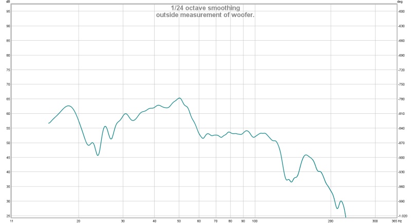

I did ask about a woofer in a T-TQWT who do very strange, people on hornresp threat says it is the room, but I need to test it outside, as you see the room is not the cause but maybe the port on the back of the woofer who is 1.80 meter long.
second picture is with mouth on the floor, the first is mouth 1.80 meter above floor for information.

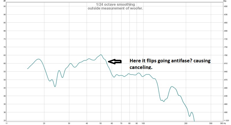

I have found what happening with the sub.
It cancels the sound making that flip, this also do the trynergy when I do not put bass and HF in a bad crossover point, getting the same error a flip.
But what can do cause this and why the flip is not present when measuring close to the mouth, looks like a reflection in room however it do it also outside.
Maybe a leak in this large box. picture two has a nice measurement when in mouth, see just a little piece of that flip left..
PS a inverted tapped horn for in home do well!! and is much smaller. So I go stop this T-TQWT trouble and build later the sub,
