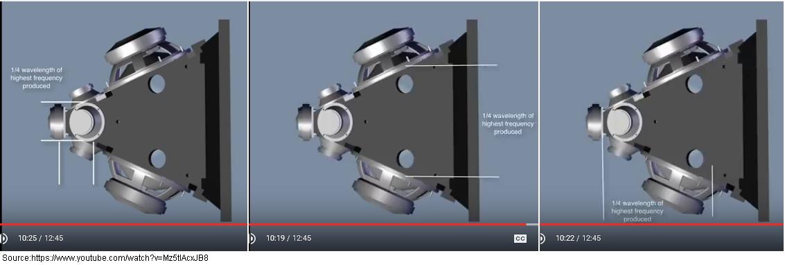

Presenting the Trynergy - a full range tractrix synergy.
xrk971 keep up the great work!
The ¼ wavelength distance is safely smaller than the cancellation inducing ½ (and greater) wavelength distance. Watch the video
https://www.youtube.com/watch?v=Mz5tIAcxJB8
For full details and explanation ref Synergy horn , read the ‘teaching’ patents 6411718B1, 8284976B2 (Thank you Mr. Danley)
George

Hi George,
Thanks for the kind words. 🙂
I wonder if Danley was referring to the same cancellation mode for cone-to-cone (closed to closed boundary condition)? That would be 1/2 wave and not quarter wave which is closed to open ended boundary condition.

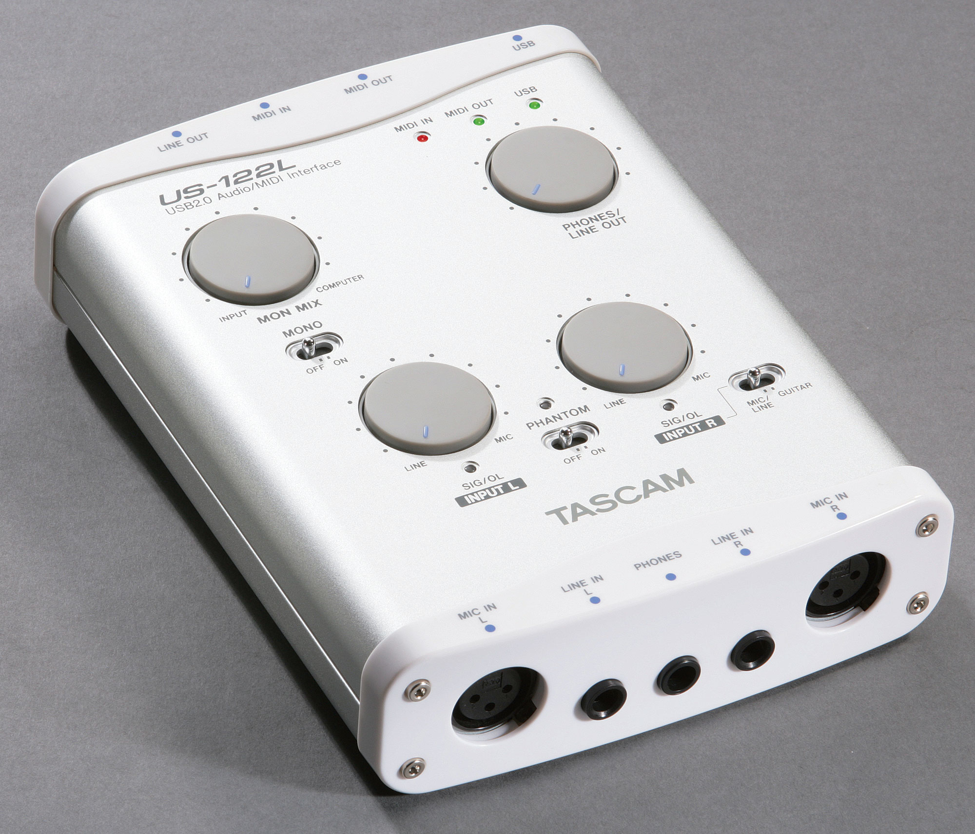

I have bought a usb audio card it is on his way, I hope a good one it is a Tascam US-122L with fantom supply and 24 bit 96 Khz audio out and inputs.

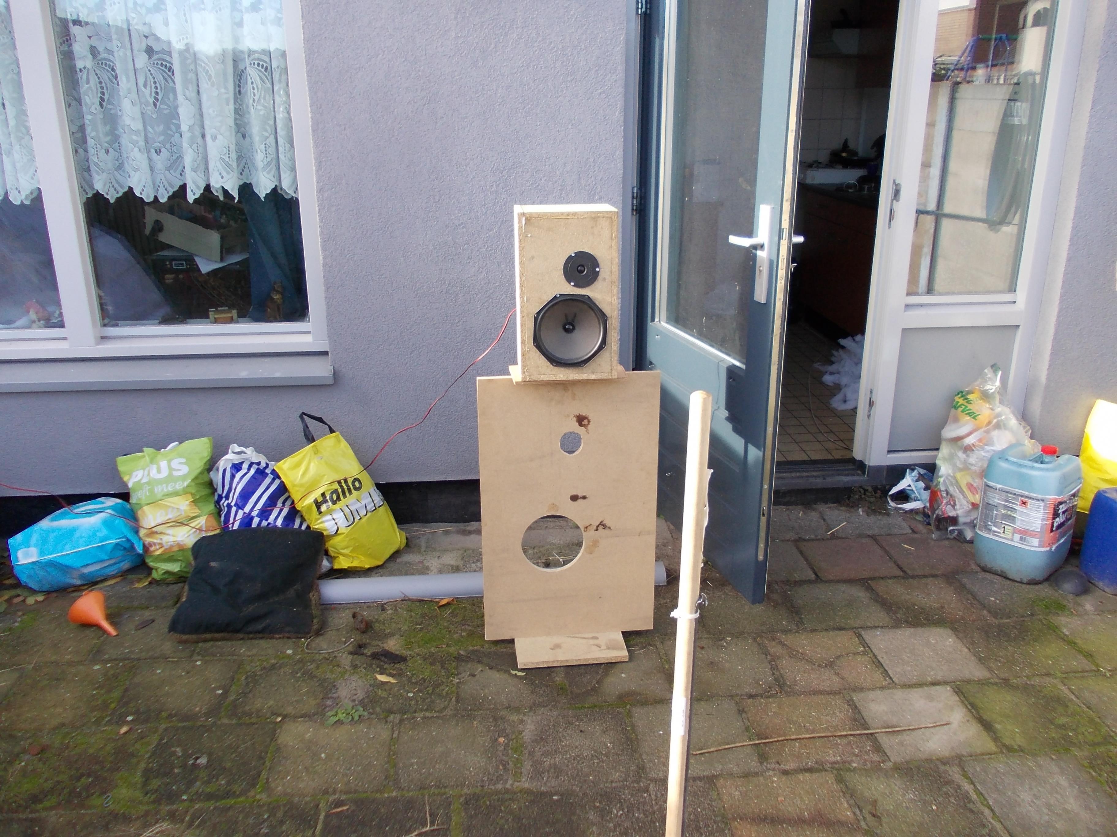

I have put now outside a stack for the loudspeakers, inside it is just not possible here, to much reflections.
I am busy whit that normal box and not horn to get measuremenst oke, after it is I go on with the horn, also I am busy with making faseplugs, little ones because HF is present in center of cone, lower frequenties are more outside center cone so I need really to get it right.

Nice DAC - looks like it should work well.
I think you have it backwards, I would be George's apprentice as he is far more experienced and wiser in audio theory and design.
Outside test is good, aim the horn at your wifi RF polluting neighbor and direct a 118dB sound beam at his bed room. 🙂

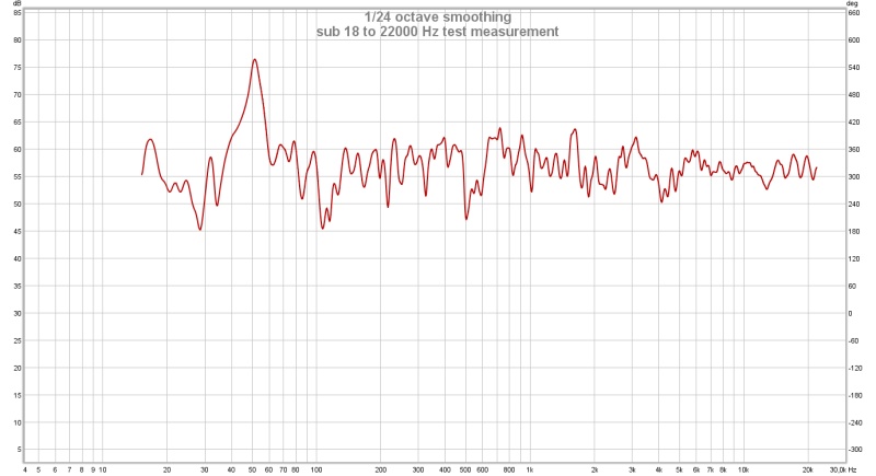

I have the problem that I did get a electrical shock from the pc housing when put mic on outside where I did had earth with my feet.
Maybe this is the problem I have also, giving a big 50 hz peak, I do need earth the pc before measuring.
The measuring is a lot better but still 50 hz peak who can also come from the antenne (sync pulses)
Use a laptop on battery to be safe.
You do now a pc who give a shock is not normal, buying a laptop for get around it is a bad and costly solution.
I put a new plug on the wall with a earth point on it to I get rid of it, you now I am electronicus so have always a solution for mister murphy.
Oh and yes my bad measurements was a problem in REW, because I did play with it ig has change someting, I have reset it again, but love to read
what to do to get good measurements and not to switch on things I do not need or even is not a good idea.

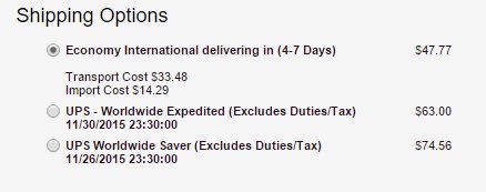

If I see the shipping costs then I get some hair getting into the air.
If this are normal shipping costs I am king kong.
And if the USA will a treaty with Europe? then this has to be change.

I have now a better mmeasurement with the usb soundcard.
did is a test with a sub and a bass/mid/high small box.
Now I can again go on with the horn, I have order some mic caps because
one is broken and I have just one left.
You see a lot of room effects in the measurements, outside was no option because
of the rain and hard wind. Just move the mic a fraction give a total different outcome
how sensitive that is I am suprised.
But REW do also not save files except when overwriting one, windows 10 has to
be removed and back to the old days.
