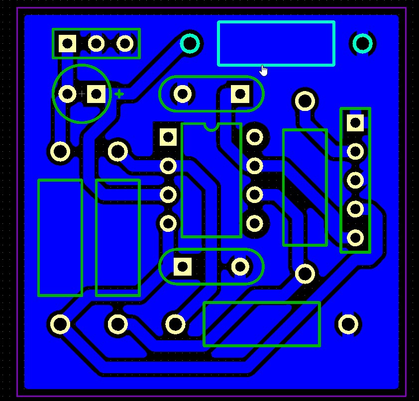

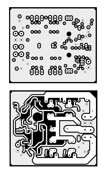

I have ready now also the amplifier pcb who go drive the tapped horn, because a tapped horn doe not well with a analog crossover.
And the mic amp do well now (see pcb), it was the copper tube who did resonate with the mike in it, now it is decoupled in a aluminium housing.
I have made the Siegfried version for measure also high pressure.

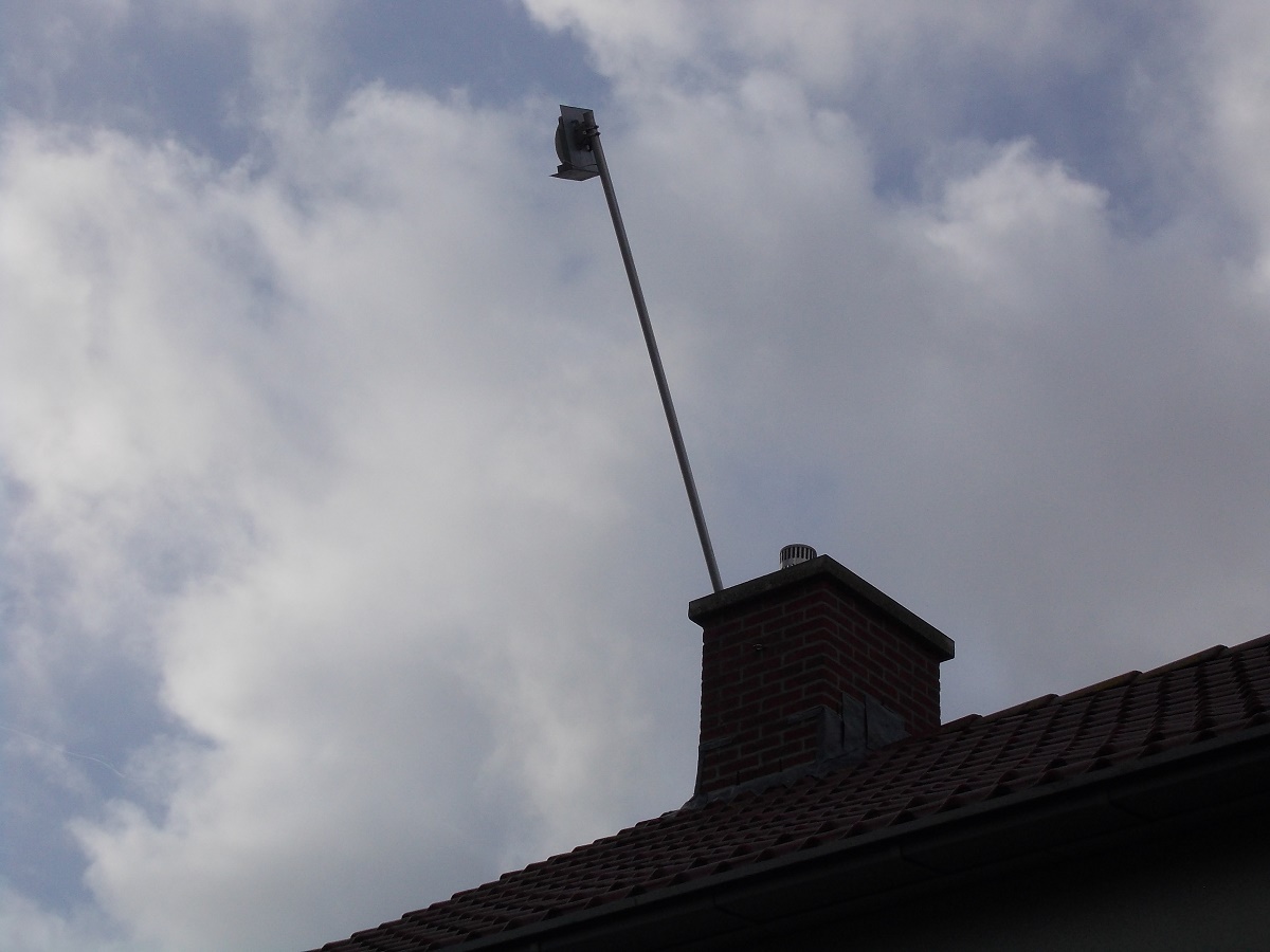

What is the point of a big outdoor wifi transmitter? Is your neighbor using it to send wifi to another neighbor far away? Or trying to make wifi freely available to the whole neighborhood?
His boss lives on place some km away and need internet, he is connected with the antenna, it has a reach of max 15 km and radiate 8 watts.
But now it is down, because the present storm has kill it, but still transmit, so the child 4 years sleeping there has now full power 5.8 gigahertz closer then 2 meters from the head.
I am sensitive for HF, so it is that I can not call with mobile phone for longer then 4 minutes, after that ringing and tickering occur in the ear, making me very dizzy.

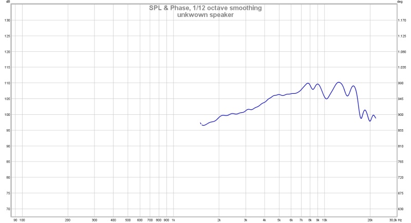

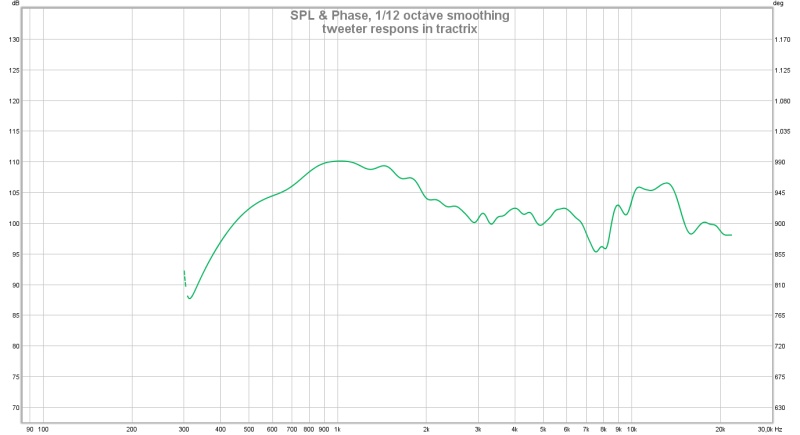

I Have done a measurement with also tweeters and a unkwown spekaer from a pc box.
I ask myself, making a tractrix whith bigger mouth and speaker making a small tractrix inside will do the whole band with sensitivity.
But when do 108 dB and loose 12 dB is still 96 dB watt, not bad for a 3 inch.
PS wrong plots, unkwown is tweeter and tweeter is you now unkwown.
measurement is with no filters.

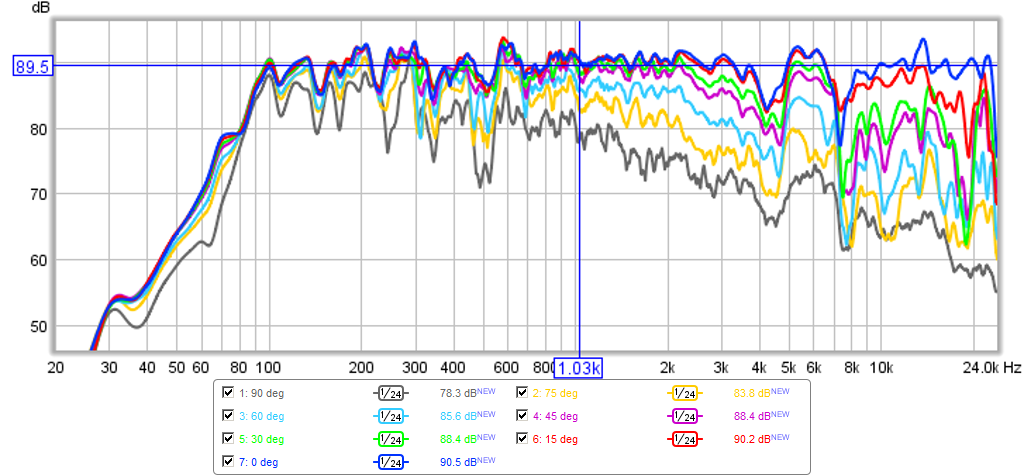

There is a small dip that gets progressively deeper off-axis at 350Hz according to my measurement:
I don't have the speakers in front of me but I am guessing that the distance from one woofer cone on one side to the other cone on the other side with band pass ports and chambers is about 0.46m. That might cause a half-wave cancellation dip around 370Hz. That's for opposite sides. On the same side, they are the same wave so doesn't count. The dip might be about 2% to 5% at most. I do see some wiggles there but that is also affected by mouth diffractions and even some room effects.
Nice measurements, I assume the dips below 500 Hz to be room (floor reflection?) behavior ?
Yes room modes - go away upon gated measurement at 5ms.

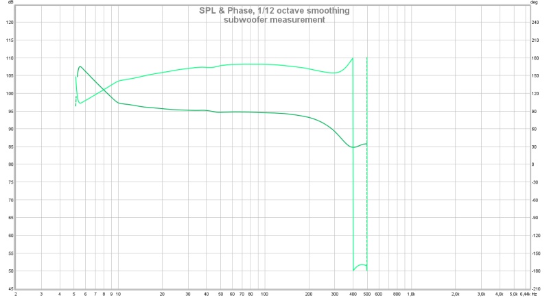

I Have did a measurement of the TQWT sub, because it was not yet good damped, now it do well and has nice plot.
Not used for horn, but I have small box together with that, the big open baffles are gone now. So I can sell them when needed, but it has to work.
