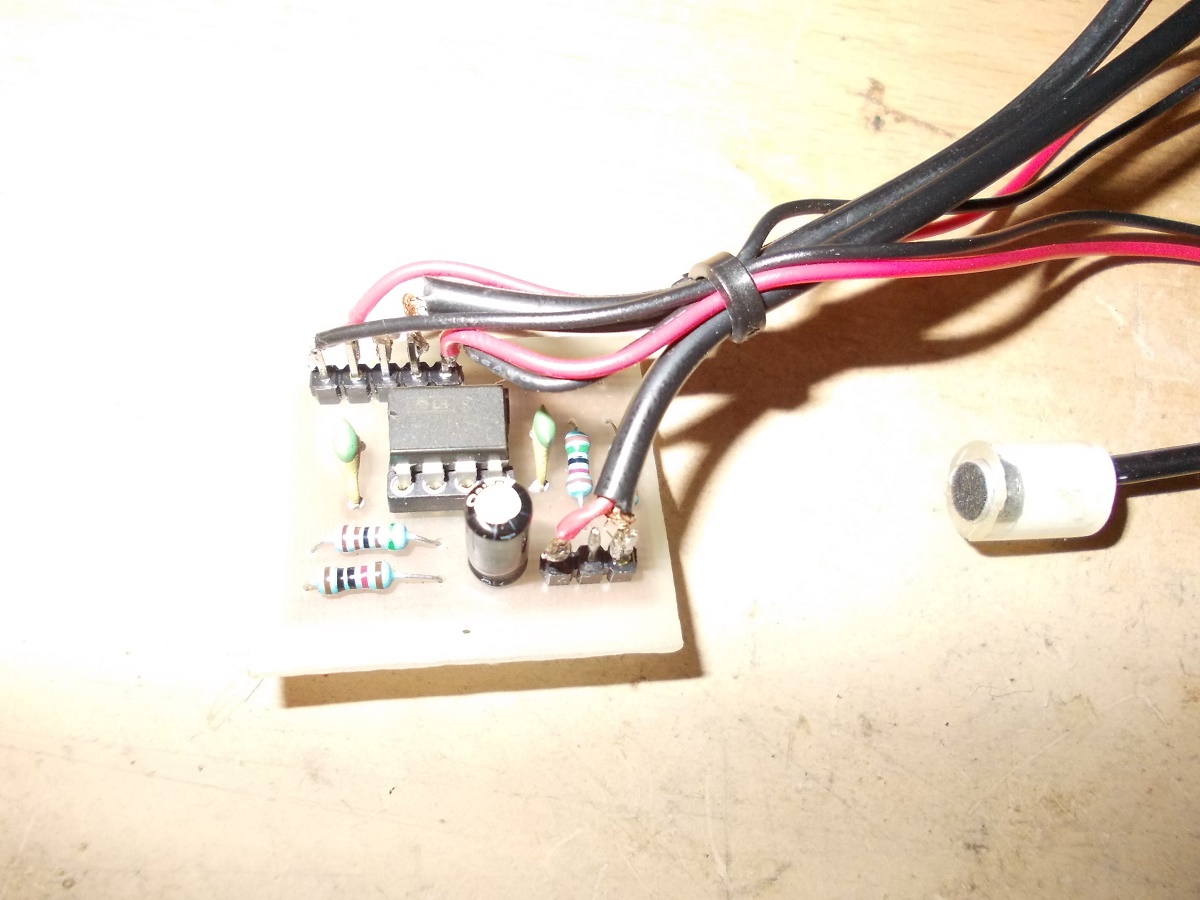

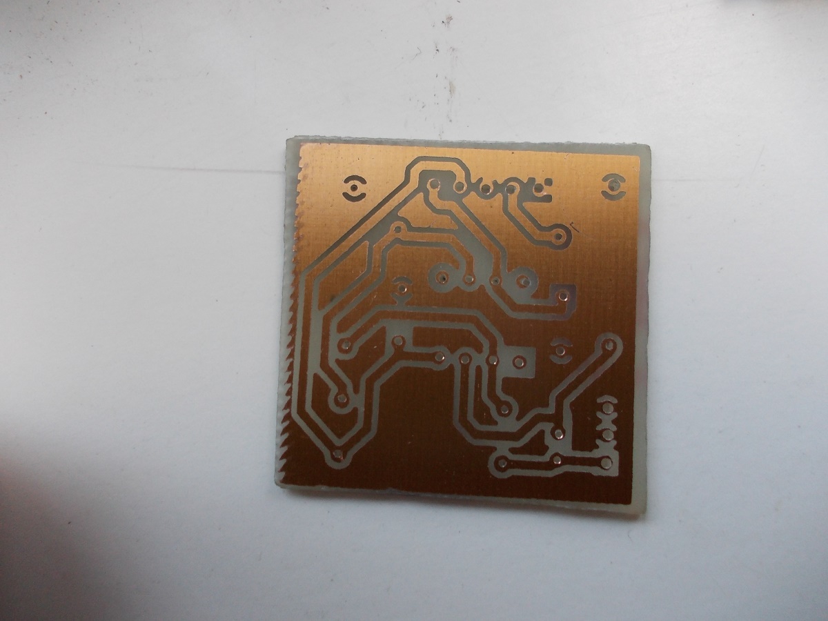

3.5 x 3.5 mic amp pcb is ready, now populate it.

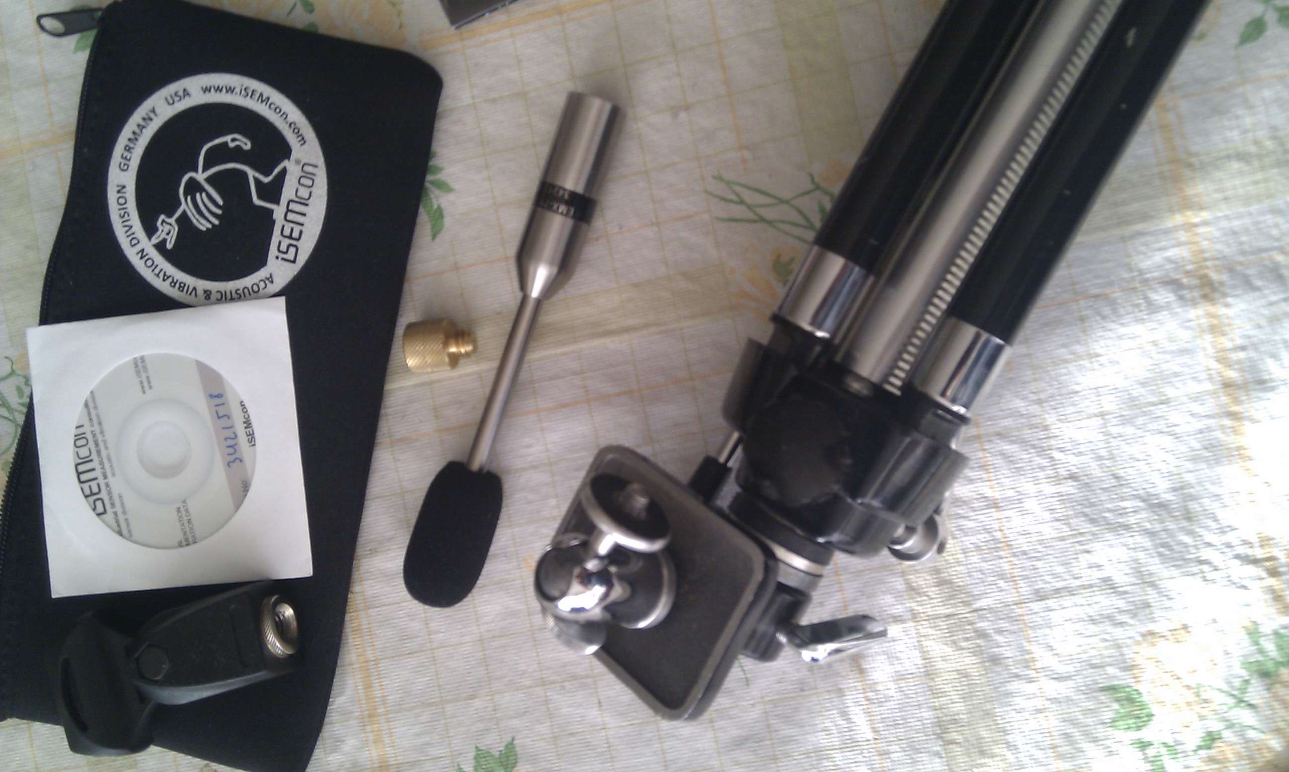

(PS : guys I found today the adaptator scew to putt my mic on the Photography tripod ! I know Wesayso want a measurement of my aluminium 6.5 mid and the whole speaker 😉 )
Yes, I would like to see what the Lynnfield can do too. Is it possible to do a measurement with and without the mechanical resonance absorber strut over the driver? I would really like to see quantitative data that it has an effect.

.....(PS : guys I found today the adaptator scew to putt my mic on the Photography tripod ! I know Wesayso want a measurement of my aluminium 6.5 mid and the whole speaker 😉 )

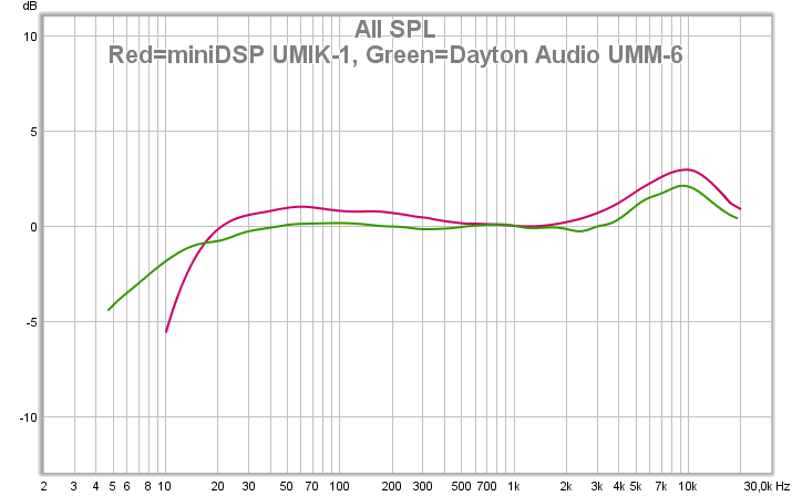

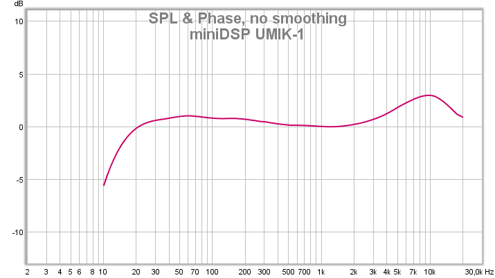

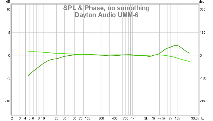

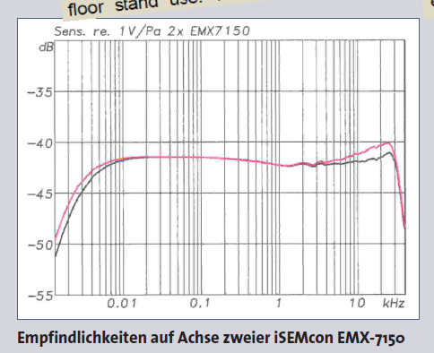

Nice mic 🙂 would you mind sharing correction file from that CD as "Import Frequency Response" into REW with X axis 2/30kHz Y axis 11/-13dB (SPL) 540/-540 (Phase).
Picture 1 is EMX-7150 response from brochure.
Picture 2 is my S/N correction file for UMIK-1 in REW "SPL & Phase" window.
Picture 3 is my S/N correction file for UMM-6 in REW "SPL & Phase" window.
Picture 4 is UMIK-1 and UMM-6 in REW "All SPL" window.
Look picture 2/3 UMM-6 has phase data added in correction file UMIK-1 has not.

Ok,
I will ask you how to do when I will re open the thread (soon as now I have all the stuffs : just need to install REW on the old XP laptop which has already Rew, and uploaded the semi-anechoic calib correction file; I have also the old ECM-8000 as well as an other point of view - without calib-)

You make nice PCB's! No wonder you are so good at custom amps.
:cheers:
Yes I am better with amps, loudspeakers are quite new for me, but I have to learn that also to get go further.

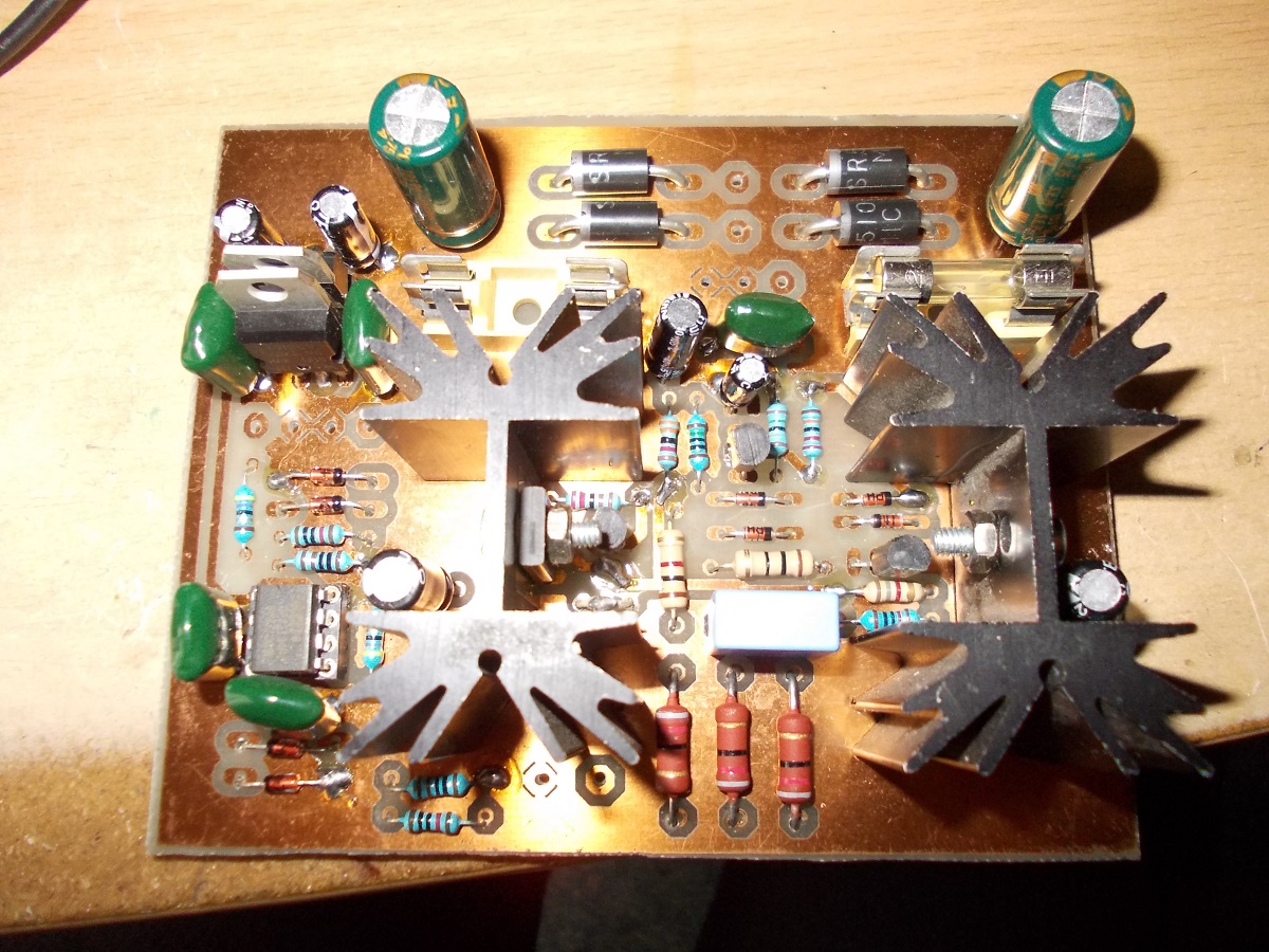

these are pcb ready for 1e mike amp a la Siegfried and 2e my own jig for speaker measurement having also a 10 watt class amp on it.
Last one is for later.
regards

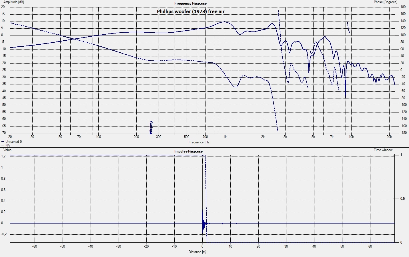

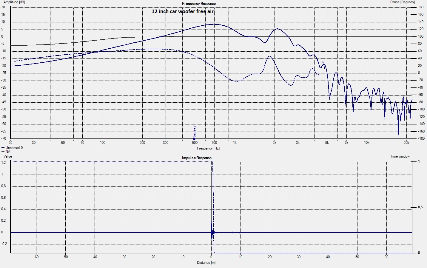

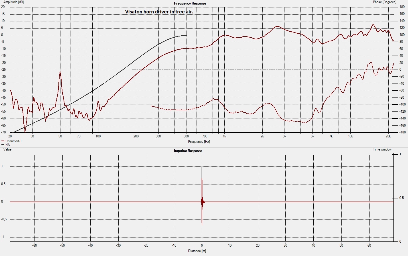

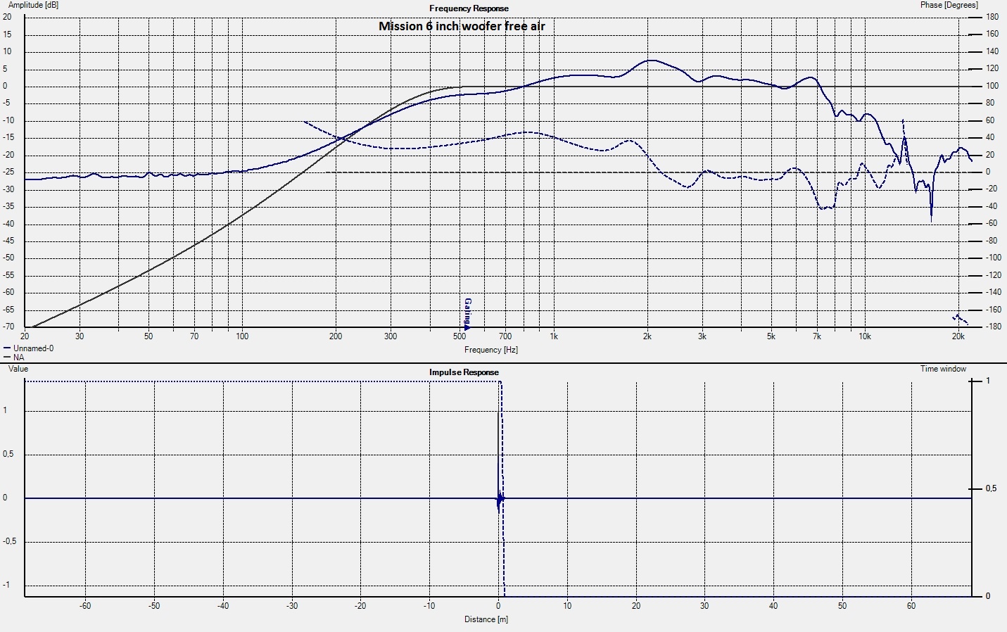

I have done measurements with the new amplifier and corrected mike.
Holmimpulse looks to do better then REW in my case, maybe trouble because of windows 10?
I think windows 10 is now so nice for this, and the audio codec on my pc has effects in them who maybe do not get off completely, seen the fall off below 100 hz can be caused that the mike is damaged or leaking, so I have ordered some new ones and a real usb soundcard so I have no more trouble with windows anymore. Or make a speacial pc for this kind of things with old windows version or linux.

kees52,
You made nice PCBs thanks sharing, regarding errors in woofer measurements in the plots you write "free air", wouldn't they then make weird canceling patterns and look strange and need a simple baffle to be better.
I did'nt now if speakers in a factory be measured that way, you are right using a baffle for good tests.
But you have a point, see link.
This explanes that tweeter do well in previous measurement.
https://www.jensentone.com/what_is_frequency_response_chart
