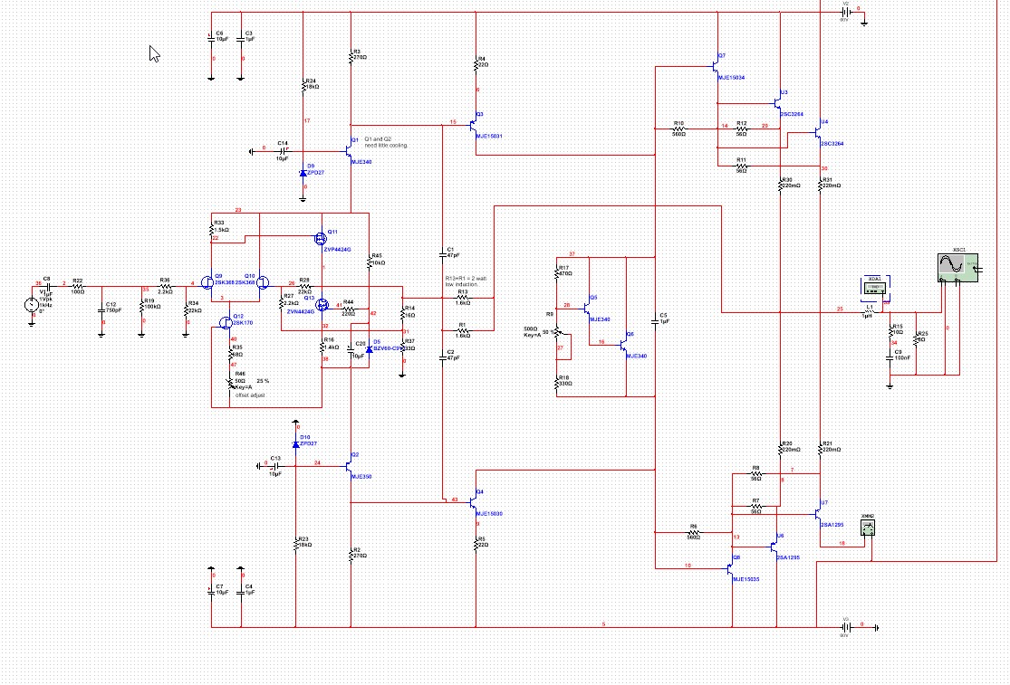

the first video is a new kind of hybrid without cathode follower but a high (100mA) current triode (2.5 mu) in cathode follower configuration give more even harmonics give warm sound with mosfet stage.

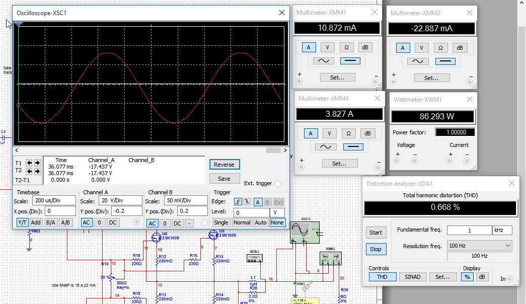

here schematic of second hybrid, dc coupled type.
I have also play with the alexanderamp current feedback bipolair version with ring emittor transistors as ouputstage with the discrete Nelsson pass opamp who do nice. see last picture.

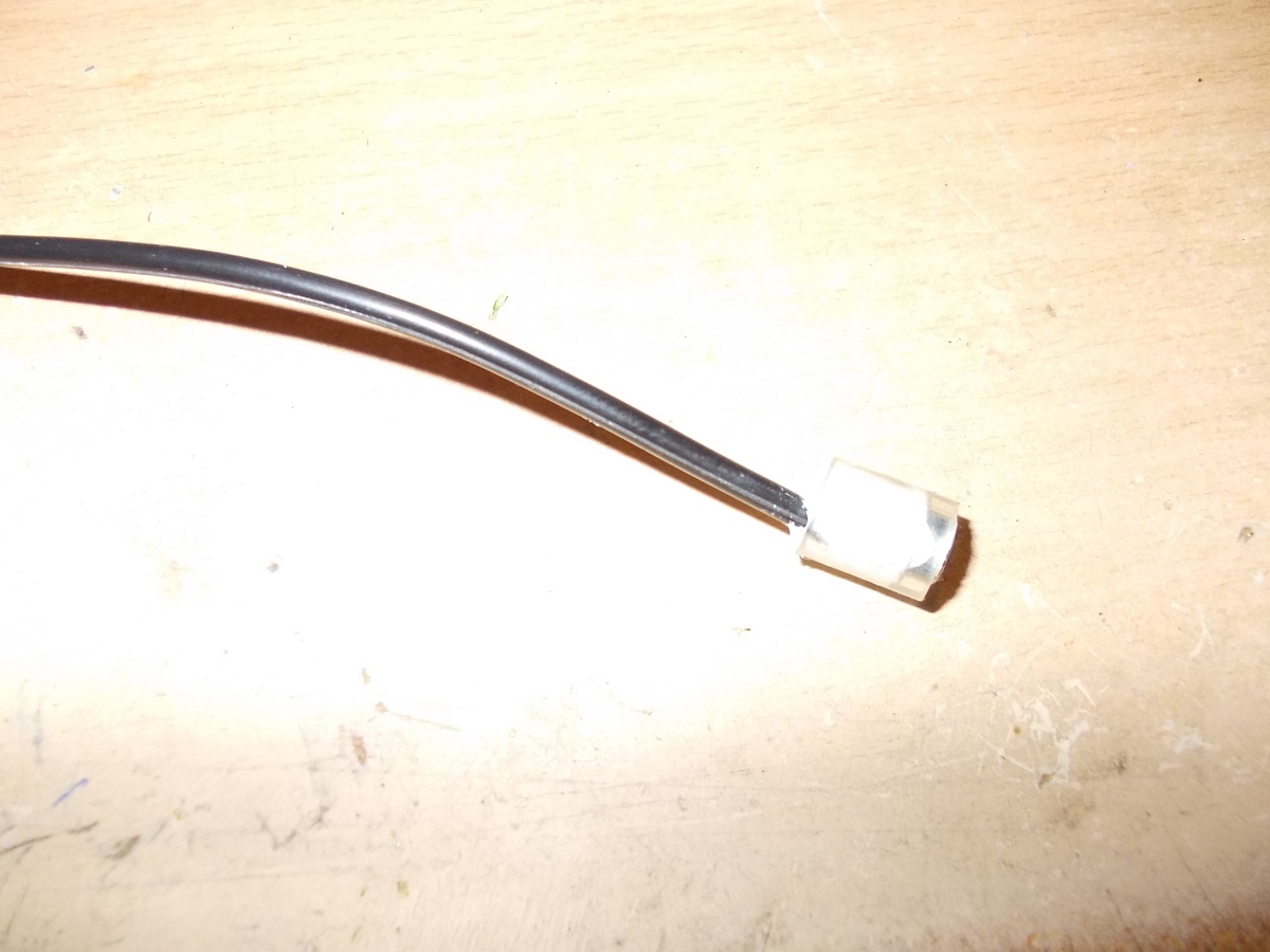

I have wounte the measurement trouble, it was resonance in the copper tube mike was in.
Yes, use glue to seal tube joints and interface with mic capsule. I thought you have a nice commercially made mike? Is the tube the stand mount holder?

You now, I like DIY, so I make it myself, I have the Siegfried Linkwitz mike, I have now gleu mike in rubber tube, and put that in a aluminium tube, that will remove the resonance.

mic is done, in a plastic tube and filled airtight.
Now it wil not resonate anymore.

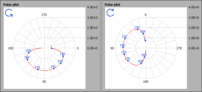

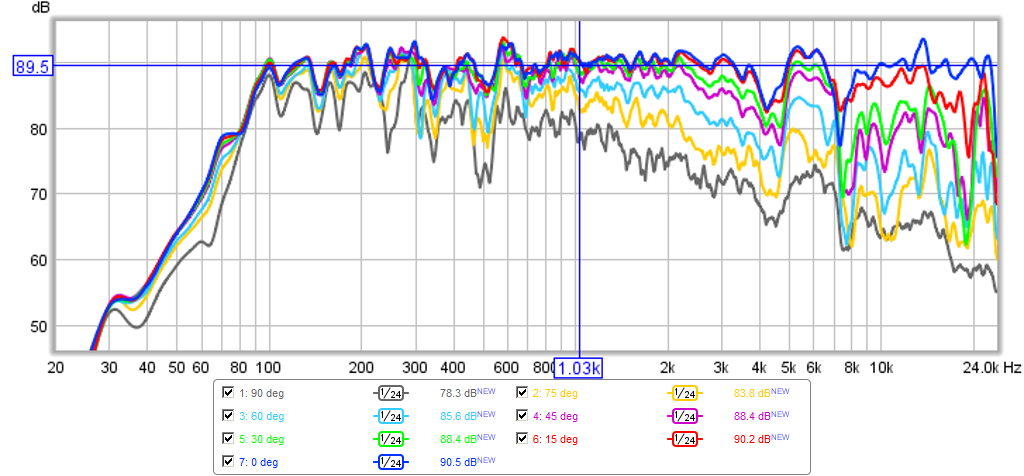

Thanks Kees, I'm not exactly sure how to interpret some of those numbers around the wave front. I was thinking of the polar measurement with the pretty colours.
Typically I only provide frequent response curves taken at various angles. There is a package somewhere that can take that and make a nice polar ply like Kees shows. That is basically a plot of SPL vs angle (think of angle like a compass and speaker is at middle ) extent of curve is SPL.
Oh ok, I think I get it. How come the spl is higher on one side than the other? Is that a corner?

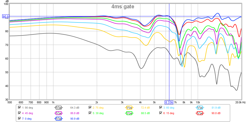

Polar response measurements
The mic was 0.5m away and +15 deg above horizontal plane. Data is over 90 deg half angle. First plot is un-gated, second is 4ms gated to remove room reflections. The throat notch anomaly carries through for all angles, the variation between angles appears smooth. The core beam width appears pretty uniform over 60deg full angle and directional below that. I am not sure what I can measure to show that there is directivity at 100Hz over a plain direct radiator.
Un-gated:
4ms Gate:
Un-gated:
4ms Gate:
