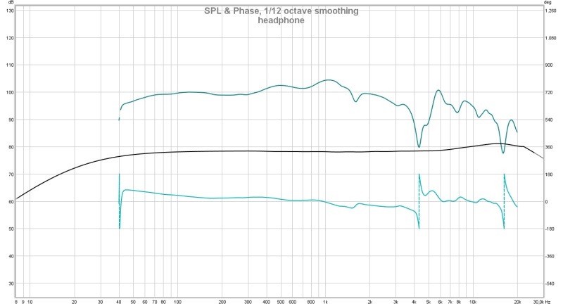

I have somewhere trouble with measuring, the headphone do now also dips quite heavy, I did hear also echo. think about RF radiation, so get complain again by house owner who rent it to me.
A headphone does normally quite oke.
Older measurements did oke, strange thing I have to solving before going do working further on horn, horn sounds well though.
regards
Doesn't seems fair people should have a home and live in such enviroment really feel sorry for you.
That said a point that could make things non-consistent is you seems run new free Win10 and that system is in so young a state where they throw out updates continueally that could change your experience, therefor would have more peace in mind had you run Win7 that we know would be consistent from measurement to measurement communicating/controlling hardware and software.
