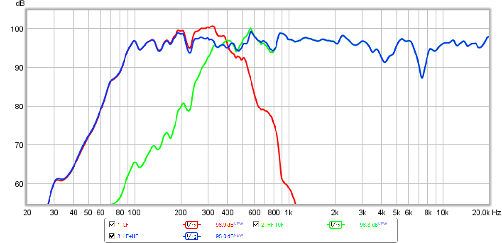

Here are the measurements for the 10F in the Trynergy at 0.5m. There are a couple of sharp dips at 4k and 7.5k that are due to some rough edges I have at the throat. Will need to work on them but sharp dips are not quite that noticeable. This is at 1.64v into the 8ohm driver or about 0.34 watts and I am getting around 96 to 98dB at 0.5m.
Here is the acoustic XO plot:
513195d1446925375-presenting-trynergy-full-range-tractrix-synergy-trynergy-10f-xo.png

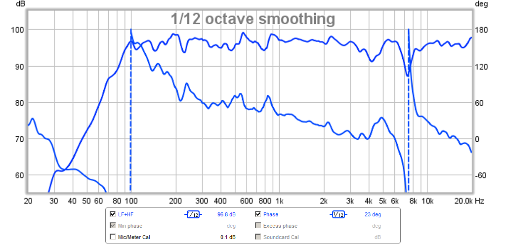

Here is the Phase:
513196d1446925375-presenting-trynergy-full-range-tractrix-synergy-trynergy-10f-phase.png

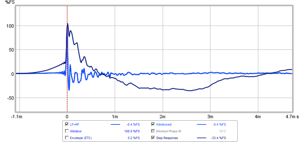

Here is Impulse Response and Step Response - there is some ringing due to the throat discontinuity artifact, and the SR does not go far since this is a 100Hz bottom end only:
513198d1446925375-presenting-trynergy-full-range-tractrix-synergy-trynergy-10f-ir-sr.png

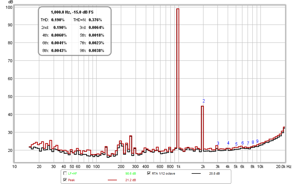

Here is the RTA looking at the HD with a 1kHz 1.64 volt excitation, I don't think I have ever seen a speaker RTA plot that looks this clean - mostly 2nd harmonic and non-existent higher orders. Some folks over in Multi-Way Forum were in disbelief that the 5MR450NDY in a tractrix had such low HD, but it was not even as low as this. This is probably the main reason why this speaker sounds so good on vocals. It is about as pure of a sound as you can get. The fundamental is about 98.6dB with a little over 300 milliwatts power driving it. The cone can't be moving much (sims predict in the tens of micro-meters). that's 0.19% THD at equivalent 92.6dB at 1m!
513199d1446925375-presenting-trynergy-full-range-tractrix-synergy-trynergy-10f-1khz-rta.png
