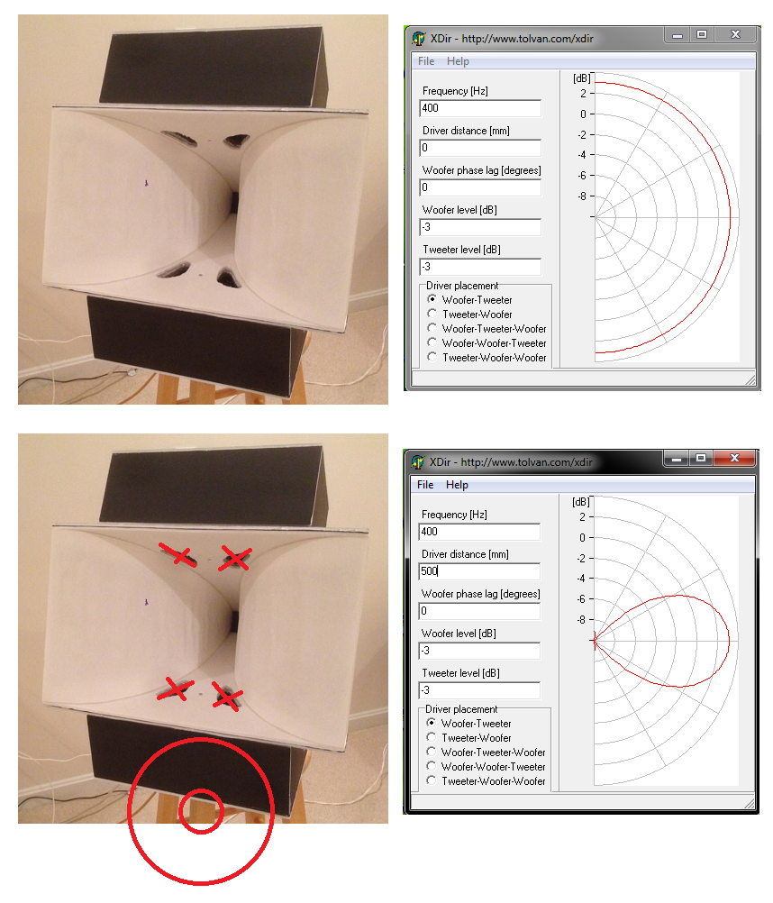

Think in long run seen with audiophile eyes it would pay back doing the extra work implement mid-woofers as xrk971 did to have ctc distance as a coxial speaker, and would improve vertical lobe at XO point so it doesn't matter if one is sitting or standing up. Below example vertical polar is a 400Hz XO point and ctc distance to mid-woofer set 500mm in the lower one. Also examples is with minimum phase XO types that have HP verse LP in phase at XO point such as BW2/4 or LR2/4 where a BW1/3 will have a tilted lobe.
Of course it would work having single mid-woofer below horn many multi way speakers has such a lobe scheme, but think xrk971 Synergy solution in polar response is improvement as was it a single point source.

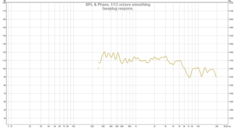

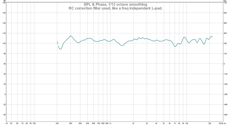

It is a lot action here. Well I have made a correction filter for the faseplug version, but the faseplug go extent to 4 Khz, after that I need again 10 a 12 dB correction making the horn lower sensitivity in my case 92 dB watt who is still 10 plus dB for this driver not bad for a 3 incher.
I go make a radial plug, busy now with making a saw on a table so I can do precise work.
I do have done measurement who has one close to horn and one with horn high in free air with 2.5 meter distance.
looks not bad, when damping the horn with roof leather it will be even better I think.

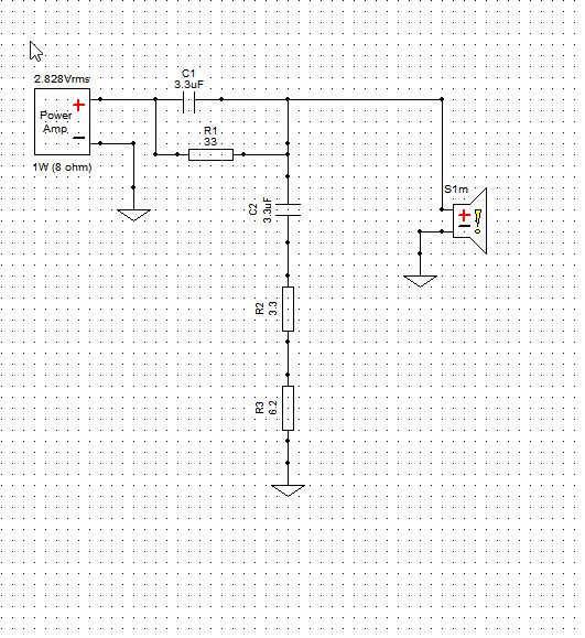

The correction filter is made with a cap and a resistor parallel in series with speaker, making it a kind of frequentie independent L-pad so to say eliminating some loss.
XRK971- the speaker need a qts lower then 0.40 my is also something to high, horns need a strong motor special for hf extention, a tangband wideband has very low tqs sometimes even 0.2.
I have removed the amplifier shelf filter from input, I go use normal speaker crossover for corrections, because it go to 3 a 4 Khz with faseplug I do think about making a three way horn, with tweeter and bass mid corner horn, this keeps 108 dB watt, and very low distortion, but for now I go on with the trynergy and ready for the bass part.

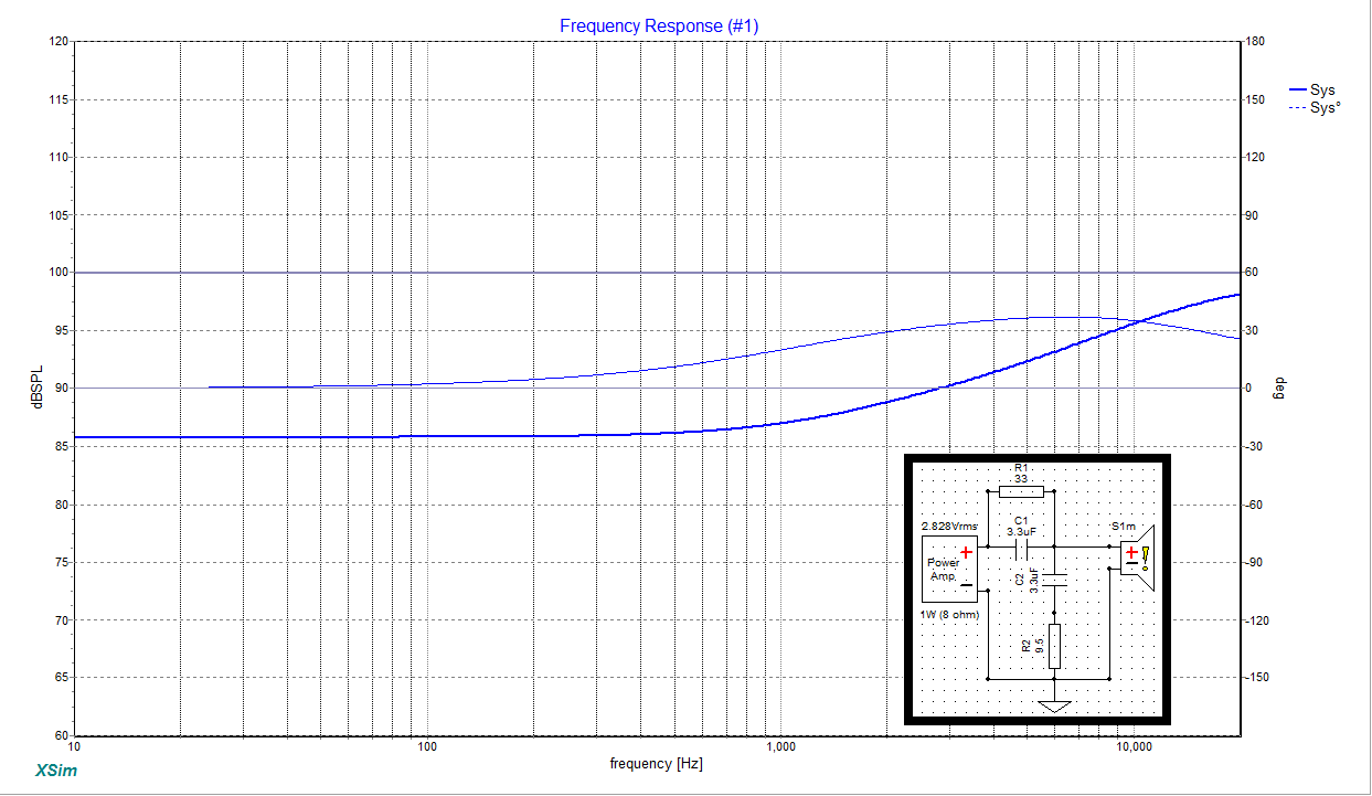

Great progress Kees. Thanks for the circuit. Would you mind showing on same plot with and without your equalization circuit? If we use a different driver, we would need to customize the circuit I suppose. So it is basically a frequency dependent low shelf filter, looks like 2nd order this time?
Don't forget to plot with 5dB per division (20 is too big to see anything).
Here what EQ kees52 circuit do to grey trace 100dB SPL textbook flat response driver, blue is with EQ circuit.

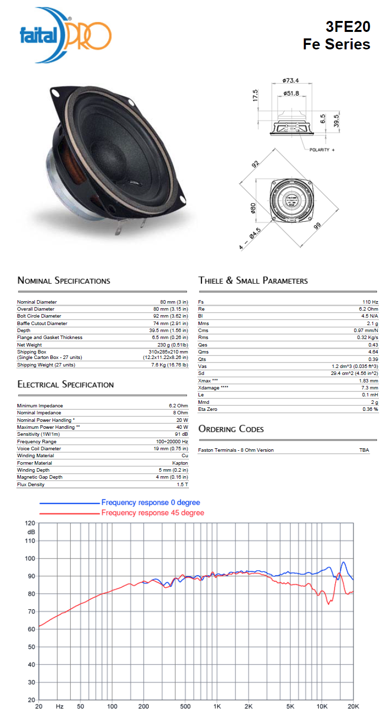

Also did find some other Qts <0,4 drivers other than TB brand at different costs.
First is obsolete Faital Pro 3FE20 but still available around in some shops datasheet says Qts 0,39.

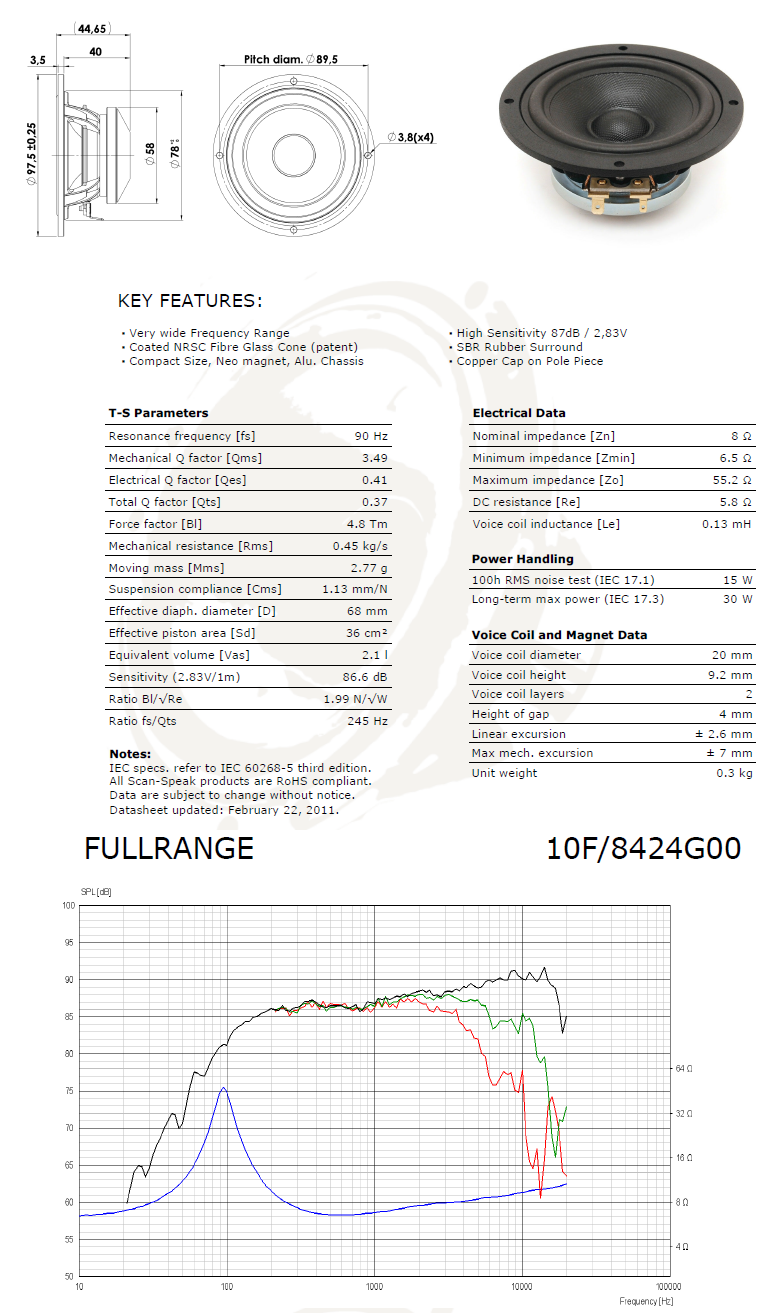

Third is SS 10F/8424 datasheet says Qts 0,37.

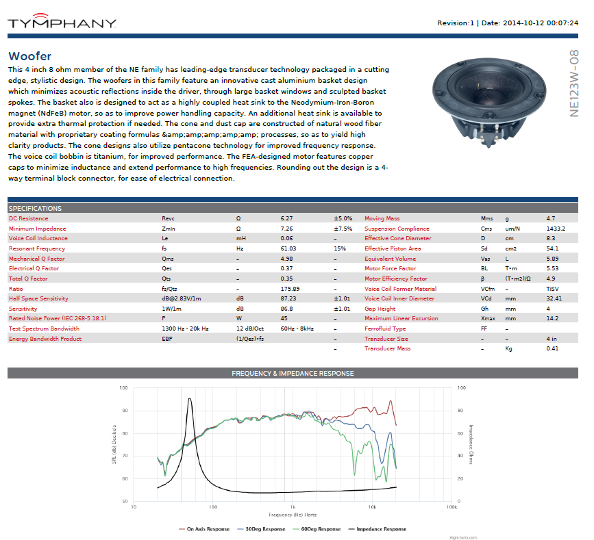

Fourth is Tymphany NE123W-08 datasheet says Qts 0,35.

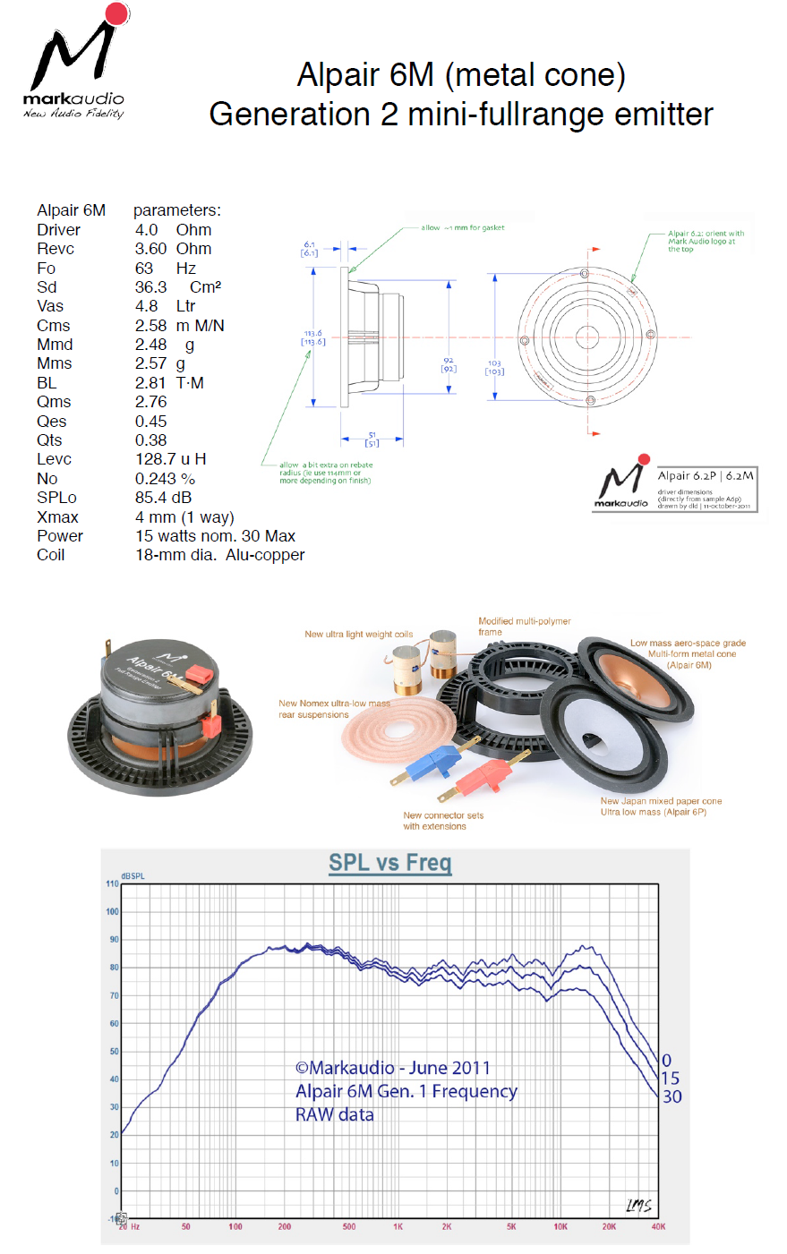

Fifth is MA Alpair 6M generation 2 datasheet says Qts 0,38.

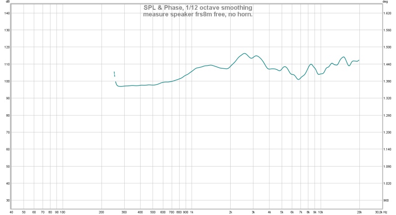

This moment I am busy without the faseplug, it looks like distortion occurs when use that, and because after 5 Khz we have to use a 10- dB correction then I have bot use that plug, and horn do beam with the plug also, maybe the radial version do not.
First picture is without filter right on the amp output.
Alpair 6 M looks oke, has a very strong cone.

kees52,
Could look like response from either 10F/4424 or 10F/8424 datasheet would suit fill some of your dips, bad thing though they not as low cost as Visaton FRS 8 M. From datasheet Alpair don't suit here with the dip at 9kHz but often seen they perform very different from datasheet in real world so it could surprise, at www.oak-audio.co.uk they ask £77.00 a pair.

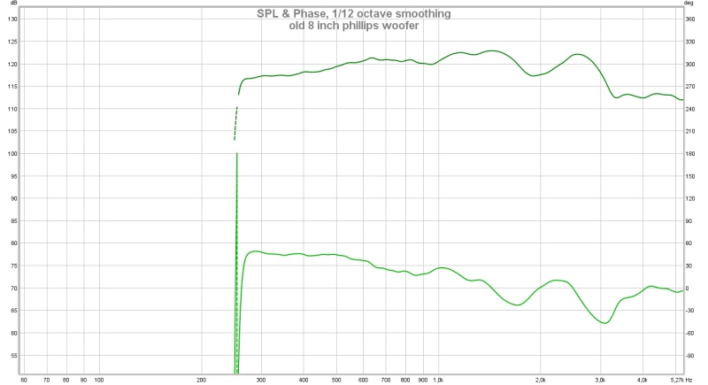

I discover that the visatons do resonate, sounds like a spring, start already with low volume, also after I have use a ferrite ringcore for the mike to get RF out, I did measure again, also here the visatons are very badly made, both. in free air she alse ring very much, and I have a lot of peaks.
see pictures of the old phillips and the visatons, it is quite clear. And still I am not
pleased with the mike amp, distortion because of RF radiation, so I need to make that first
oke, I go use a opamp from burr brown.
