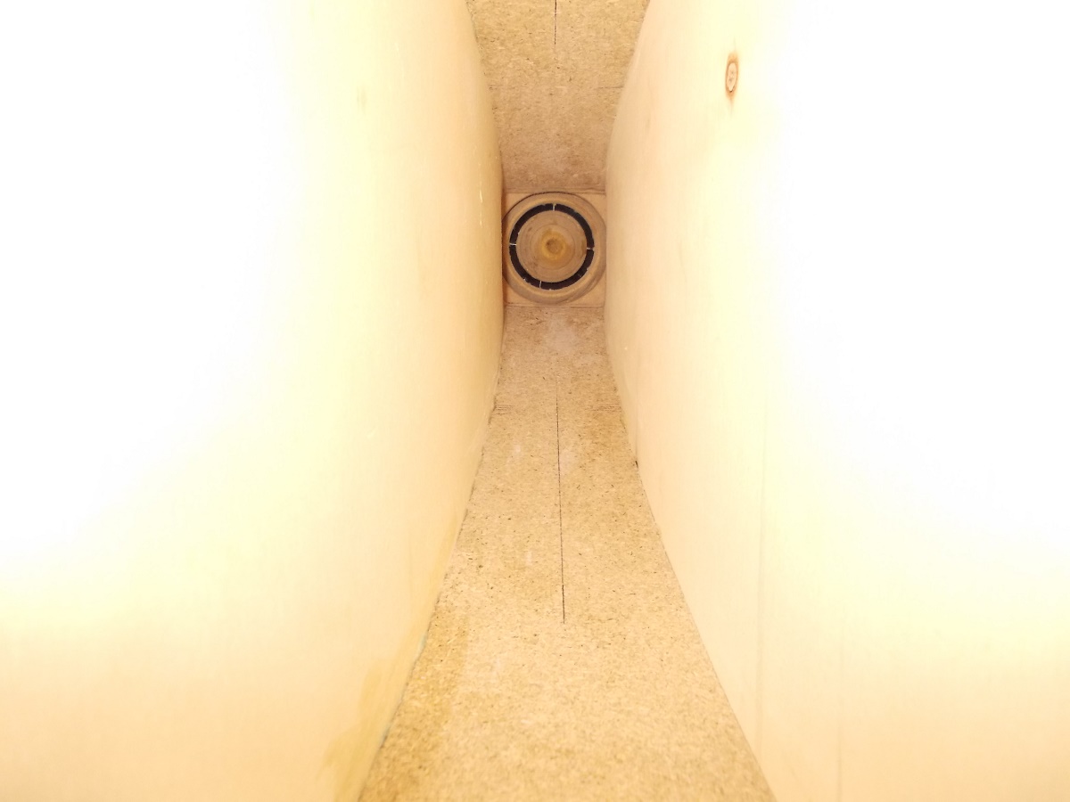

Presenting the Trynergy - a full range tractrix synergy.

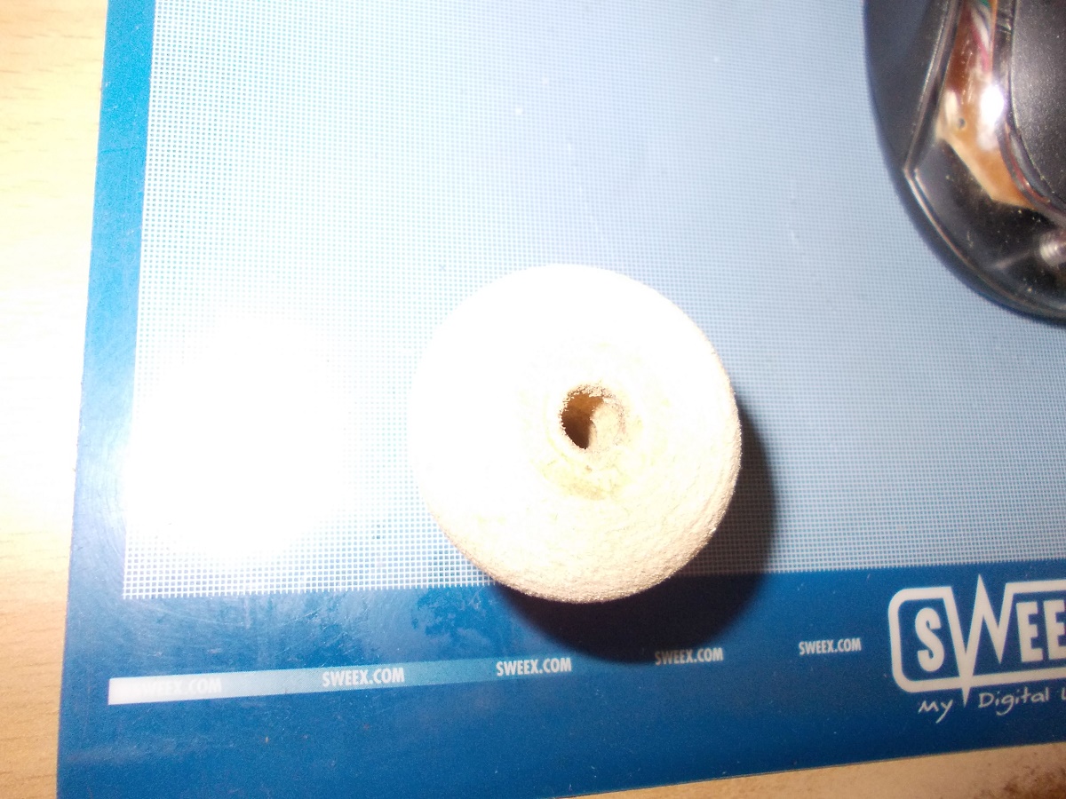

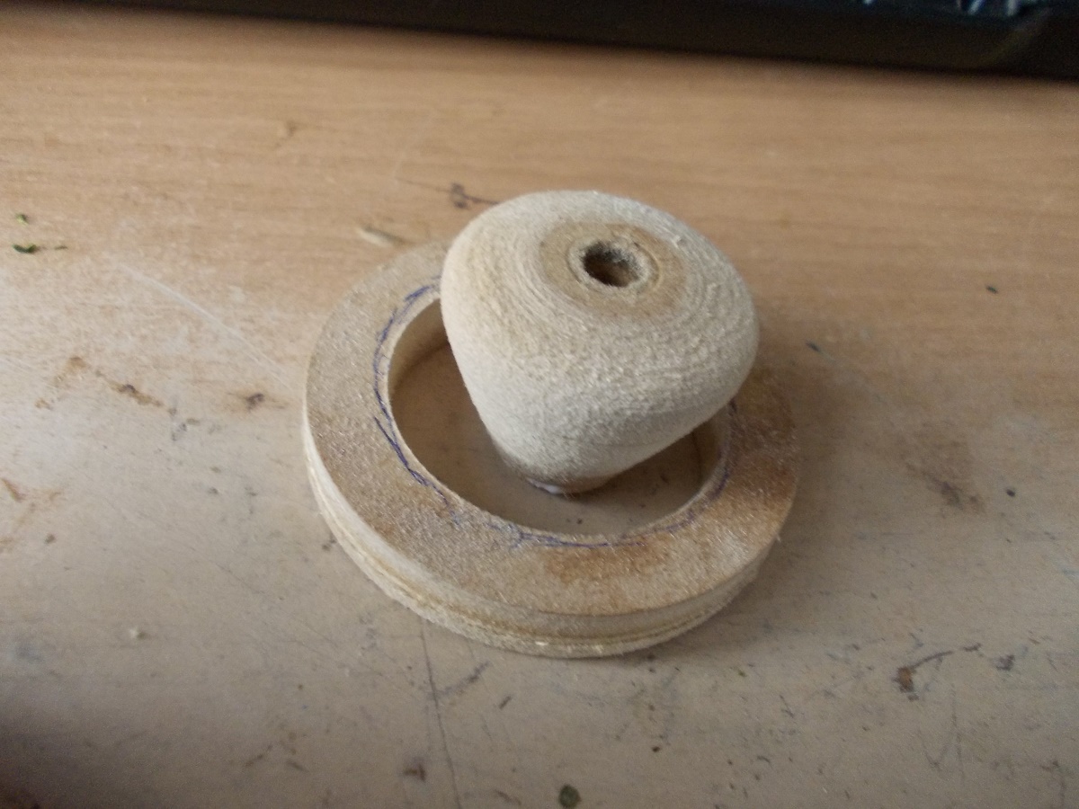

I did some tests with making faseplugs but working with a woodlathe do need practicing, the big lathe can also make bigger horns if i get love with it.

Nice work Kees. Can you please provide a sketch of the phase plug dimensions/plan? Maybe we can try to copy what you have done? I have a 3d printer that might make quick work of it.
You now I have to do it on speculation, I have no faseplug calculato
r software as I did see http://www.speakerlab.it/PPS.htm have one.
I use compression factor on eye en test it so I will let now dimensions afterwards.
regards
kees
I have now done the plugs and go start measuring this week. I am curious about the extension of the hf, the less it needs correction the better in words of distortion.
Plugs are not perfect, need a better machine and some skils, but The wooden horn was also the first time I did such wood work, tools are needed..

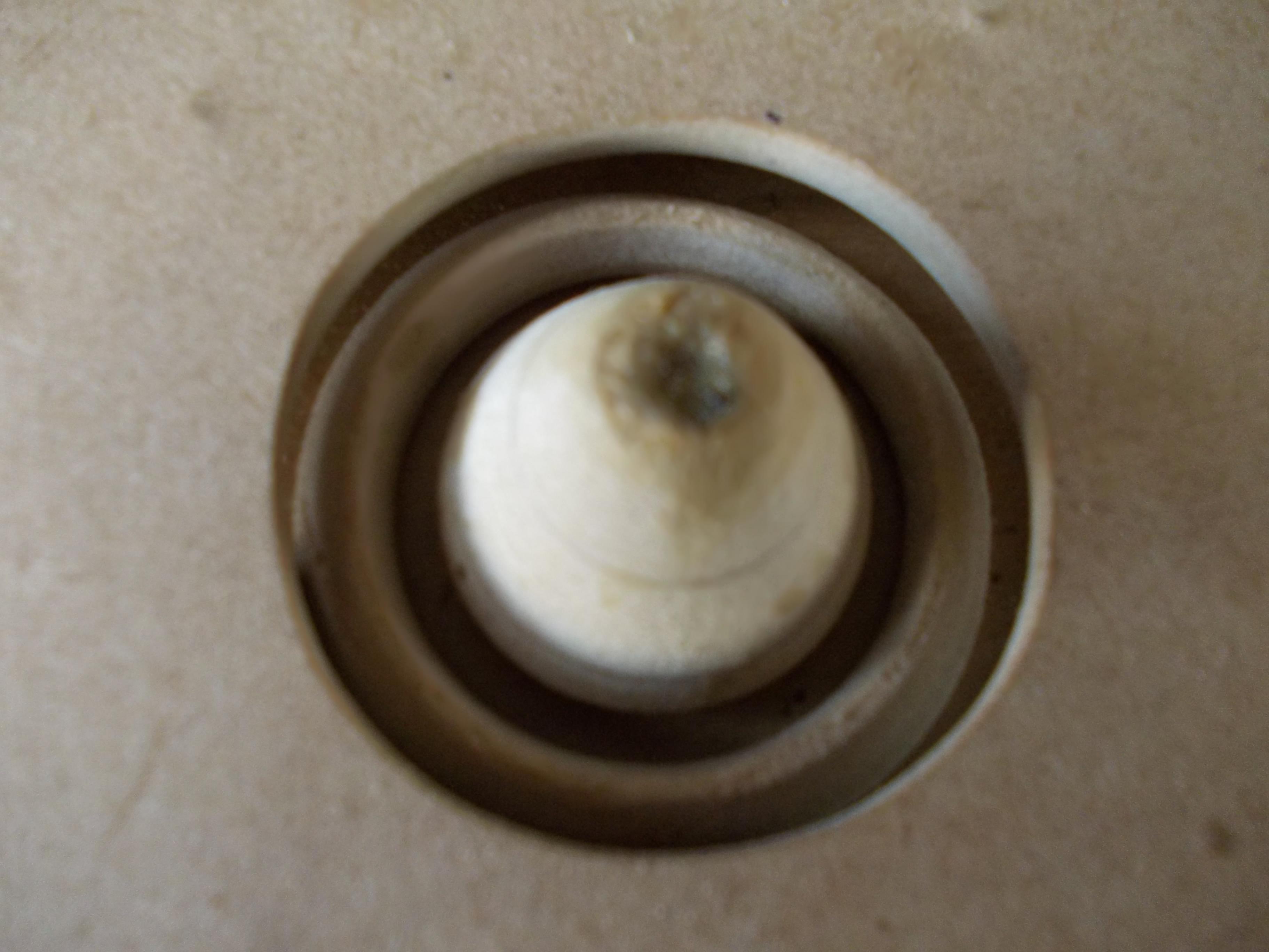

It is made and put in horn, sound is recorded and go on youtube or cloud.
see picture of plug, it sounded also more powerfull, recorded without filters, straight on amp, I let later see the measurements, I am busy now.

Nice work there - looks very professional. I am amazed how small the cross sectional area of the actual "throat" is through the phase plug. Are you saying it doesn't need the high pass cap?
I do not yet now how it will do in HF, have to measure, but have strange things with windows 10, like when download a recorded video from sony mobile phone it go take a movie elwhere from a harddisk , crazy windozs.
sound do wel without a cap, I go upload that later and put it here.
I do not now what is left over from crosssectional area, I did gamble here difficult to measure, maybe hornresp need a faseplug calculator or someone who can write that.

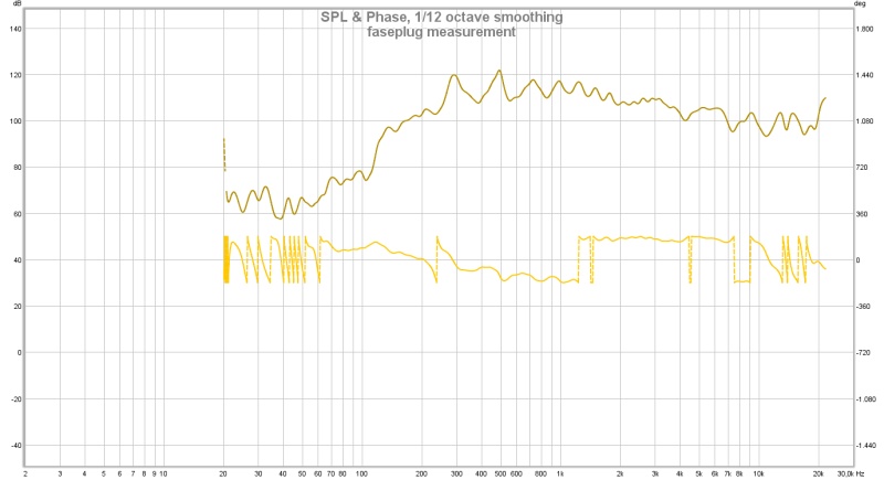

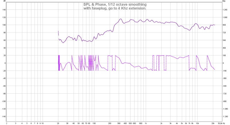

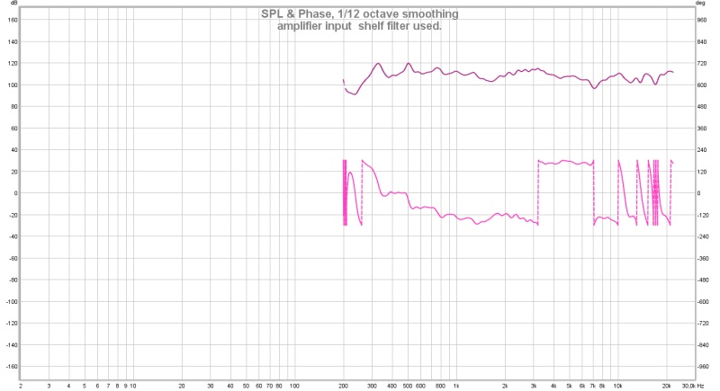

did measurement it exyens now to 4 khz before fall off, was first 1.5 Khz. so need really smaller path and I go so try a radial plug. First I go try also a filter this time a shelf for amp because fall off is different.
Measurement is without filter or shelf, but straight from amplifier output.
regards

Shelffilter used and measured, it need half less correction as before faseplug, so it is worth furter examination, but making faseplugs by hand is a art, timeconsuming but fun.
Dips can be resonances of the wooden horn, I go damp that stuff. maybe backchamber need more stuffing or cone breakup problems.

Things are progressing nicely! It seems the polarity is wrong again though, and the scale is way too large (~400 dB). Set it to something like 80-130 dB and the frequency-axis to 200 Hz - 22 kHz.
I'm guessing you could use some gating to get clearer measurements as the interesting frequencies are above 200 Hz. A 4 ms window is easily achievable even indoors, just keep speaker and microphone more than 1.2 m from all surfaces and use the "IR Windows" button in REW to set a window that is 1 ms before and 4 ms after.
