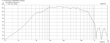

Ok I just ran sims with Delta15LFA in Univ Classic. You are in luck. It sort of works. 98dB from 48Hz rising to 107dB at 100Hz and 103dB at 500Hz. The high Qts gives some deep extension for a Univ Classic. Will post graph later.
It possible give a bump on the low end. not that bad and sometimes seen as a gift.
regards
🙂 Why not, a little extra bump in the bass can't hurt, and the minidsp makes it easy flatten the rise at 100hz
Because the Uni Classic normally starts falling off at 70Hz, the high Qts "bump" actually compensates for the fall and it is flat to 48Hz with flat shelf to 70Hz rising to max at 100Hz. All smooth rises though so a bit of EQ will work nicely to form this into a 98dB system. Seems a good match for 95dB TC9FD in the single cap post HPF to flatten per Kees 3.5kHz 6dB/oct filter. This may be one of the simplest all horn 2-way covering 50Hz to 20kHz for peanuts.

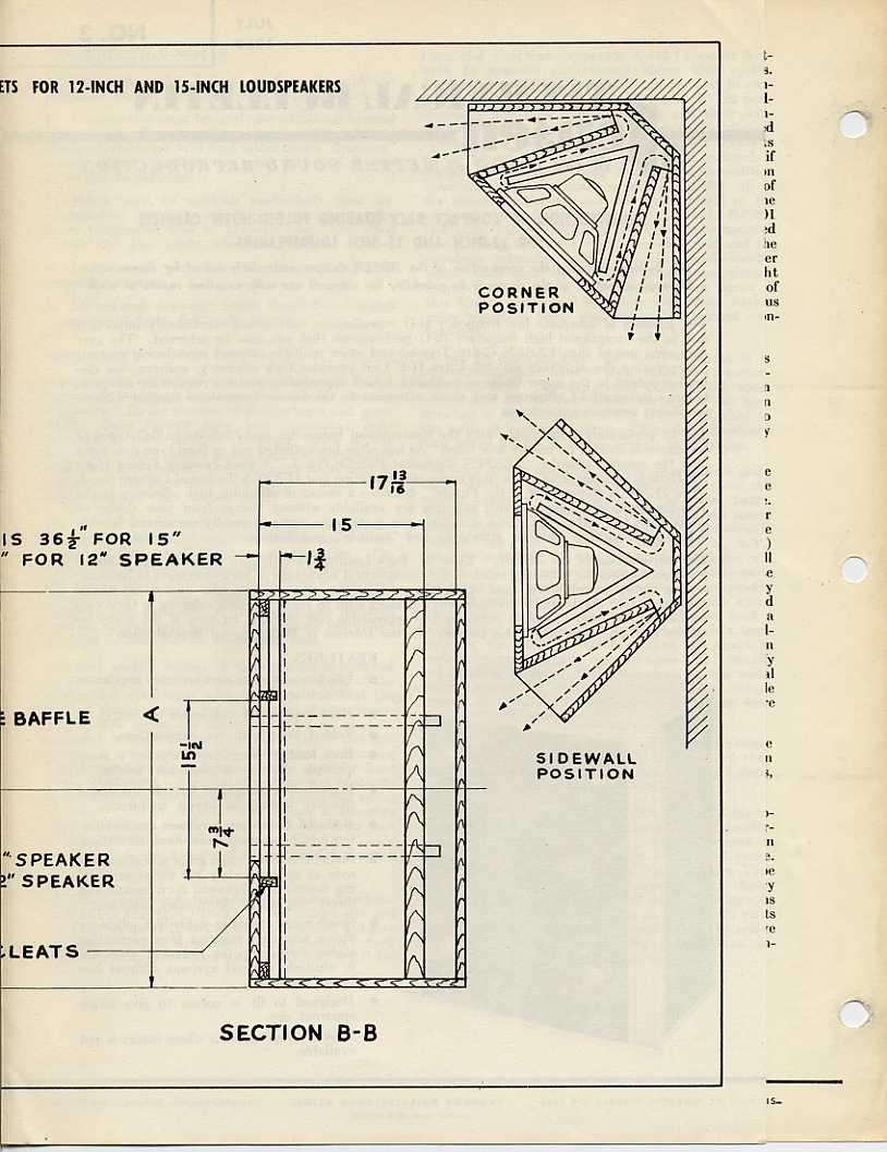

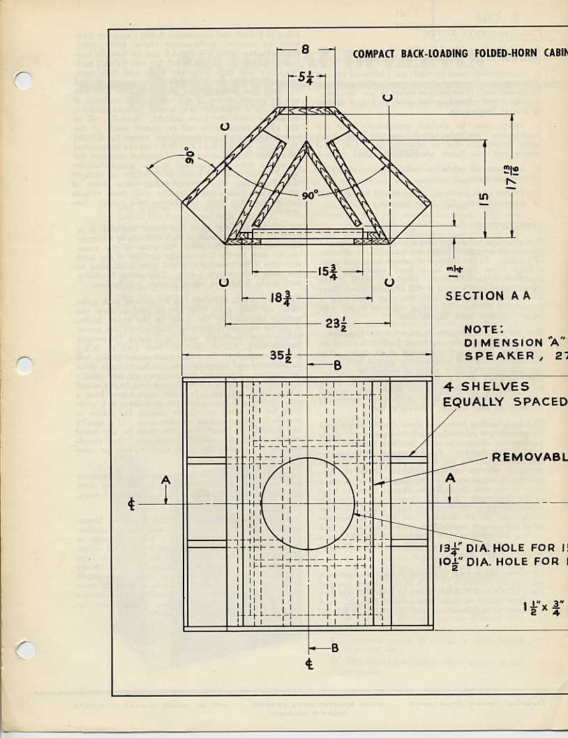

Just to confirm xrk before I scale, print and start cutting wood, these are the correct plans?
Mainly I don't quite understand the 2 flares drawn on the top and bottom Plan pdf?
Those are correct - scale so that throat is 2.0in x 2.0in.

Back to the horn, I feel stupid for asking but I am still a bit confused by the ..." this curve represents" line in the 'top and bottom' pdf. Which line am I cutting on? Like I said, stupid question but it's early here and the coffe ain't doing its job yet!
Microsoft is finally monetizing all their data collection backends the way Facebook and Google already have, it's the way of the future unfortunately. I still haven't found a Linux distro that works with everything I need for day to day business relationships so it has just become a game of risk minimization. You pick your battles I guess.
The drawing is a view showing the side walls attached and it is normal to the bottom wall so you see a perspective of the top edges of the side walls as the curves not labeled with arrows.
Personally I would not cut the bottom or top wall along those curves but leave them oversized like a rectangle and draw those curves on the bottom and top wall. When you cut out the side walls and force it to curve to the drawn curve the panels will self-assemble the tractrix profile. That is, by forcing the boundary condition of the curves side wall to the line on the flat it forms the tractrix curve.
Having extra material on top and bottom leaves room to mount the woofers of you choose to do that and it gives more strength to the structure. Kees cut all joints including top and bottom but that's not what o would recommend.

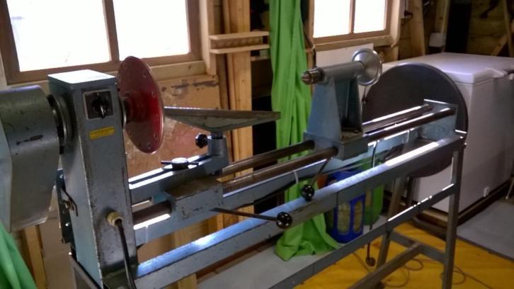

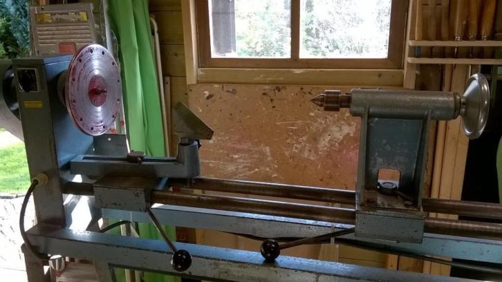

Here I have place the pictures about the way I did made the horn. post 508, 509, 510, 514, where the mold are and the clamps.
here the lathe, costs are 100 euro ex shipment..
