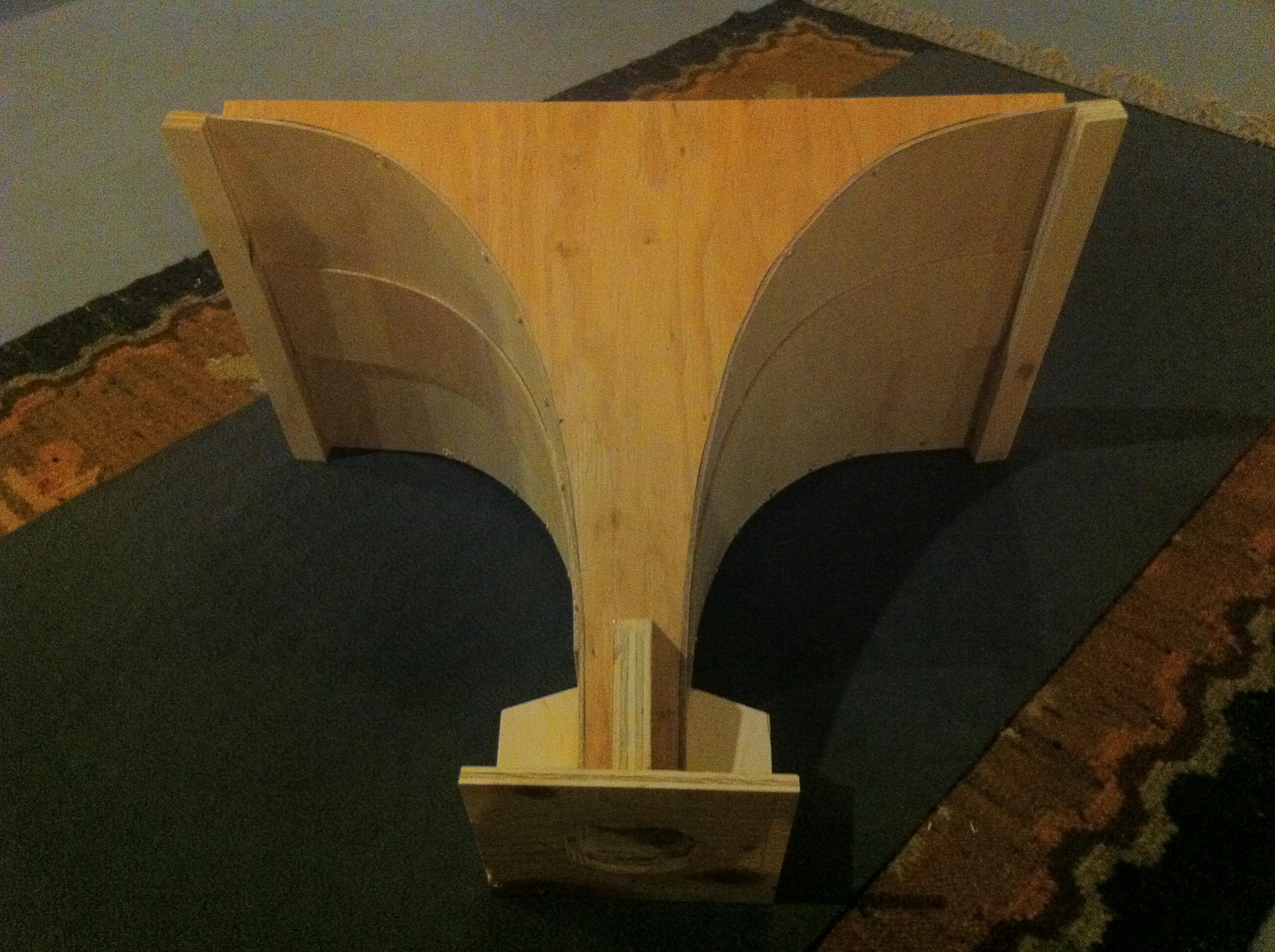

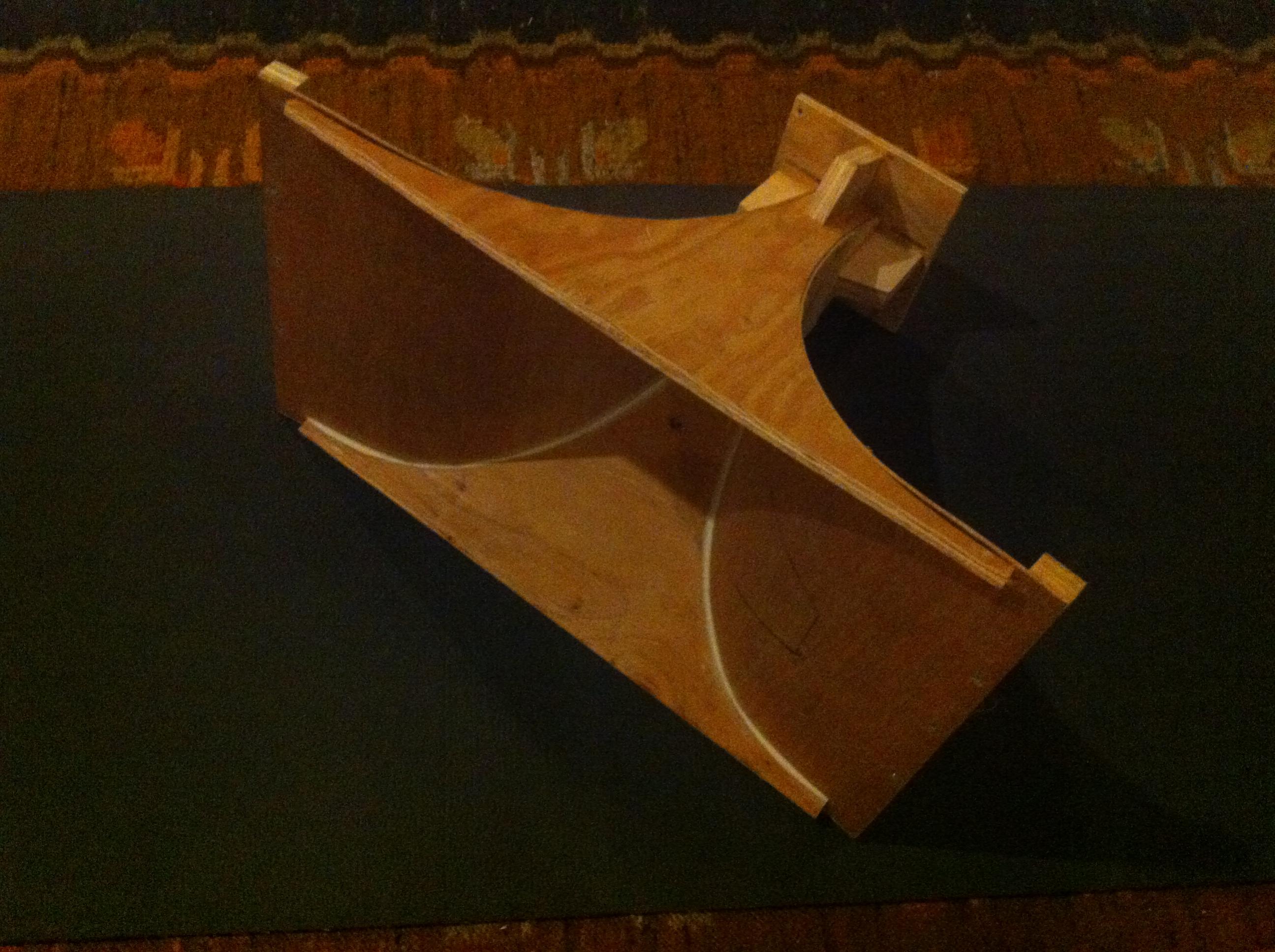

Hi all, my friend and I built 4 wooden Tractrix horns (Faital 3FE22) for renegade outdoor quad performances/parties. It wasn't all that hard, but the thin plywood required a pre-soak (16+ hours wrapped in very wet towels under a trash bag to prevent it drying out) and it took our 4 hands to accomplish the bending/curve fitting of the ply to the top and bottom walls. (The best way to fit the sidewalls to the curves is to face the horn down and just press the curved walls into place. This could almost be done by 1 person alone if they had flexible clamps.
I believe the ply is 3 layers of furniture grade hard wood, but my source was scraps from a burning man project so I'm not exactly sure what wood we're talking about (no, i'm not a burner).
So we built 4 of these over 2 days... The first day we cut the 8 side panels out, the 8 flat top/bot panels and the rear chamber boxes and started some assembly. The second day we screwed/glued them, stuffed the boxes, and basically finished the design as shown in the attached pictures.
They are incredibly light. They required a thin CLD layer along the side to reduce woody tone/resonances. Due to the construction style if you cut it to just the right size it is forced to curve onto the horn body between the stabilizing fins (cause it's obviously a torpedo) and the horn mouth brace that keeps the thin plywood from bending like a jbl2360a... (It will bend like a 2360 if you don't brace it, really).

Notes from our build: The tractrix curve templates didn't print symmetrically, so make sure those are working how you want (possibly fold them to get symmetry as the files on DIYA are oddly non-symmetric? Make your curved horn panels slightly larger on the vert axis (so the CSA of the horn doesn't change) and you accomplish the correct/simulated tractrix profile. If you adopt the construction method shown you'll be making the throat and horn profile slightly different than XRK presented. The recess for the driver isn't needed unless you're seriously going to exploit the SPL potential of these. Take care with the throat entrance... Keep everything as smooth and uniform as you can as any changes at this point will be that much more audible (small problems get amplified and recursed)...

Looks great thanks sharing build data, curved panels looks little thin but braced by the CLD layer, do you think this solution is also good enough if bass solution will be injection ports as xrk971 did.

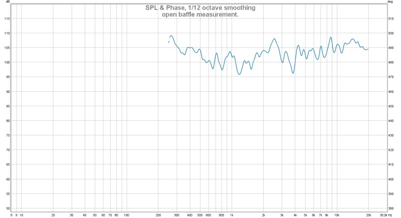

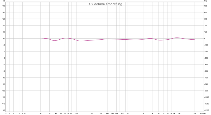

I have done measurement with the open baffle and the horn, looks like both has a very common outcome. Something here is not oke, put it in a metal housing did not work.
possible the mike itselfs is a problem, but in past I had nice measurements.
Also the soundcard can be a cause, maybe a usb soundcard is best.
picture one is when it did well, it is smoothed 1/2. strange it is suddenly not who can point to radiation, the scope do see pulses.

The throat is slightly rectangular because I didn't resize the template curve for the side panels (like I suggested in my post above)... A quick mental review suggested the profile was still the same, just the total volume of the horn had changed slightly (no?)... Hopefully I didn't compromise the FR too much. They sound pretty good, but it was a known compromise given I only had 2 days to make 4 of them.
I had a chance to listen to the painted and glued CLD version this morning before sending it off to play records in a 1930's hotel powder room (art installation) and it has a surprising amount of bass when used without a crossover... In the near field the direct radiator portion of BW makes it seem almost like its full range. Low volume listening is kinda fun although IMD becomes an issue pretty quick. How did you tune the rear chamber of this horn? For low mids to HF I would have thought a sealed back driver would have been closer to reactance annulled... I'm glad it's not as it's more fun to play with an adjustable back chamber volume.
I really like the Faital 3FE22 in a tractrix. It's quite pleasant.
