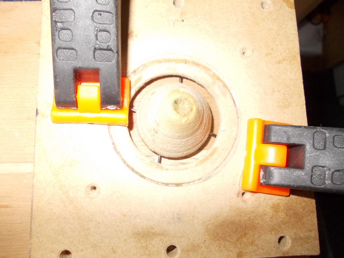

I am started again with the preserving of highs, with faseplugs, mike is oke, I can measure now.
Idea is as little of space between cone and horn throat, but never less dan xmax afcourse, so I go use plaster and food folie between to make a print of the conus.
regards
I have strated again faseplugs, I just want to now what I can do to prevent to much correction, because this 12 dB can cause extra distortion.
Here a pic of a single ring and not two, because the speaker is already so small.
regards

Nice work in phase plugs Kees. You said you made a mold of the cone shape. Did you use this as the profile for the lathe work to turn the phase plug shape?
I have not yet a mold, no not for lathe but to see how cone shape is, so I get precise print of it, us very thin plastic between plaster and cone so it get not wet.
This moment I do make a saw from a sigsaw for making precise cuts like a model saw.
regards
kees

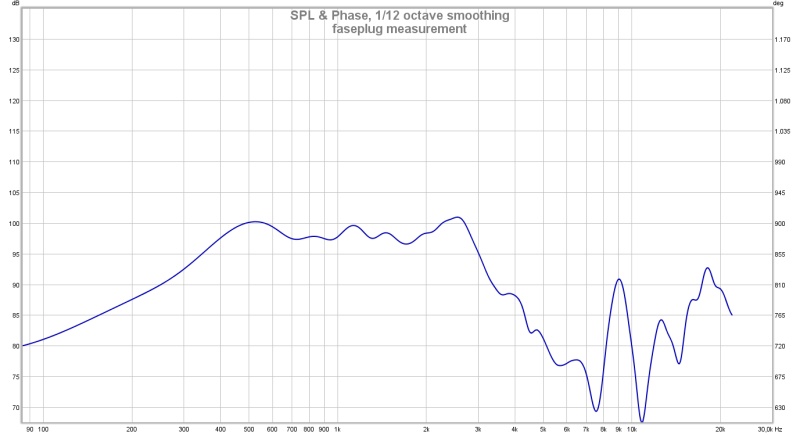

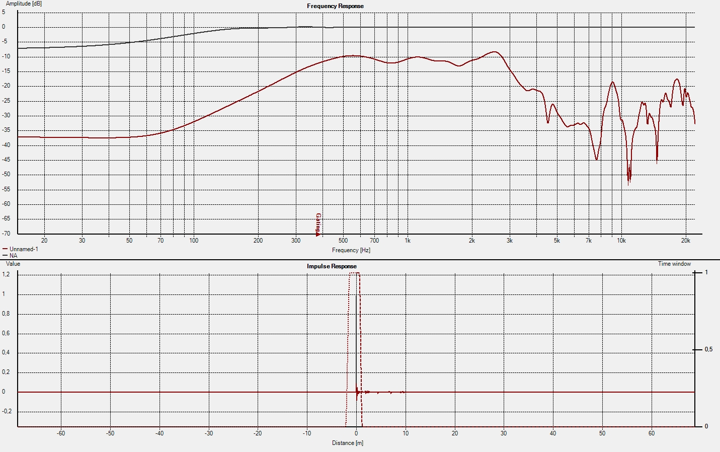

Hi all
I have done a measurement with a faseplug who has only one split, but that give in hf big peaks, however, from 400 to 2500 Hz it has a very nice plot.
Seen the polts are identical, the mike do work not as it has to.
Next step a new faseplug a la radial, maybe that will go do better.
We talk here about a very wide bandwith who has difficulties but exciting ones.
regards
