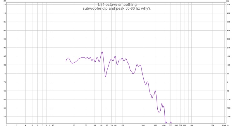

Who can explane me why the subwoofer do this on 52 Hz, it is not removable with damping or I do not now where to do that, I have done it with hornresp but then in real it do not, maybe the visaton who has big VAS is the problem, I can do isobaric them I have more wsp26s.
thanks.
regards
thanks.
regards

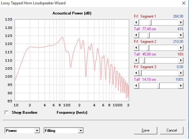

this go to 20 Hz and it is a T-TQWT see hornresp picture.
the sim is now isobaric, I am busy to make them that way to halve the VAS.

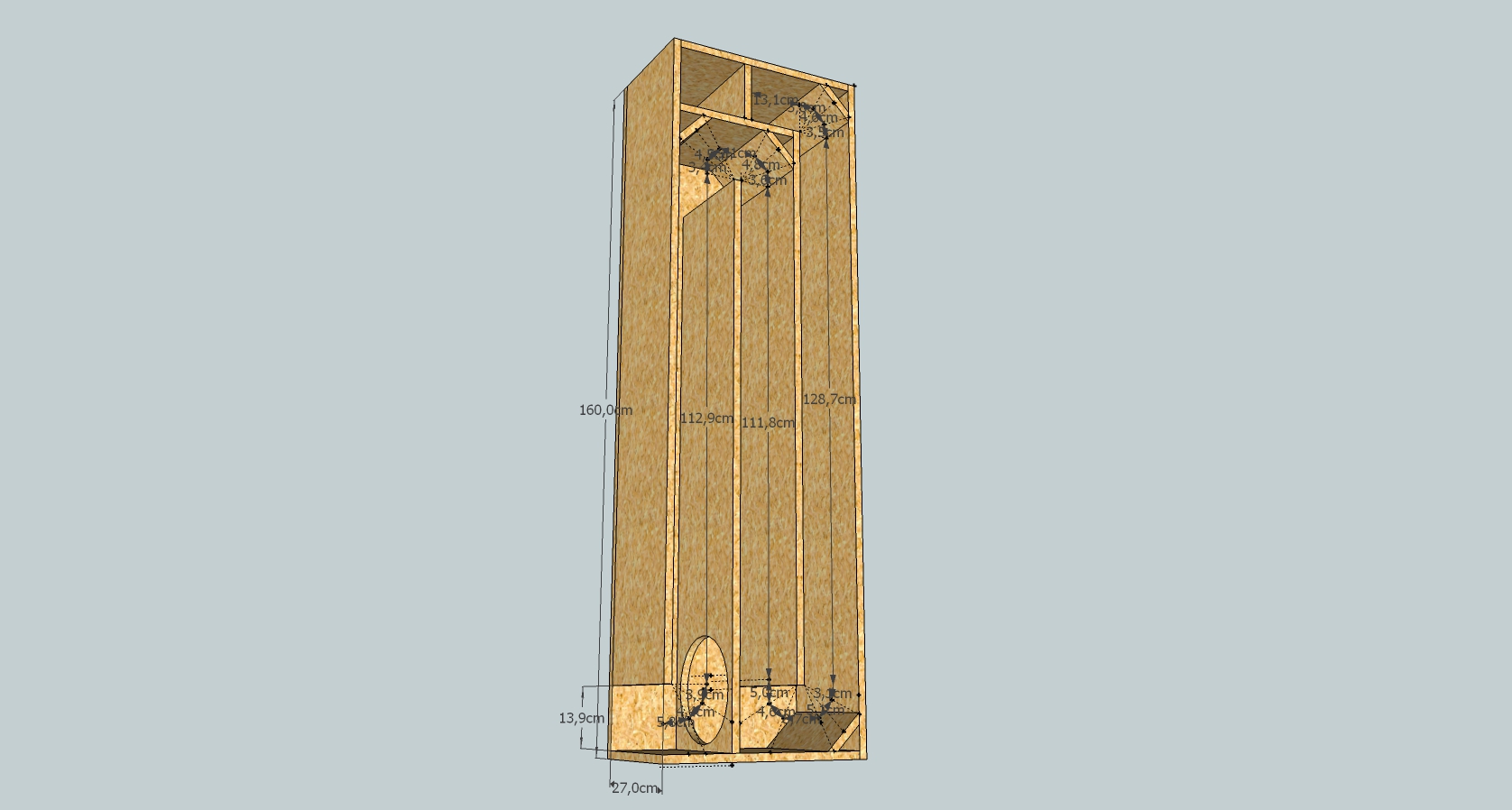

I have seen your bass ports are not round but some strange form, have ypu reason for that? like the dimensions, the round hole get then to big.

Is that a measurement of a built speaker as shown above? Sometimes a dip is floor bounce. Stick mic at exit plane of sub and measure very low level excitation to see if it is intrinsic.
A dip is usually caused by cancellation of reflected wave from mouth back to cone - and is the reason why most tapped horns go up to 100Hz only. If you are designing for 20Hz extension it will move the cancelation dip lower and possibly at 60Hz. The fact it is a peak followed by a dip tells me it is probably an internal reflection from terminus coming back to cone and canceling. Or a reflection from closed end to cone canceling. 60Hz half wave is 2.85m long. Look for a cone to end wall 2.85m distance and you have your culprit.
