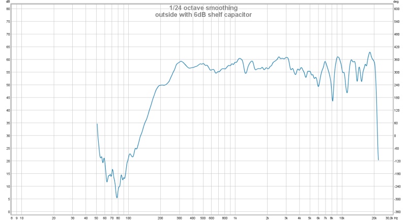

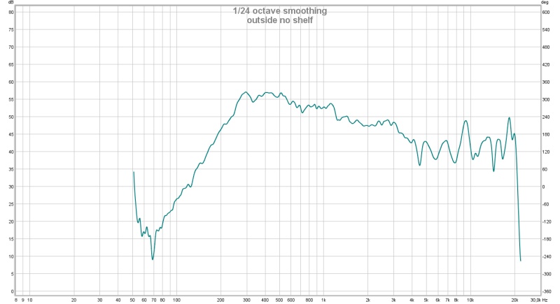

Wel I did some measurements outside I still got some peaks and stuff and I think the transmitter is a cause in the trouble because I do hear the rattle from it and get it not out, the mic picks that up and needs to be untouched with filters.
I did also with the headphone but is peaky to, I have bought the mic capsules from a chinese supplyer from ebay, do I have here a problem? or just my house room is very peaky one, the woofer did also get a canceling on 52 hz and not to find the cause yet.
The Tascam US-122L do have quite some noise also, so I have here a dirty evironment with that antenna, I go take steps to get it removed because also
I am sensitive for radiation, it can seriously disturb my sleep, it works like koffie for me that radiation on some strange way preventing deep sleep, that is examinated in a hospital and reason that the judge have place me here because it was clean, until 16 months ago.
Buying a mic is not a option because the Siegfried mod is quite good, possible even better then a pro mike.
Picture three is measurement in mouth of trynergy horn, the wildness above 10 Khz can be the mike or resonance horn or cone breakup.
regards
kees

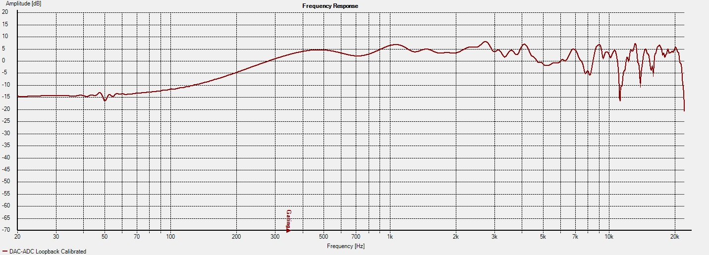

Tell us this is not your DAC-ADC loopback.
SL has long ago switched to using Earthworks measurement microphone.
I think it is measurement of horn at mouth with Holm as it matches the second figure above. It would be good to see the DAC-ADC loop back though.

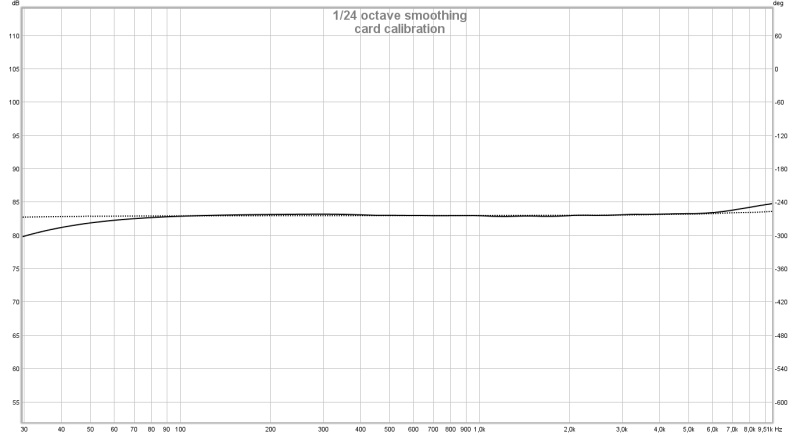

No it is'nt, this is the mike measurement, picture is the soundcard correction file loaded in REW I do not now how to see it in Holmimpulse.
I do not remember it is close of not but is was outside, possible 1 meter.
also you can see the mike correction file in it, for the WM-61A. the file is for the Tascam usb soundcard.

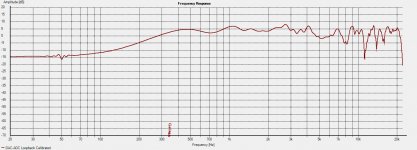

Here the measurement of the audio AD-ADC through Holm Impulse.
that was the card who did measure also the horn in previous post.

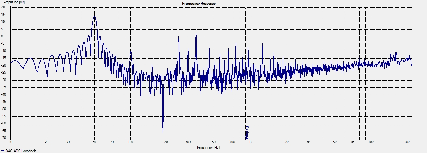

And a test with a wire so I can see the antenna do disturb things, (RF filter removed.) it is middle picture, strong wifi right? and yes it comes from the states and is for company cardens, store centra, not for ordinairy homes, so I have start go to court as a last resort.
And a test with the phillips in a 17 liter box with 5.11 wide and 4.2 long port, so I can see what it will do in the horn, so I can just put the port in and go on with it.

That 17liter response looks good. For your wifi interference test - how long of a wire are you using? Wifi is 2.4ghz - doesn't need more than a 6in long antenna. It looks like you have a long wire that is picking up 50Hz emi.
I did use a short antenna wire, just 3,1 cm long, that is 300 : 2400 : 4 for 1/4 golflength, but the pulses are the problem, who is am modulated and so do disturb, like your mobile phone does when close to a box or amp.
the 2400 Mhz does nothing on his own, to weak also.
I have not a 50 leak, I have earth, but I do hear in box the rattle of that box, possible because of the nabure do not like me has a transmitter pointed on me, this is afcouse not nice, and so he has to go to judge on 4 december.
