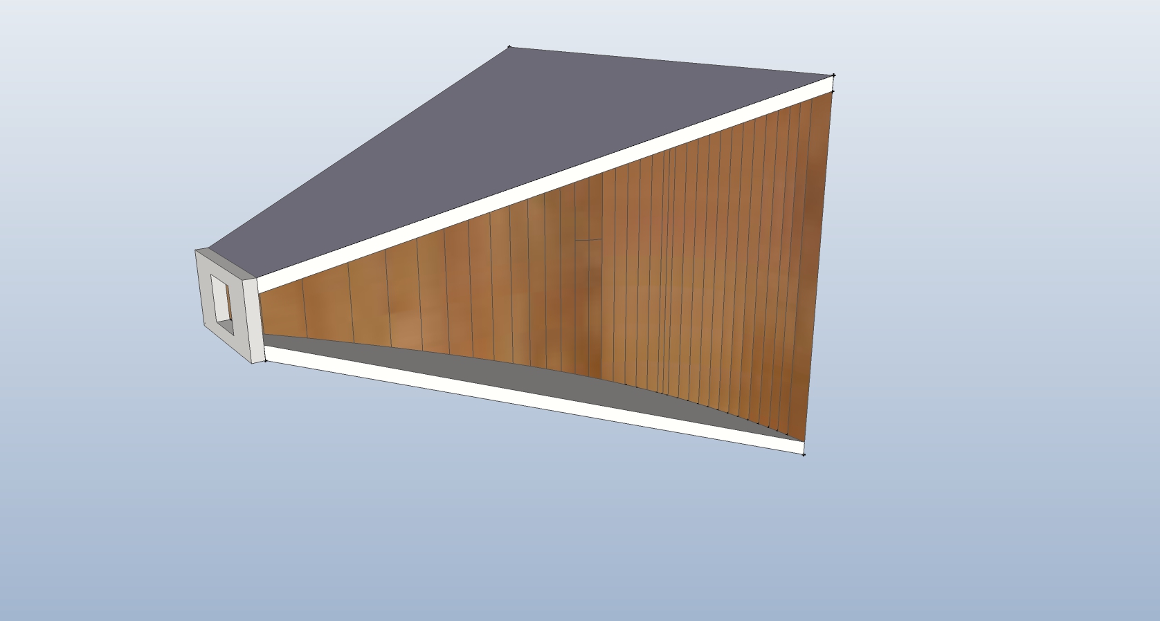

Dou you now how you did fill in ratio horn width to high in tractric calculator?
I have done 1,5 what are yours?.

I used whatever the default was from the Volvotreter spreadsheet. It probably was set at 1.5 aspect ratio.
That is what I did use, volvotreter do has 1.000 in defauld state making a square.
I have done the numbers now as you did in akabak, so it is more clear for me, but I did see you use scale in akabak, is this because you did scale your horn? I did not and is these script not usable for me?.

I must have changed the aspect ration then - forgot about that. I scaled it because I designed it for the 5in driver initially with 3.75in throat. Then to make things easy, just scaled to 2.0in throat and used 3.5in drivrer to make things easy to model and build based on CAD plan already generated for 3.75in throat.
I'm going to try the scaling into Adobe reader printing windows to print at 2" throat size !

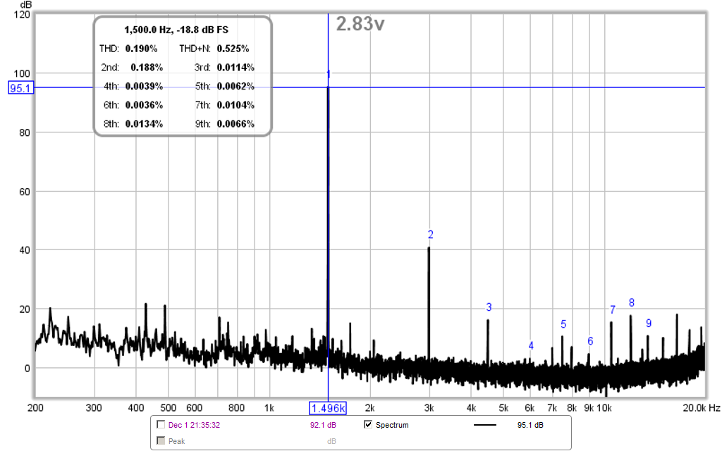

I measured at 1m (distance from mouth exit plane) and 2.83v (as measured with Fluke 100 DMM in AC volts with 1.5kHz sine wave excitation) and got 95dB using a 6.6uF high pass cap.
Here is RTA showing about 0.19% THD at 95dB and 1m.

That will be more believable if your measurements confirm distortion level at 114 dB is still listenable at the low and high range of the response 😉.

What do you consider a level of distortion that is still listenable when at 114dB peak? You have no faith in the Trynergy? 🙂

Working on the horizontal wall pdf, I reduce with Acrobat Reader the original patern of page 1 for having a 2" throat width (=66.5% of the original size) ! With multi-tiles print I got 4 pages ! But If the throat size is accurate both the mouth width and the horn size are not accurate.
When I reduce (without printing) to 0.70% the original pattern, the size I find is larger : 71.3 cm x 42.24 cm (28.07" x 22.63")!

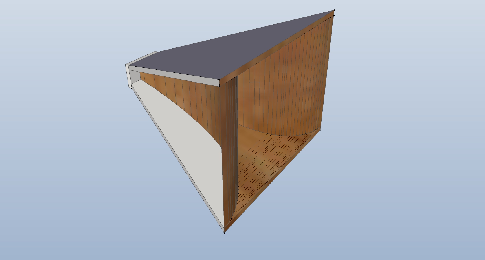

I have my old taped together tiled plans somewhere. Let me dig them out and see how big they physically are. If the throat is correct, the mouth should be correct - look at the grid that is printed. If that grid size is square and consistent on all pages, it is good.
That would really depend on the type of signal being played and the frequency and type of distortion, odd being worse than even order, AM/IM distortion can be worse yet.Art,
Single number - 10% THD is still listenable (to me) for most contemporary pop music.

I simply took the size of your pattern and pushed it to * 0.7 to reduce it for the littlier 2" throat the 10F needs. With those results I choosed the foam for cutting !
Today I just have been playing with the printing and the % function in Acrobat reader printer screen to reduce only the throat of the pdf file of page 1 (horisontal curved wall pattern) to 2" instead 2.78" (initialy made for a 5" PRV driver).
Like if the reduction was not "homothetic" (same reduction ratio in all the dimensions) : It should be an error of manipulation from me ! Tomorrow is an other day ! Will try tommorow afternoon again...
Btw the extension seemed odd to me as non really linear to be glued on a plan top & bottom surface ? the extension was more like a "nozel" at the end : so flater again like if it missed something... maybe because not curved yet ?
Have to switch into "concentration mode" to read it again ! I will try first to print the file at 100% and look at if checks to the measure you give (the 100% print 9x A4 paper)... have also a problem of margin which ask to measure the A4 which need to be crossed before tape scotching !
I can try in town with A3 size: big Canon photocopy shop ! But A4 at home stays easy enough !
