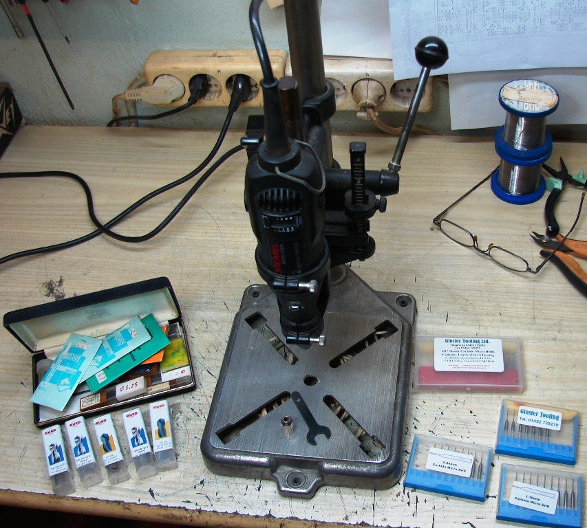

Wow! Here is the PCB drilling factory 😀. A Dremel moto tool attached on a Dremel drill press stand and a big variety of drill bits (either HSS or Carbide Turbo Shank) from 0.3mm up to 3mm.
Have fun! 🙂

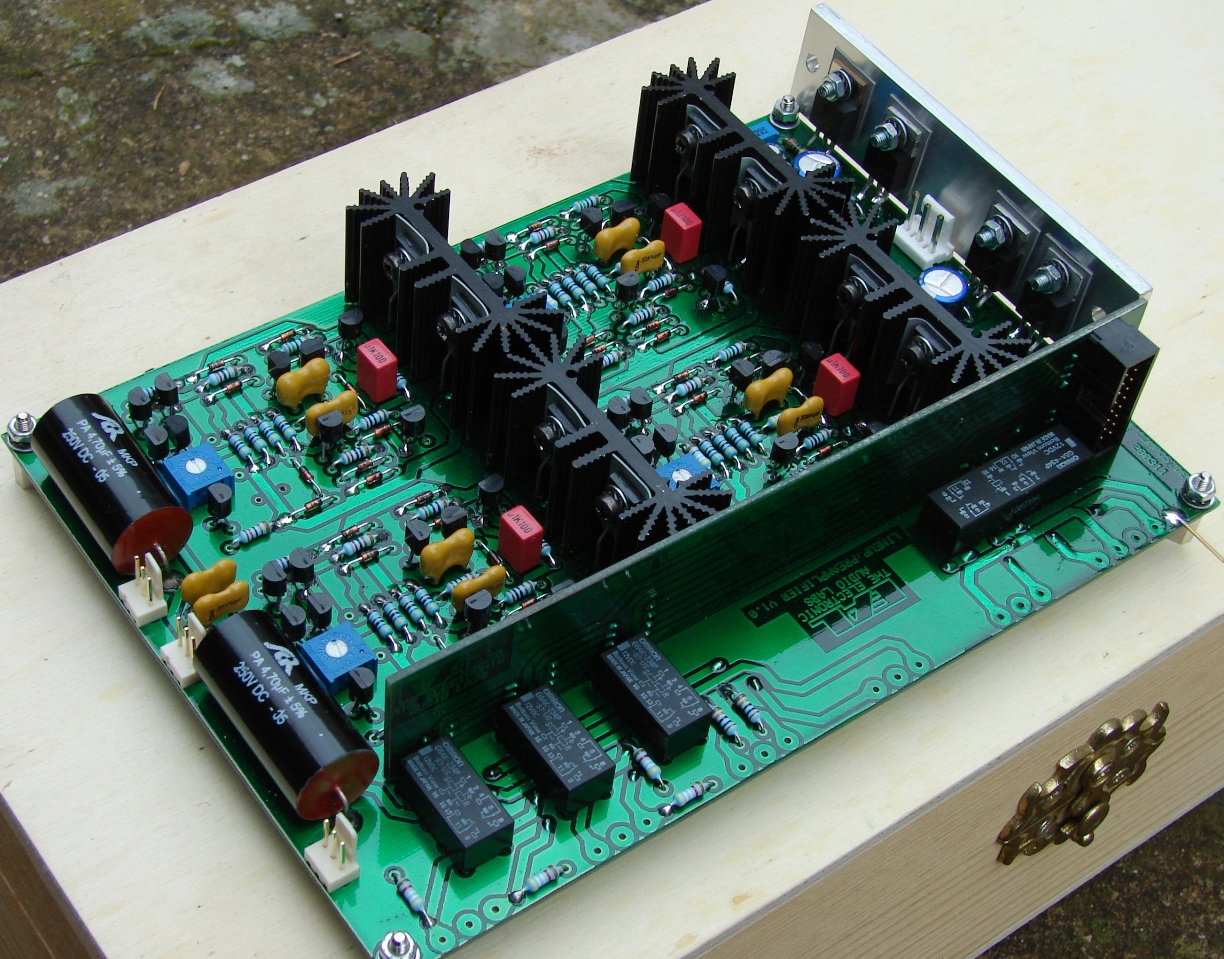

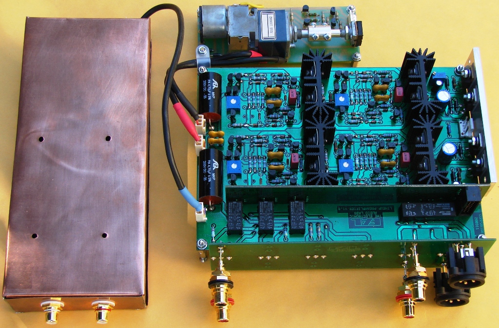

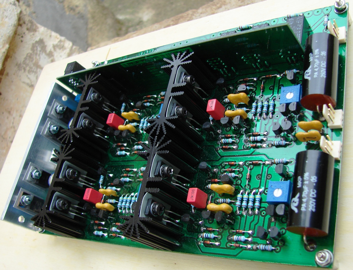

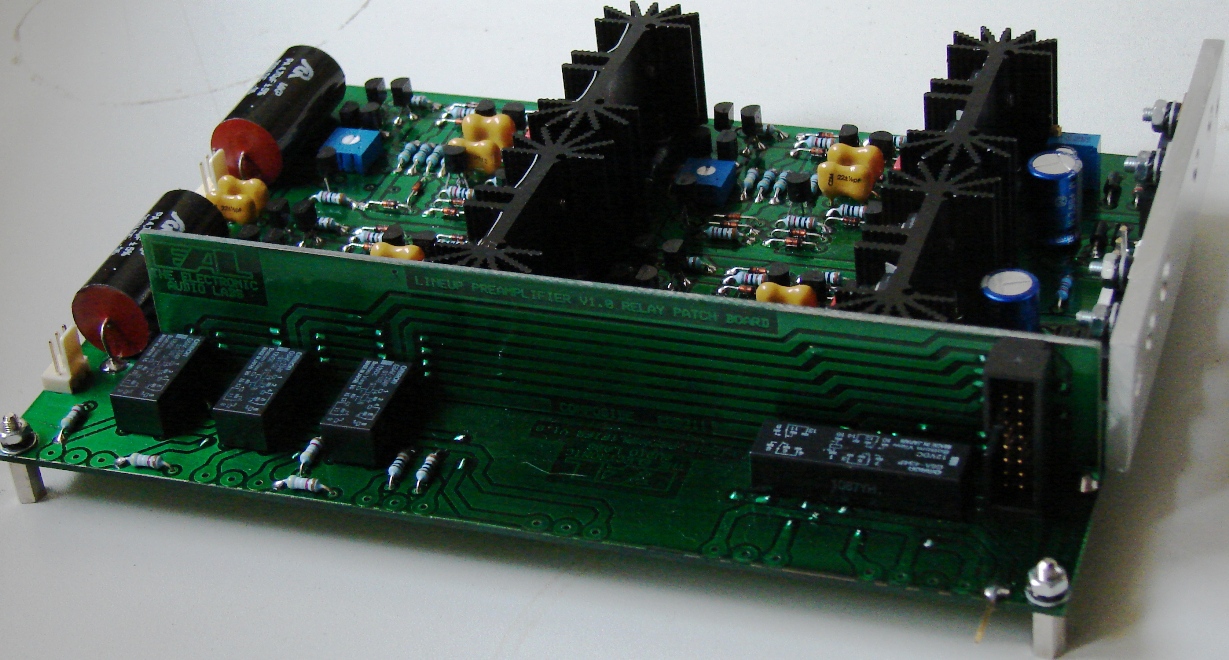

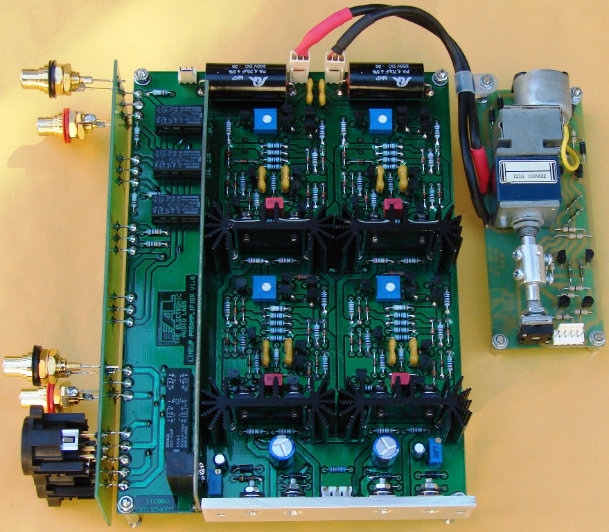

A whole stereo preamplifier, whose the heart are the four discrete BisBos OPAs, is implemented on this 190 X 135 mm PCB. The two front OPAs - behind the two large foil caps - form a stereo input buffer in voltage follower arrangement with unity gain. It should be noted that, this first stage can be easily modified as non inverting with any desirable gain by adding simply one resistor and one electrolytic cap in each channel. The two rear OPAs, form a stereo unity gain inverter circuit. Thus the preamplifier provides both single and balanced outputs. At the rear end, it is the voltage regulator-stabilizer circuit implemented by two LM317-337 followed by two common base transistors. On the same PCB, are mounted the input select and the mute Latching type relays. The vertical PCB transfers the commands from the microcontroller unit to the Latching relays, so digital tracks are separated-isolated from analog tracks. There are 3 gold pin headers. The one at the corner of PCB is for connecting a fourth input (in our case a Phono stage) instead the two at the middle are for connecting the motorized ALPS volume pot which is mounted on a separate PCB in which are included the H-Bridge and the auxiliary pot which tracks the rotation angle of ALPS and transfers it to the microcontroller.
The parts used are of high quality: All resistors are Vishay Sfernice MRS25, caps are either SCR, WIMA, Cornell Doubilier and Panasonic ECA. Small signal transistors are BC550C-560C and mid power are MJE172-182. Latching relays are OMRON G6AK-234P with Silver-Palladium-Gold contacts.

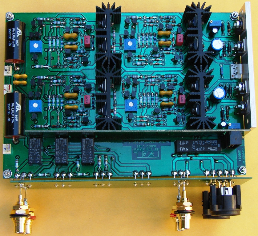

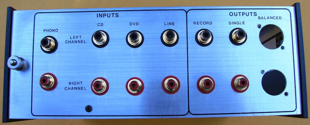

One week ago, i have completed the I / O sockets mounting patch board. In the pictures, you can see that i have soldered just two pairs of RCA sockets and a pair of XLR (all Neutrick). The first RCA pair is the CD input and the second is the Single Output, while the two XLRs are the Balanced Output. It remains only a PCB for the mounting of power supply reservoir capacitors (2 X 6800μF per channel) which are some big and could not be contained on the main Preamplifier PCB. The rest non soldered pads from the left, are: DVD IN - LINE IN - RECORD OUTPUT.

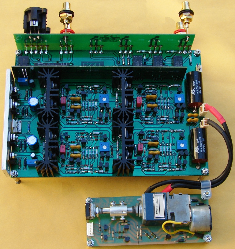

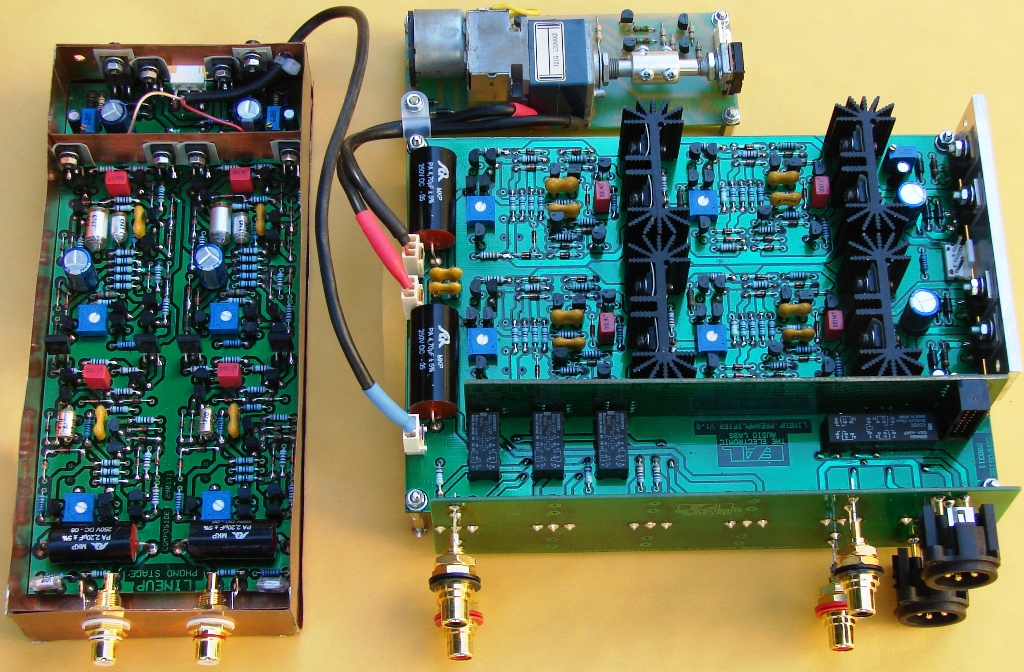

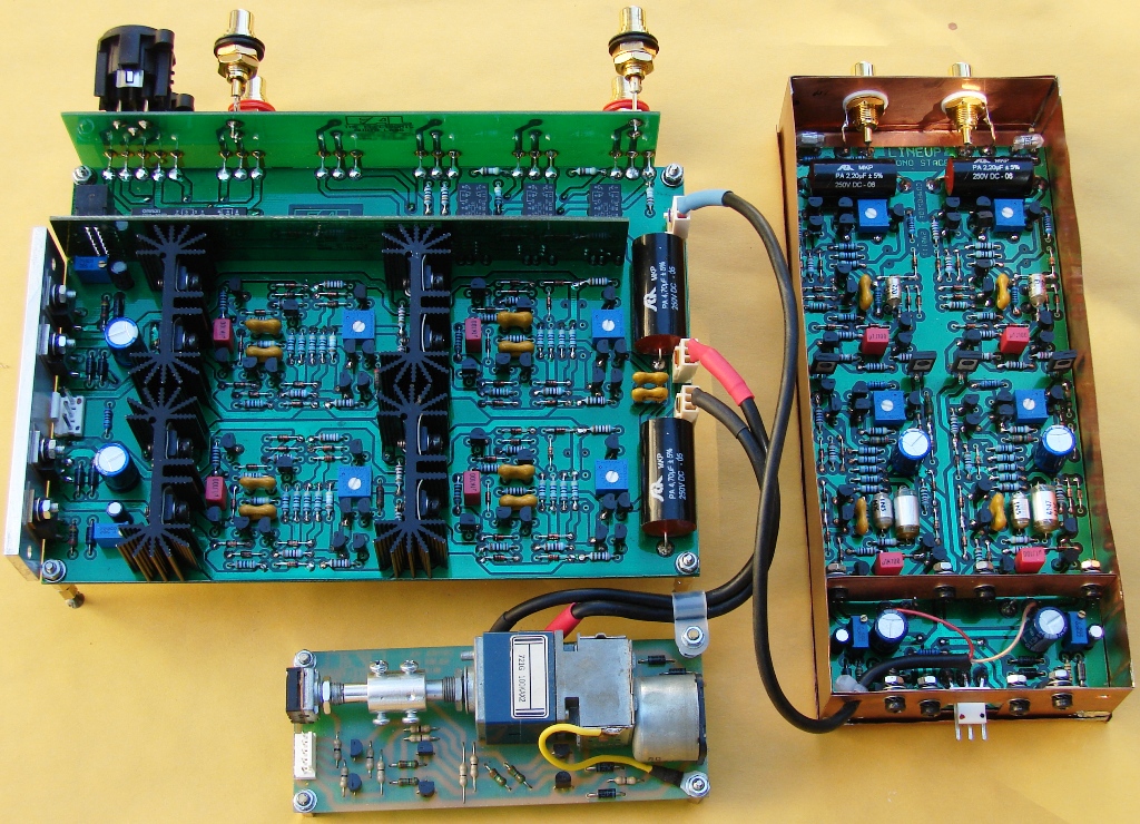

In these pictures, you can see the Preamplifier joined with its companions: The volume control unit and the Phono Stage. I had the chance to make some audition tests with vinyl records and CDs. To my ears and for the possibilities of my speakers Mission 780, the sound is quite good. Mids and Highs are neutral without colorations and screamings. Lows and Low-Mids are amazing good (that is the main benefit of discrete implementations against ICs), very tight and warm. The noise floor is very low (my estimation is about -90dB by hearing the output with my headphones in absolute silence).

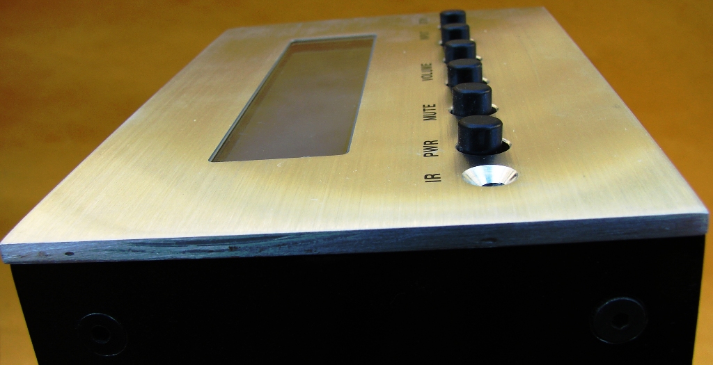

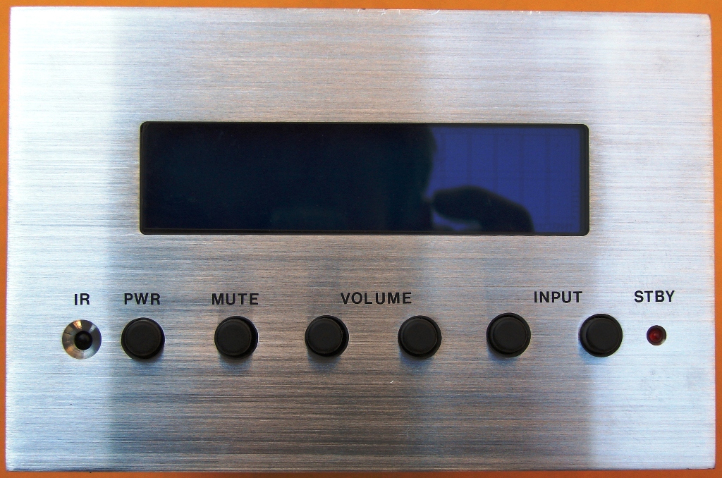

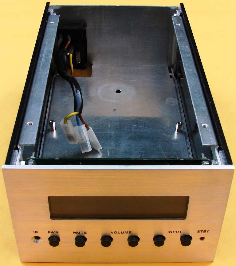

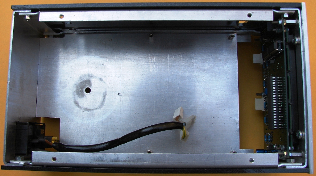

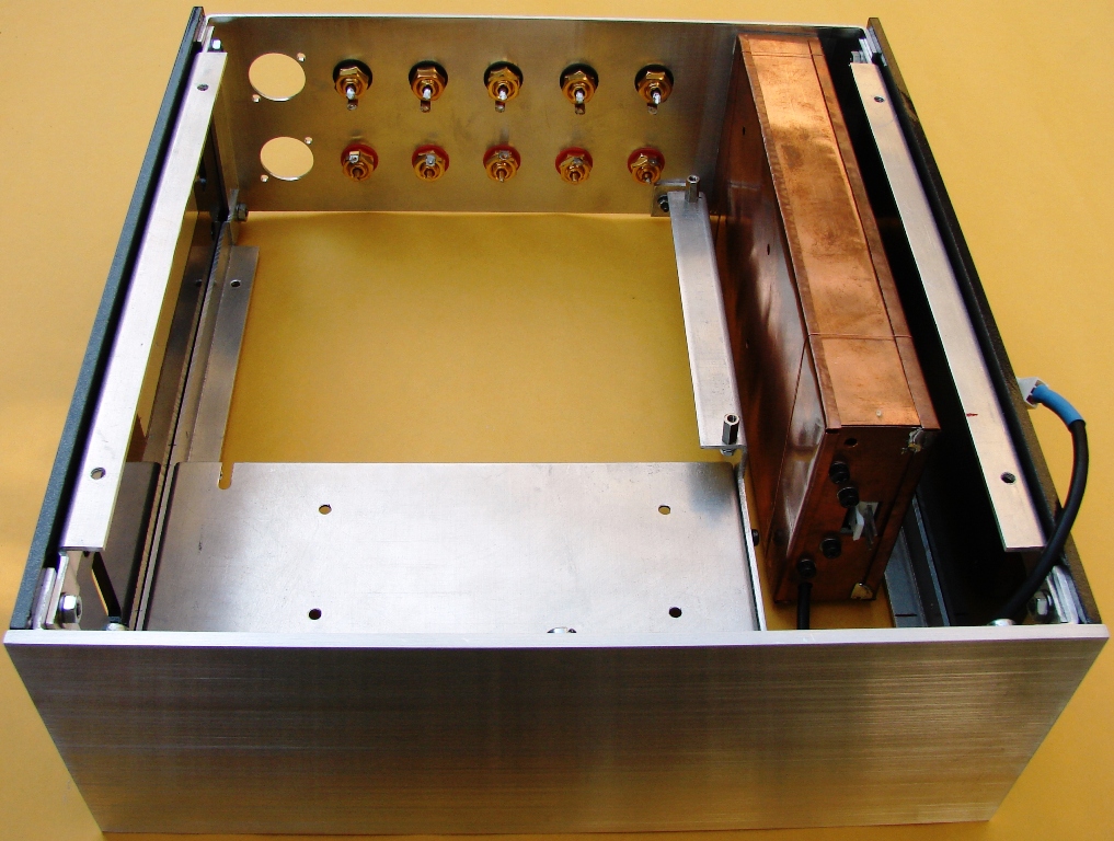

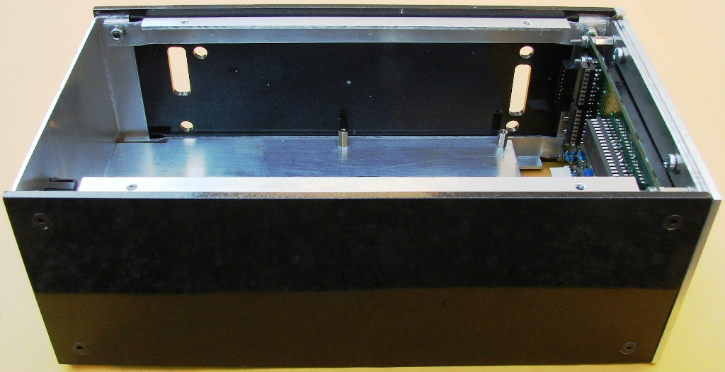

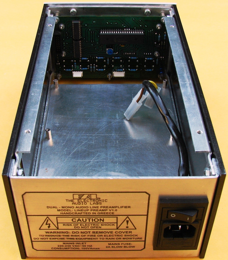

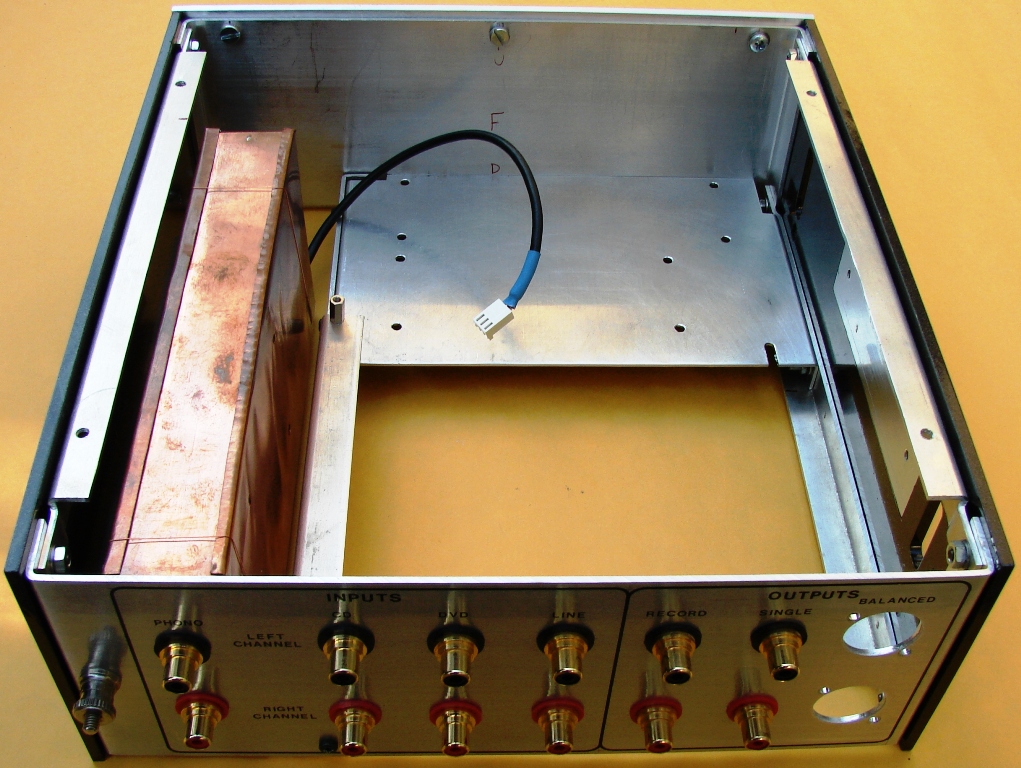

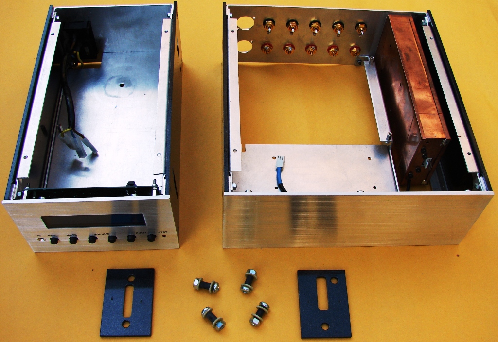

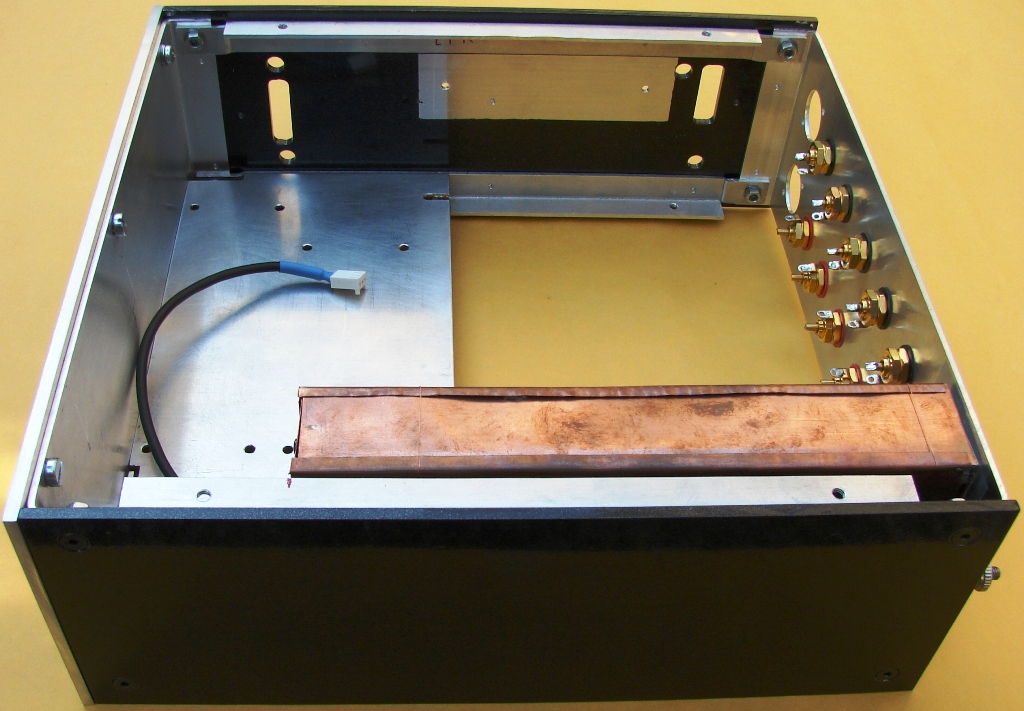

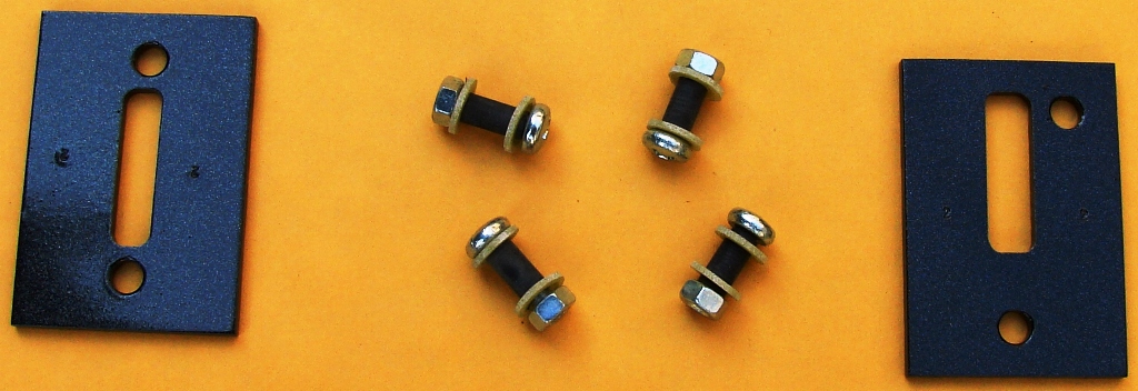

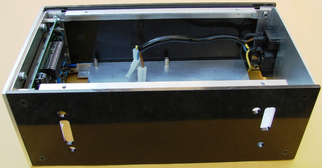

😀😀😀 OK, OK... I know that in 23 April i said that i will have ready the metal case in one month . Now it is 19 June, so finally i needed 2 months. Before the assembling of the whole unit, i would like to present the individual parts in pics. In general, the whole construction is formed by 3 separate cases joined but galvanically isolated between them. The basic material used is 4 or 2 mm thick aluminum sheet. Everything is hand made and home made. Side panels are painted with black-metal acrylic spray. Markings are obtained with Letraset Transfers or Letraset Shafmat film and are coated with Talens clear varnish (it is absolutely transparent, strong and has very good adhesion on aluminum) for protection from scratches. Both cases include sub-chassis for mounting the pcbs and parts, so as top and bottom covers can be removed easy for e.g. service or upgrade routines.

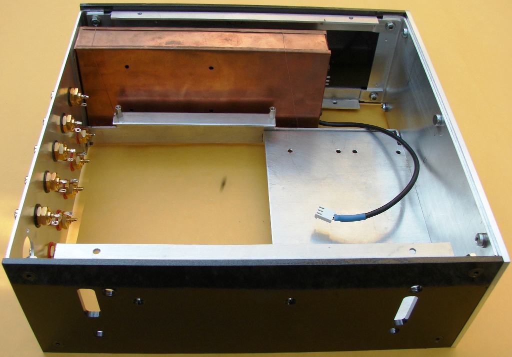

Here is the second case in which included the analog signal processing - routing circuits. The copper case, is the phono (RIAA) preamplifier which is also galvanically isolated from the main case.

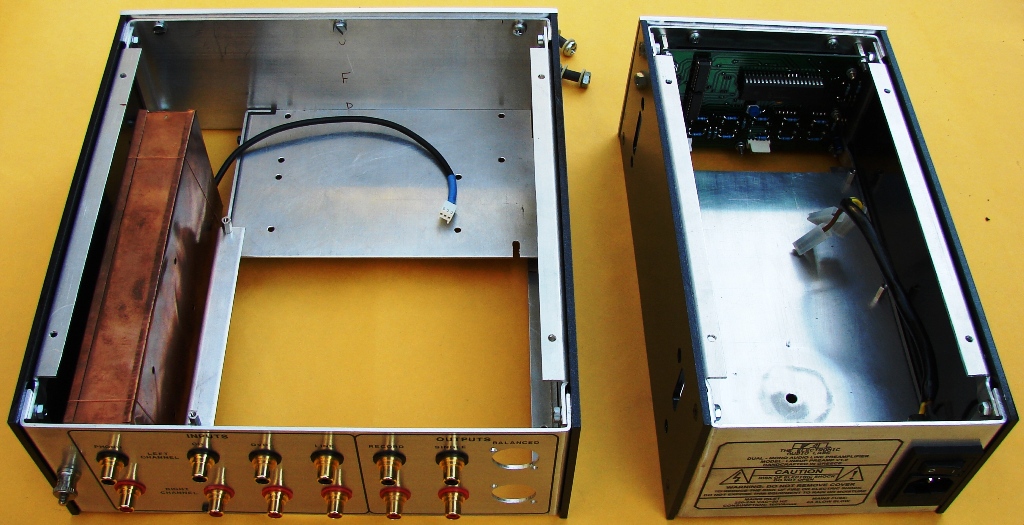

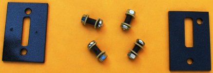

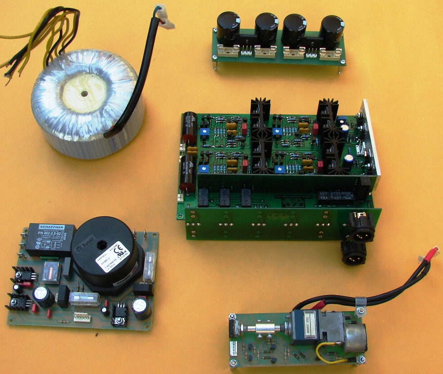

Here some pictures indicating, the two cases side by side before the assembly, the bolts-nuts-spacers and the group of electronic parts.

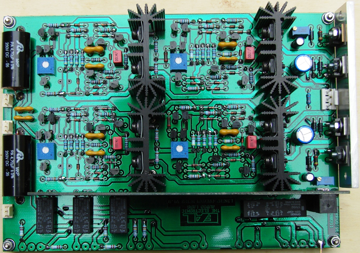

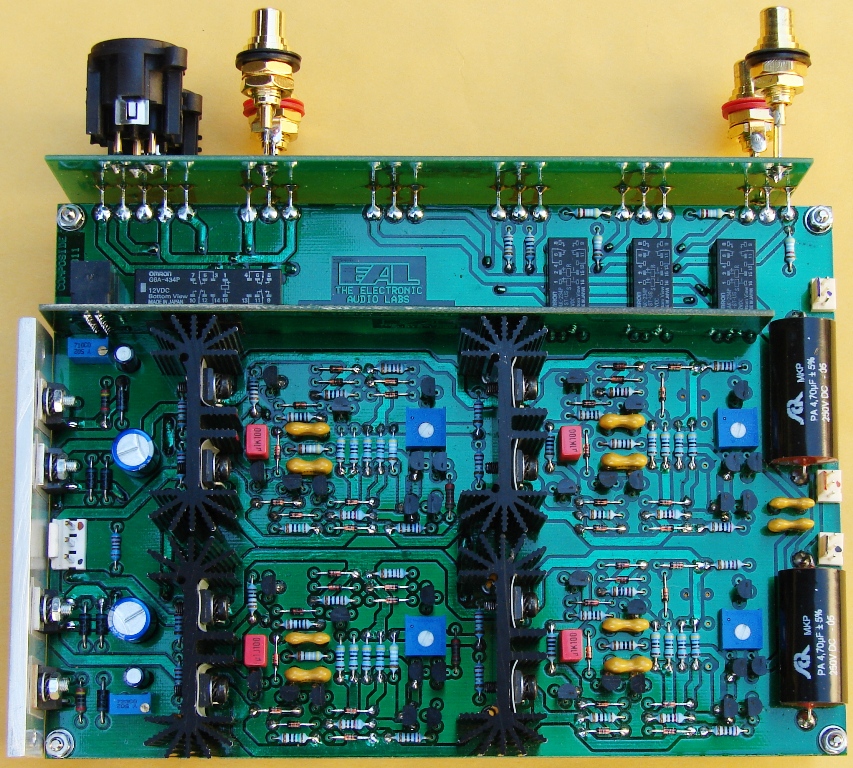

In post #2 you have a photo of your trial / prototype design with no heat-sinks on the BJTs. In post #42 you have a photo of your finished design with BIG heat-sinks on the BJTs. I've never seen a solid-state op-amp that generated a lot of heat. Why the big difference?
Best regards,
Obe1
Hello fotious,
Bravo ! :worship:
Best regards,
Obe1
Thanks Obe1 for your kind words. Heatsinks on the output transistors give in preamplifier the ability of driving low loads like headphones.
Thank you
Photius 🙂
Hello Fotious,
Thank you for sharing this most elegant design. Yes, large heat sinks to accommodate low impedance loads like headphones makes sense. I hope it's safe to assume that no heat-sinks would be required to drive a power amp with an input impedance of 47K Ohms.
Best regards,
Obe1
Can I do anything (change something) so that gain is 7 to 10 dB?
Yes, you can do this. Look please at the PCB layout in post #38, there is the option of using the discrete either as voltage follower or non-inverting amplifier. The associated parts to this, are C5 - C9 = 470μF/35V electrolytic and resistors R8 - R28 = 8.45KΩ. Resistors R9 - R27 must be changed to 8.45KΩ and capacitors C6 - C10 to 15pF. After this, the gain of discrete will be "2" = +6 dB. It should be noted, that the bandwidth of discrete is reduced at around 350KHz (if i remember well, i will check it to confirm you) when is working to provide voltage gain. More gain, less bandwidth. Its original bandwidth with gain = 1 or 0dB is almost 1MHz, so if you don't need voltage gain it is better to use it as voltage follower.
