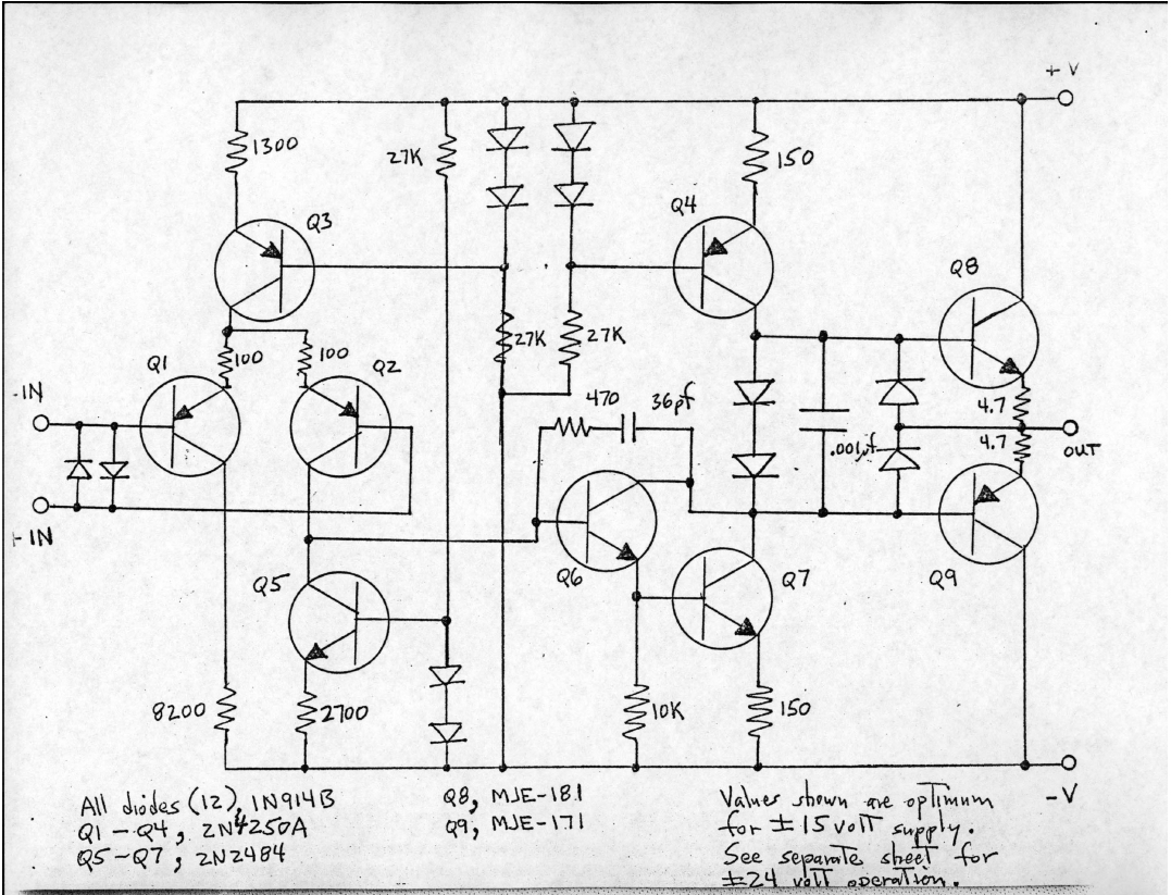

No, it is not my idea, fotios.
But I have seen it in forum. In a power output stage.
JENSEN original opamp is using it, too. I think.

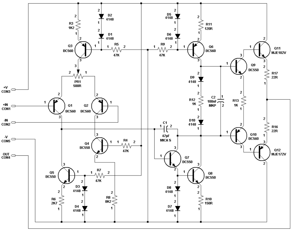

In the first picture is the original D. Jensen 918 OPA and in the second is the modified circuit by us, with the help of simulator.

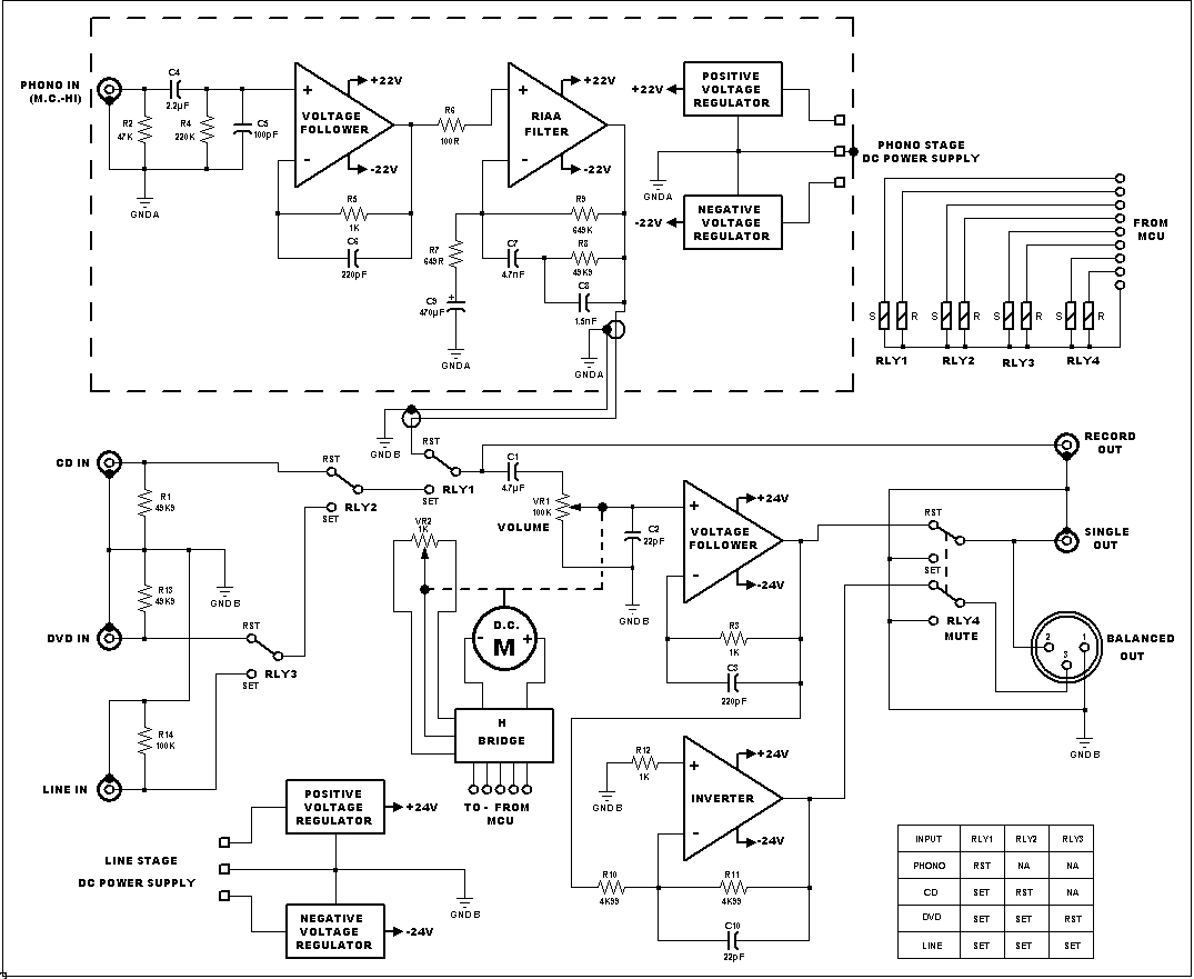

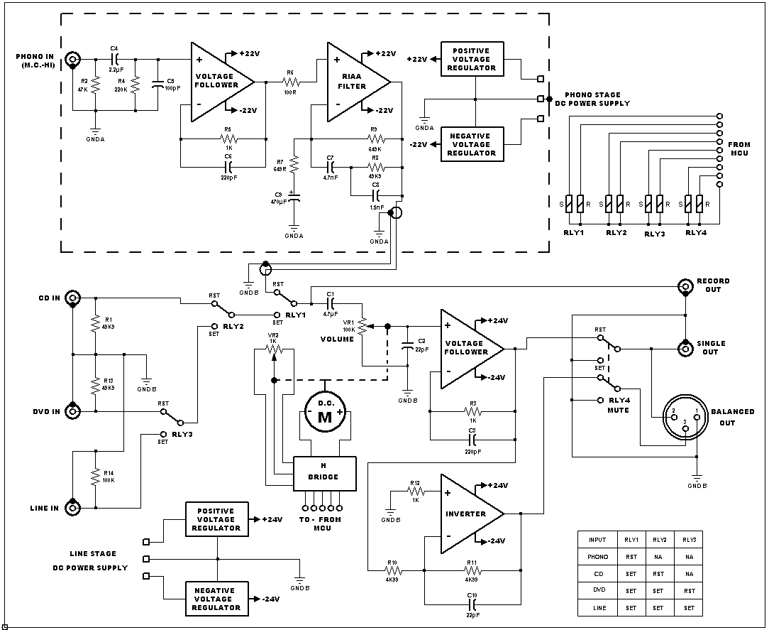

Lineup & Fotios Preamplifier
Here is the block diagram of preamplifier (one channel is shown). We have include just 4 inputs. Separate power supply is used for the Phono stage. We use a different way for signal routing thru the input selection Latching relays to the volume pot before the output buffer. The usual way, is the use of a separate relay per each input which of the "common" terminals are tied in a BUS which infected from noise produced from the open contacts of relays. With our way, the contacts of relays are always "loaded". I am only reserved on this: The signal of Phono stage it has to pass thru only one contact before the output buffer and this is OK. But the signal of CD-In it has to pass thru 2 contacts, and the signal of DVD-In and Line-In it has to pass thru 3 contacts. What it bothers me, is that each contact presents stray capacitance and i don't know how much can affect the signal quality. Only the final product will show it thru FFT analysis.
Any advice on this issue, is welcomed! :)

I'm interested to know why the unusual selection of MJE 172/182. I know Jensen used them and that simulators will say what models tell them but do you have a reason to select them here in preference to say, MJE243/53 or (as you suggest) BD139/140?
Hi Lineup
Reason is that i have in my stock only MJE 172/182. No one MJE 243/253 or BD 139/140. MJE 172/182 are not so unusual, they also used in Bryston discrete DOA33. From technical view, BD 139/140 have better bandwidth (according to datasheet of NXP they have ft=160MHz) in the cost of Ic=1,5A, but MJE 243/253 are same with MJE 172/182 except Ic=4A. In simulation, indeed is shown a slight increase of bandwidth with BD 139/140 in output.

I am already in the process of drawing the PCB of preamplifier. I have ready the plans of the Phono Stage which is a separate unit, optionally included in the preamplifier. I am currently working on the attached block diagram and i will have ready one "home made" PCB at the end of next week. I don't know if it suits in the demands of other people, but there is no problem to we do some variation. Reprogramming of MCU code to suit in each case, is very easy (in 2 hours as much, i can change the code). You should carefully study the block diagram first. Tell me what are you thinking about it.

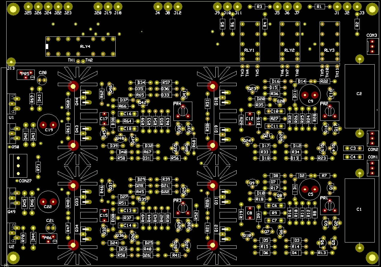

Hi Ian
I am in the process of PCB drawing. The first PCB drawing will be according to the demands of a customer (THANK GOD! i received an order and some money in advance) preamplifier including and a Phono Input. Please, be patient for 1 week to finish the whole preamp (included chassis) which will give a general view of my ideas about a "real world" project. Thanks for your assistance. :)

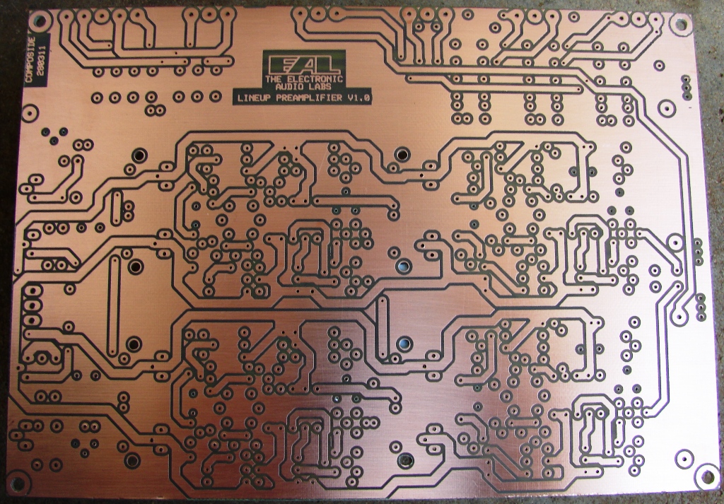

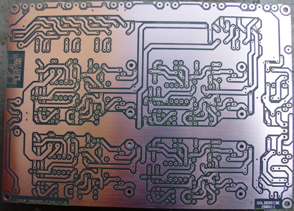

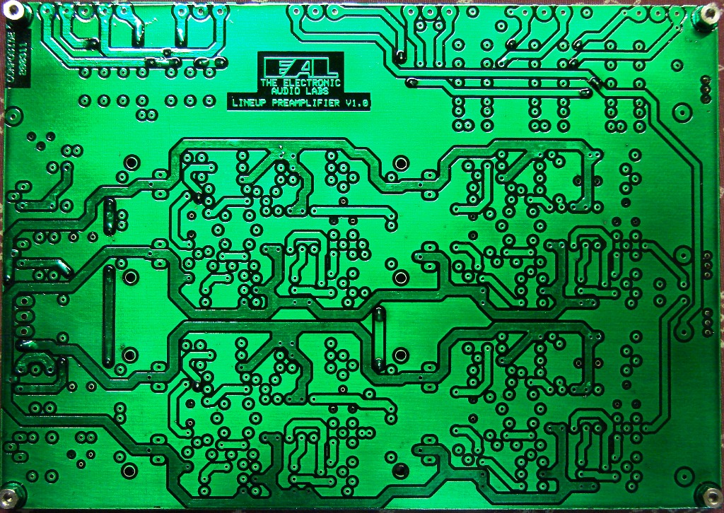

Main PCB is ready
AS i promised, just today i finished the main preamplifier PCB board. It is home made, double sided, 190 X 135 mm. In the two picts, it is drilled and cleaned, ready for the tining of power and gnd tracks.
The first pic is the component side, and the second is the solder side.
Have fun! :)
PCB ready for assy
O.K. guys. Here we go! PCB is ready for assembly. There are 27 via holes (0.6mm each one), which have been soldered with spare wire leads from used parts. After this, power and gnd tracks have been tined. Finally, the PCB has been varnished with the nice green PCB encapsulating lacquer of PETERS. Have fun! :)

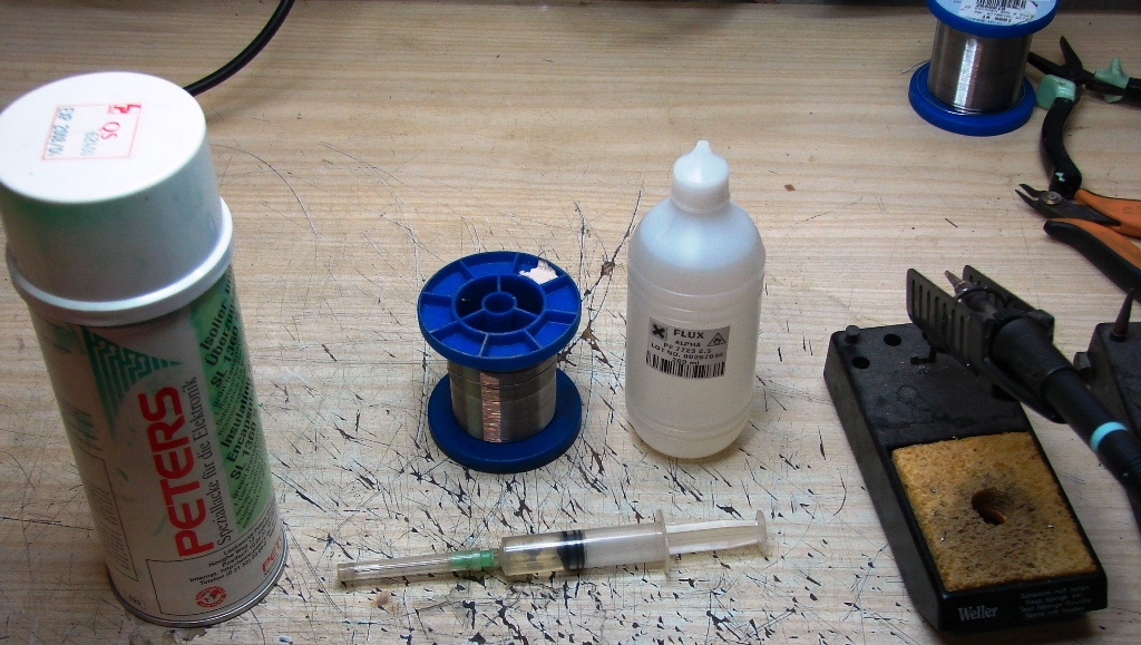

In the picture are presented the tools and the materials that i used. From the left, the first is the green PCB encapsulating lacquer of PETERS. In the middle is the rosin free solder wire (lead free, Sn 96% - Ag 2% - Cu 2%) of ALPHA FRY that i use for the tinning of copper tracks. In the left is the liquid flux of ALPHA FRY that i use for assistance in tinning. I use a syringe for applying the flux. The result is a very clean and effective tinning. Any residue of liquid flux can be removed very easy with common spirit.
