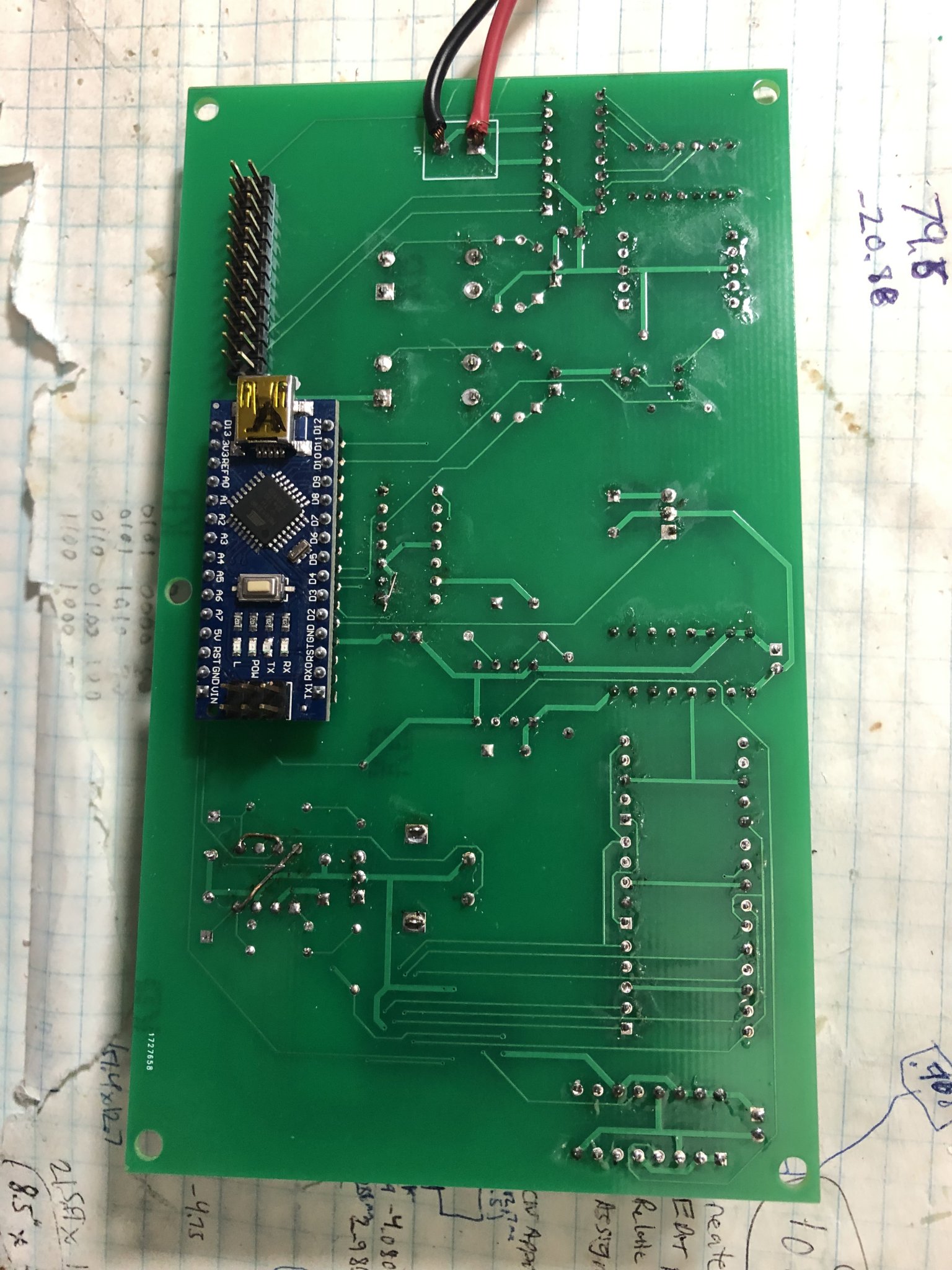

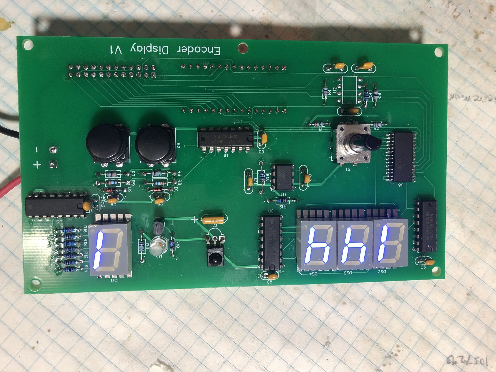

And here are a coupe pictures
I spent most of the day today debugging the software and testing hardware, and it is working correctly, finally. I will double check the PCB layouts again tomorrow and order boards. And another order of parts. Once I build up a set of boards I can fine tune the software while listening to a square wave until the pop is gone.
I am changing the relays from the LSB to MSB when turning up and MSB to LSB when turning down the volume, hopefully this method will work first time.
Attached is a copy of the code for anyone with a case of insomnia.

Roy found a problem with the new Analog board in that the I/O connection pitch was set to 2mm and wanted it to be 2.54mm which is an easier connector to get and the plug for it doesn't cost and arm and a leg for the pins, sold separately. Also wanted a Pin 1 marker for the 24 pin header connection which btw goes on the top of the board. And I updated the power connector since there is no board under it feeding power up. So here is the updated gerbers. Still need to scrub the BOM then repost it.
Good to have someone else go through the BOM, I have looked at it so long that I stop seeing the problems.
Roy has been going through the BOM and found a couple problems with the resistor Reference Designators on the resistors of the Display Board.
So, here is the latest update of the BOM.
So a little information on the new boards for troubleshooting. The Display board can be tested by itself then connected by a ribbon cable to the Analog board. Power up the board, the digital pins for volume, relays and display, are D3-D10, pins 6-13 on the Nano, they should all come up as LOW, 0.25 to 1.5v. The mute pin, D11, Nano pin 14, should be low. Input selection pins D16-D18, Nano pins 21-23, should be High, Low, Low. Measure from ground to the pins to see if you have the right outputs, if so then any problem with the volume display is in the Display circuit, check U4 the oscillator for output from pin 3, U7 should be toggling its flip-flops setting the last two address bits of the EEPROM and feeding U6 the clocked output of U7 to decode the two input on pins 2 and 3 of U6 to decode to 0-4 to turn on the LEDs one digit at a time, so rapidly they look like they are all on together. The inputs to the EEPROM Address line A0-A7 should not be changing and should match the relays so you can measure with a voltmeter. Address lines A8 and A9 address into the EEPROM with 00, 01, or 11 and are changing rapidly so need a scope to see or an AC Hz setting on the VOM.
Most other things are easy to follow on the schematic to troubleshoot. Any questions just bring them up here.
