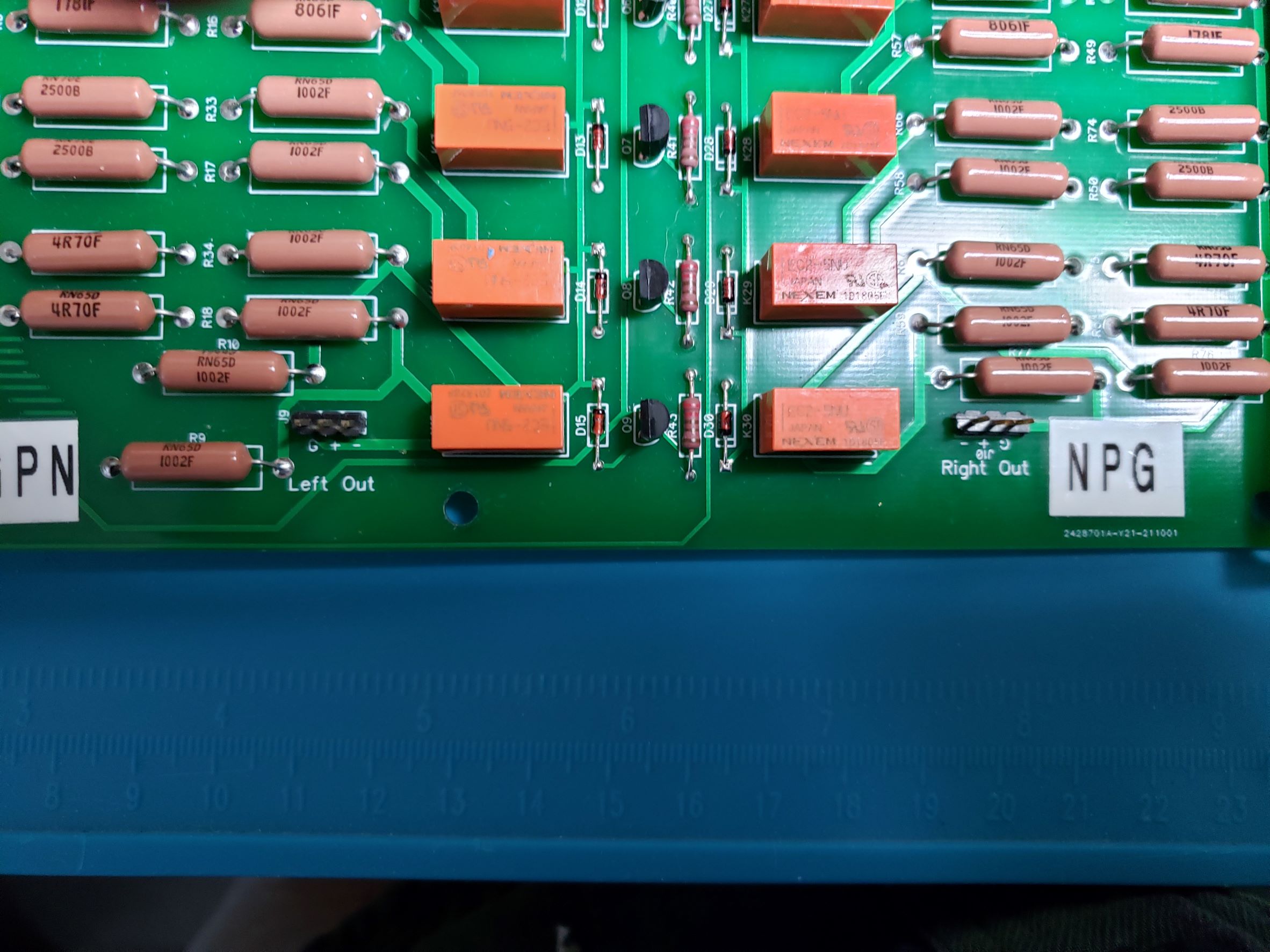

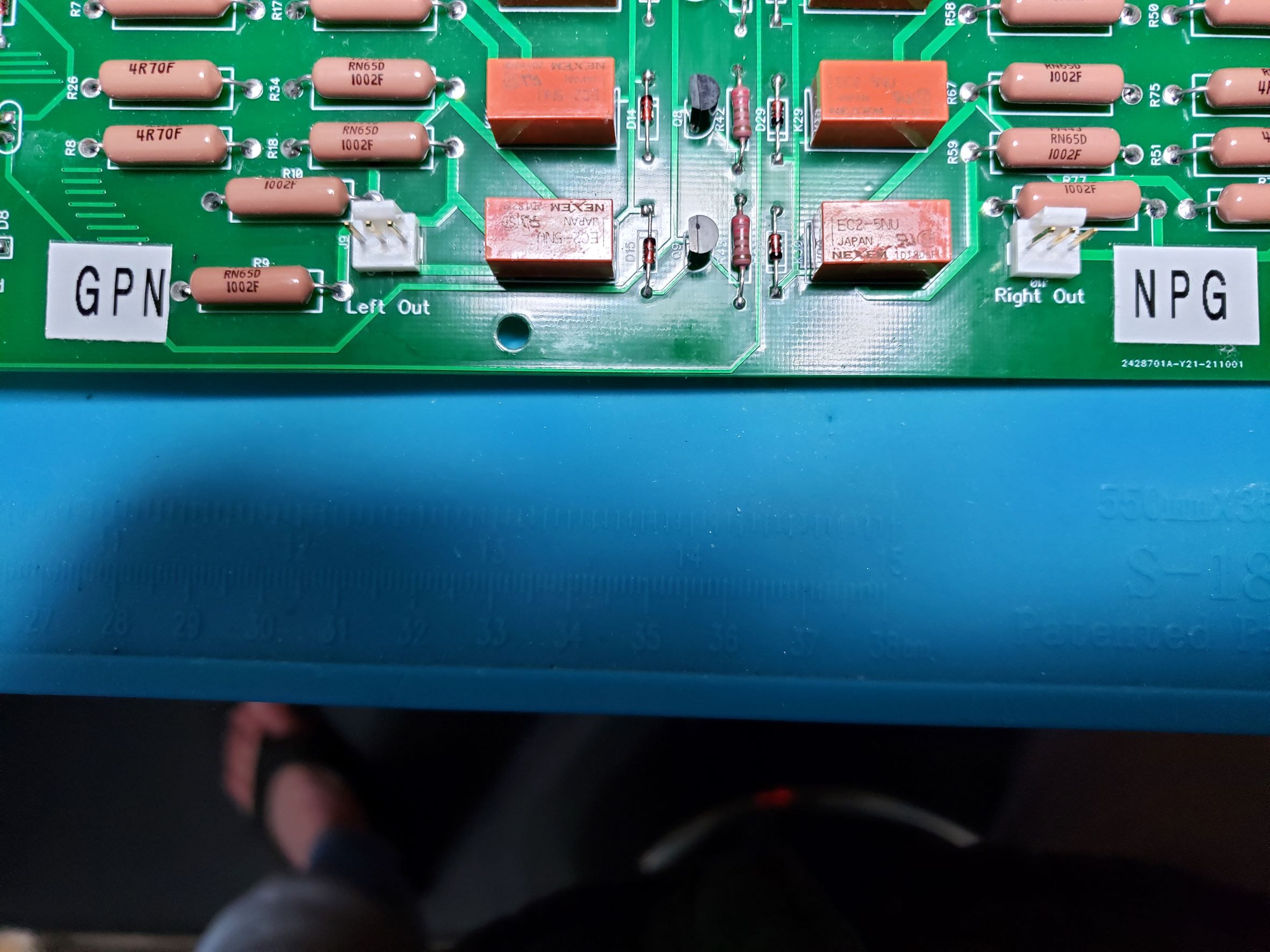

In wiring up my version of the analog board (3.1) I have found that the form factor for the volume output easily fits the standard 2.54 mm single row non locking headers with the wire markings still showing. However, I am finding that the con housing can easily slip off because they are non-locking.
Installing a locking header, while still fitting in the space available, will cover the output polarities. In the picture below, I am using a common locking header (Mouser 538-22-11-2032) notice that there are no longer any visible polarity markings for the outputs. As the pinouts for each channel do not follow the same polarity pattern, this can be confusing. I would suggest moving the polarity markings further away from the header so that they are still visible. There seems to be plenty of room for that change on the analog board.

I can do that on the next rev of the board when we find out if it needs a fix for the pop.

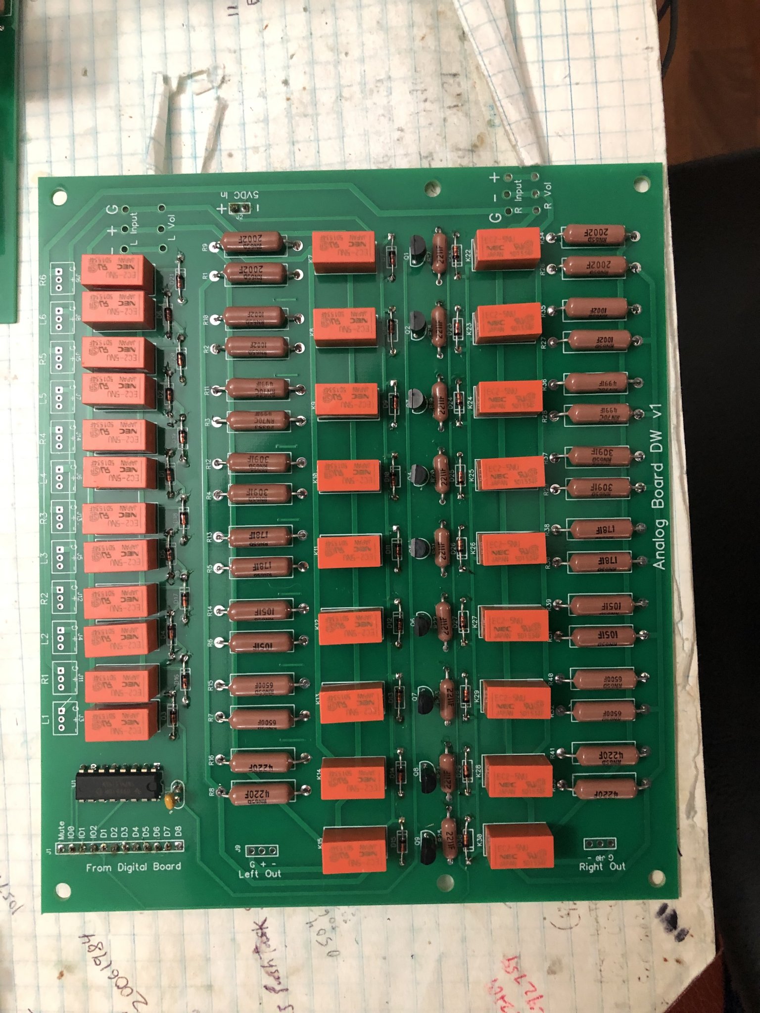

Yesterday I received by Digitally Weighted volume control board that drops onto the current digital board. Once built I can easily compare the two designs for sound quality and input loading, or output values.
