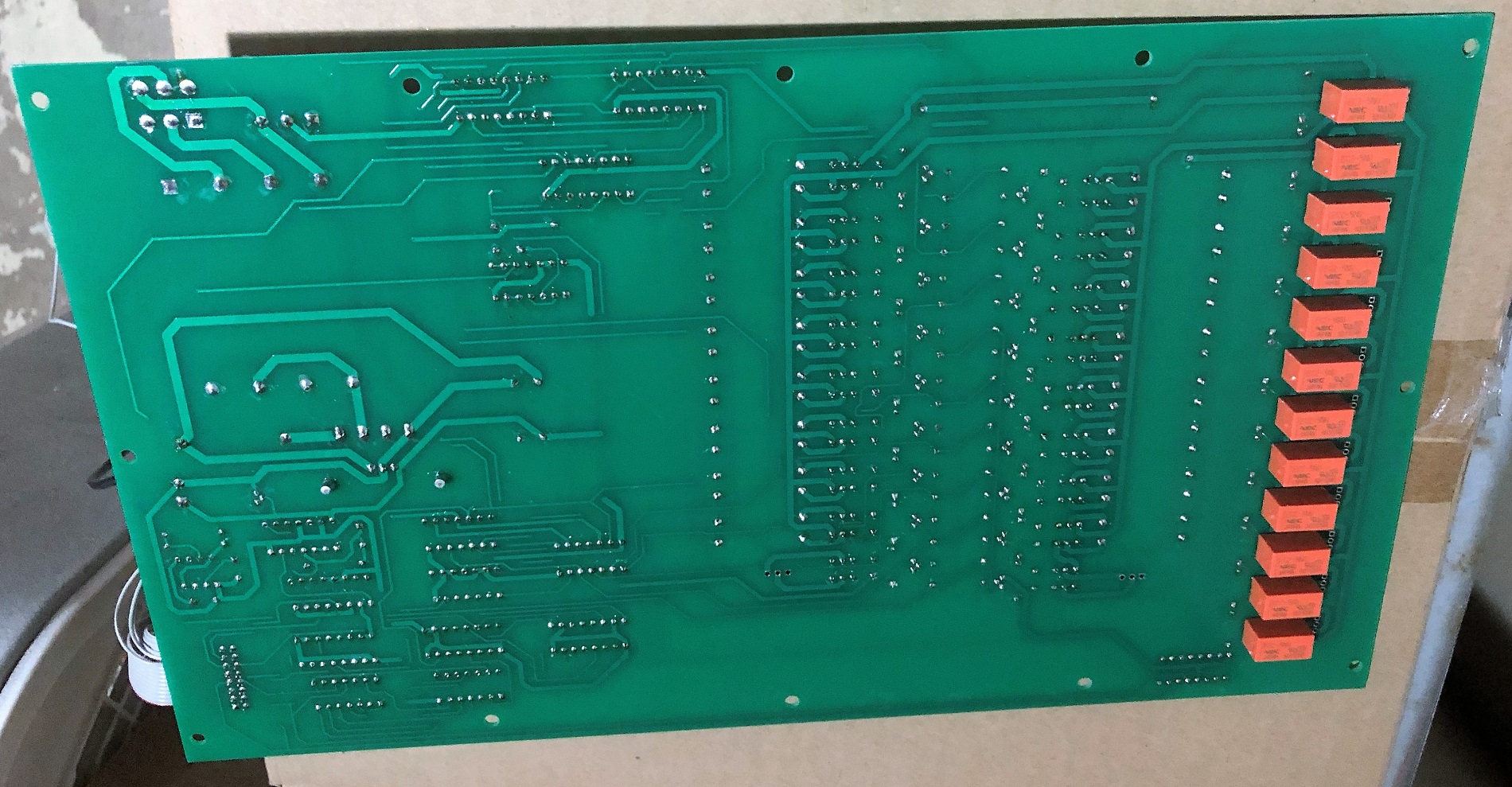

Main Board:
The main board contains the power supply for the control circuitry which consisting of a double primary and double secondary winding transformer, T1. The double primary windings can be paralleled for 115v or used in series for 230v, set with the switch S2 (you can use jumpers if you like to save a dollar). The secondaries are in parallel for the higher current output. The AC voltage and current is rectified by a bridge rectifier, D1, and fed through a fuse to the fixed voltage three pin 5.0 volt regulator, U1. There is a current storage capacitor before the regulator, C1, and one after, C2.
There is a reset controller, U9, that reads the voltage at startup and sends a reset pulse out when the voltage has reached the operating point so the board comes up in a known state: the volume at zero, no input selected and the mute not active. The output pulse of the reset controller is sent through two inverter gates, U12, in series so a positive and a negative going pulse can be directed to the chips which need to be reset with the appropriate polarity pulse.
There is an oscillator made with a 555 timer chip, U5, running at 15 Hz, its output is ANDed by U2 with the volume up and down signals to step the volume up or down while holding a button down on the remote or display board. There is a third input to the AND gates, U2, for the volume up/down inputs which is from the enable/inhibit (E/I) circuit created with U10, U11, U13, and U4, and reads the eight output lines from the 2 counters, U6 and U7. When the output from the two counters reaches maximum volume, 255, the output of the E/I chips is ANDed by U13 and inverted to proper polarity by U4, goes low to the Up AND gate so it will not accept any more input and thus not roll over from maximum to zero. Likewise, when the two counters reach zero the output of the E/I chips, U10 ANDed by U13 and inverted to proper polarity by U4 goes low to the Down AND gate, U2, so it will not accept any more input and not roll over from zero to maximum.
The output from the volume counters is fed to the volume display control circuit, U14 and U18, and the output lines from the counters also drive a transistor per line to turn on a relay to control the volume resistors. The resistors that pass the audio signal were chosen after reading an article in Linear Audio showing the distortion levels in different types of resistors. The Dale/Vishay RN60D resistors were listened to and then used in the design. There are four of each value and are matched to better than 1%.
The volume display control circuit is made up of U12, U14, U15, U16, and U18. Two gates of U12 form an astable oscillator which clocks the counter U14 and the display counters on the display board at 5 kHz, C5 provides the oscillator with a tank and R3 sets the speed of oscillation. U15 and U16 are two 4-bit comparators, ganged to form an 8-bit comparator. This compares the output of the binary counter U14 with the binary output taken from the volume counters U6 and U7. When the comparator inputs are equal, pin 6 of U15 goes high, triggering the monostable U18, which outputs a brief pulse to the latch control line that goes to the display counters on the display board. When the counter U14 reaches a value of 256, the link between pins 11 and 12 resets the chip and sends the reset pulse to the display counters on the display board also.
The input selection signal from the display board is inverted by U4 to drive the counter input of U8s clock; one press of the input selection button clocks the counter up by one. The three output lines are in BCD, and go to a BCD decoder U17, a high current device, which is capable of driving the input selection relays directly. The outputs from the counter are ANDed together so when all three are high, a seven, it outputs a pulse which is inverted by a U4 gate to the correct polarity to clock the Load input of the input selection counter whose inputs are set to load a one. The outputs from the counter also go to the display to be decoded to show the input selected. So, the input counter starts at zero at power up, counts up to 6 and resets to 1 in a loop of 1 to 6 back to 1.

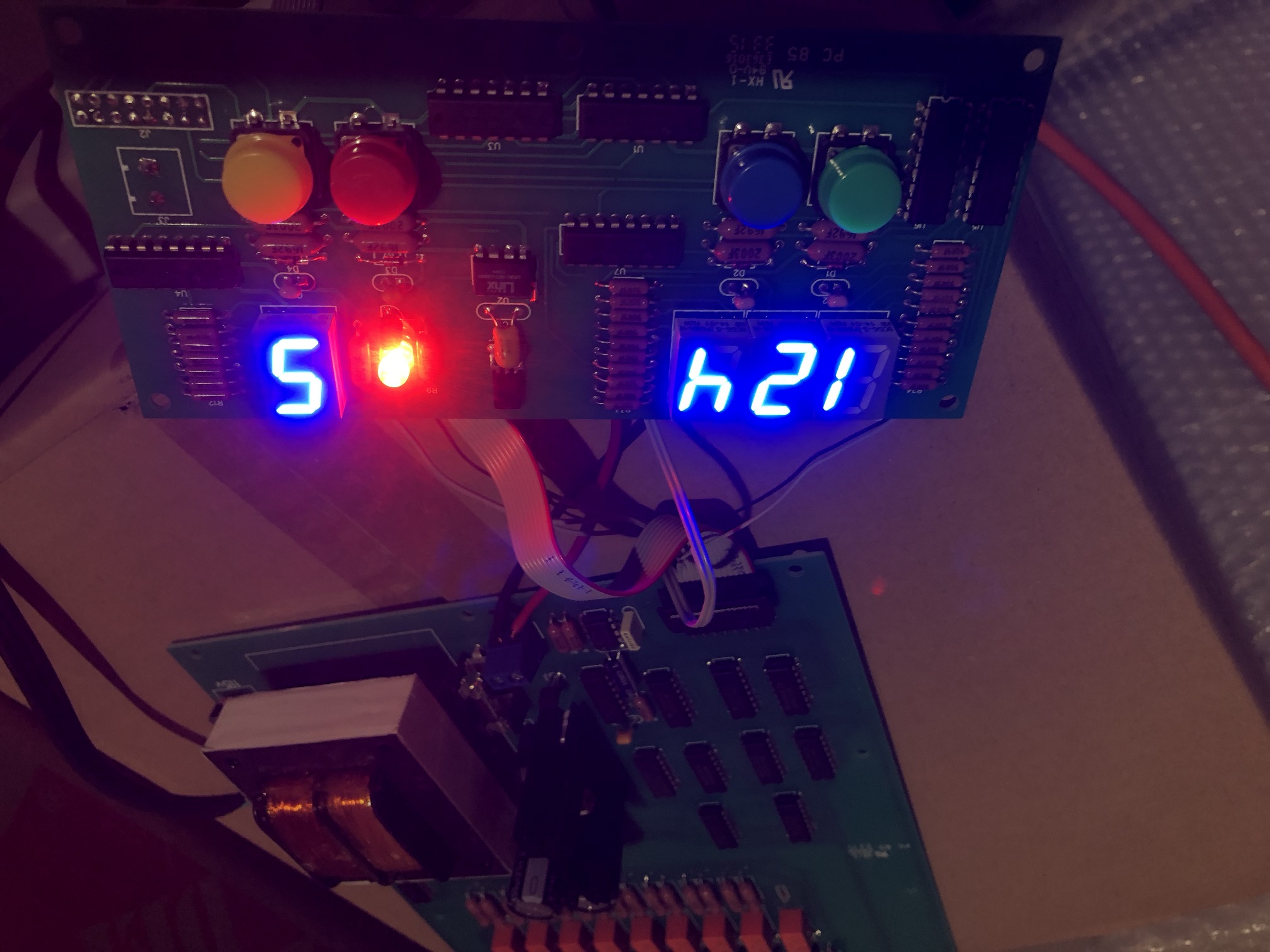

The mute control signal from the display board sets and resets a flip flop, U3, whose output goes to the mute control relay to mute the audio and the output of the flip flop also goes back to the display board to turn on and off the mute LED.

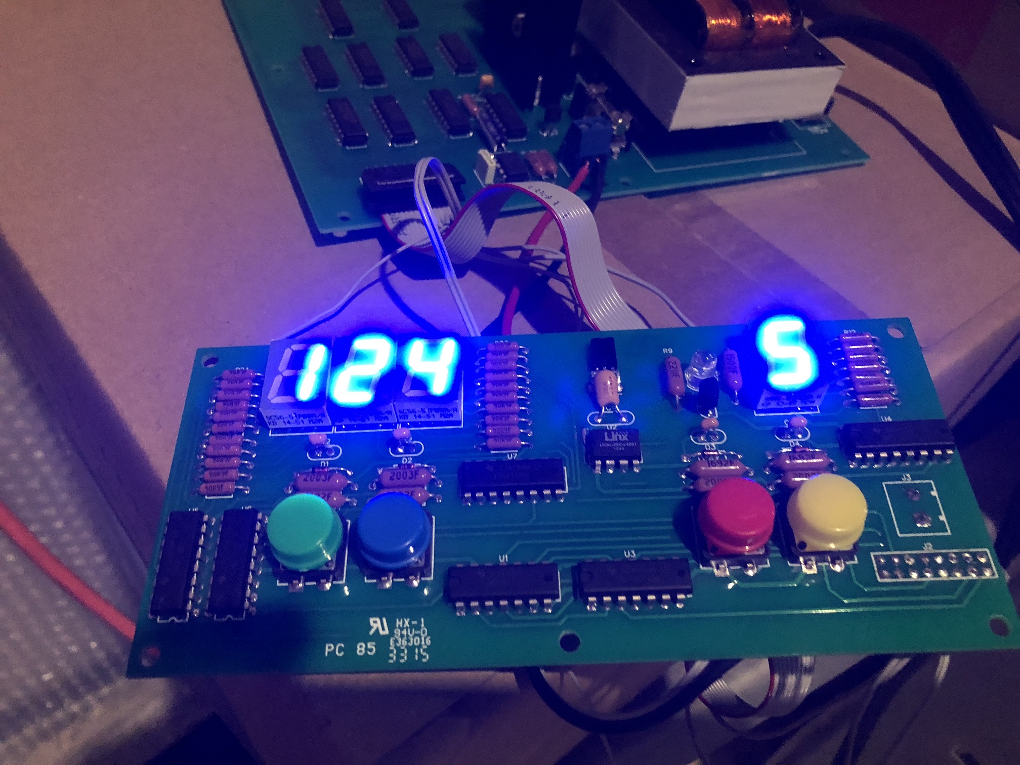

Display Board:
The display board has an infrared photo receiver, PH1, operating at 950nm and 38 kHz modulated signals, capacitor C1 makes sure the receiver has very clean power. It demodulates the signal back to the code sent by the remote, but it is inverted so it is sent to an inverter, U1, then to the decoder chip, U2, which decodes the pulse train input which then raises one of its four output lines for the code received. The outputs are for volume up and down, input selection and mute control. The decoder output is ORed with the user push buttons by U3.The input from the user buttons are “debounced” by a network between the push button and the OR gate. The input to the inverter, more gates of U1, are held high by a pull up resistor, and charges the capacitor, which keeps the inverter output low. When a button is pushed the capacitor is discharged through the resistor in parallel with the diode, when voltage reaches a low enough level the inverter switches to a high output. When the button is released the capacitor is recharged quickly through the diode in parallel with the resistor, at a high enough voltage level the inverter switches to a low output. The inverter is a Schmidt trigger type so it cleans up the input wave form from the user. These control signals go across the ribbon cable to the main control board.
The display board also receives control signals from the main control board over the ribbon cable.
The mute control signal turns on and off the transistor, Q1, which drives the red LED D5, R9 limits the current to the base of the transistor and R10 limits the current to the LED, increasing the value of R10 will reduce the brightness of the LED.
The three control signals for the Input control are BCD, Binary Coded Decimal, and are fed to U4 which decodes the BCD in to signals to drive a 7 segment LED display directly through current limiting resistors (U4 requires a common anode 7 segment LED).
The volume display is driven by three control signals: a 9 kHz clock signal, a latch signal, and a reset signal. The counter/display driver chips, U5 – U7, each drive a 7 segment LED display directly through current limiting resistors (U5 –U7 requires a common cathode 7 segment LED). The counters are daisy chained so that the first counter U7, or ones place digit driver, is fed the 9 kHz signal to its clock input, when it reached its maximum count it outputs a clock pulse from its carry output to U6 clock input, when U6 reaches maximum count it outputs a clock pulse from its carry output to U5 clock input. The count of the counter is not displayed until the latch control signal on each counter is pulsed by the common latch signal, the counter then outputs the decoded count to drive the LED segments. When the maximum count is reached the reset line is pulsed by the main board resetting the count to zero. The latch signal refreshes the display approximately 9 times per second. Whatever count is latched remains on the display.

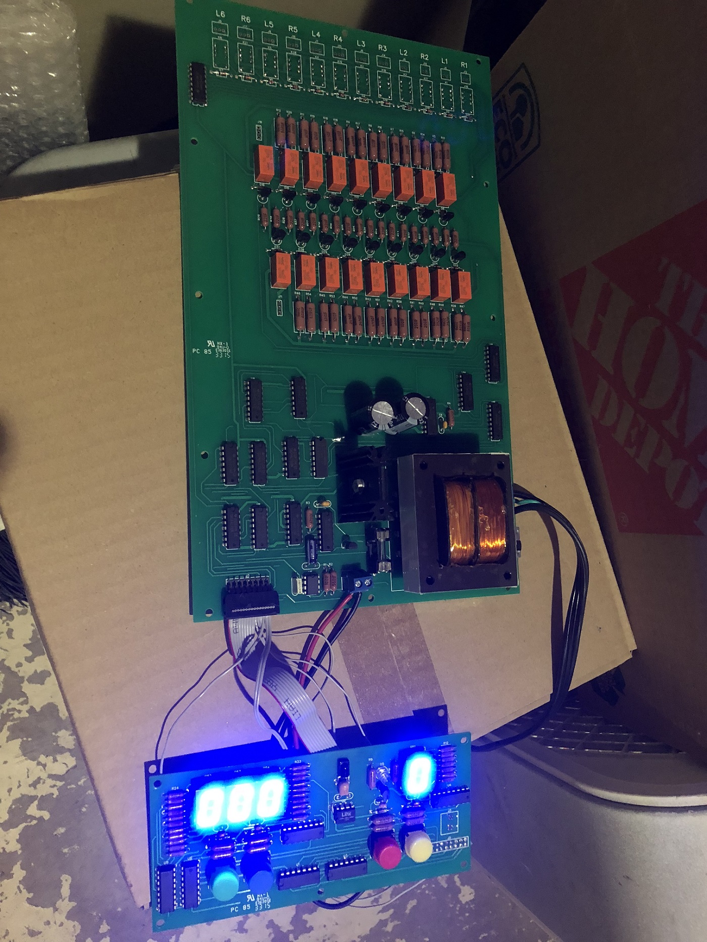

I forgot to attach the pics. Here they are. LEDs overwhelm the cell phone camera.

From looking at your mainboard schematic, it looks like you might be missing some functionality that could end up being crucial.
Lets say 00000000 is maximum attenuation and 11111111 is no attenuation.
What happens if you are at 01111111 and you turn up the volume by 1 step?
Remember that realys do not make/break instantly.
Then if you were really unfortunate all relays could be ON for short(1ms or so) while and you would now temporarily end up with 11111111 which is no attenuation at all before you end up at 10000000. the same goes the other way, what if you start at 10000000 and want to turn the volume down by 1 step? you could go to 11111111 temporarily before you end up at 01111111.
I have,while developing my own design, tried it without anything to control the relay timing and it is not pretty, it sounds awful changing volume, with a lot of pops and clicks.
Something to think about.
