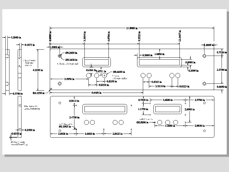

Preamp Faceplate
Here is a picture and the drawing files for the faceplate. This will give you dimensions for your own faceplate. The Window and four buttons is for preamp control. The smaller window and three button holes is for a DAC that was built into this preamp.
- Analog Line Level
- Preamp Control - Volume, input, mute, remote
