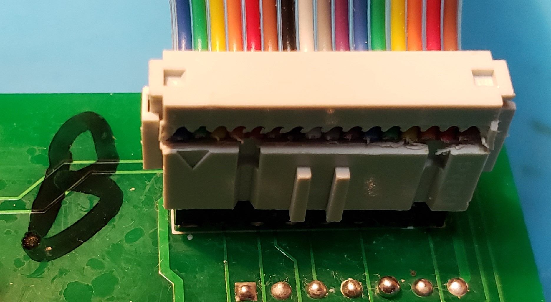

John,
I received my boards back today and am happy to report the boards and cable work as advertised. I tested all my other digital and display boards, and they were working correctly as well. I quickly went through and scratched out the "A" and "B" on my other display boards connectors and relabeled them with magic marker.
I then looked carefully at the cable that you had modified for me. I noticed that you had changed the orientation of B on the display board and found that that configuration worked correctly. The problem is that one of our sets of eyes is lying to us🙂.
To me, the blue pin is no longer oriented to the dot. The blue pin on the cable is coming in from the top of the board but the dot shows that the cable should be coming in from the center of the board. Please review the picture and see what you think.
Roy

I see the problem, it is in the thought that the cable has to come out of the pin 1 SIDE to BE pin one but that is not the case. Look at the connector, the triangle points at the dot, the cable could come out of the bottom of the connector as it does now or out the top, pin 1 is to the left in the picture and so long as the blue wire is on that side your are good. Look into a connect that hasn't been press yet you will see the wire piercer doesn't care which side the cable comes out of.
Looking at the connector, I see what you mean. I was limiting myself to a subset of viable cable configurations. In other words, if I connected both sides blindly, I would have a 50% chance of getting it right rather than just the 25% chance I had assumed🙂. My other set of cables works fine but I guess I didn't beat the odds on one of the cables I sent you.

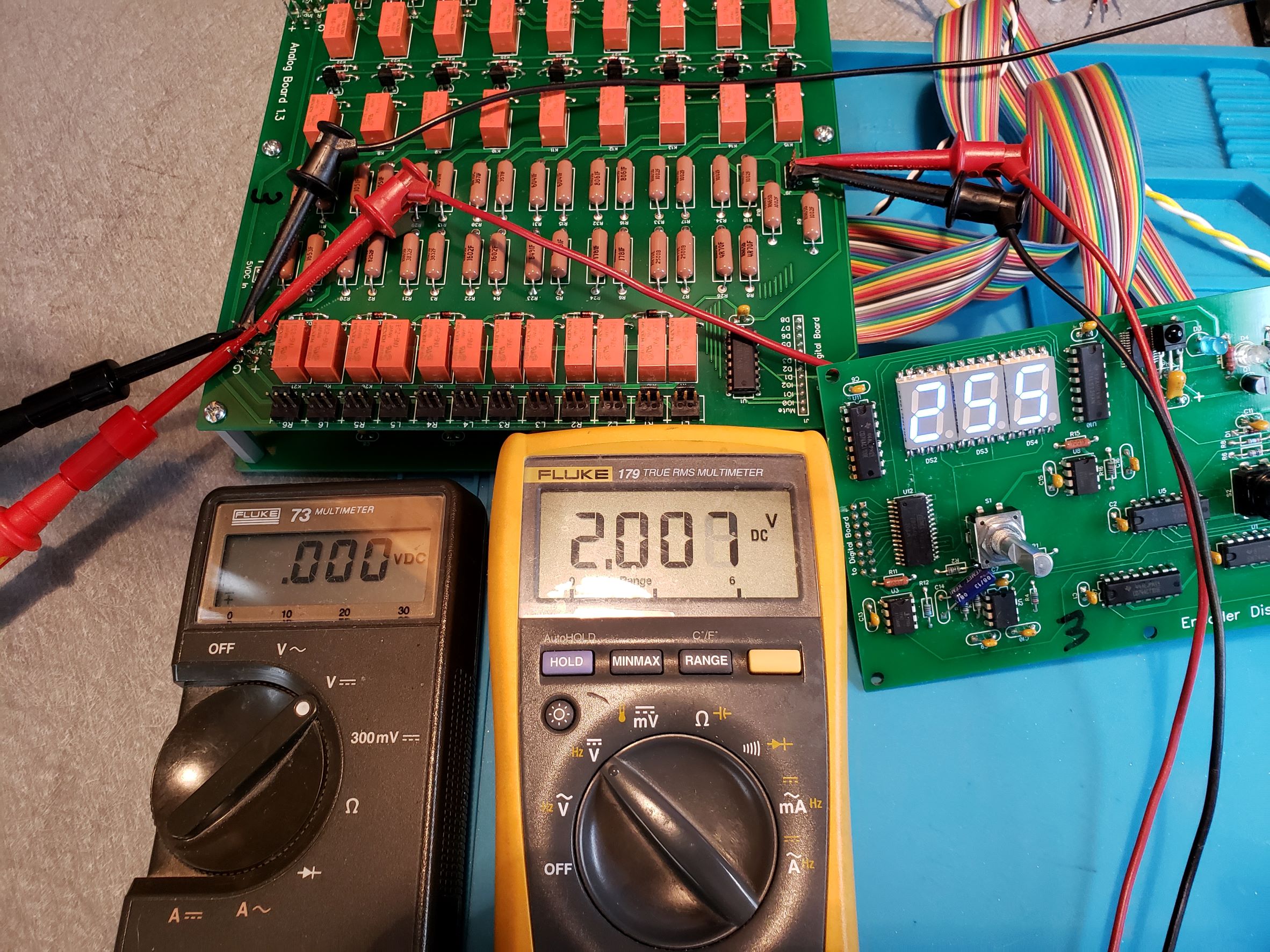

John,
I seem to be having problems getting output from the volume control. I have cut the traces and placed short bare test wires in the switching out and volume in IO holes. Switching works great on all three analog boards but I am not getting any output when I try to put 2V DC through the volume inputs.
In the test illustrated below. I have placed 2V DC between the Left + input and ground as seen on the Fluke 179 meter. The volume is cranked up to 255 and I should be getting around 2V from the left + output and ground. What we see on my Fluke 73 is 0V. This is true throughout the volume range.
I also tested the other three boards with the same results. The switching works but the volume doesn't. On one board I reconnected the cut traces and tried to use it as a passive preamp with no success either.
Got any ideas where the problem might be?

John,
I am getting results on the volume problem. I started by checking the diodes on the switching relays that I knew worked. Sure enough, I was getting close to five volts on the diodes of the input relays that were indicated on the display as active.
I then checked the values of 100, 101 and 102 on J1, the digital board input saw the unique set of high (approximately 5V) values for each input setting. I found the same true for the mute pin. This left D1 - D9 for controlling the volume relays. After testing which pins went high (approximately 5V) as the volume was turned up, I found it to follow a code and appeared to be operating properly.
I then checked the volume diodes and found that they only reached 1.2V rather than 5V when they tried to go high, probably not enough to trip the relays. The obvious question is the relay driving transistors. The BOM called for 2N3904s but they were not in stock. I ended up substituting BC549Bs at your suggestion. Could they be causing the problem and is there a viable option for that transistor?

1.2 volts at the relay isn't enough voltage to switch on the relay. Sounds like the transistor isn't turning on hard enough to pass the full voltage. I haven't had an issue using the BC549 as a switch for LEDs and other devices. Testing to find out has some risk, I think the chip can drive the transistor base directly without pulling to much current from the chip. You can try bypassing one of the resistors to the transistor base, just do one for testing, a jumper wire across the resistor would do it. If that works then we know it is base current. Safest option would be to put in the 2N3904, looks like Mouser has 200k of them in stock now.
Substituting some parts can be tricky, one batch of transistor works and the next batch doesn't. In the digital realm I have always been able to substitute a 74ACT part for a 74LS part but testing for timing changes is always required.

2n3904 may has a different pin out from that of bc54X...ebc vs cbe.
The base drive current of the design was generous at about 2mA and a transistor having half decent beta would have no problems saturate at 56ma Ic. Hfe>=30 is all it needs. But if reverse e-c, you get beta = 10 if you're lucky.
