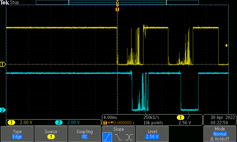

I got out the scope this morning and took a look at the 2 signals into the Arduino and
while not pretty, they are typical of mechanical encoders. These cheapy encoders are
1 cycle per tick, and 20 cycles per revolution. I define a tick as rotating 1 position either
way to the next tick. That noise is dirt in the contacts. If you attempt to read that via
interrupts the processor will do a lot of work chasing the noise. The Grayhill encoders
I used long ago on another project were true Gray code encoders where there was 1
CHANGE per tick of EITHER the A or B readout so for a 16 position encoder, there were
4 cycles per revolution. To decode those you need to detect ALL transitions. The Grayhill
were optical meaning an LED and photo transistor so there was no noise on either phase.
If you're counting where it is imperative there be no errors, you must use optical units.

I agree that the encoders are noisy, as are push buttons and other switches. It is necessary to 'debounce' them. In hardware, given a pull-up resistor, the minimum is a capacitor to ground - empirically this works well but more sophistication is possible. Looking at John's hardware designs it is clear that John understands the need for debouncing.
Hi Stratus46,
For those scope readings were there caps across the pins to ground. It is recommended to use a .01uf cap on each pin to absorb the noise, and I find this to work.
Finding good rotary encoders that don't have shaft wobble and are not expensive is the hard part. The Optical units are nice but too expensive, though I might take another look at them.

For the code, an interrupt is the best way to get the instant of the pin falling, polling can take too long and can miss a state as it is doing now, if at the interrupt you then immediately read the other pin you can determine the direction. I will learn more of the Pin Change Interrupt, which works with the current PCB layout, and also look at using the other interrupt pin of the Nano for one pin of the encoder, which requires a couple cuts and jumps, then in an ISR immediately read the other pin then return to the main loop to determine up or down.
