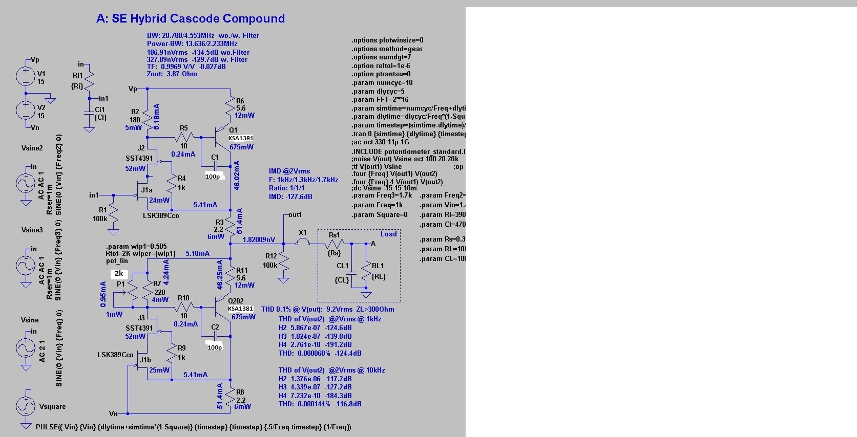

Preamp-Buffers - simple idea
Attached schematic
see attachment for the simulated values with LSK389C Cordell model (Idss: 8.3mA, Vp: -536mV)
Around 8mA through R2 and R7/P1 seem a bit high.
The increased voltage drop leads to an increase of current through the bipolars also.
You may want to check the voltage drops over R5, R6,R10 and R11 and calculate the associated currents by I=Voltage drop/Resistance.
If the currents are >>70mA, R6 and R11 should rather be increased, as the heat power losses over Q1 and Q2 might become too large.

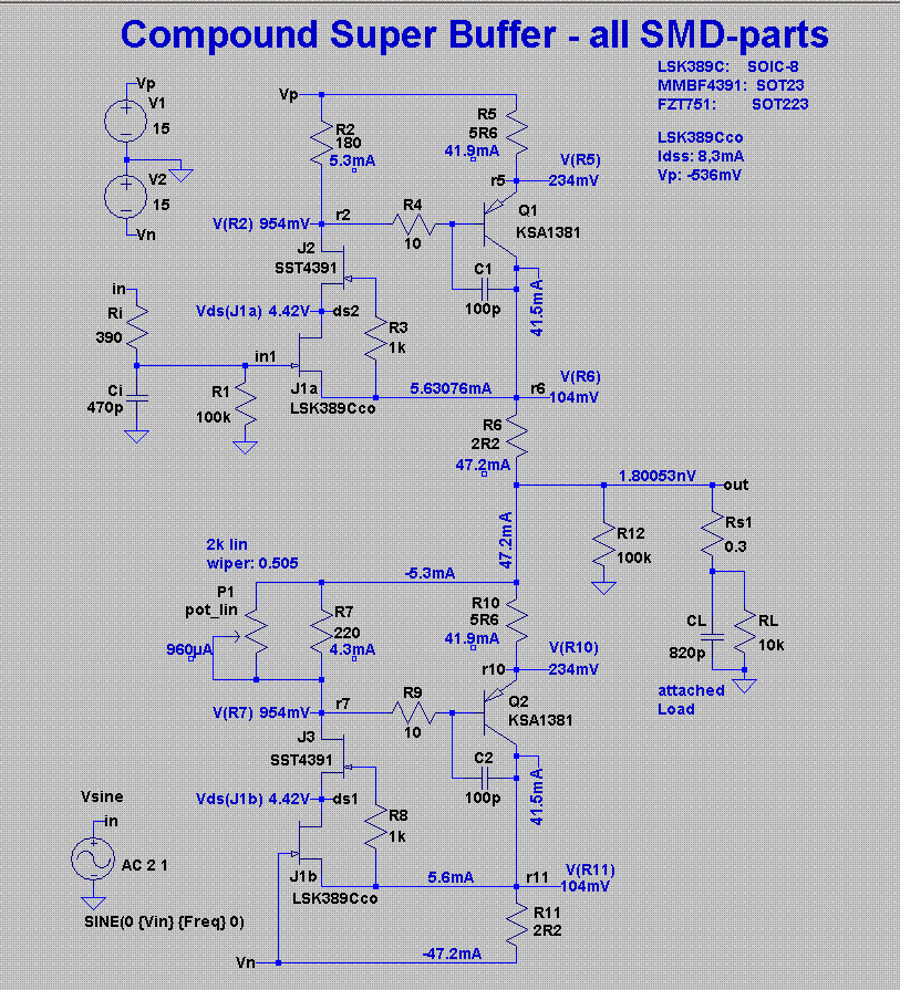

the numbers in #594 appear ok.
The most important numbers of R6 and R11 are the same.
The second most important numbers of R5 and R10 are the same also.
The last two numbers simply differ, due to the value of R7/P1 beeing just the calculated value of R7´s current.
The numbers in #595 can´t be correct.
There´s a difference between R6 and R11 of 6mA.
As this difference current must flow through the 100k Ballast resistor R12 this would lead to a (theoretical) output offset voltage of 600V(!)
The number of R6 is also quite unbelievable as the current through the bipolar transistors (indicated by R5 and R10) are the same.
The numbers of R2 and R7 are quite similar to those from #594, also not indicating something wrong.
The offset voltage value of -12mV calculates to a current imbalance between lower and upper part of the Buffer of tiny 120nA
Hence I assume a false number for R6 (also 60ma) or/and false numbers for R5 and R10 (54mA).
Around 6mA for the JFETs (54/60mA) seems more realastic than 9mA (51/60mA)
As the output offset is very small all hints to a calculation or measurement error, not to a failure in circuit function.
Merlin, could You measure the voltage drops over those 6 resistors and the output offset again?
